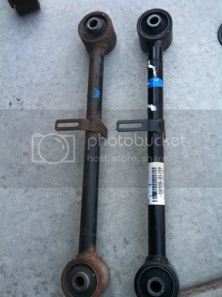

My truck is nearing the 200k mark. I dont have plans to replace it anytime soon so I tought I would start refreshing it - and making it new again. With the changes below I made it drives and feels like new. Zero thunk/thud/clunk in my drive train.

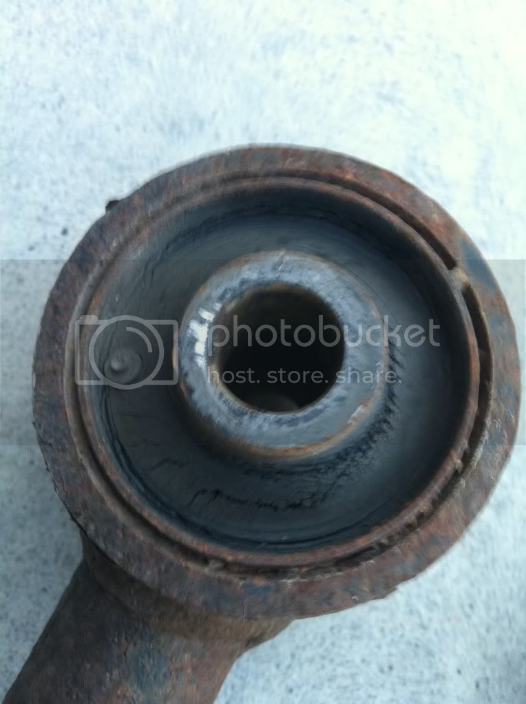

I've done the following to my 100 in the past few months:I installed new OEM rear upper control arms installed last night. Bushings were toast after 13 years and 200,000 miles.
New set of revo tires.
Balanced rear driveshaft.
New set of Sport Old Man Emu shocks.

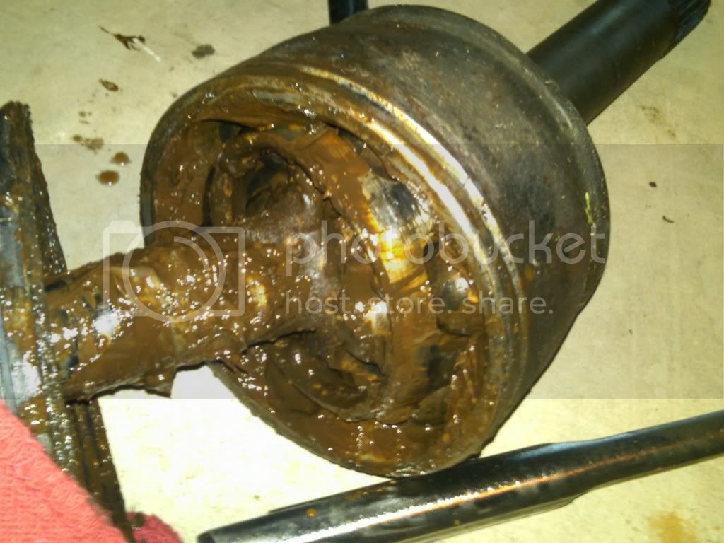

Rebuilt front CV axles - Toyota OEM

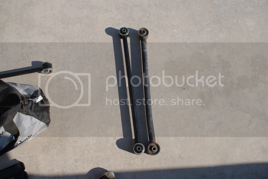

Installed Slee Rear Lower Control Arms - OEM were bent.
In the past 2 years.
I've put new Toytoa OEM front Upper control arms on.
New lower ball joints on front end.

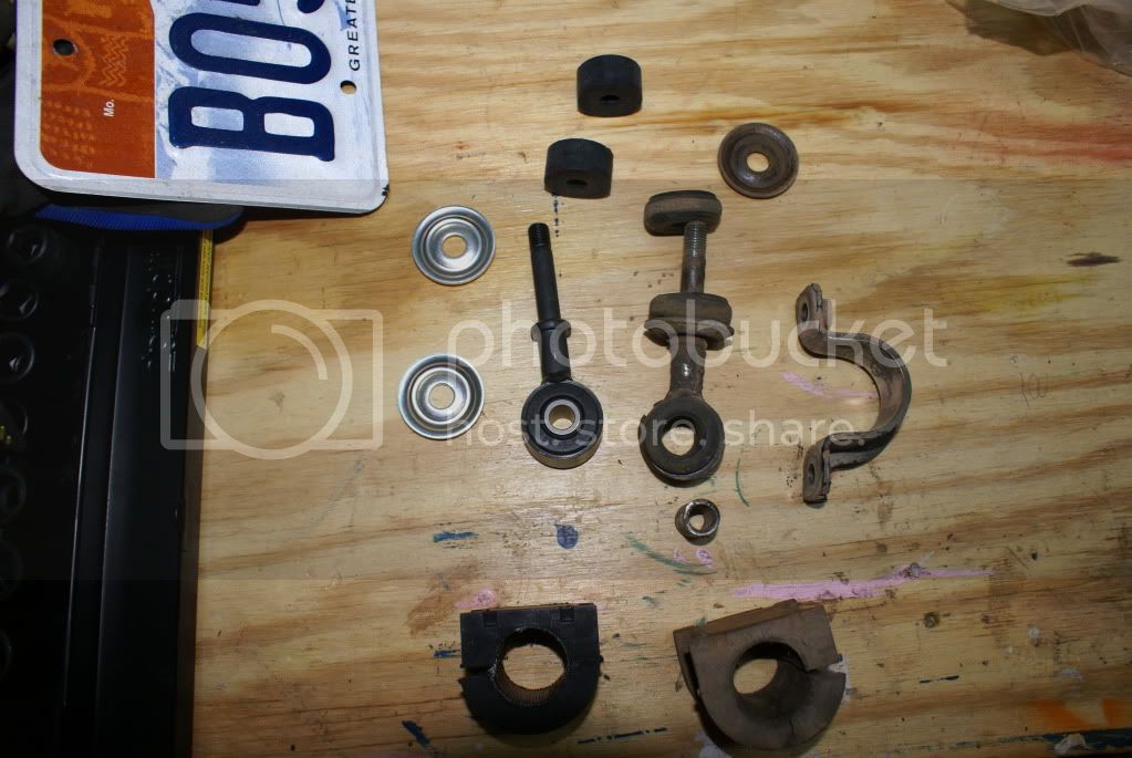

New front and rear sway bar bushings.
The truck drives and handles like new. I love it. 200,000 miles and going strong. There are many adventures still left in this Land Cruiser.
