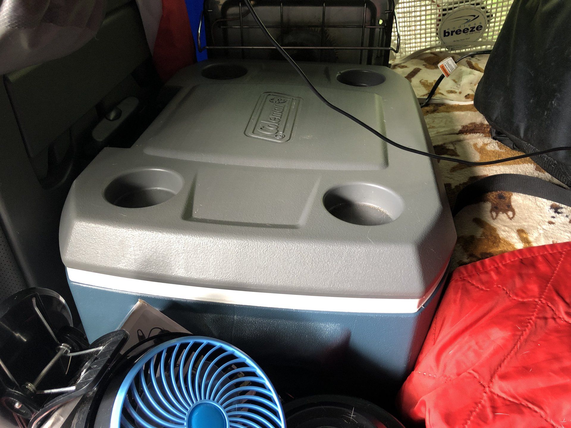

Cooler is 17 inches wide, 17-18 inches tall and 21 inches long. Bed is about 15 inches off the floor in back but a few inches higher in front, which is why I’m flexible on height (I can raise back bed height later with a single drawer).
If i take out 3rd row seat on passenger side I only gain about half an inch for width.

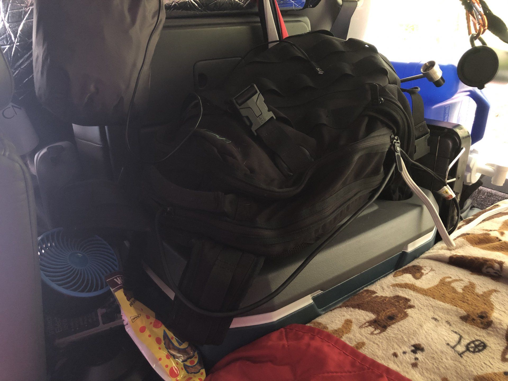

By the way, the charge backpack is working out great. Now my power banks, laptop and USB devices are getting way more charging time and I have not had any issues running out of power, not even close. Being able to quickly unplug and plug everything in, as well as it being easy to transport, makes it something I can easily integrate into my routines. I’ve also done some wire tucking using the pockets inside and it looks much more neat, maybe a few Velcro straps and the temp solution backpack can become permanent! Will add a small USB fan and might move the strip to the waterproof compartment where the laptop is, not that I ever intend on leaving this out where it is wet.
They can be chained so that I can plug the fan into the 12v from the Jackery, all 3 power banks have to drain before the fan shuts off.

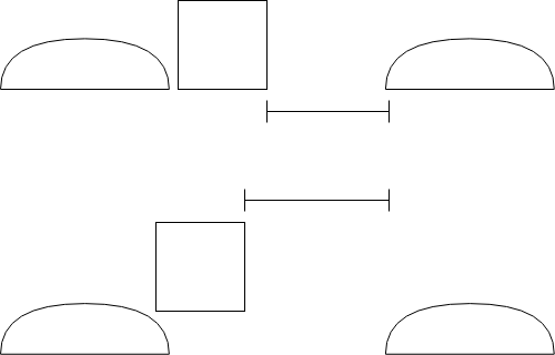

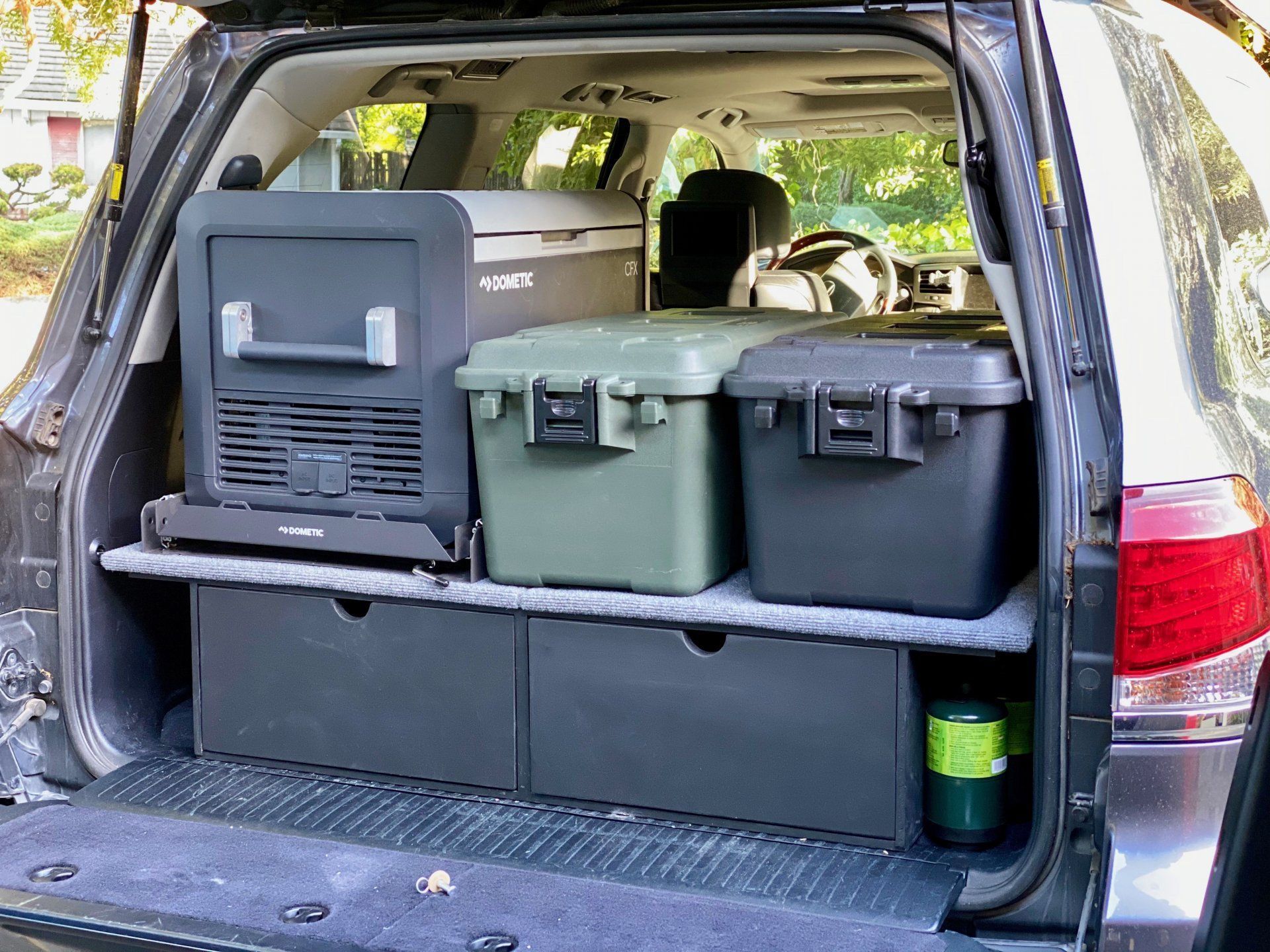

You may consider even a small drawer or something under the fridge. The reason is that if it sits close to the floor, you are limited in how far over you can mount it because of the wheel well. By raising it up even a couple of inches, you gain a few inches of space that you can use for your sleep platform (or whatever). The area around the wheel wells tend to be dead space anyways. Here is a crude diagram, but you get the idea:
You can probably find a sweet spot where you can still use the top of the fridge as you intend and also gain more flat real estate on your platform side. Think about a small cubby for your stove, or other low profile things you could store under the fridge. Food for thought.
This pic best illustrates it. You can see how far over off-center my fridge sits and how much space is open next to it.
If it was on the floor, it would be exactly where the outer edge of the drawer on the left would be. Obviously this is higher than you want to go, but you can see it in practice:

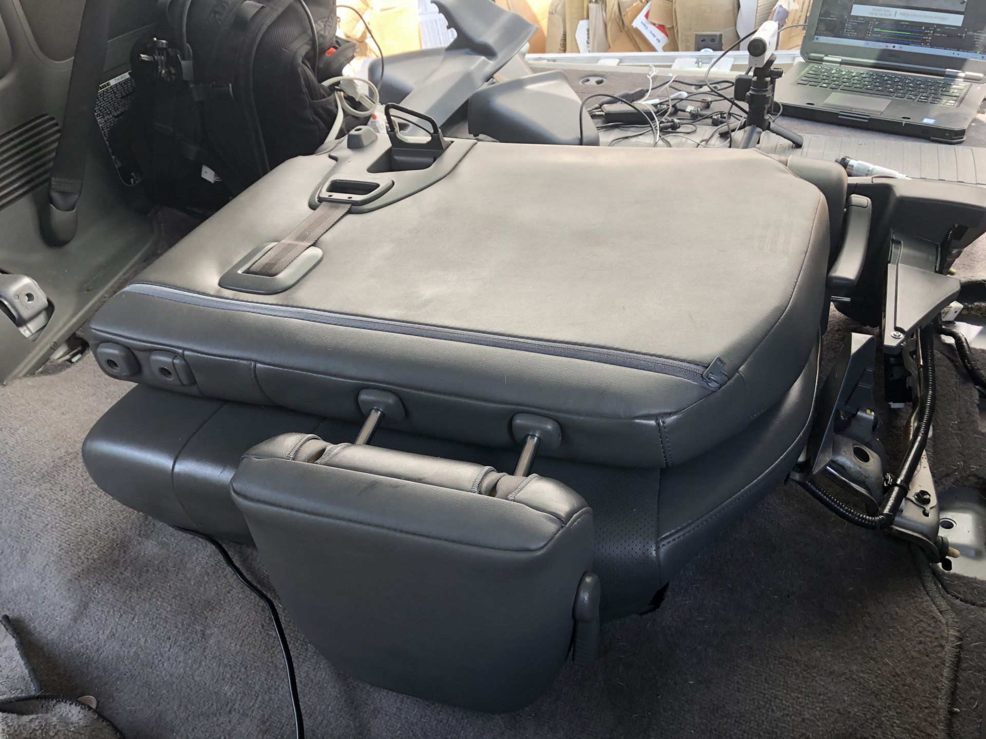

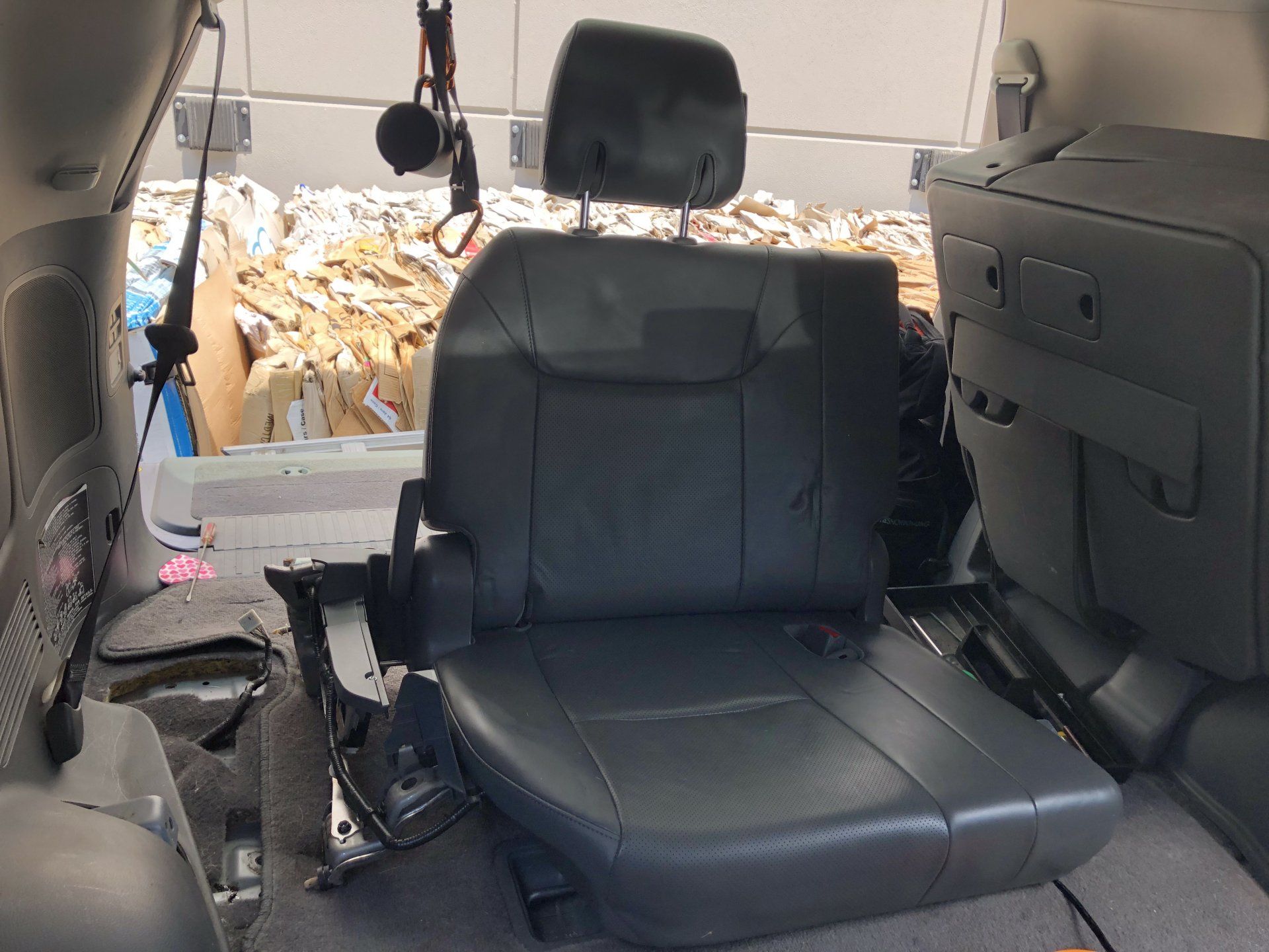

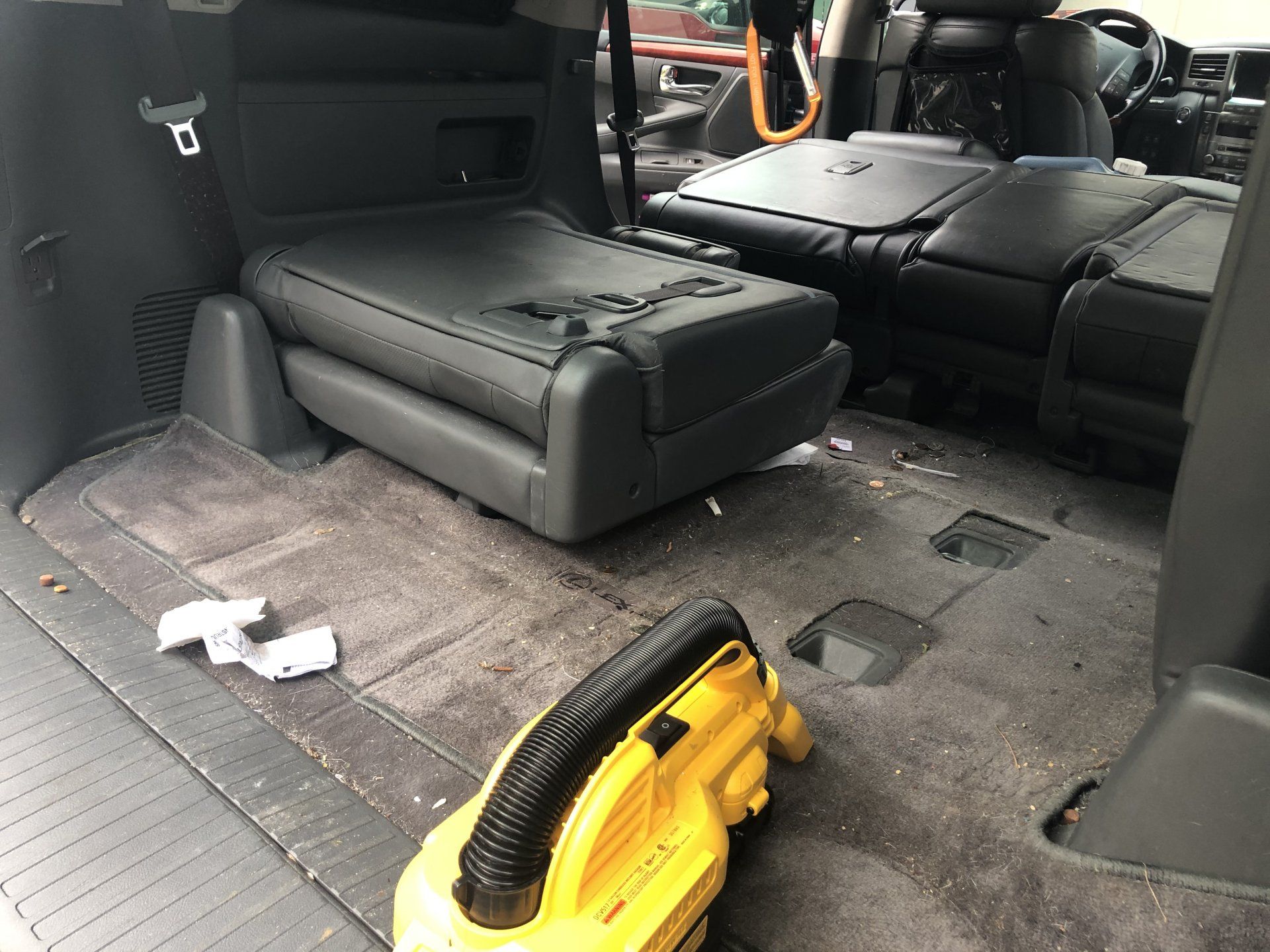

Pulling the third row: Fold seat down a couple inches so it unlatches from wall. Hold the latch closed and fold vertical. You want to prevent the latch from re-engaging on the wall. There will be a warning buzz, ignore it and it goes away. Pull trim firmly. Attached are some pics of the back of the trim so you can see where they interlock.
Four bolts and the one plug and you're done.
That could solve another big problem I’ve been having, which is that my width restrictions because Of wheelwell pretty much forces me to drop to a smaller fridge.
What I am trying to work out is that if I raise it to clear the wheelwell, then it will end up being as tall as yours? You are just clear of the wheelwell yourself, are you not? Then it will be too high to use as extra bedspace.

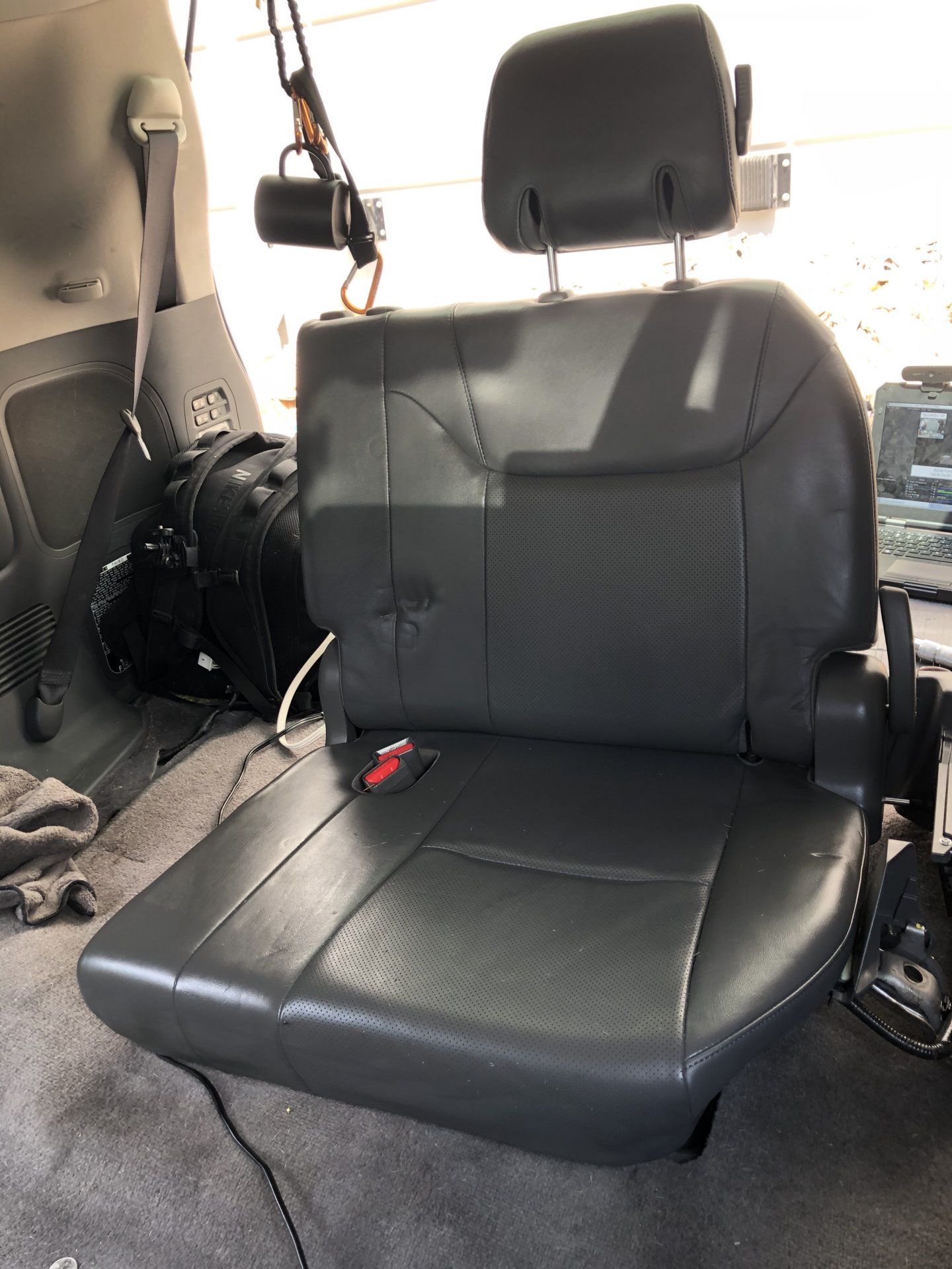

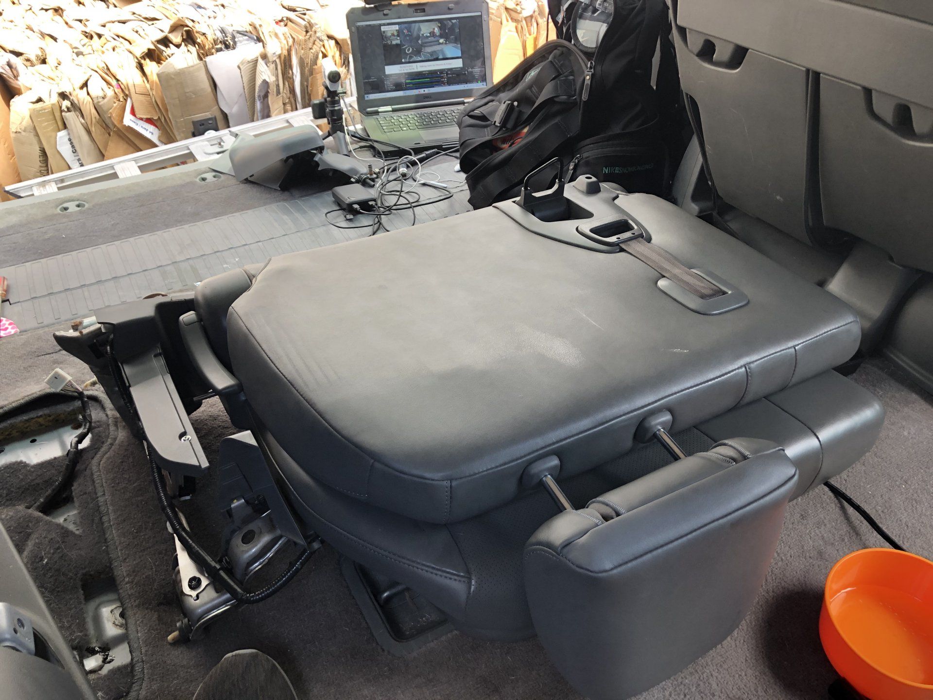

If you remove the second row seat there are bright yellow plugs. These are for the airbags. Only unplug or plug if negative battery disconnected for 3 minutes.
You'll get a dash light from srs system that can be resolved long term with a resistor. I forget the value but is been posted a few times.

The thing is that you only need to go as high as me if you want tp completely clear the wheel well. You can do some basic geometry to clear only as much as is needed or just take a couple of straight edges at a 90 degree angle and you can approximate pretty easily to see how high you need to go to gain as much space you need for the size.

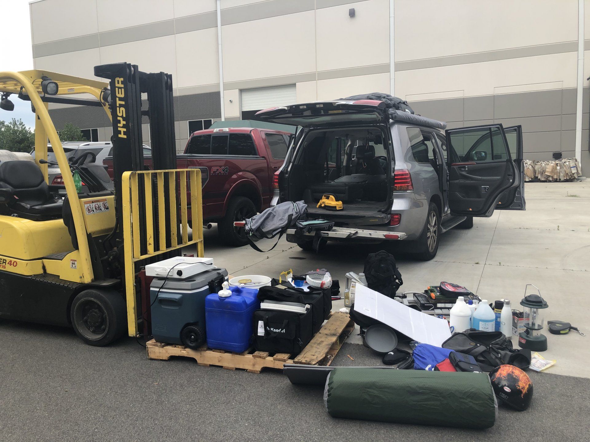

Pulling the third row and the big 2nd row seat today! After that I will try calling IceCo again to inquire about group discounts and their Secop compressor lineup, and will call other vendors to see if they will entertain the same.

2.2 ohm resistor to Prevent SRS airbag warning lights, and disconnect negative terminal 3 mins before pulling the yellow plug. Can you post a picture of how your resistor is taped on there? I have never put in a resistor before so a picture is worth a million words here. Thanks @grinchy and @Markuson for leading me to the SRS solution.

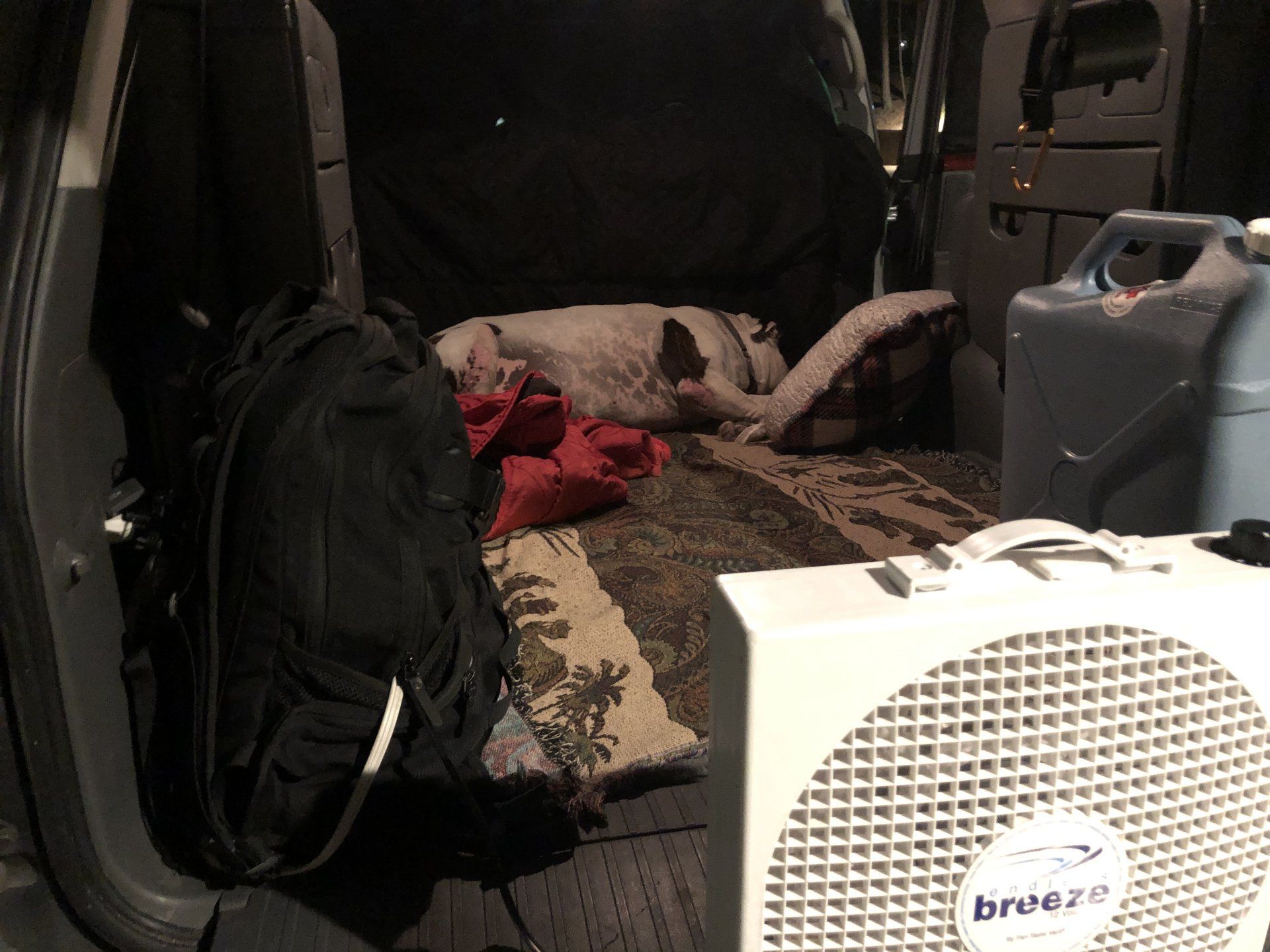

and by the way, the floor isn’t that bad I actually had a nice long sleep! Wasn’t used to having all that width to roll around in which was nice.

I asked my dad if I could do the removal inside the warehouse today since it might rain, and he said NOPE lol. We have a lot of people coming in and out and they need the loading dock areas (where I normally work on the car) clear. I normally just use it on weekends when we are closed and I have free reign over the warehouse.

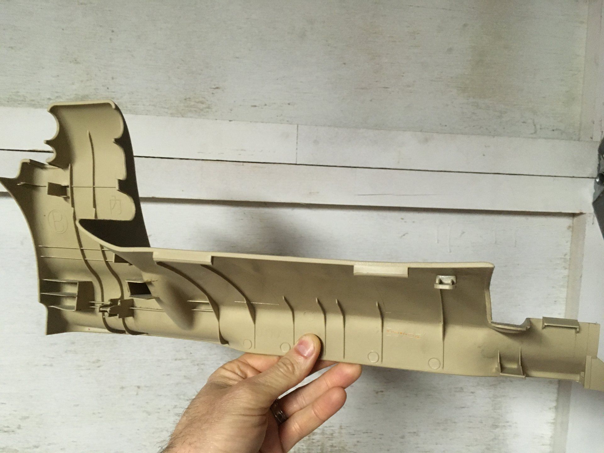

Up for donation. I really would love to find someone who can make use of these so that they don’t go to waste or take up space forever in my parents warehouse. I cracked the built in DVD Player display on the 2nd row seat by laying on it, but I can swap it out with one of my working ones since I don’t use it at all. Everything works on all the seats.
Ideally you pay for shipping but I can likely get you some good freight rates. Will add pics of 2nd row seat later After it is out. I will also shrink wrap everything to protect it while it awaits its next owner.
