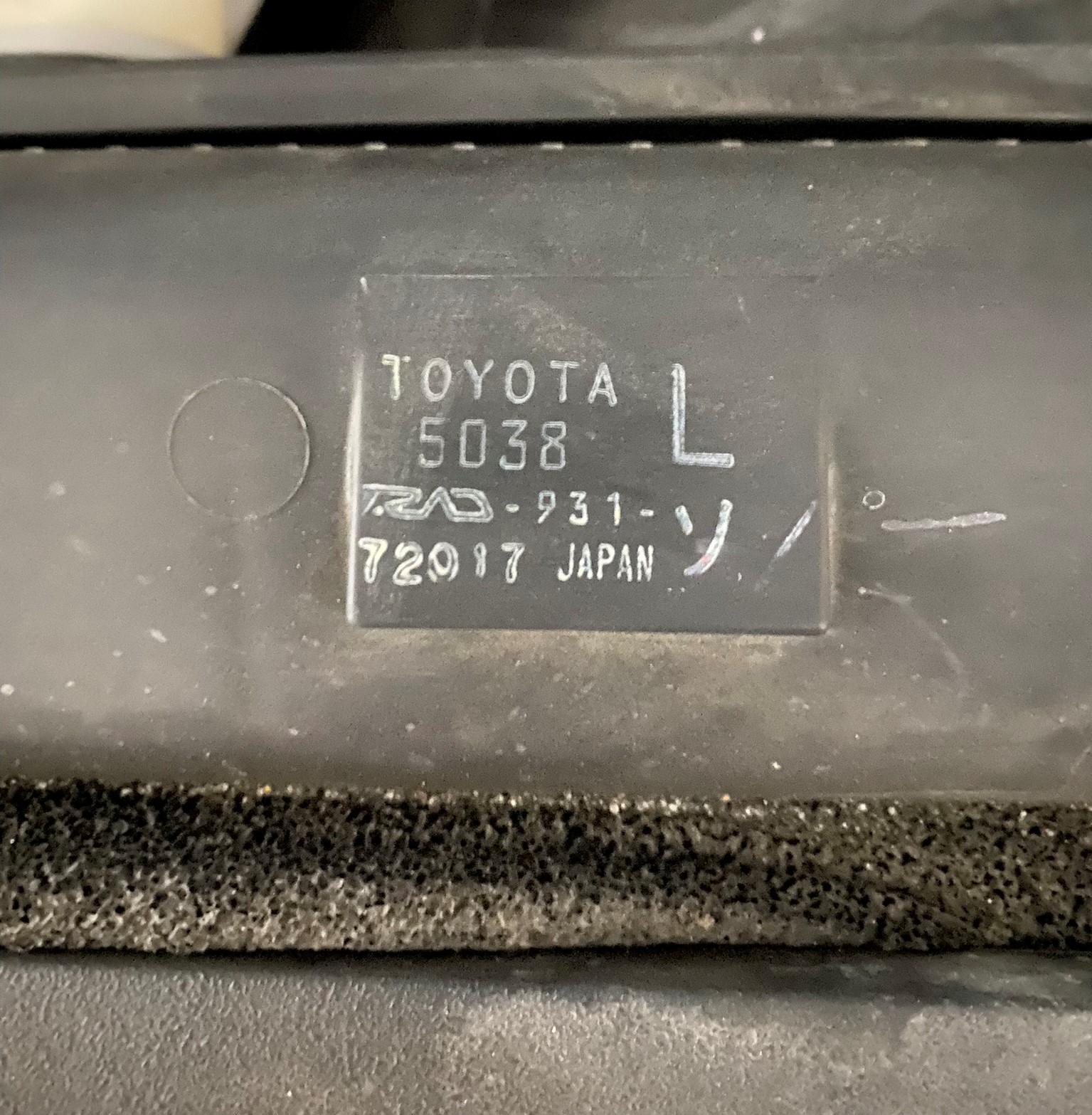

Might as well post it here too since people appear to be having trouble finding it.
This is the new radiator, note the more rounded edges where the ID plate area meets the tank to reduce stress risers, and the rear edge being more prominent since the plate got tilted forward to reduce the height of the front edge.
The quickest way to tell at a glance is the tank is flush with the center of the tag, not the rear edge like the old one.
I just picked up my 2011 two weeks ago. I'm the 3rd owner and the PO said he'd never touched the radiator. But I'm hoping/wishing/praying the original owner did. I think this is the new radiator, but it has a different part number than the one above. Can anyone confirm this is good? Would be a huge relief.
That's the new style. You are good. Most likely replaced at some point.
@Goldbug - confirmed this is good !!
I have an '08 w/~105k on the clock. Is this one of the dog radiators? If so, surprised it has not gone bad yet.
Sure is. I’m wondering if pretreating with some jb weld makes sense. If the vehicle is new to you, it might have already been replaced.
