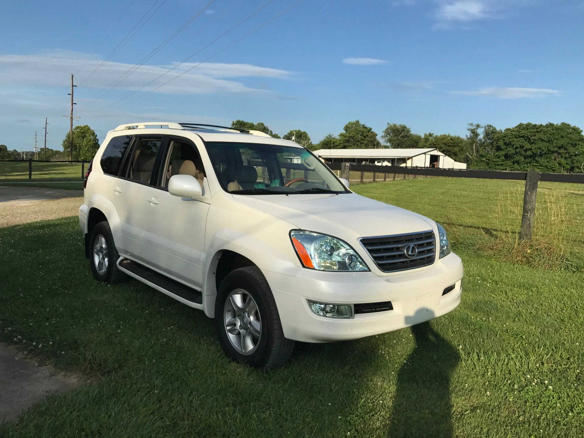

Long time lurker, first time poster. I've been looking around the forum for the past 6 weeks after the purchase of my build vehicle (07 GX470 non-kdss). Vehicle was purchased in Ohio with 115k for a good price, only serviced at Lexus and driven by an older lady. Standard rust belt wear on the underside that I quickly removed, treated, and painted after I drove it back to Colorado. The wheels are in good shape minus the spare which looks like it had never been removed from the heavily rusted spare tire mount on the underside of the vehicle. I am always looking for more recommendations and info for the items that will be added throughout the build.

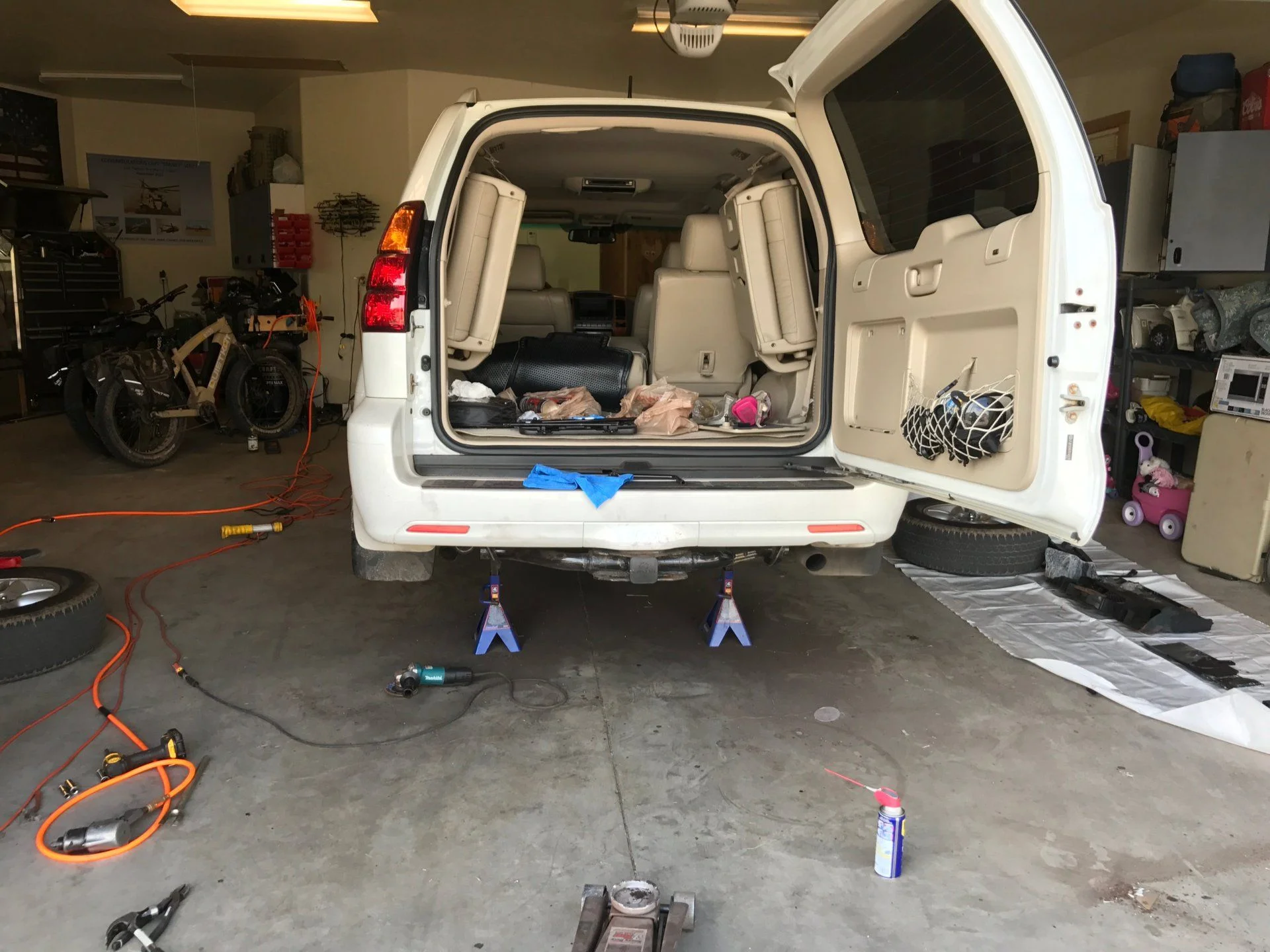

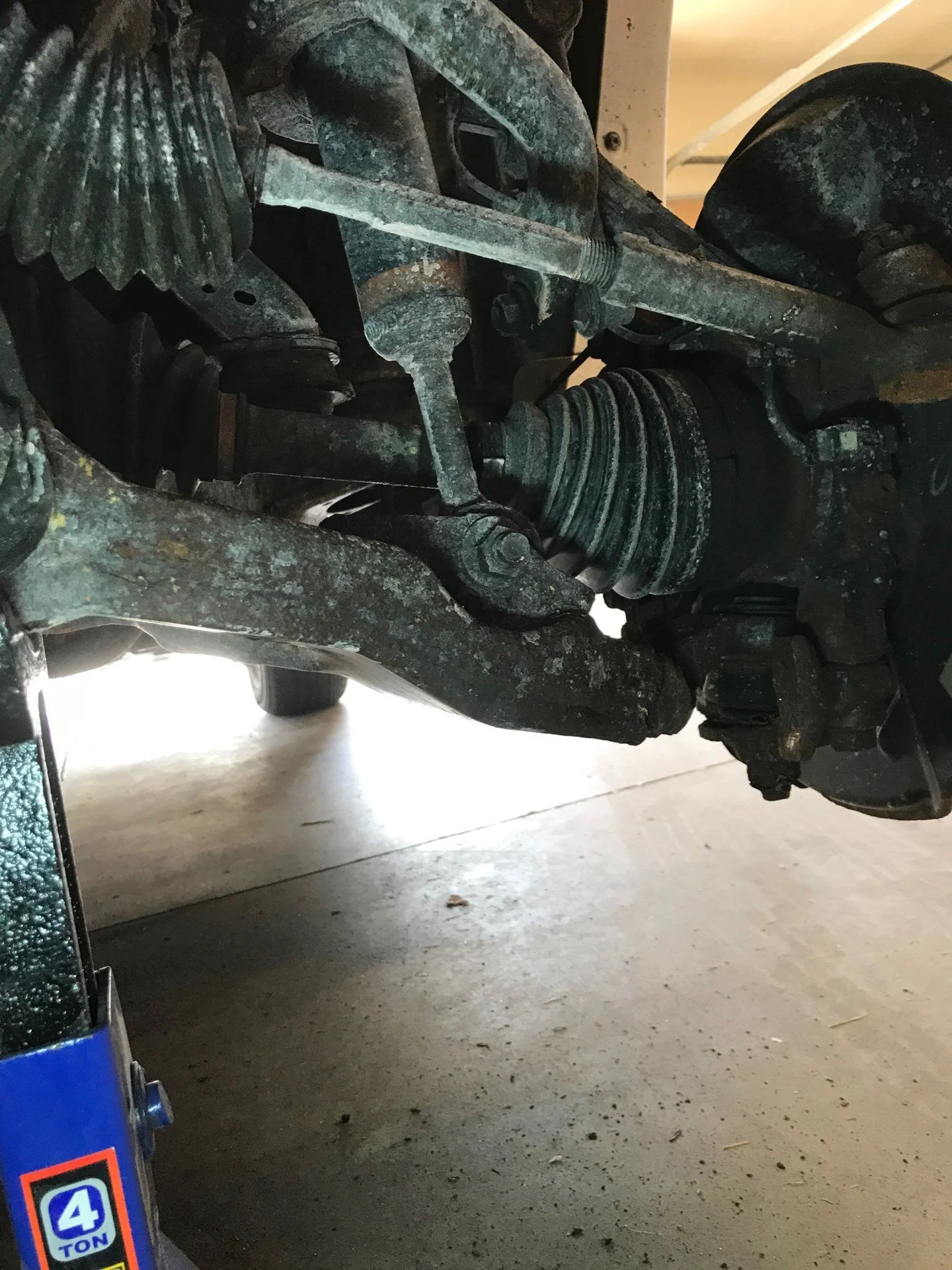

Rust removal. Took it to bare metal on the bad spots with orbital sander and fine grinding discs. Treated with Rustoleum Rust Converter and covered with spray on bed liner. Took several hours and almost lost a finger along the way after the sander bucked and went partially though my reenforced mechanix glove. If you do this wear eye protection and a respirator due to the high probability that "rust dust" is most likely very toxic.

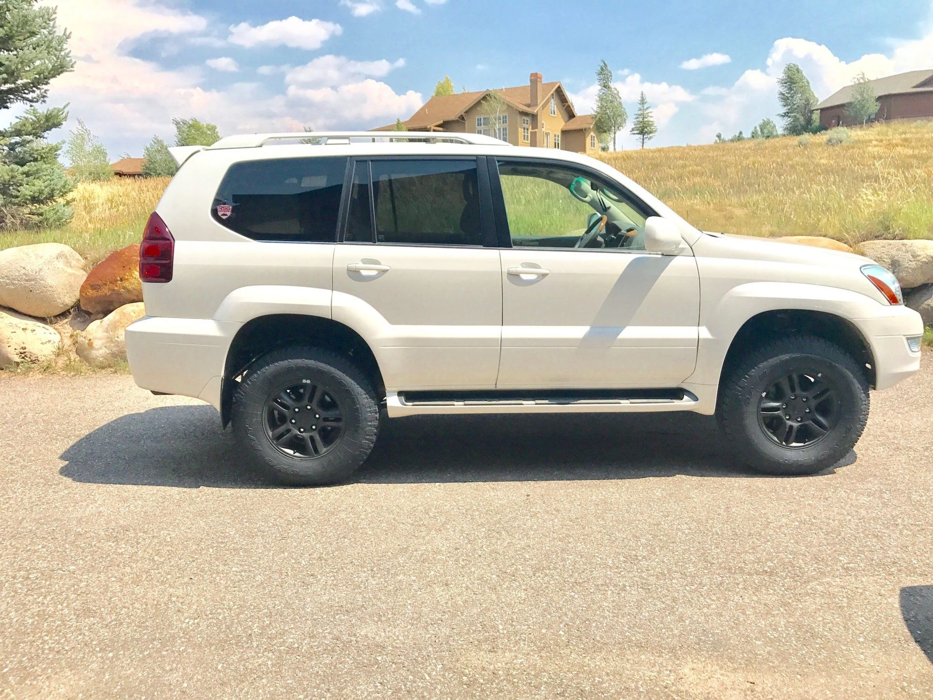

At least one lad here is running 35's - rubbing is eliminated with some wheel well modifications, very doable (I'm running 33's with just the slightest trimming required).
Congrats
I am running 32", Dick Cepek Fun Country 265/70/17 with MetalTech/Radflow 2.5-3" lift on 2015 4Runner SR5 wheels, no problems

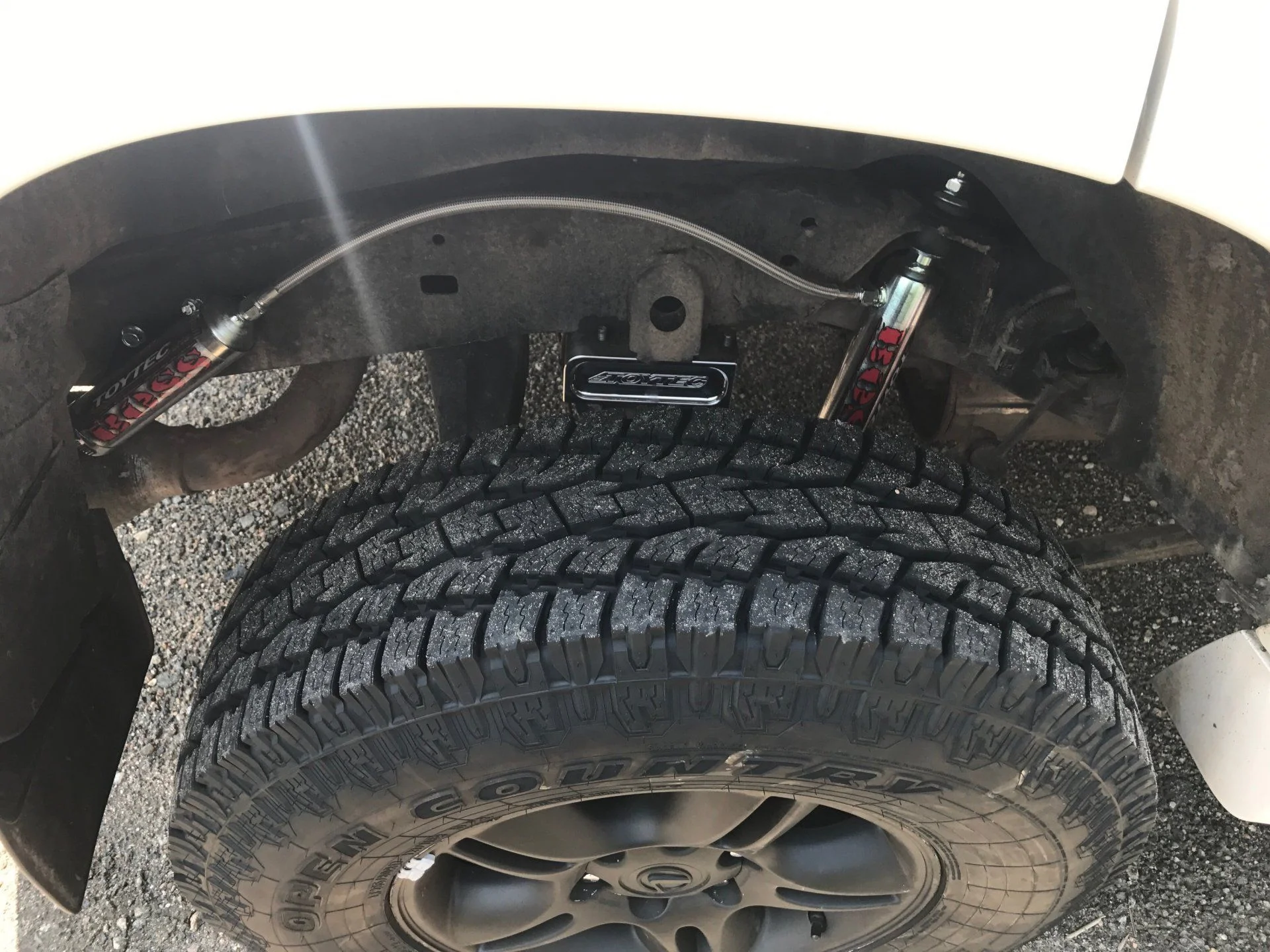

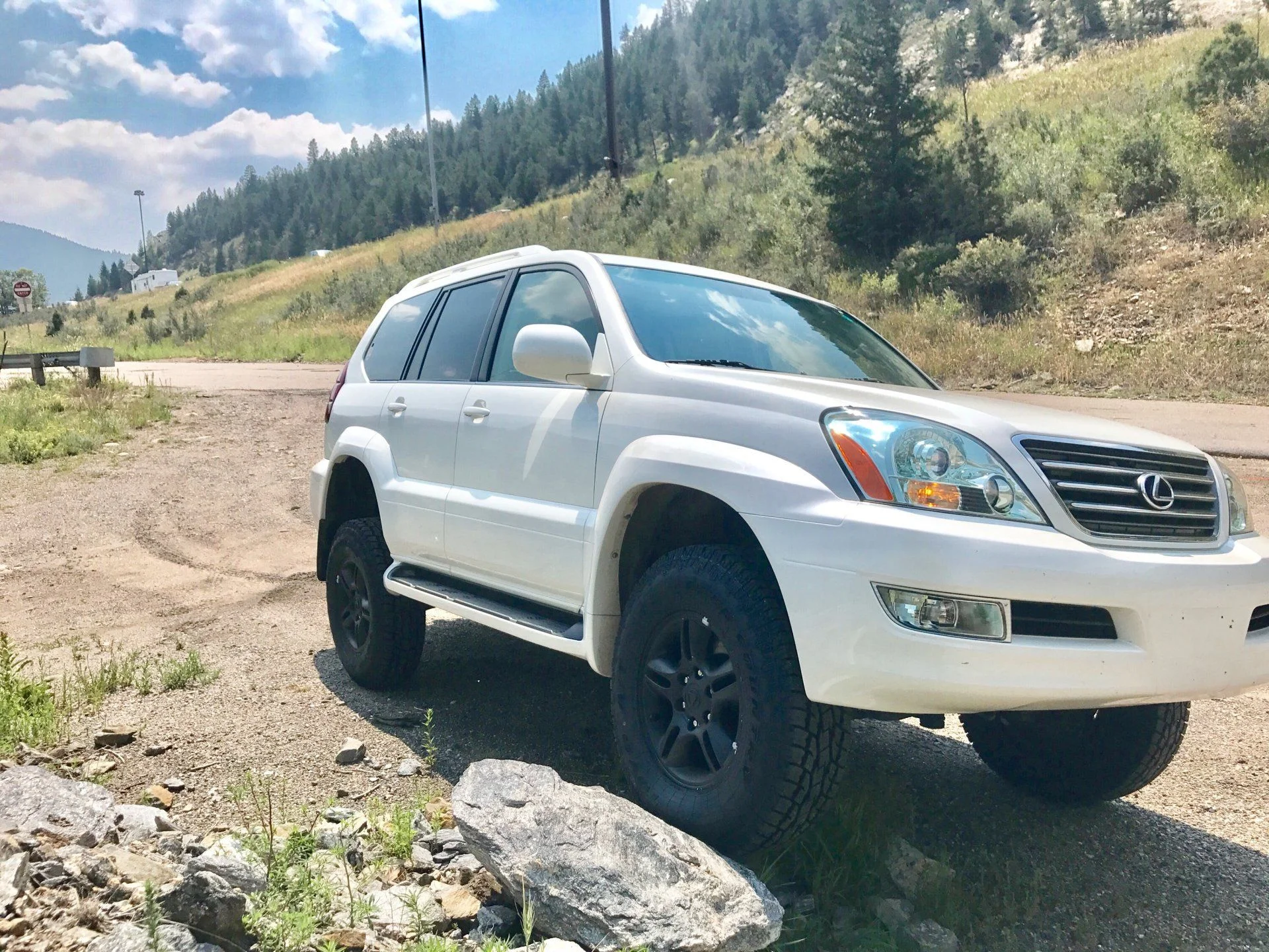

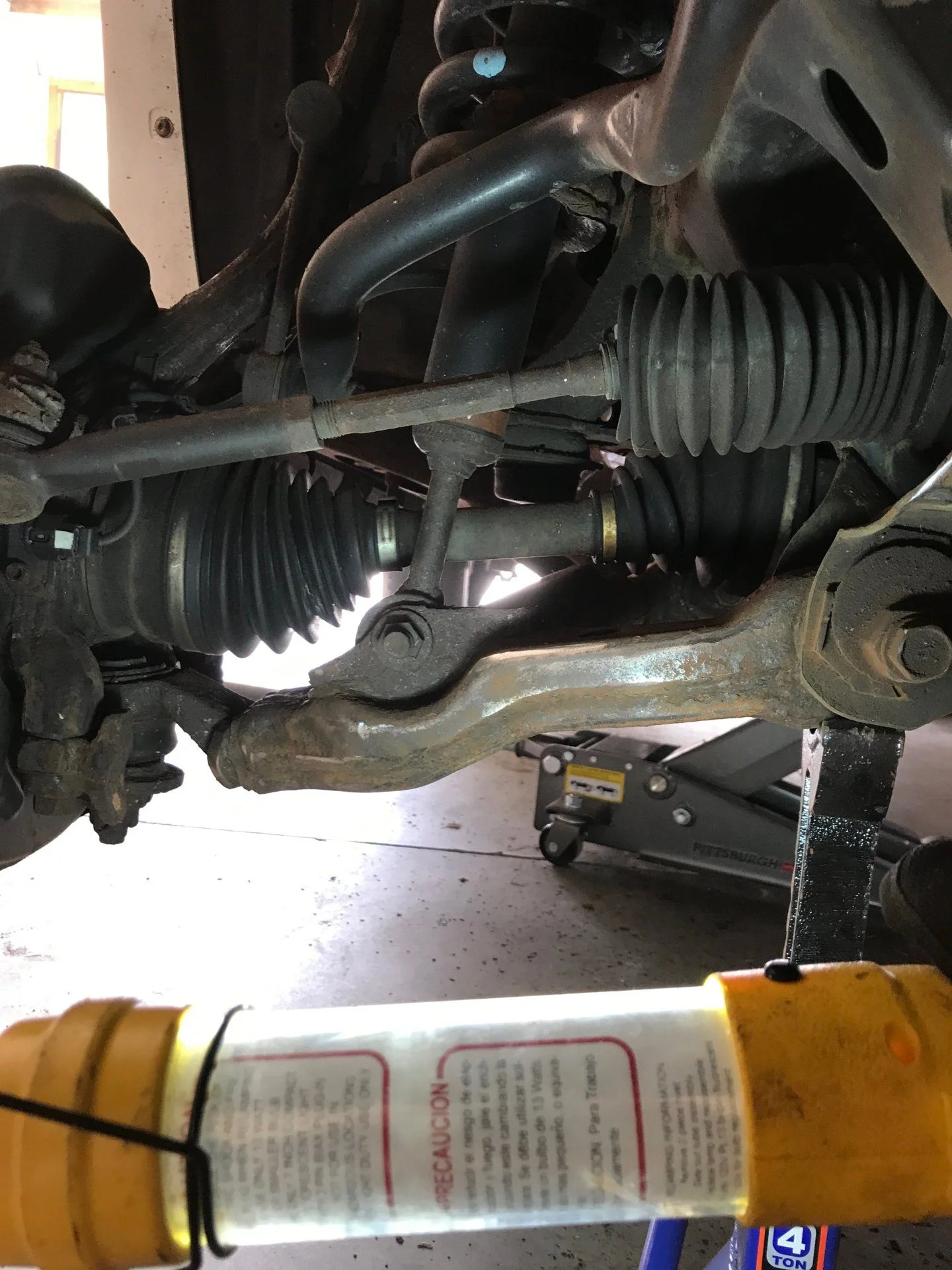

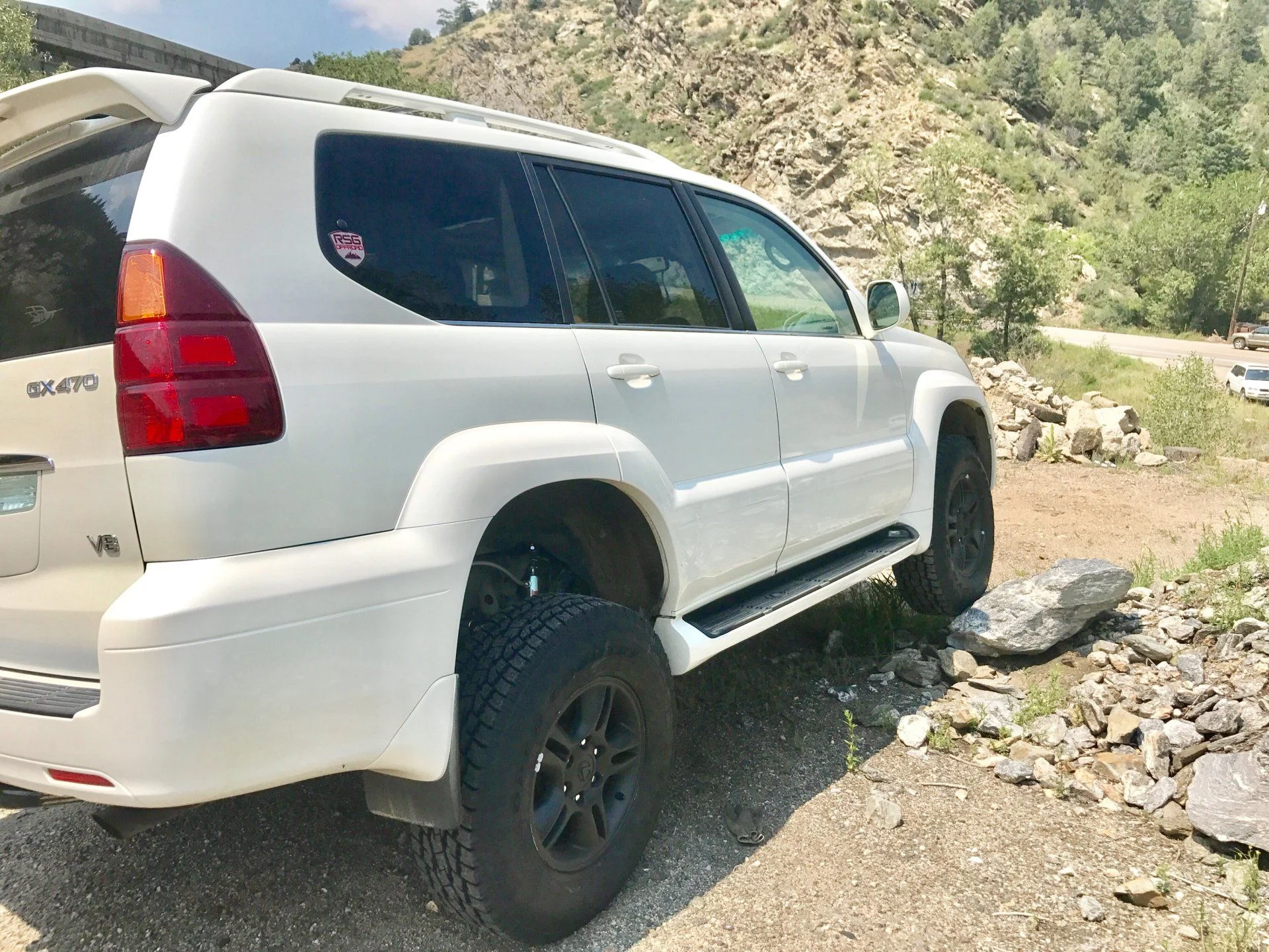

Went to RGS off-road in Lakewood,CO for the lift install. I couldn't be happier with the job they did. Toytec Boss 2.0 with upgraded rear shocks (reservoir), HD coils, SPC adjustable UCA's, and Toyo Open Country AT2 255/80r17 tires. While they were in there they replaced the sway bar endjoints which were shot. The vehicle rides better than stock (no body roll, excellent dampening) and the OC AT2's ride super smooth and quiet for a 33inch all terrain. The speedo was off by 4.1 mph at 60 mph which is easily fixed through the nav calibration menu. Next the running boards will come off and sliders will go on. Looking forward to hitting the trail.
Late addition: The 255/80r17 spare does not fit in the stock location due to the towing kit. That will be alleviated once a rear bumper is installed and the hitch package is removed. There was also slight rubbing at full turn and a triangle the size of a small slice of pizza was cut from the aft portion of the front wheel wells to accommodate.
