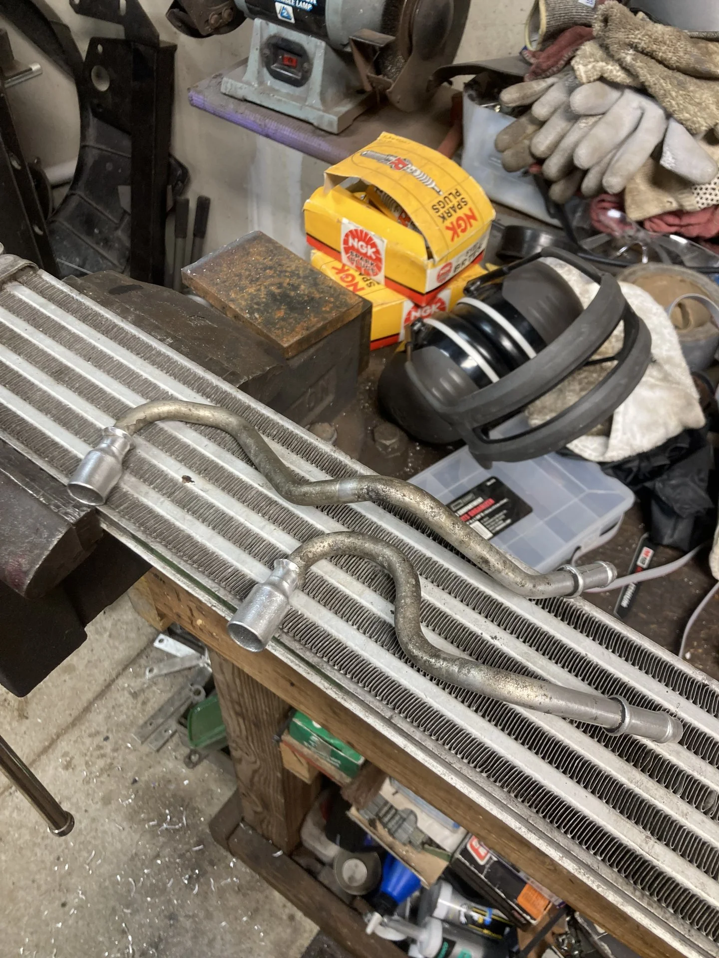

my new addition
before i was using power steering cooler from ford f150 , but i wanted more cooling surface and more oil , so i come up with this idea.
i m using hose hook up from ford f150 cooler it must be cut off , and new cooler is of Volvo xc90
all i did solder tubes to Volvo cooler and it fits perfect in between Toyota frame
