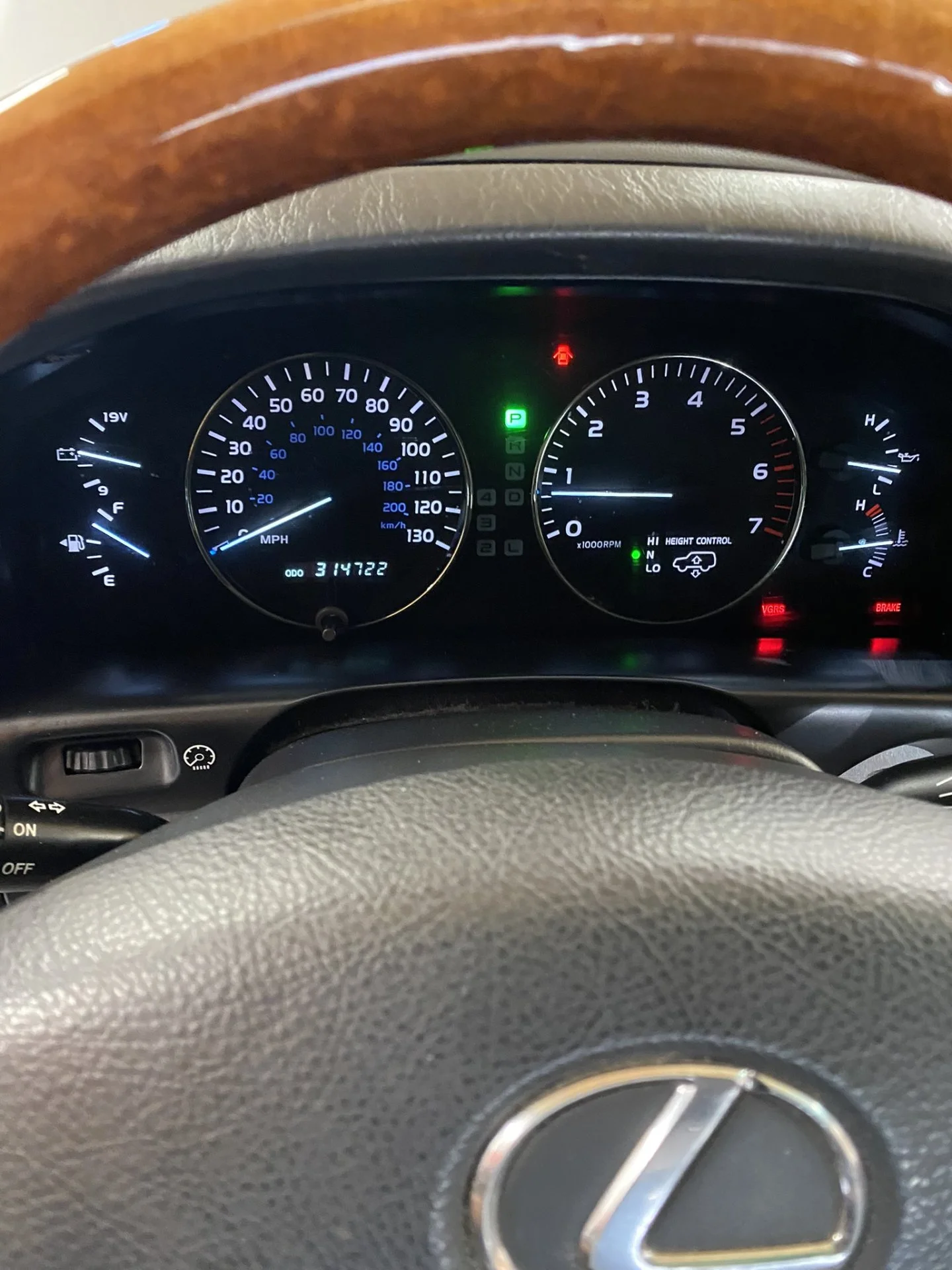

I recently encountered the constant VGRS light and off-center due to a dead battery. The light would not go off. I tried straightening the wheel and removing the battery cables for >10 min to no avail. I then tried jumping pins 4 & 12 of the OBD port which did make the Trac control & VSC blink, but the VGRS light remained constant.
Anyhow, The next day I decided it would just be one of those things I’d deal with at a later date and after driving it around a little while (10-20 min?) I noticed the steering wheel gradually went back to a correct on-center angle and the VGRS light later shut off by itself.
May not help those whose VGRS has actually gone out, but for anyone who replaced a drained battery, this might offer hope lol.

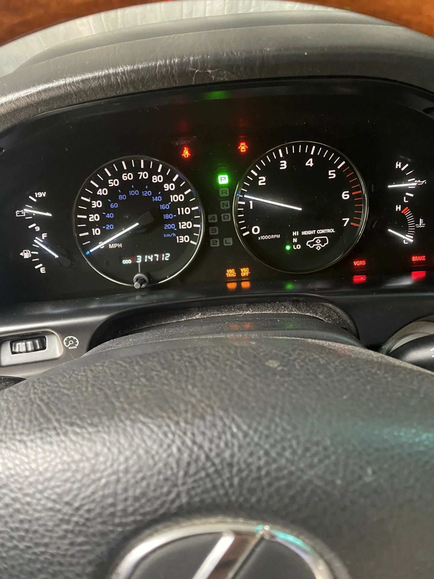

I've 03 LX470 with dash warning lights VSC TRAC & VSC OFF along with VRGS on. DTC C1289 C1568 found in tech stream. Steering wheel not centered ( left of centering ~30 degrees) automatically after battery disconnect, nor VGRS light going off. I've yet to work on it, for these issues! As i'm working my way through many from improper maintenance.

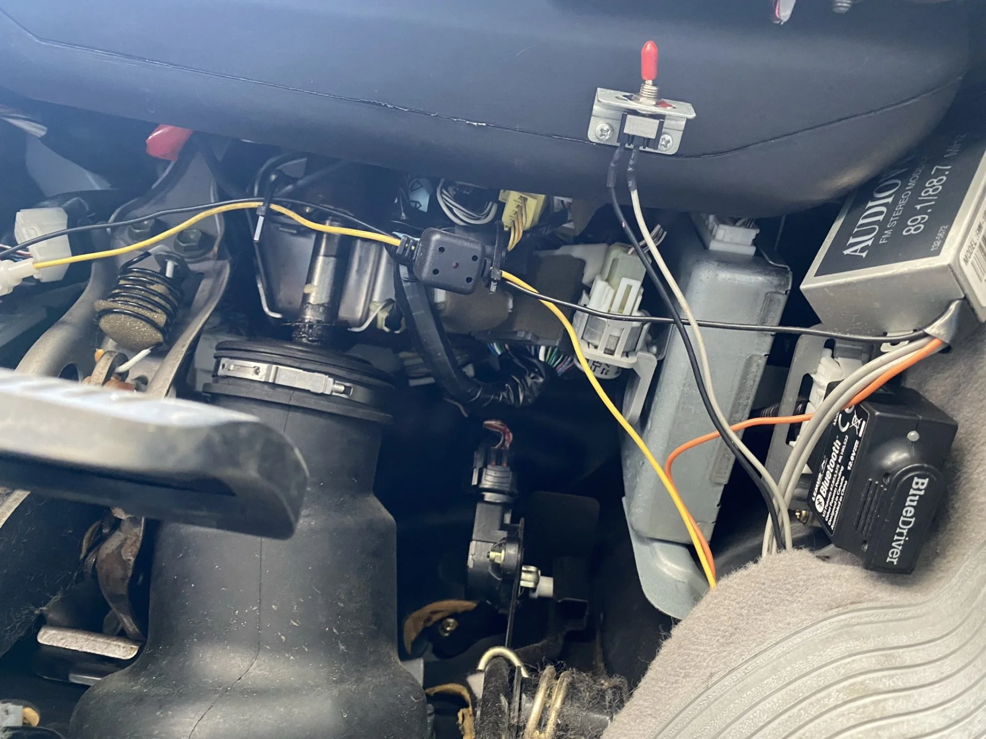

But I did spent my time (a lot of time), removing the non factory wiring. Which some were "port" or "Dealership" installed, like old tech cell phone hardwired. Other stuff like Laser front and rear radar detection gear, may have been 3rd party. But radar stuff was integrated in phone stuff. DVD on other hand, look to be installed by third party (not at port or Dealership), from looks of it. Also a NAPA battery tender. Hummm battery tender! :hmm: Not surprised with non factory wiring junk.

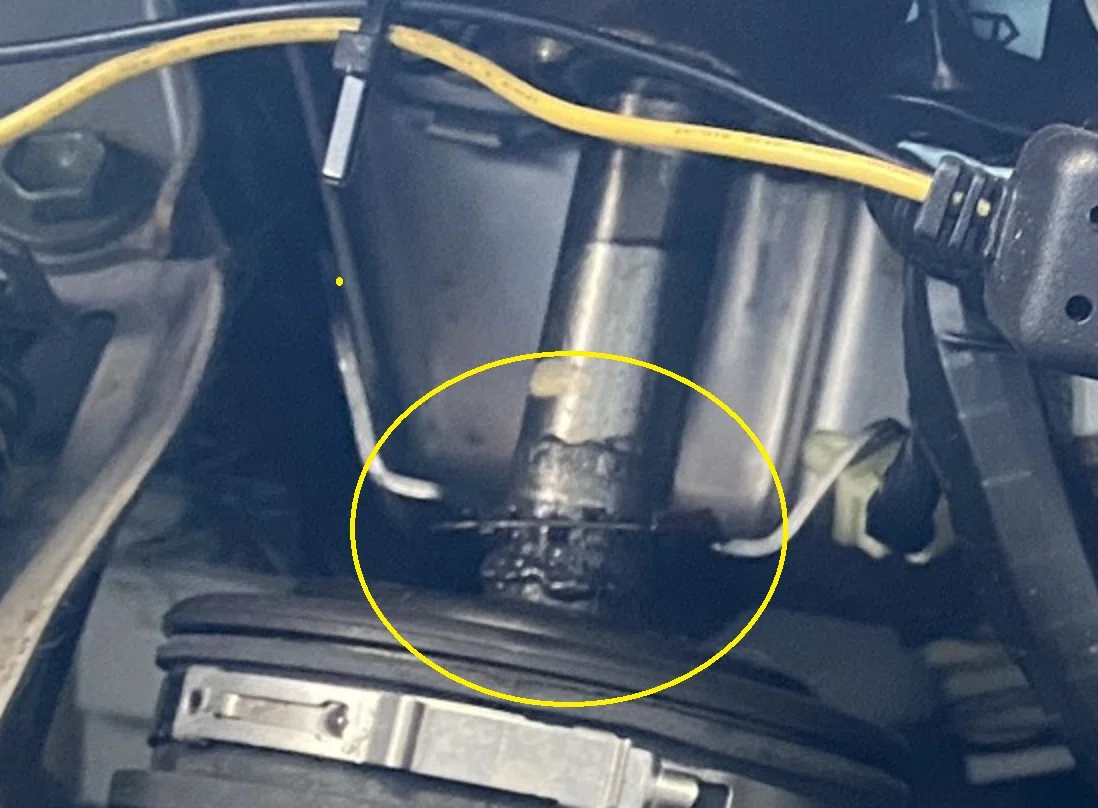

While pulling non factory junk from under dash. I noticed a locking washers loose on steering shafts near VGRS black boot. It appears to be the one involved in the TSB where steering wheel shafts can become disconnected. Yikes!

Found it, unplugged center cable, went for a short drive, Vsc lights still on.
That sucks. A couple things you could try -
  • Attempt to clear codes again
  • Bring up the data list for VGRS and see if you can identify what isn't working (assuming anything works at all)
  • Disconnect ALL the plugs at the AHC ecu and clear codes and see what happens. I have heard that you can unplug everything and remove the ECU and the only side effect is the VGRS light but I haven't tried it so I have no direct experience with what will happen.
Sorry! Wish I could help more but I just haven't been in your shoes. Hopefully you can get it resolved without a crazy expense. I agree - I wouldn't be dropping 7k on a system I don't particularly care for in the first place.

It is very important to get the VGRS recall taken care of, in any event.
TSB for the VRGS, letter to owners states:
The construction of the steering shaft is such that the snap ring on the shaft may disengage when the vehicle experiences an unusually severe impact to the front wheels (for example, striking a deep pothole in the roadway). If the snap ring becomes disengaged and the steering wheel is then repeatedly turned to the full locked position, over time the steering shaft may become disconnected which could result in a loss of steering control and thus increase the risk of a crash.
My 03 LX470 Lexus (not yet road worthy or plated) has open 3 recalls (DRL, VGRS & Air bag).
My 07 LX470 has/had 1: (VGRS). Which it's service history, indicates taken care of. Which I need to double check with Lexus I'm interpreting correctly.
DESCRIPTION: STEERING CONCERN ~|~C/R STEERING RECALL ~|~UPDATE STEERING BRACKET ~|~PERFORM SSC ALF CAMPAIGN
It is same statement I find on other 03-07 LX470 history. At Lexus Service History | Lexus Drivers - https://drivers.lexus.com/lexusdrivers/service/history
Inspecting my 03LX. I see minor front bumper impact, the kind that happens in parking lot. No signs of ever repainted any areas. The only clue of possible impact that may have dislodged the snap ring. Is one wheel paint is much worst than other 3. Likely it was the spare. I need to take a close look at the spare (hanging under cargo area), to see if it looks like it took a hit (bad pot hole) or not the factory wheel.
But it could be just time and miles without sever impact, snap ring came loose. This 03 LX470 also has some braking issues. Can you imagine if steering was lost, brakes then air bag failure. o_O
Makes one of the safest vehicle on the road, a killer!

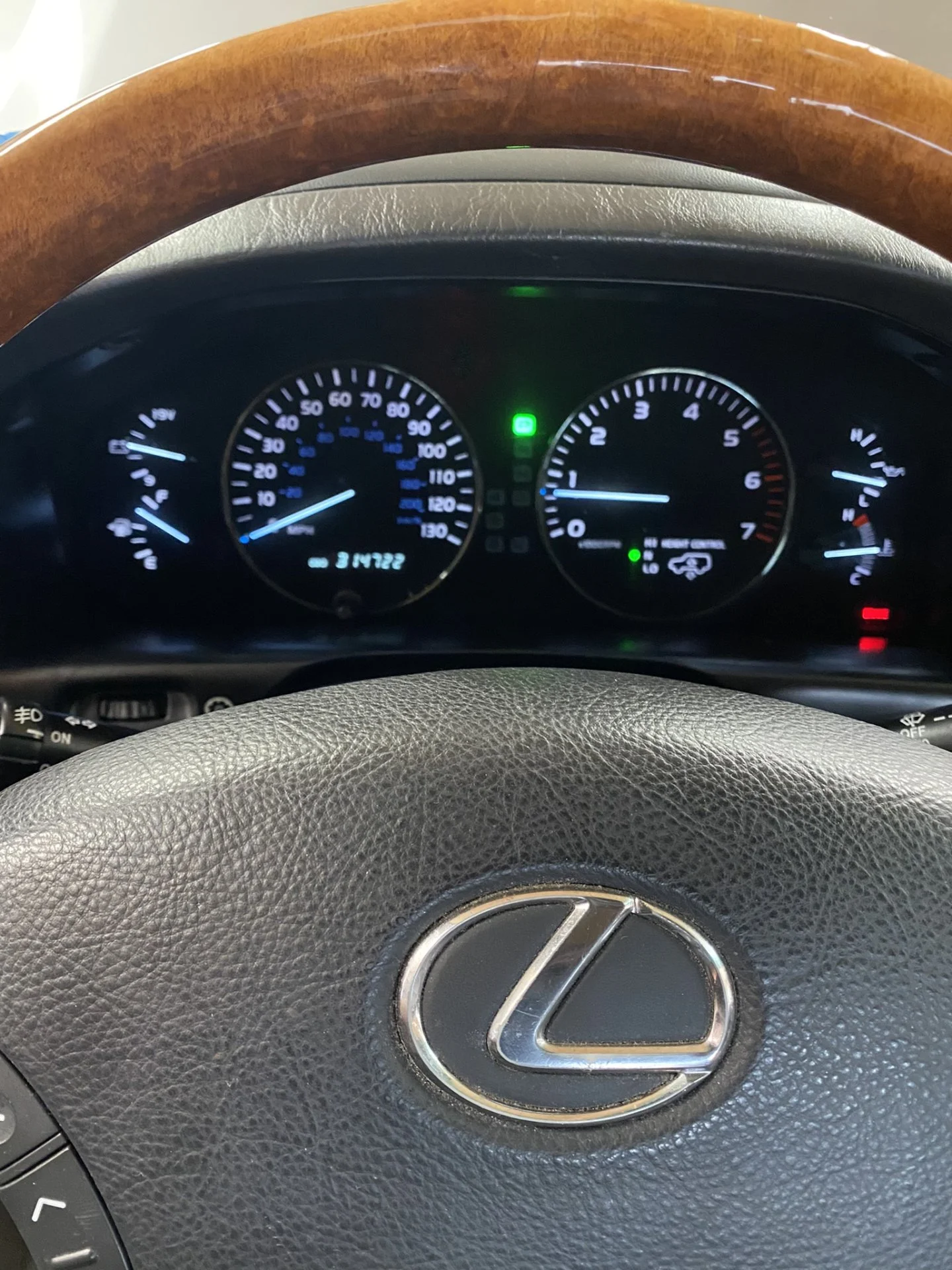

So update on the 03LX pictured above with dash lights VGRS, VSC.
After recall work done by Kuni, no VSC, but VGRS was still on.
Once back to my shop. I went through tech stream into: VGRS live, Utility, Steering angle adjust. Followed prompts. VGRS light is now off. Steering "seems" (need to drive more and get on HWY) wheel centered.

Is when, I spotted the VGRS steering snap ring was out of position (picture back a few post). Interestingly the steering wheel was about 30+ degrees off centered also. The steering rack & pinion is a replacement R&P,. R&P is painted black and been in for some time by the looks of it. Paint all black, means I can not see the color code strip to determine if a Lexus VGRS R&P or not.

  1. VGRS snap ring (picture above show, snap ring had come loose), very dangerous!
