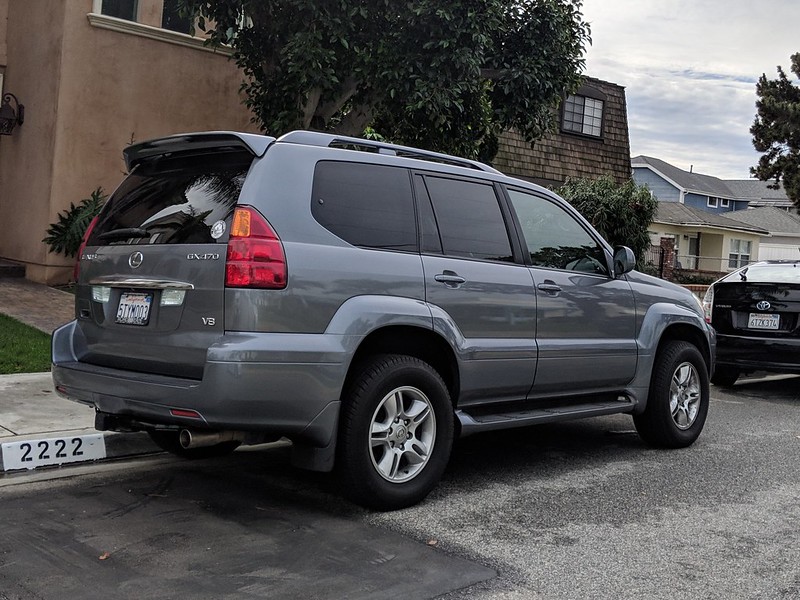

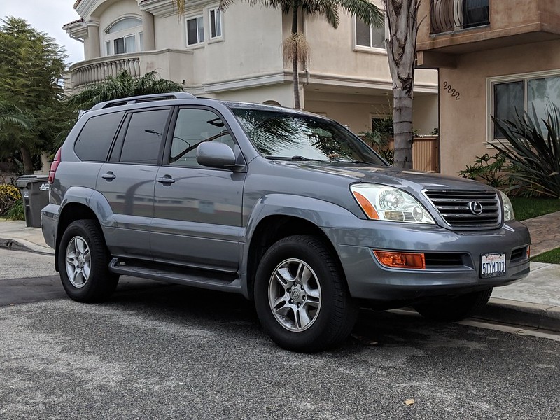

Finally got serious about getting a Toyota 4x4... After much deliberating, dove in and got a 2006 GX470 Nav with 153K miles on it, bone stock at the time of purchase. It's a CA car, so undercarriage looks good, and pretty clean overall. Compared to my wife's '15 GX460, it's a little crusty, but hey, that's to be expected!
Since I got it, here's what's been installed:
- Falken Wildpeak AT3/W's in P285/70R17
- Dobinsons Suspension kit w/2" lift (thanks to Kyle over at Treaty Offroad for the parts)
- SSO rear coil conversion
- New OEM LCA's (for the new bushings)
- SPC UCA's
- New OEM inner/outer tie-rods
- New end links (MOOG front, Dobinsons rear)
- New-ish front interior door panels
- Android Headunit
- Black Prado exterior belt mouldings
- G2 1.25" wheel spacers
- RAD Rubber splash guards
- Lamin-X amber foglight stickers
- High performance Treaty Offroad and GXOR stickers! Probably some ih8mud ones too :)
Eventually going to do the standard running board chop, and likely chop the bumpers a little too. A little worried about chopping the running boards since the kids need them to get in and out of the rig.

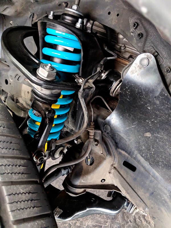

2. when i was under the front drivers side fender, replacing the rubber splash guards, i noticed that there was some seepage around the engine... i'm not too well versed with the layout, so i'm not really sure what i'm looking at. here's a pic, where you can see it (right in the middle or the pic):
i would start looking at the valve cover gaskets....unless they have been replaced recently i would almost guarrantee they are leaking or dang near leaking. easy enough to run your fingers around the valve cover edge....
