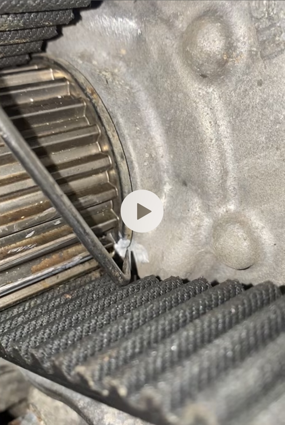

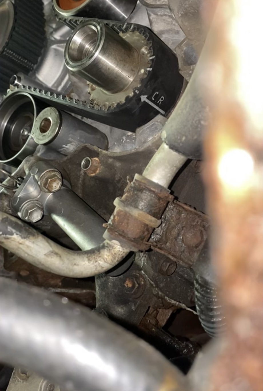

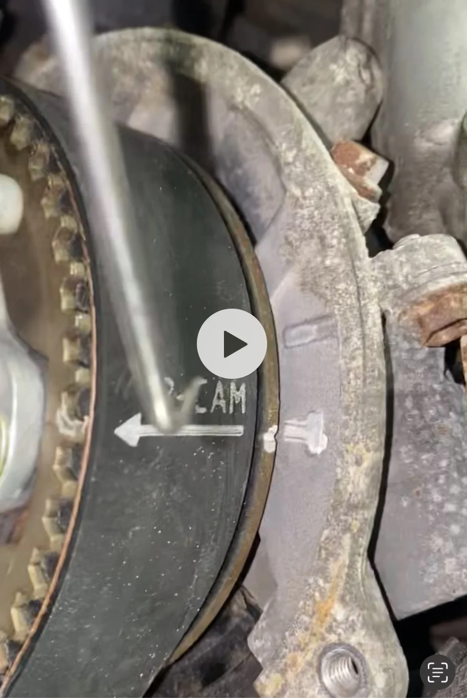

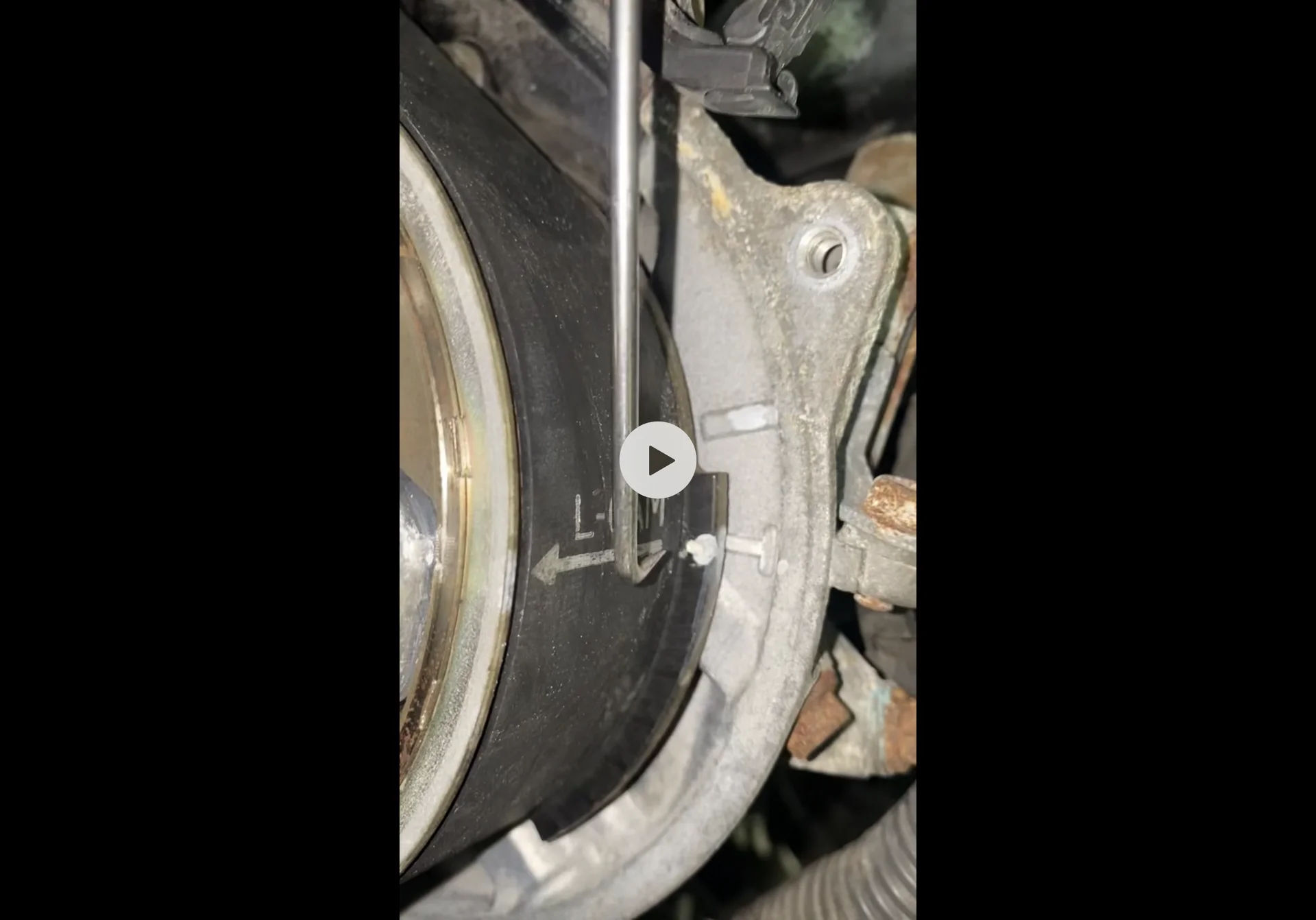

I had the timing belt done on my 4Runner and the mechanic sent me a message that it has a CEL on and is throwing the P0011 Code. He provided videos of the timing belt and everything appears to be timed up well and that the belt is tight. See below.
Here is the left Cam
Right Cam
Top of the Crank
Bottom of Crank
Is there anything in these pictures that looks suspect? It all looked good to me, however seems like the P0011 code could be related? He also did an oil change with high mileage full synthetic. Could it be the camshaft position sensor? Any knowledge from the experts would be appreciated.

Yeah timing. I just did mine on a 2005 4runner and fyi you can use the "T" marks for replacement.
But for checking timing you use the lines as shown above

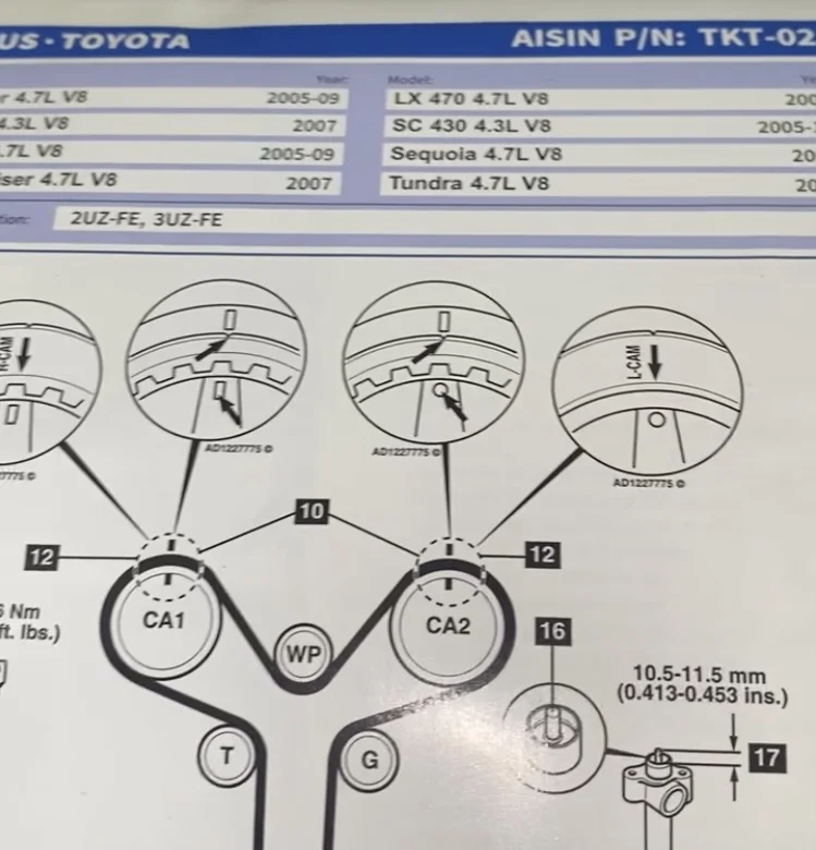

Honestly it looks like gnob is right and the Aisin kit that was used called out the “I” as the timing mark and not the “T” as shown in my other pictures. Did your kit call out the T instead?
Assuming the timing is off would there be an obvious issue with how it runs if it’s only off by that much? Also if both cams are off wouldn’t I expect another code like for the other bank?

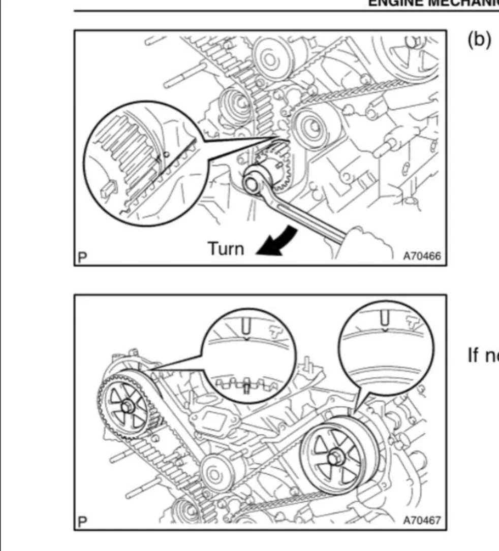

I've seen lots of conflicting info based on years but I followed this on my 05.
There's a difference in the terminology. To check timing at TDC use the notch on the crank pulley to 0 and the marks shown above by gnob. Start there and let us know what you find.
That’s it, is off at the crank. The dot should be on the mark and the two close marks should enclose the bolt hole when installing. He had the crank at TDC with the cams advanced to the timing marks.
