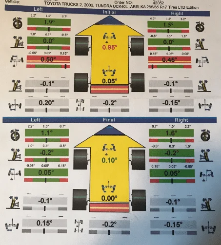

@gnob Here are the before and after alignment numbers. It doesn't pull or anything, the steering wheel just has a slight shake. I took it to the Toyota Dealer who also said wheel shake is most likely due to tire balance. The tire shop re balanced them and I asked them to check that the tires are true, but there is no change. The strange part is that it was the same shake with the old tires and with the new tires. The only difference were the shocks, tie rod ends and alignment. The truck was smooth as could be before that stuff.

Appreciate the feedback! All is good now! I ended up going to the dealer to have the stud fixed, and I had them do an alignment as well. They said the caster was off and the toe was slightly off. Glad I bit the bullet and went to them. I’d hate for my new tires to not last.
