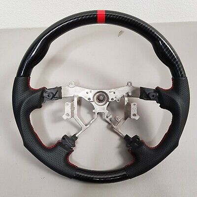

@Timonek Need a link to that steering wheel!
This is not gx model but this is seller that sold mine so contact him he has tham all the time but i dont see them now in his listings.
