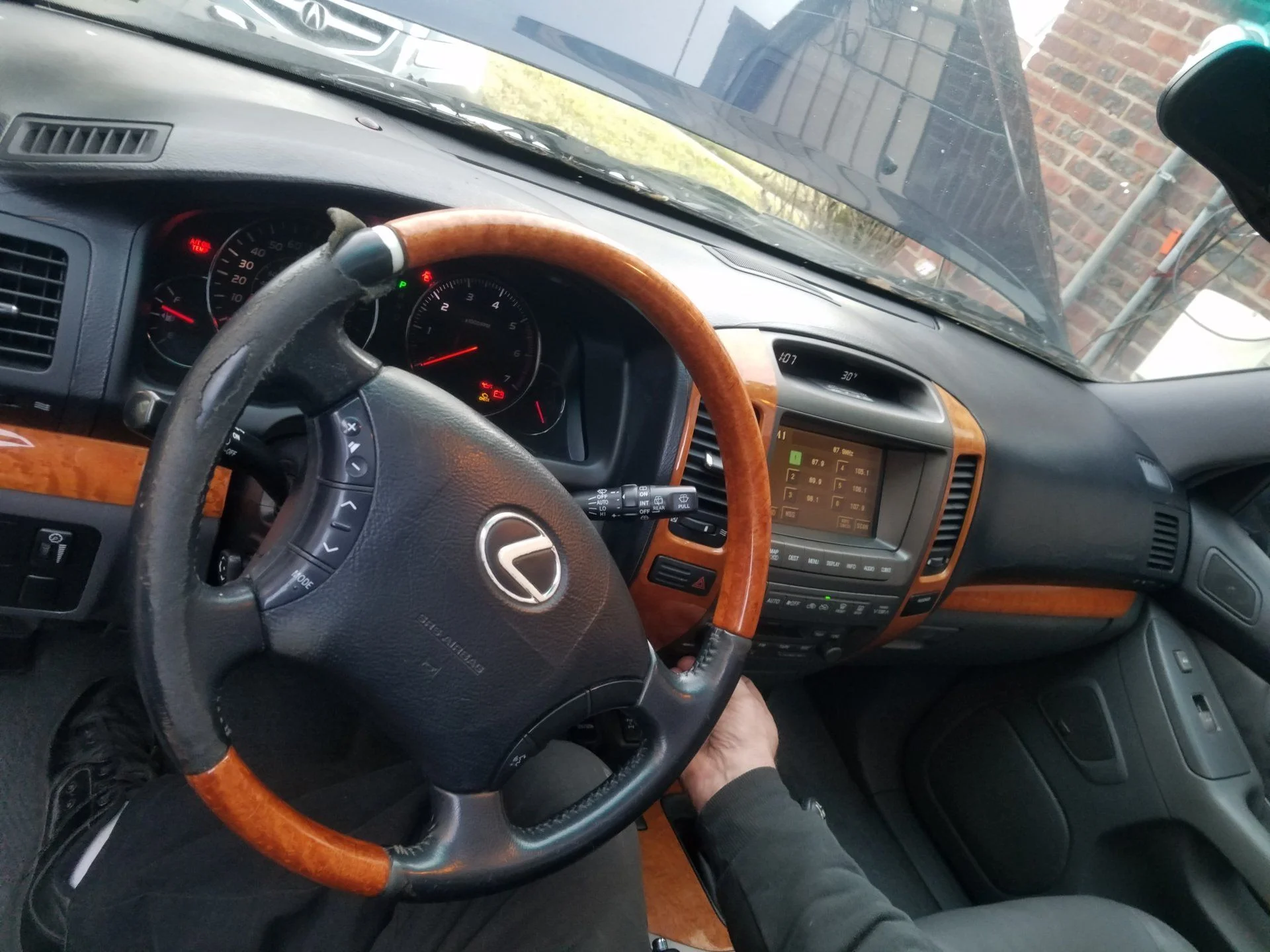

secure key icon that blinks red, when I insert key it blinks, when cranking still blinking. Is this red light shouldnt go off when You turning key and crank?
Im thinking maybe due to time car doesnt recognize key ? but on other hand, when key is inserted steering wheel moves all functions works, even air compressor working for few seconds ( probably adjusting pressure )

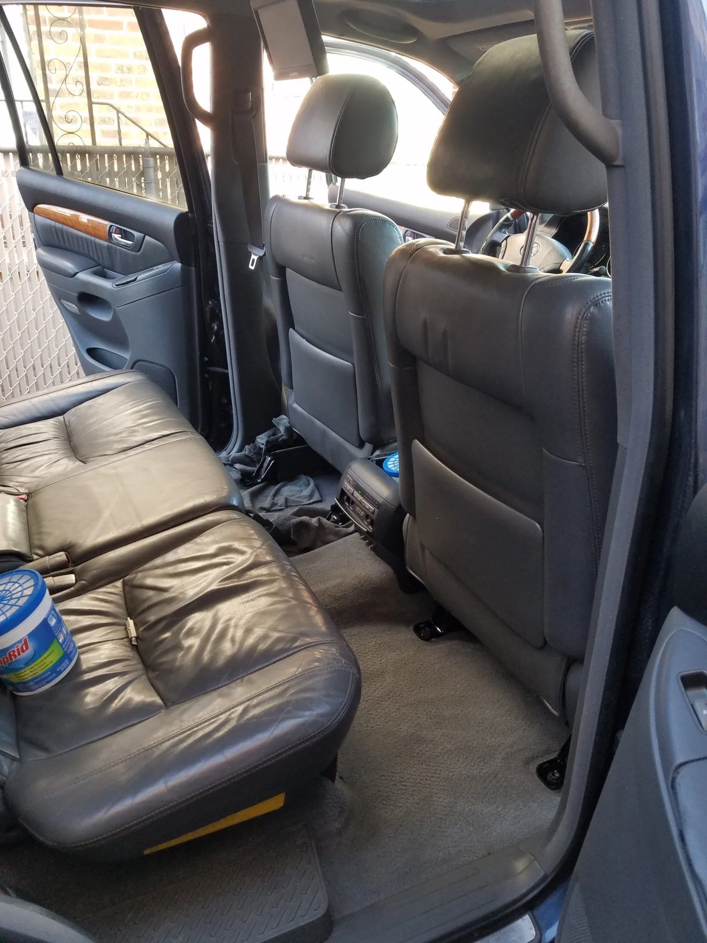

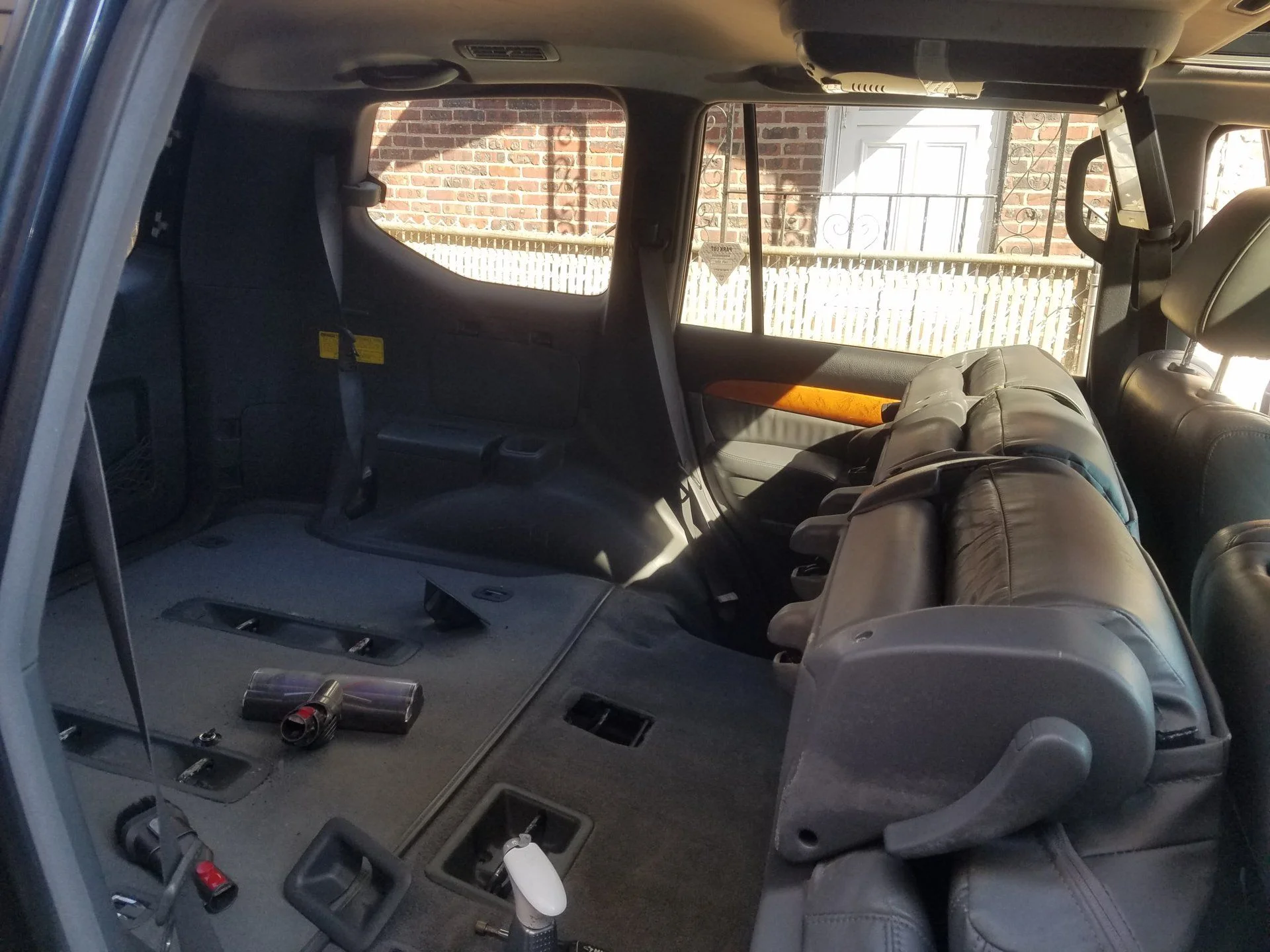

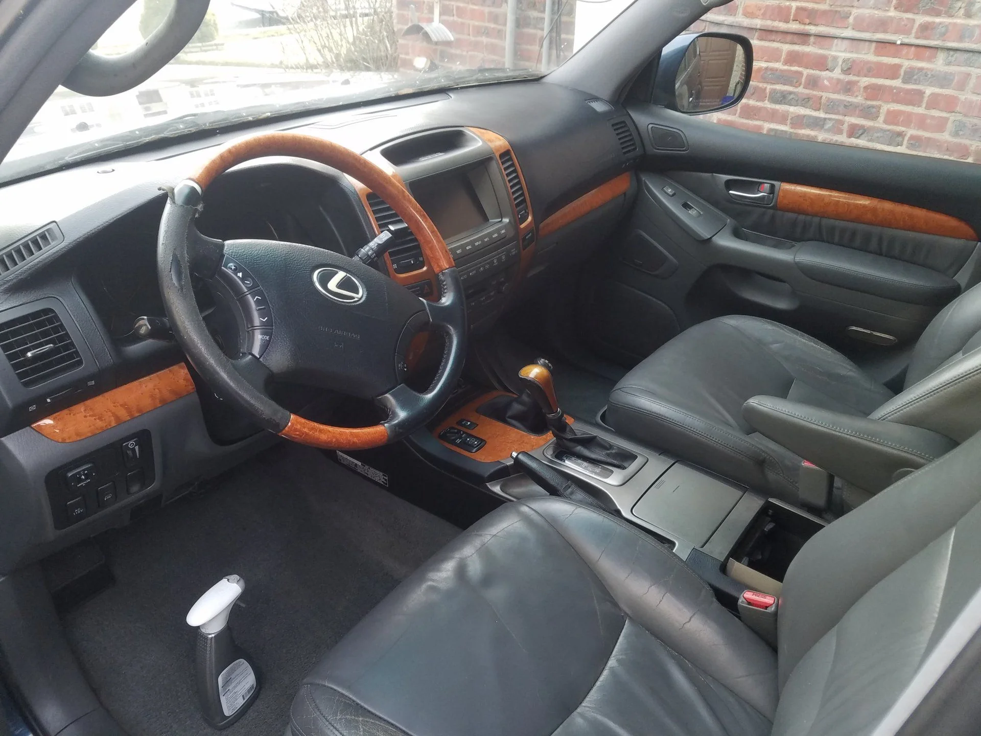

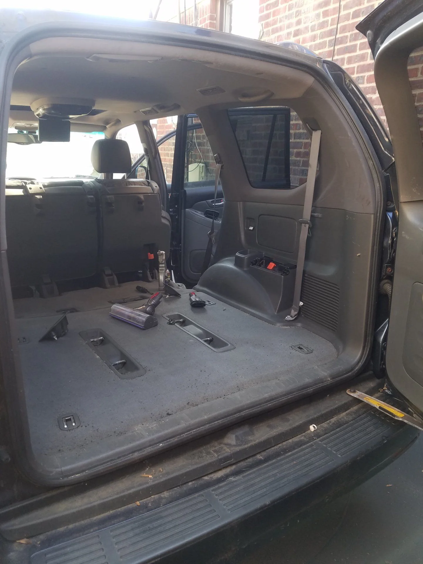

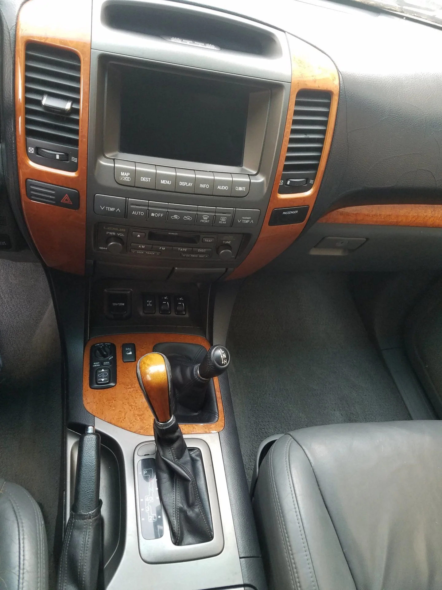

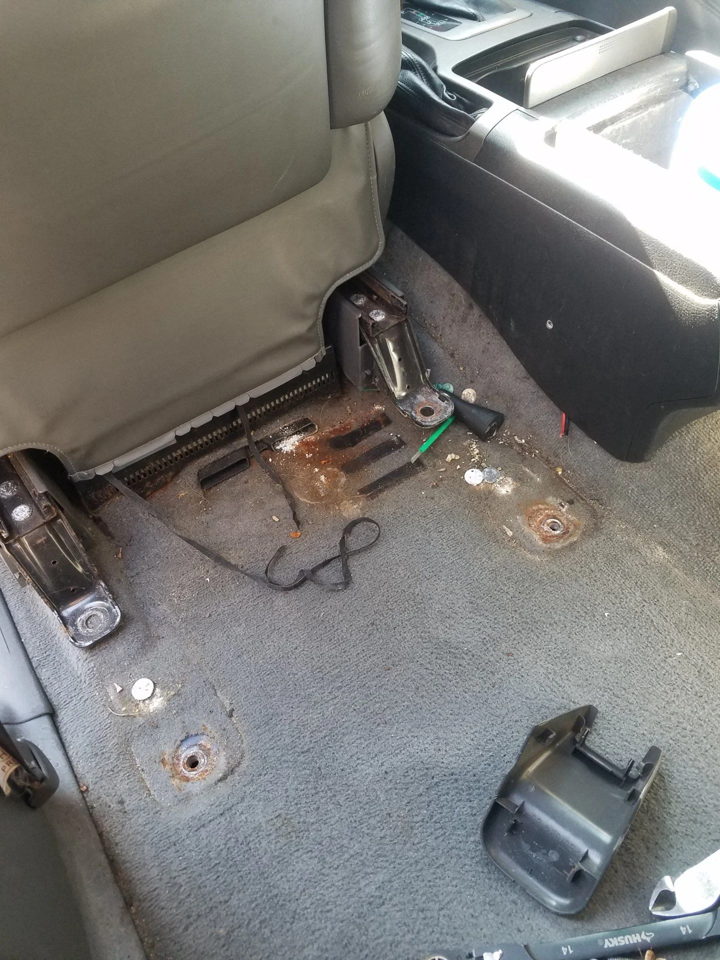

it is it is. :) I spent saturday on interior cleaning, lot of work, car is 17 years old so i expected it but it wasnt that bad. enjoy !
