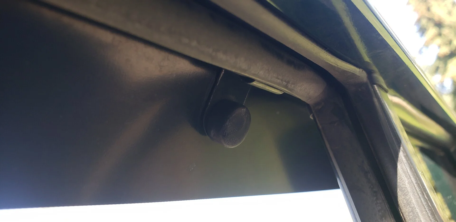

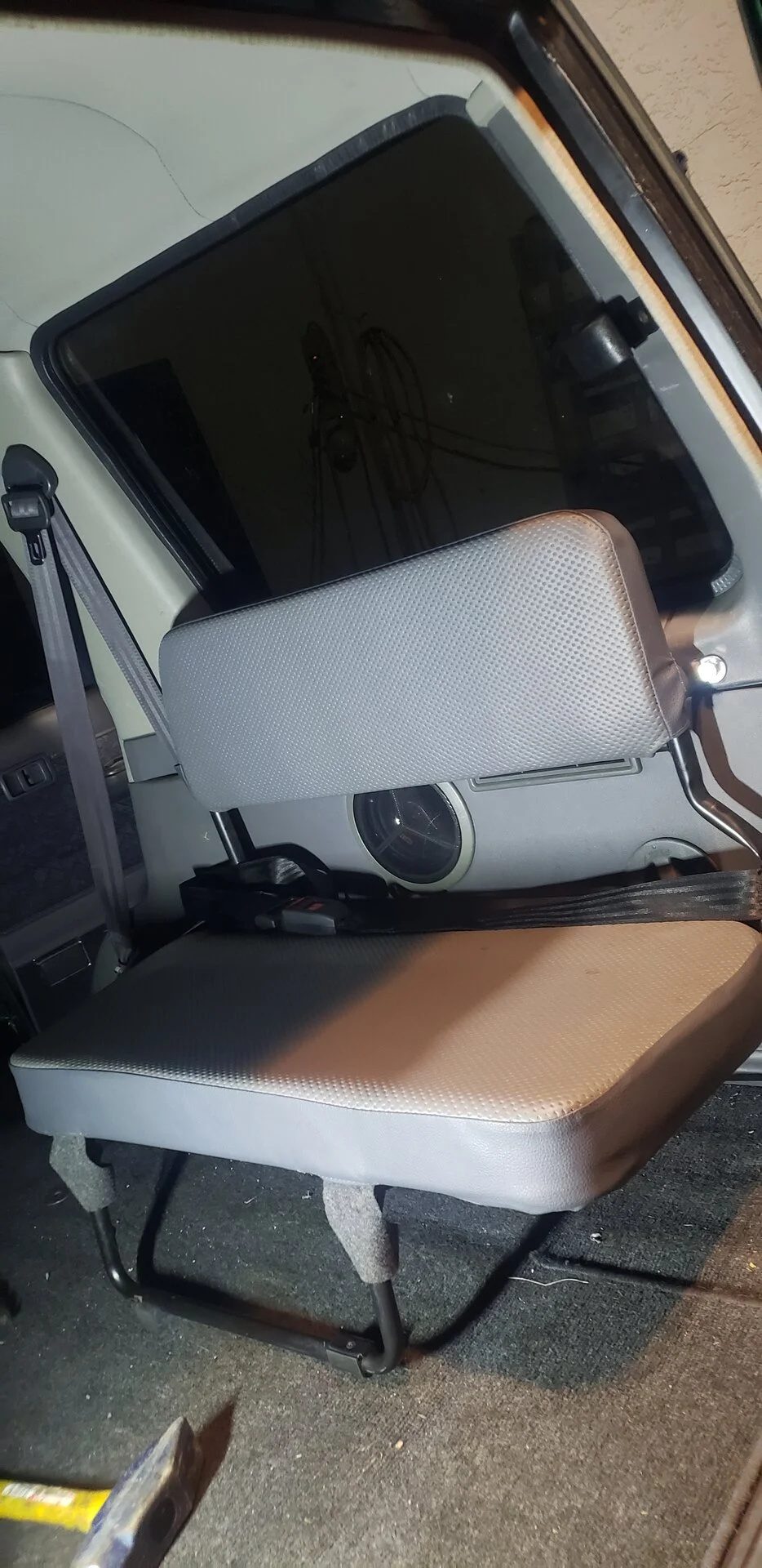

Install of the seat went pretty quick as well
I think these seats are technically able to fit 2 people side by side on them, but I only installed one seat belt as I really don't think I will have a need to haul 9 people.
Folded up. I seem to be missing the little strap to hold the seat up and the leg down when not in use, so I just used a bungie for now.
All in all, it was quicker and easier than I expected. Unfortunately there were no captive nuts in the body for these seats like I was hoping for... hence the nut-serts.
Perhaps the strap is available separately.

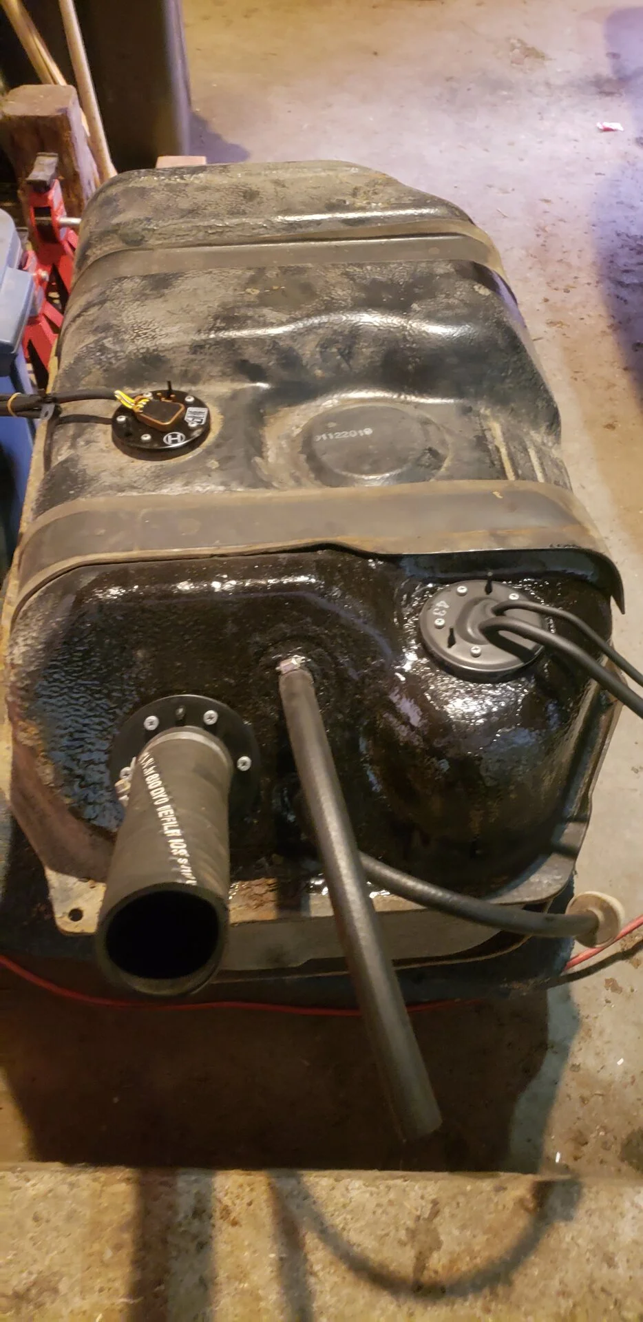

Spent my lunch time putting the new pickup in the fuel tank, last part to getting this ready to re-install. Took about 5 minutes or so fuddlemucking around getting it in the correct position because of the baffles in the tank. I suppose one could say it was (dare I say it?) somewhat "baffling"... cue groans here.
All internal/external parts replaced, whether they "needed" to be or not... one of those "while your in there" moments. I do not want to pull this tank AGAIN for another 20 years or more. The actual problem replaced:
New filler hose and tank connection, plus new hose on the expansion breather:
New fuel gauge sender:

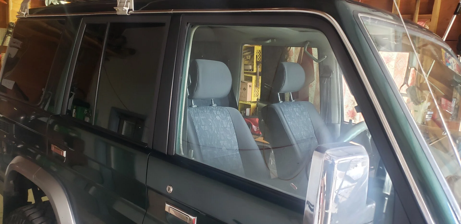

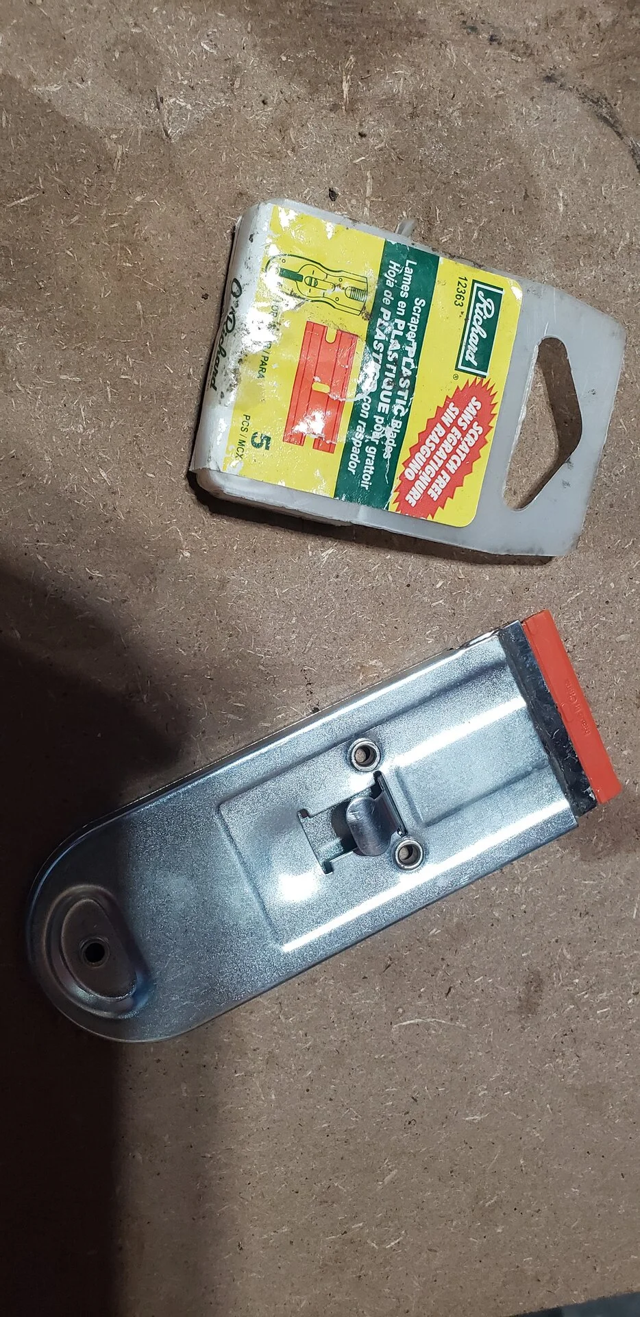

The easy part (yes - EASY) is removing the deflectors. They are secured using 2 sided tape and a christmas tree style plug onto clips. Normally, one would lift the tab on the top of the christmas tree plug to remove, but these are "sunny side up" and pretty brittle, so I removed the bottom side with a small pry and pliers.
my tools I used
There are 2 on the rear windows, and one "permanent" one on the rear of the rear window. The 2 front windows have 3 to remove.
Once they are all off, I used a "plastic upholstery knife" to cut the 2 sided tape. I began at one edge and with just the thickness of my fingers I would follow along behind pulling it away and creating the space for the knife to saw through the tape. End result was about 5 mins per window and they were all off intact:
If anyone actually wants these, you are welcome to them free of charge. Just whatever shipping would be? You would need to purchase new plastic plugs and 3m 2 sided tape, but I saved all the clips. Mark the date of this post, because if no one is interested I will not store them - they will go to the recyclers.

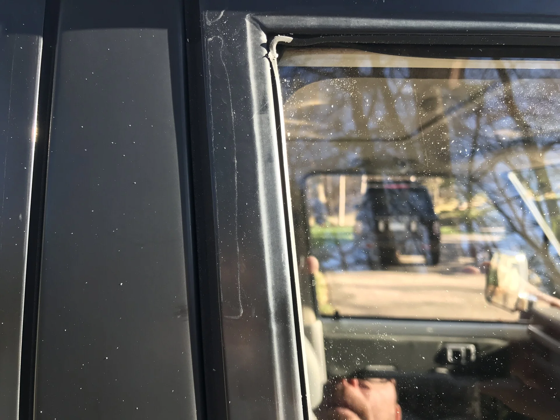

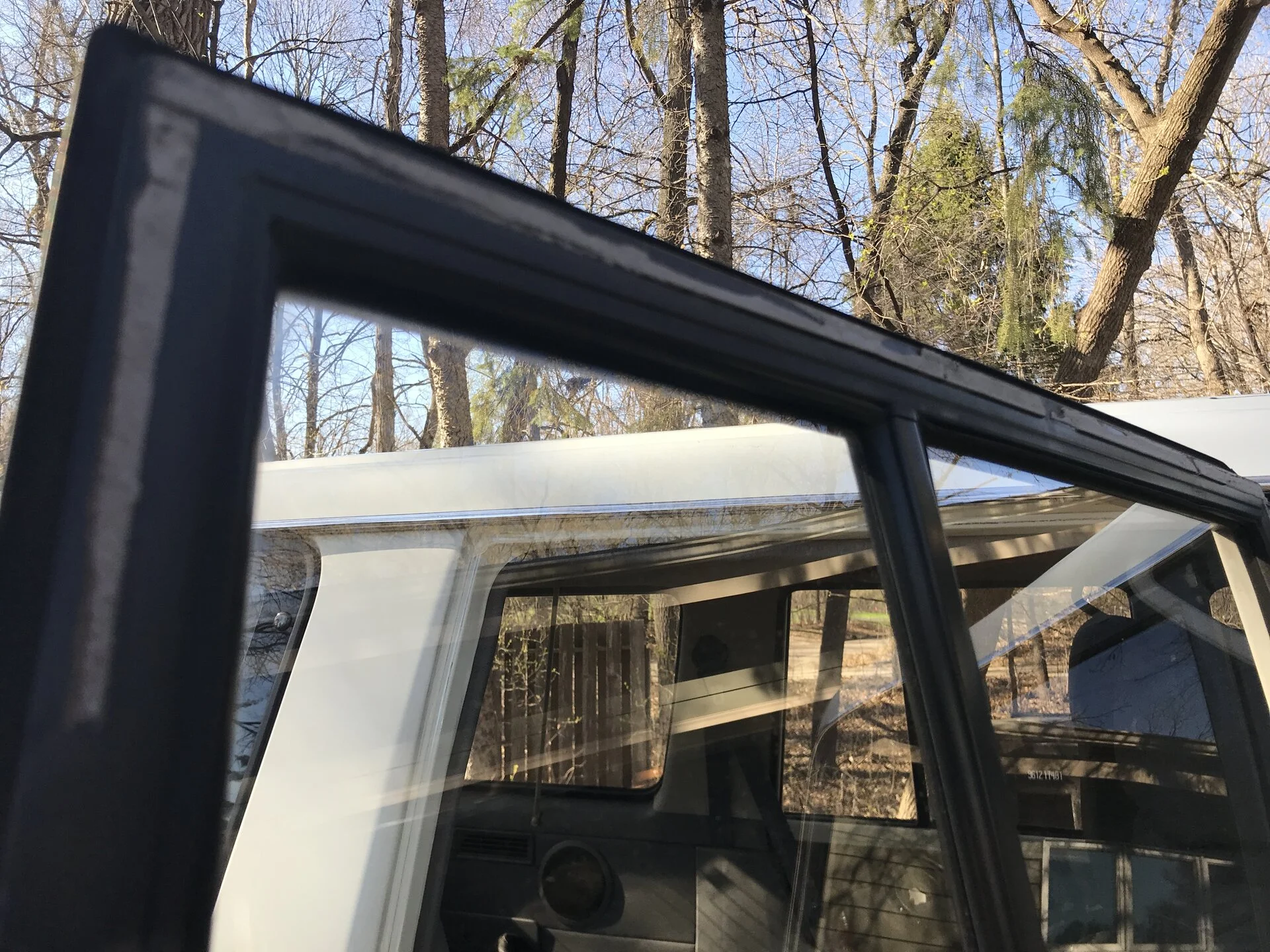

Now for the hard part... getting the nasty tape and glue residue off the doors. My initial thought was heat and a plastic blade to scrape it off... well, that was a great idea in theory, but in practice it just made a gooey mess and spread it around more than remove it.
The idea was to minimize the amount of damage to the finish on the door using a plastic blade. However in practice, this was just not feasible as it was just making a big mess. I quickly discarded the heat idea, moved the cruiser into the garage and out of the hot sun.
I swapped the plastic blade with an actual razor blade, consequences be damned. With a deft and steady hand you can actually cut the tape away from the door with minimal to no marking on the paint of the door. When the tape glue is not gooey from heat, it actually cuts away relatively nicely.
Now the harder part. After razor blading the tape and glue away, you are left with a relatively thin layer of tacky glue. I tried rubbing alcohol (evaps too fast), hand sanitizer (better, but still evaps pretty quickly), gasoline/paint thinner, before finally heading to the store and settling on this little wonderful product:
Spray this on, leave for 5 mins.
Those green plastic scratch pads for pots (don't tell my wife that it ended up in the shop) work GREAT at getting the glue off, but I found with the rubbing it was also taking the black finish off the door
So then I went back to the plastic blade in the scraping tool, and that became the MOP for the rest of the doors. A little cleanup of where the clips were attached will be necessary as well, so in the end I still needed to touch up the paint. The black that is around these windows is an odd color. It is not really FLAT black, it is not really glossy either, but something in between. I decided on flat for now and I can better color match it later, I suppose.

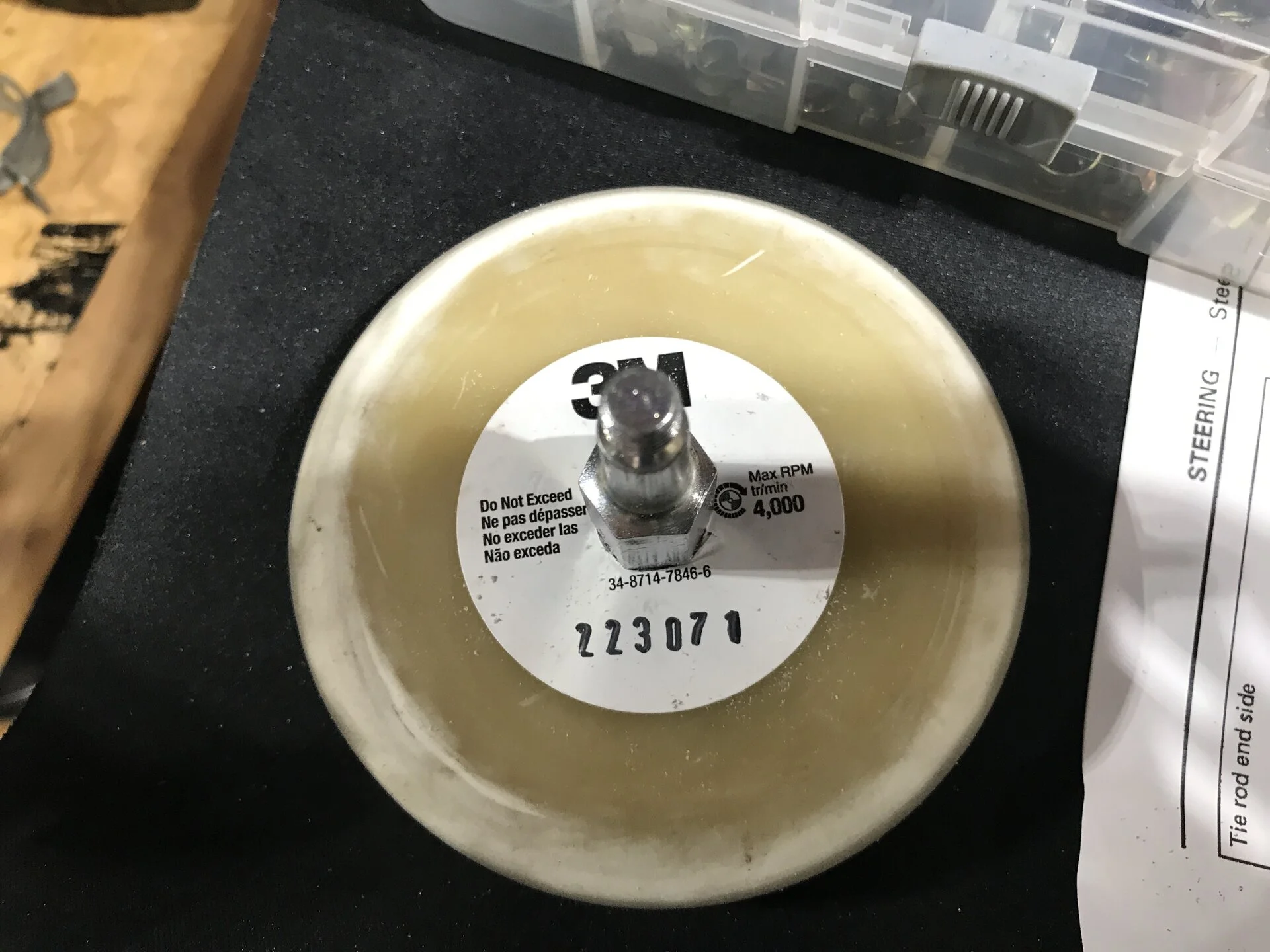

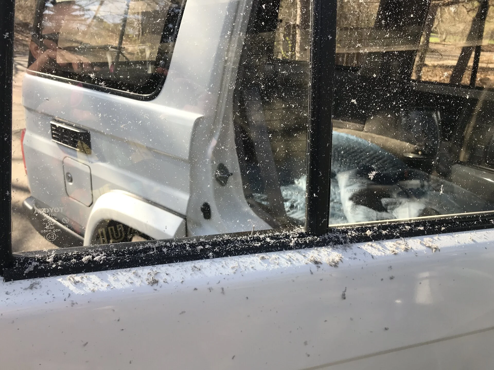

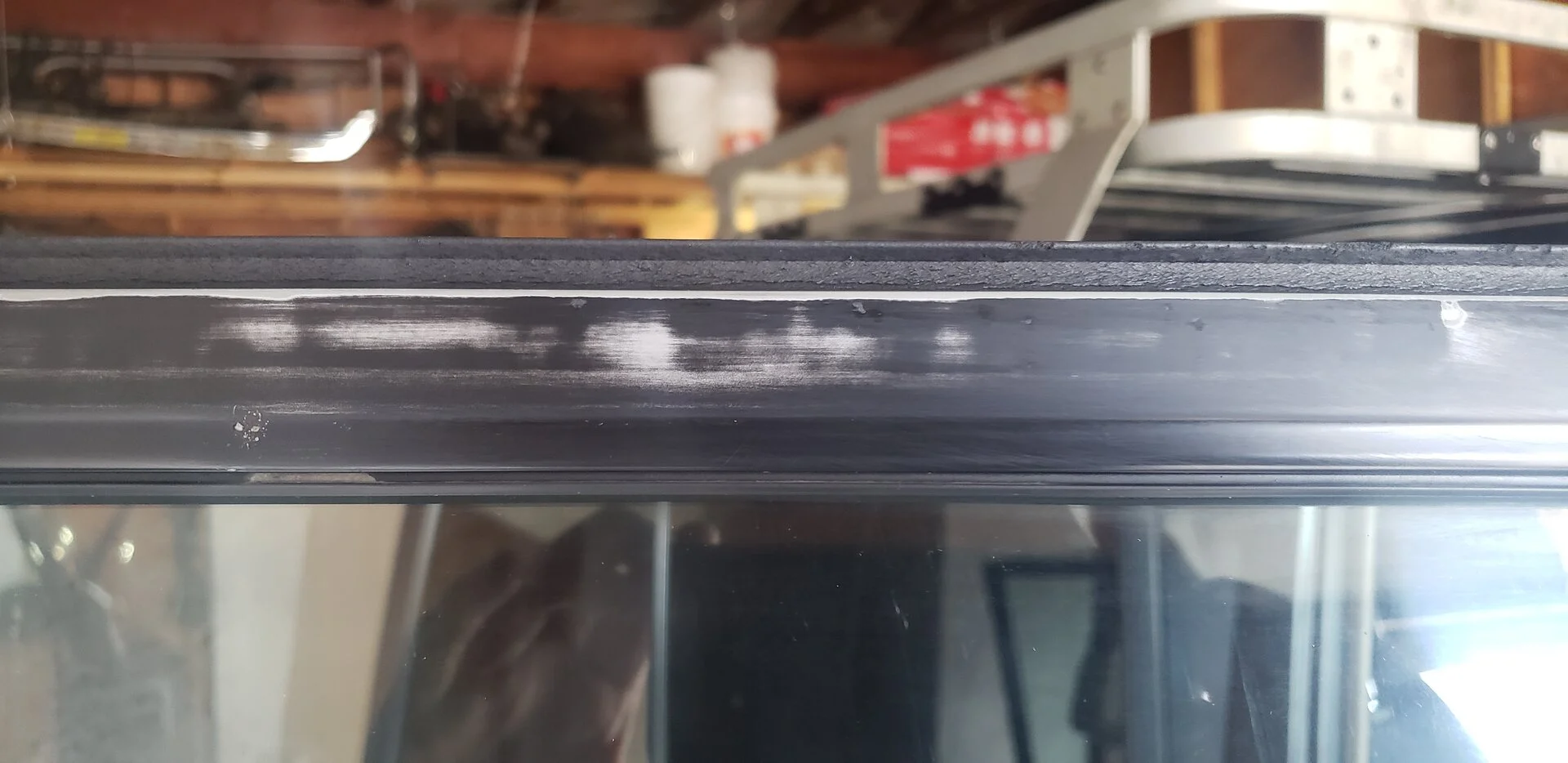

I don't think there is any magic answer for getting the gunk off from the sub-orbital space bubbles but this is another option should you have more adhesive based removals.
somebody else here suggested this to me so I figured I would give it a go.
little bit blurry but all that ugly stuff
during the process you will be covered in small particles of dead whale, stuff goes everywhere. I wore a mask, and did it outside.
it does get the stuff off but as you can see with a little sunlight. it leaves the hardened edge of residue from 25 years of baking. However, it does not seem to harm the paint. So I will let this age a bit and try again in a couple of weeks to see if it comes off after some weather and a wash or 2.
