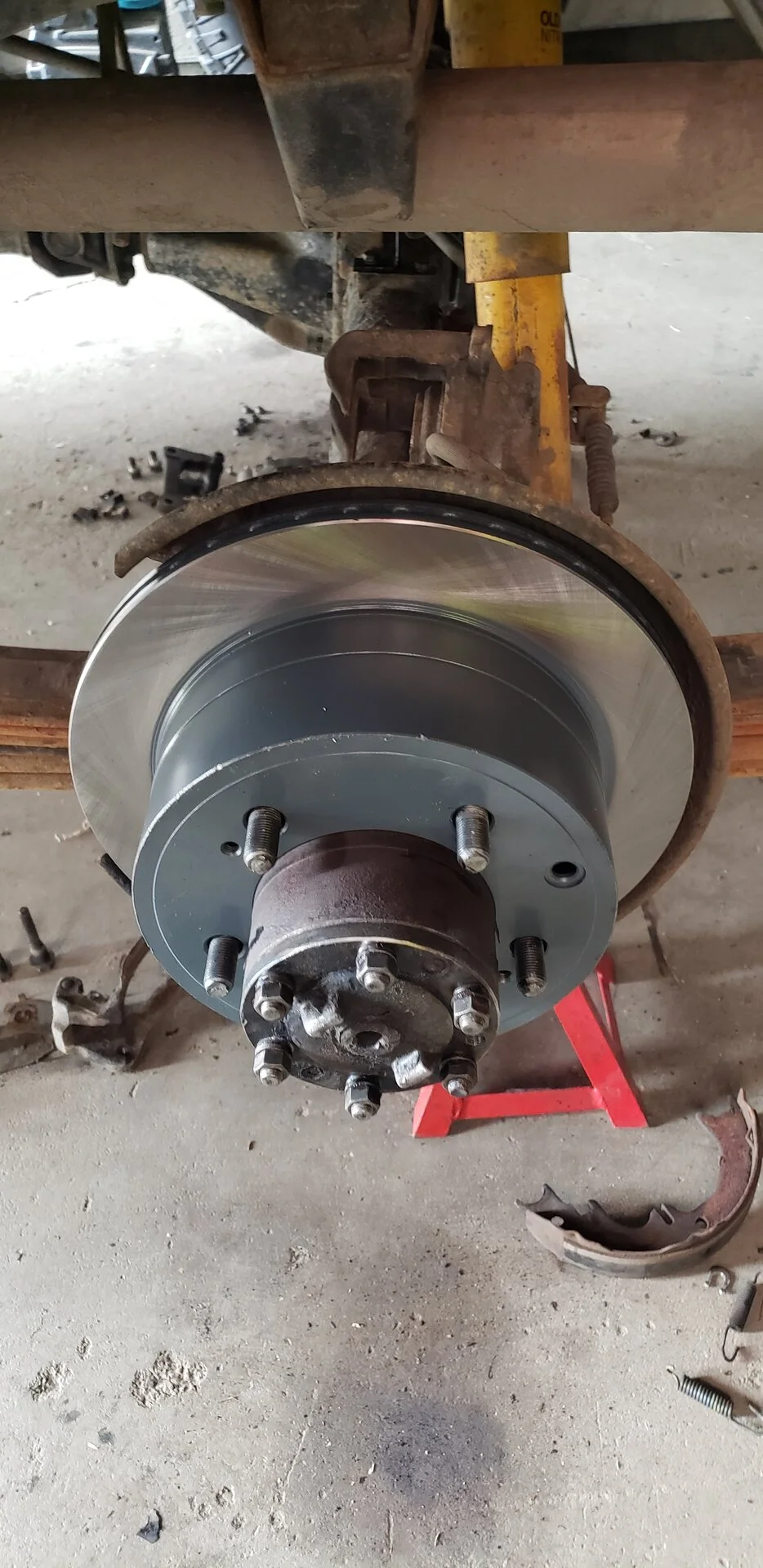

Ok, I drove the cruiser around some more over the weekend, and it is driving beautifully. Nice even braking that feels smooth and solid.
I adjusted the emergency brake and it has good tension like before, only I have to really pull on it a couple of more notches to work well enough on a slope. It seemed to grab better before. My thoughts are they just need to break in ("brake-in?" 😜) a bit. What do you feller's think of this theory? Time will tell I suppose.
For clarity - this is a rear disc brake setup, with the incorporated drum brake emergency brake.
EDIT: For additional clarity - My break in theory comes from the fact that drum brakes tend to grip more on one half of the shoe. Being these are new shoes, I am thinking I need to wear the corner off a bit to have more shoe in contact with the drum. Since these shoes do not really see any use (emergency brake only) I think I should go and use the emergency brake to stop myself a couple of times to get a little wear on the shoes, thereby creating better/fuller contact with the drum.

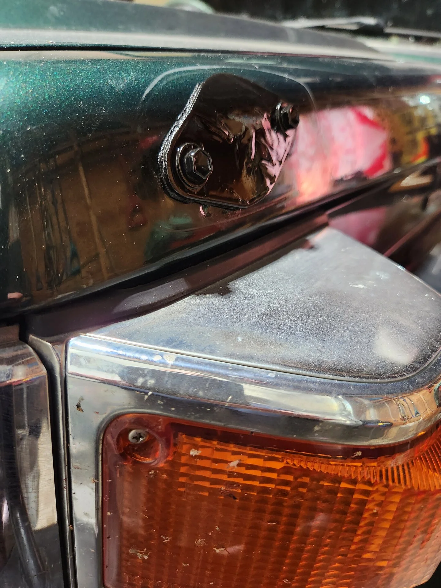

However, I got tired of the fender mirror for people with no spatial awareness and I have had trouble finding a rubber grommet that would fit the hole it would leave behind. I decided to make a blanking plate out of some aluminum flat stock I had.
I figure with the better aerodynamics and less weight over the front end, I should see an increase in mileage of 0.03190247 mpg
I still need to clean up the clear coat for the marks the mirror left behind, but I am glad it is gone.

Ok, since no one had an opinion on this, I have done my own testing, and I "broke in" the new emergency brakes a bit by using them to control my speed near my house while going down hill. While this helped a bit, I still was not satisfied with the performance.
My conclusion was to follow the FSM to adjust, but instead of backing off 6 teeth, to simply back off only until I can move the disk/drum freely. Just in case someone else comes across this issue. :cheers:

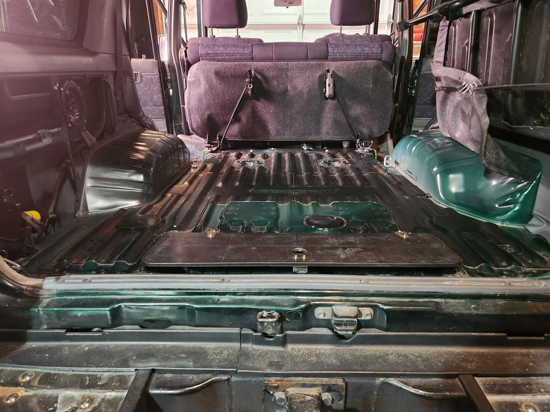

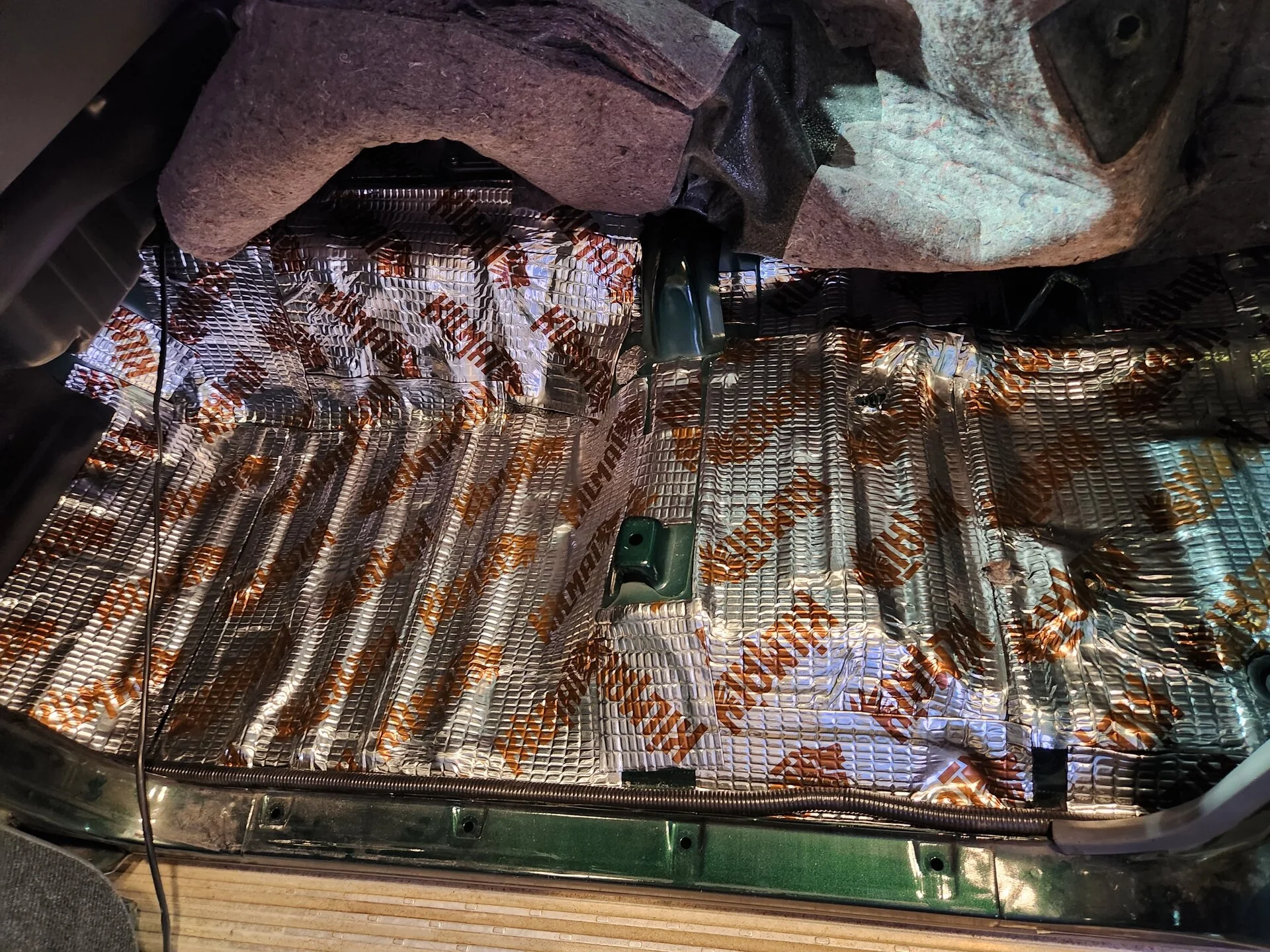

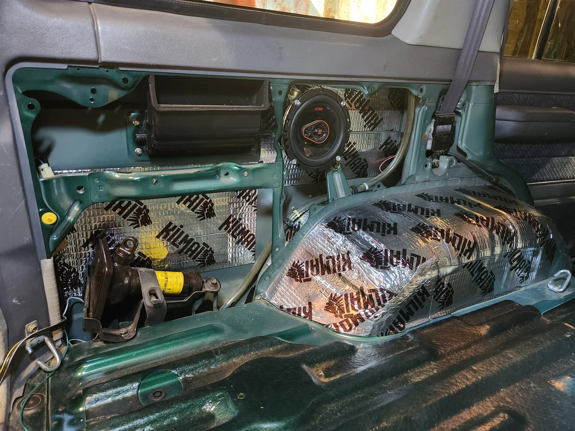

After contemplating this for many months, and after the positive reports of two upstanding local cruiser owner's - @JDMBC & @JDM Journeys , I took the time to install some sound-deadener in my Land Cruiser.
I only did a rough estimate of what I would need, and purchased 1.5 boxes of kilmat (54sq ft). My plan was to install it with full coverage, and as much as I could on the inner panels and doors. However, in order to still do the doors, I will need to order another 1/2 box, so if anyone else has the same plans, then just grab the 2 full boxes (72 sq ft).
I left the rear seat in place since you can tilt it forward and back with little effort in order to do the work. Everything else came out with the exception of the middle console as I did not want to deal with the mess with the coolant lines for the rear heater.
As you can see from the pic above, there is some sound deadener from factory, plus the carpeting has foam backing on it so I was not sure how big a difference the kilmat would make. I decided to bravely(foolishly?) forge ahead with abandon - being careful of the sheetmetal when reaching into the inside panels.
I am quite sure this is the first time the carpet has ever been lifted up, and probably the best this has ever been cleaned. While I did not find a lucky penny, I did find this, though I am not sure what the currency denomination is(other than the "1" on it). I had no idea that Japan made money out of aluminum
I even did the inside of the "trunk":
Overall, I found this made a big difference. Only, maybe not in the way I would have totally expected. For example, what I found to be quiet before (engine noise) is now more noticeable. I hear wind noise around the windows that I did not before. I don't have to talk so loud on the highway to carry on a conversation, and I can hear the stereo much better.
All wins in my book. For a relatively cheap upgrade (more labor than anything) this is a good choice for best bang for buck, IMHO.

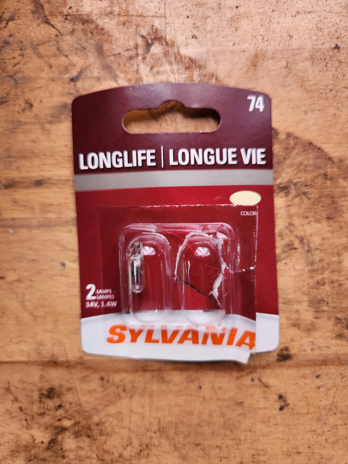

For those with 12v 70 series (this will become much more common in the US by next year) I found these to be a perfect fit for the bulb behind the HVAC controls:
Part 84999-70010

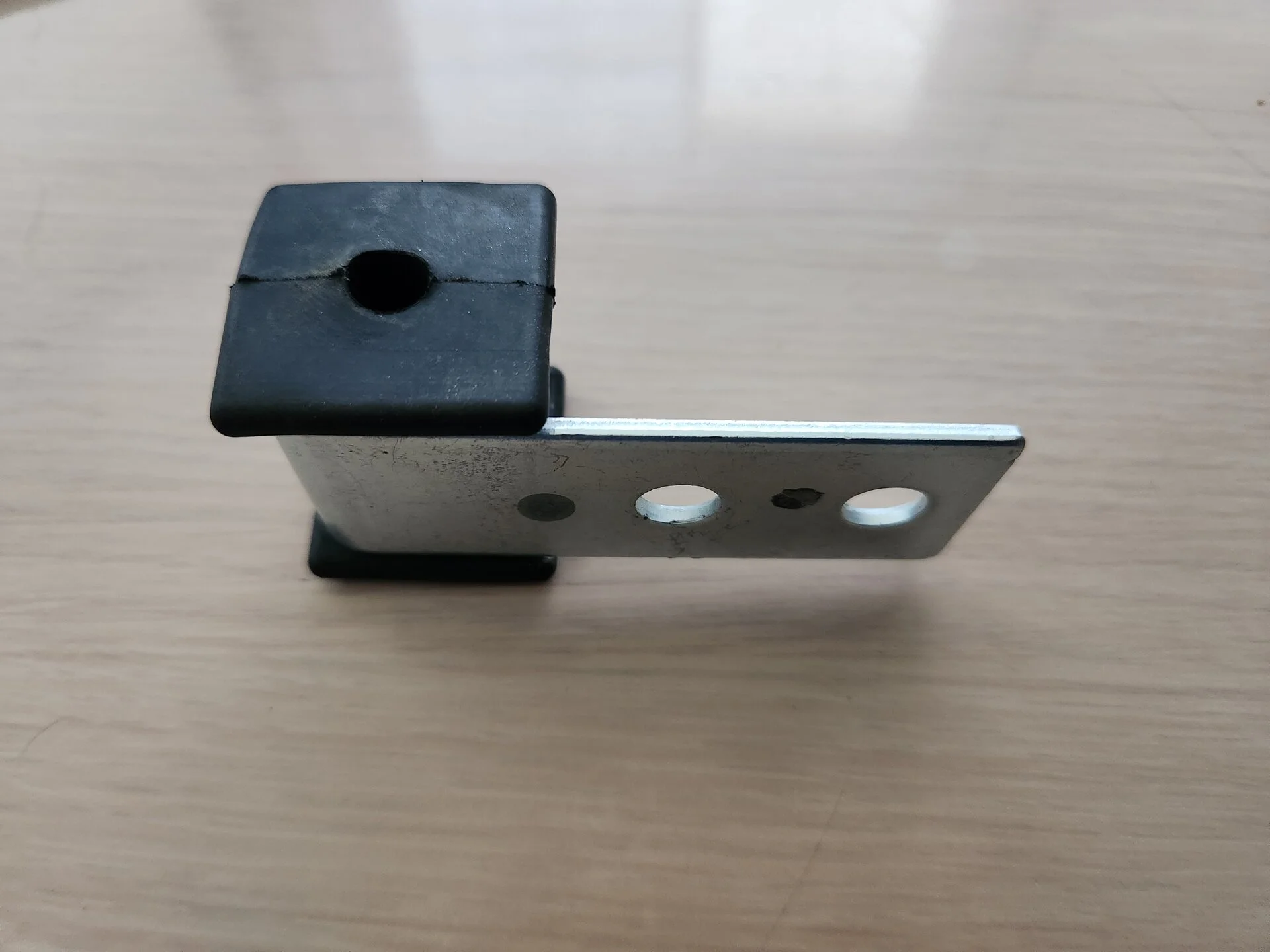

I was finally able to get into town while the local muffler shop was open (they close at 4:30, and are not open on weekends). Tough sometimes to get to a store like that when you work from home and live 20 mins away. I wouldn't have it any other way though.
So I managed to get a new exhaust hanger for $15 to replace the first one after the engine - the one that takes the most vibration. The 1HZ runs very smooth, except when starting and stopping.

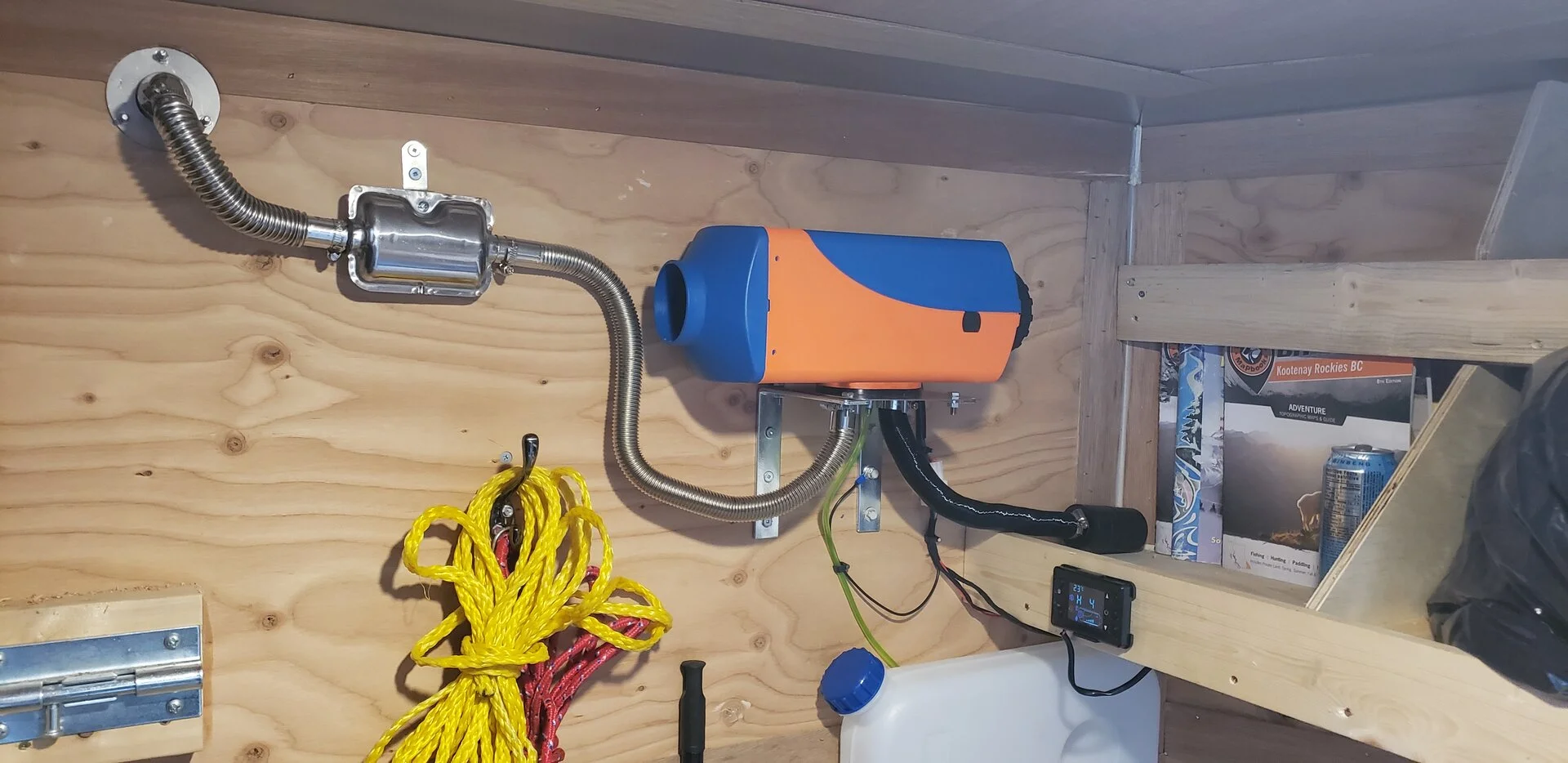

Those of you that have followed my build thread may recall the utility trailer that I modified to allow me to be on extended SAR searches and have a place to sleep and have everything I need to essentially live wherever I am at the time. I also use it for my yearly fall 2-week trip to explore the backcountry of British Columbia.
Last winter I decided to get one of these, and finally got around to installing it:
Amazon product ASIN B09C2Y88GF
It is basically a knock off of the webasto but at 1/10 of the price. Since this is not a "mission critical" item for me, and based on the reviews, I decided to give it a go. An 8kw heater is way overkill for a ~6x12 space, but I have found running an 8kw heater at 2kw is more efficient than running a 2kw heater maxed out. And at minimal setting, they claim one tank of fuel (10L) will last 100hrs. I assume this means running it constantly, which I will not be doing.
Install was relatively easy, but people complained the injection pump was noisy - a constant "tick, tick, tick, tick" so I built an insulated box for it, and stuck that inside my forward cabinets. So all I hear is the fan, and a really faint tick in the background.
What doesn't come included is any way to exit the exhaust, so I had to buy one more length of bendy exhaust pipe and I used a marine sump port as it is double walled. I also had to build a mounting bracket for it (I didn't want a big boxy one)
Installed up out of the way:
I still have to route the heater hose downward towards the floor, but you get the idea. You can't see it, but just behind the heater to the right is a vent to outside where it can pull in fresh air.
This heater REALLY puts out the heat... it comes with a panel that you can program for time, when to come on, when to shut off, thermostat controlled like a furnace, or just use a remote to kick it on when you want.
The specs on it, well, on anything really, is annoying. I realize they are provided a perfect lab environment and giving you specs under ideal conditions. However, it does draw a fair bit of amps on startup (glow plug) and I realized with my fridge/freezer in combination with this heater in fall/winter scenarios with limited daylight, I would really need to up my solar game. I ended up taking off my 2 100watt panels and putting up 2 200watt panels. I put in a decent charge controller originally in case I would need to do this, so it was an easy upgrade. My buddy wanted my old (3yrs old) 100watt panels so it was a no brainer for me.

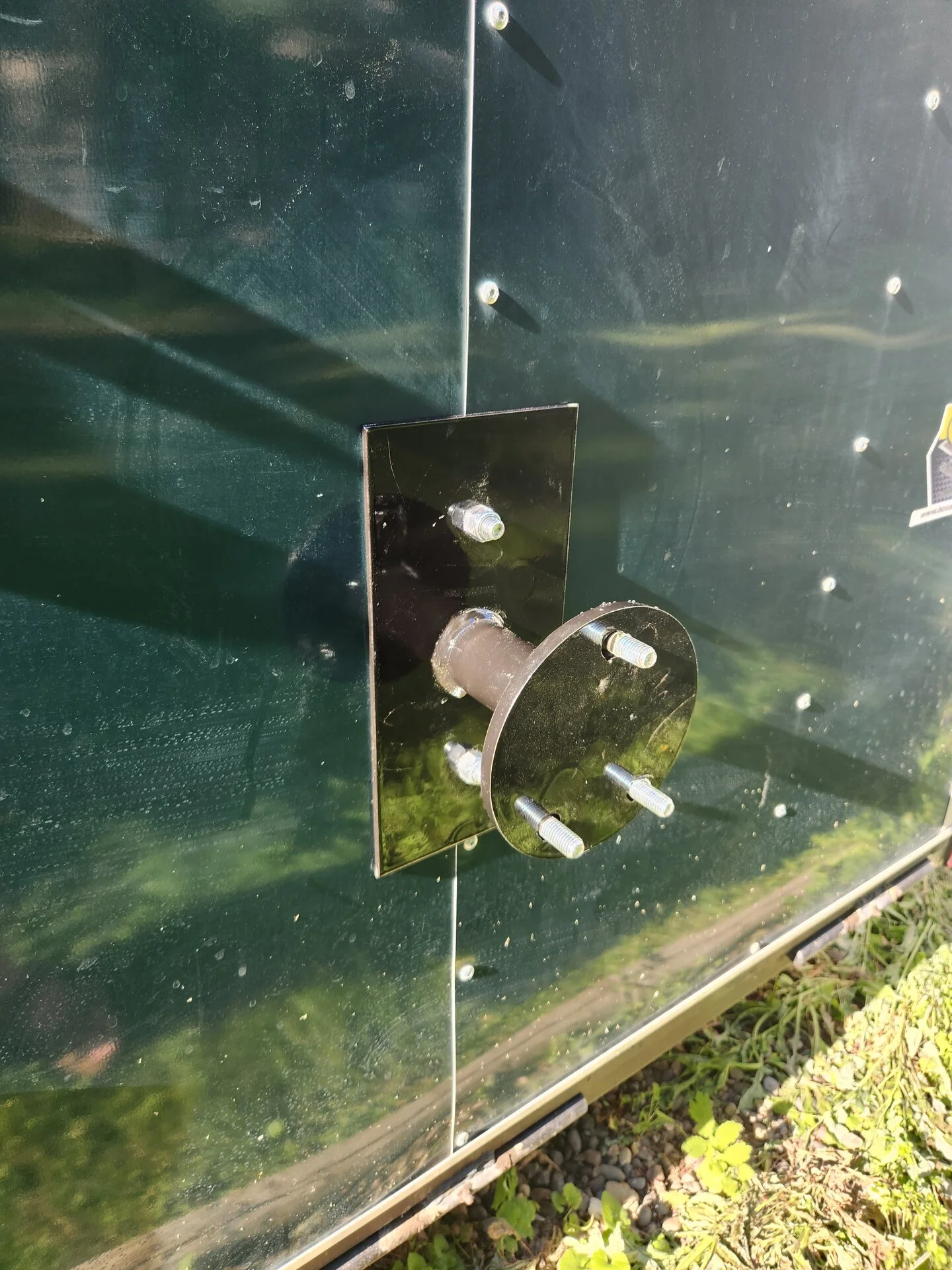

So I was able to complete a couple of projects I have been trying to get done for some time in my "spare" time.
I had to use my spare time because, well, it was for my spare tire on the Land Cruiser, and the spare tire on the trailer. So theoretically, had I not used spare time for this then there may have been catastrophic consequences.
Ok, I will spare you further philosophical debate and get to the point!

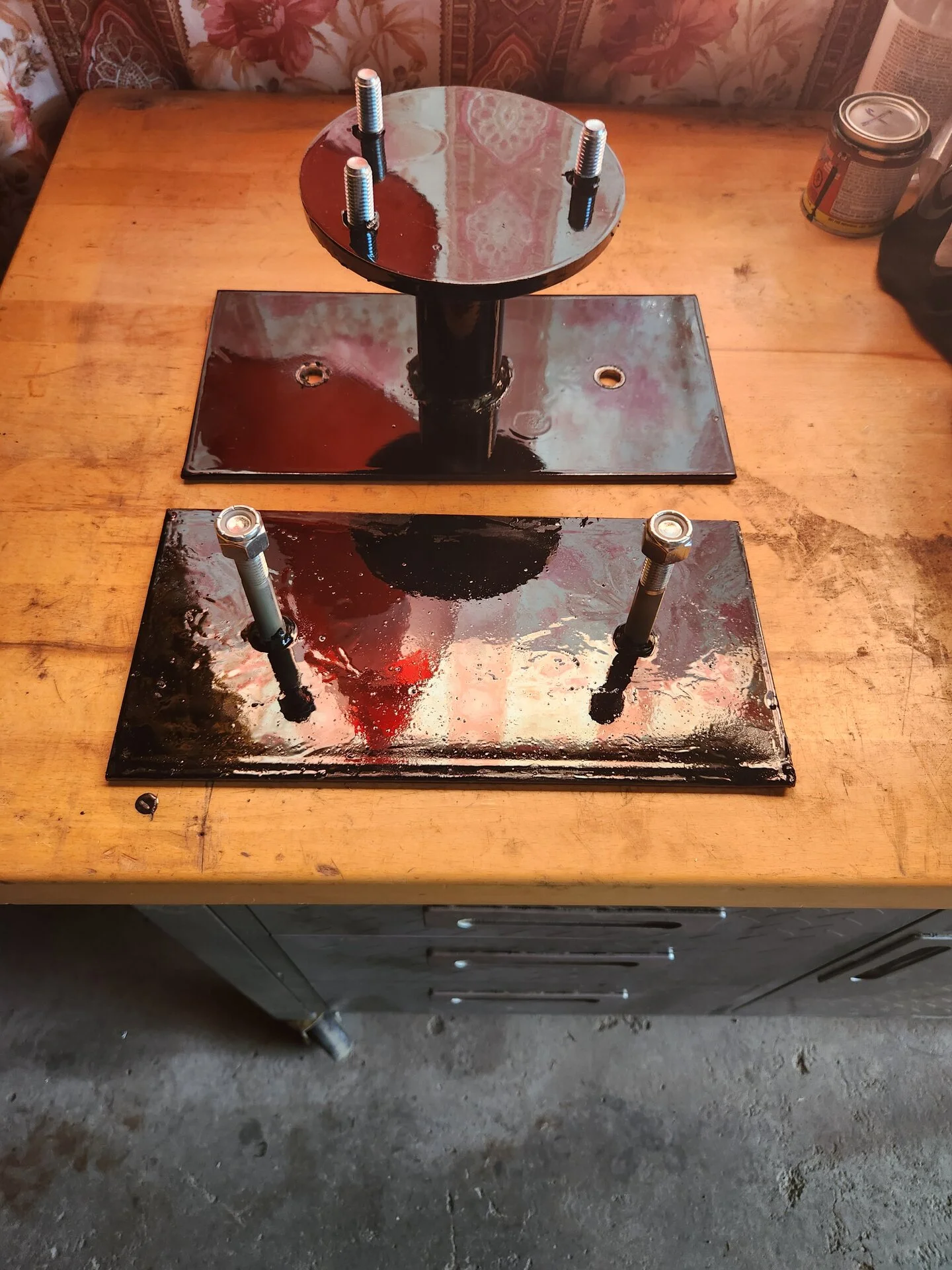

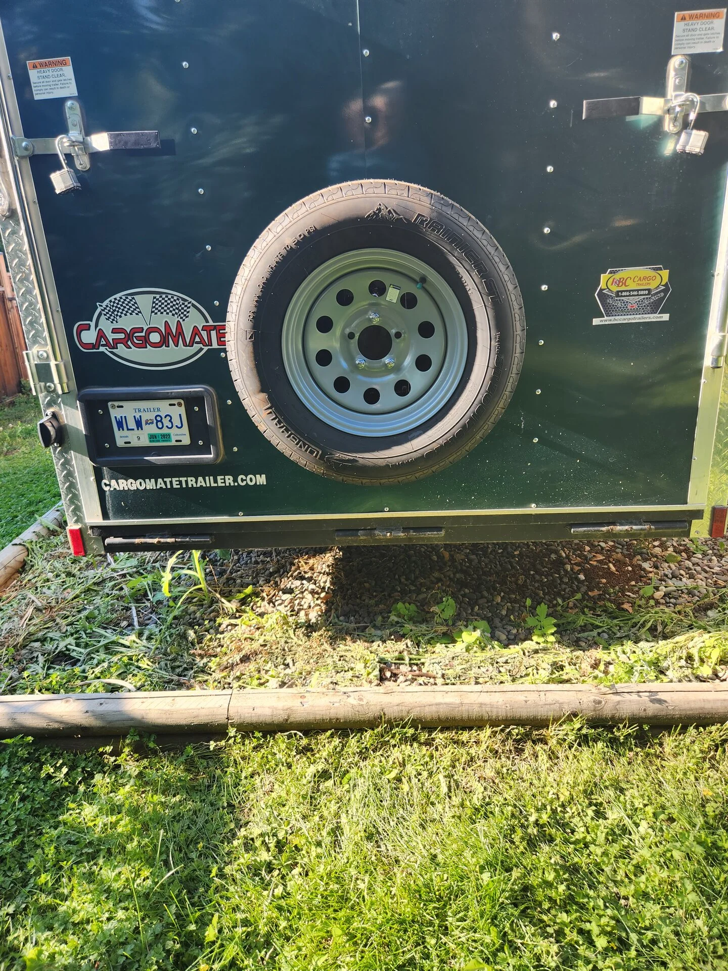

I finished a spare tire mount for my trailer. Because it is a v-nose, mounting the spare up front was not ideal, and I did not want it inside. That left the rear...
Bolted on through the frame
Tire mounted

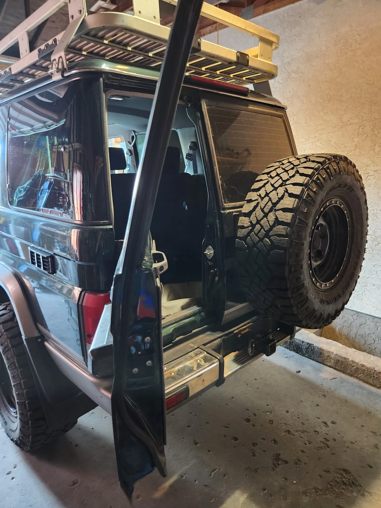

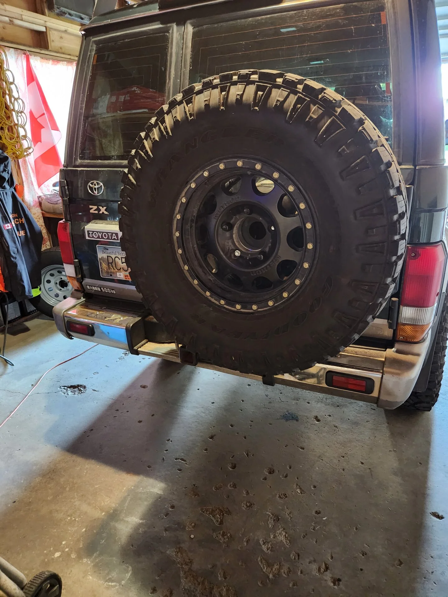

With my trip with the 3 lads coming up in two weeks, I wanted to get the spare out of the back of the land cruiser to maximize storage space for cargo. I simply used a 1.5" spacer and a couple of shims and I am just able to open the small door. Mission accomplished.
