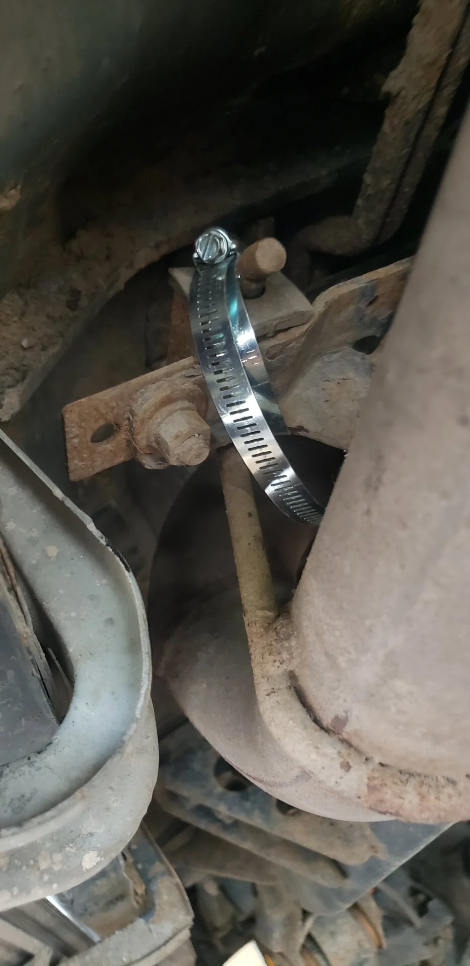

Fortunately when I got home and had a closer look, I noticed that the first exhaust hanger below the driver's seat (right hand drive) had broke.
Not a big deal, thank goodness, so I threw a clamp on it until I have time to pick up a new one, or if the metal isn't too far gone, I may just weld it up again.

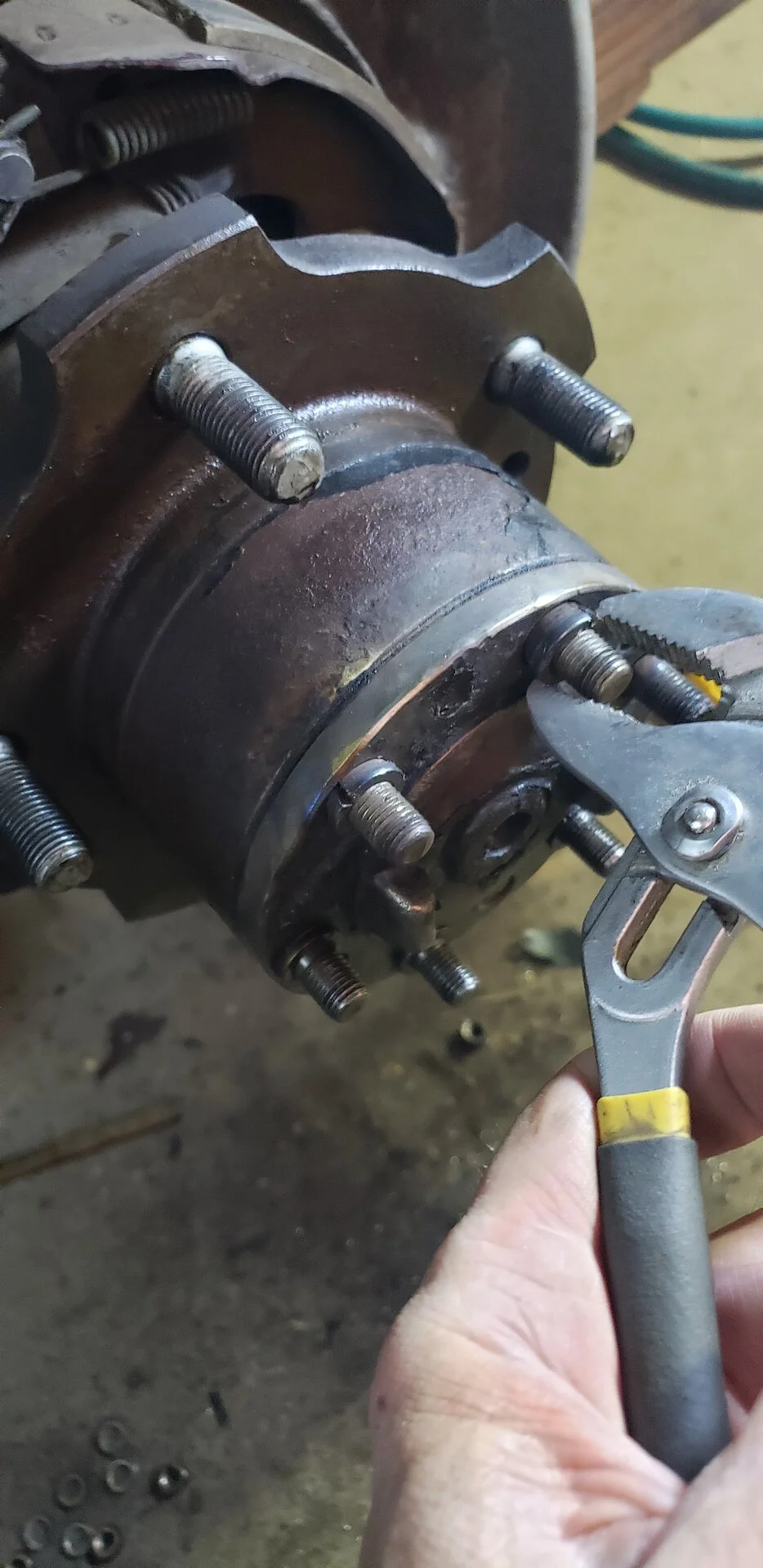

Got started on the rear brake job today... started with checking the parts I had preordered last year. Had everything but the calipers I ordered last week, or so I thought. The bearing and seal kit for the rear hubs did NOT include axle seals. 😠 Rather than get toooo frustrated, I realized this is a first world problem, and ordered those as well.

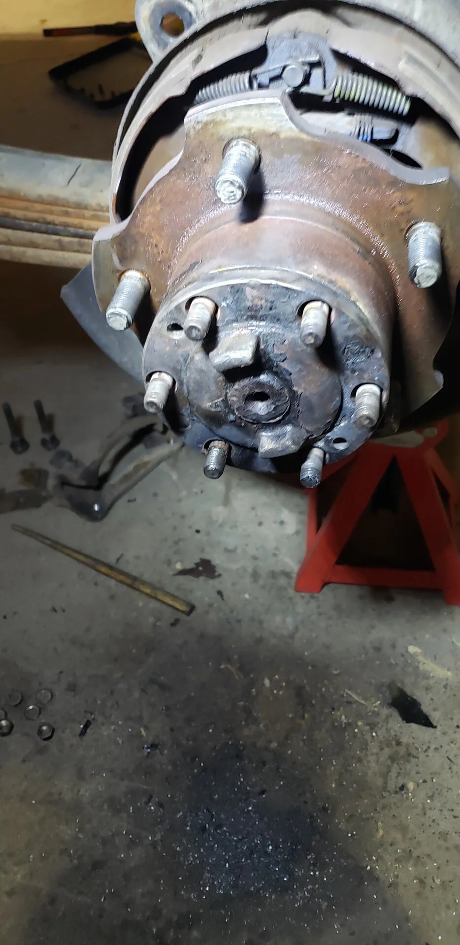

I already got the calipers and discs off in my previous inspection to see what damages I was dealing with. So I wire wheeled the POR-15 off that I had previously put on, and removed all the nuts. Now everyone's FAVORITE! The dreaded cone washers.

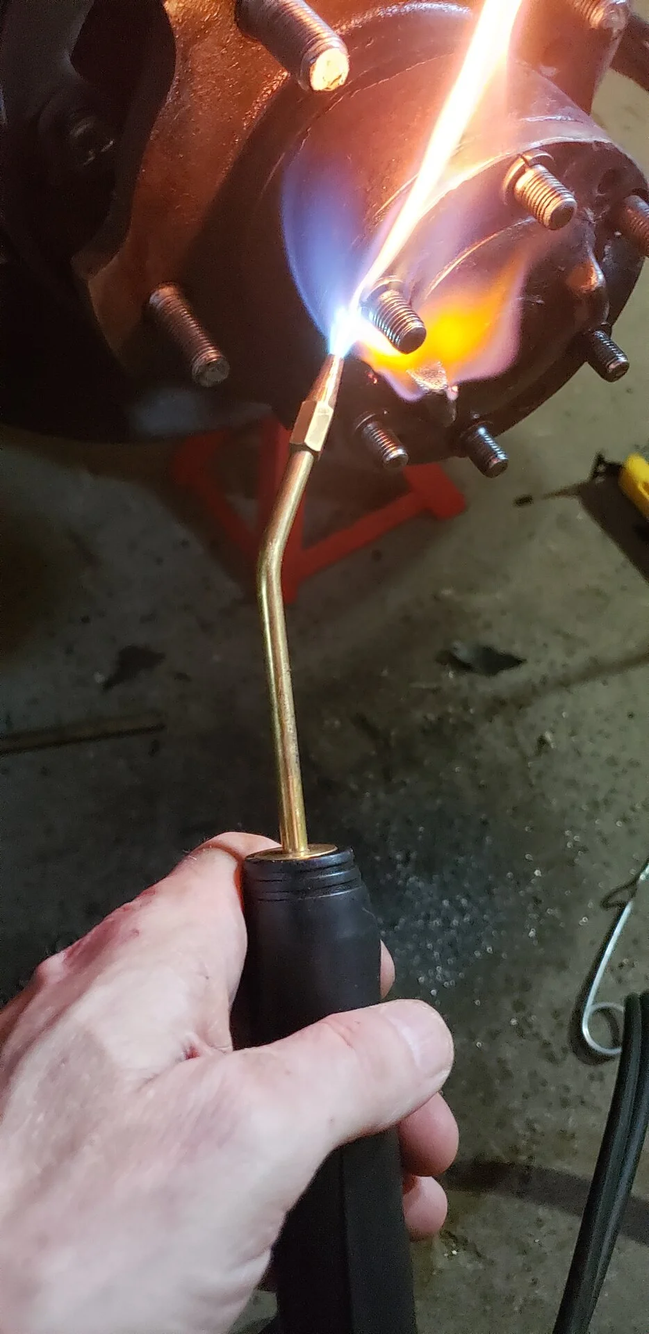

I preheated one with a mag torch, if you do not have one of these, a propane torch will work just as well, it will just take longer. I found that 1.5 - 2 mins heating the cone washer where it meets the flange (not the STUD - you are not removing this) worked best.
Then I used a 4lb hand sledge and a drift. I had to make a m10x1.25 nut for the studs as I could not find an old one anywhere. After heating, I put the nut on the stud. What worked for me - 2 solid whacks on the stud, then one against the flange on either side of the cone washer. An average of 6 whacks a washer.
Then I moved to heat 2 at a time, then 3.
First side took me about 35 mins (from the time I started heating the first stud). Once I had the first side done, the second side was 2 groups of 3 and I had it done in 20 mins. You DO need to whack it harder than you think. Hence the nut on the end of the studs to protect them from flaring.

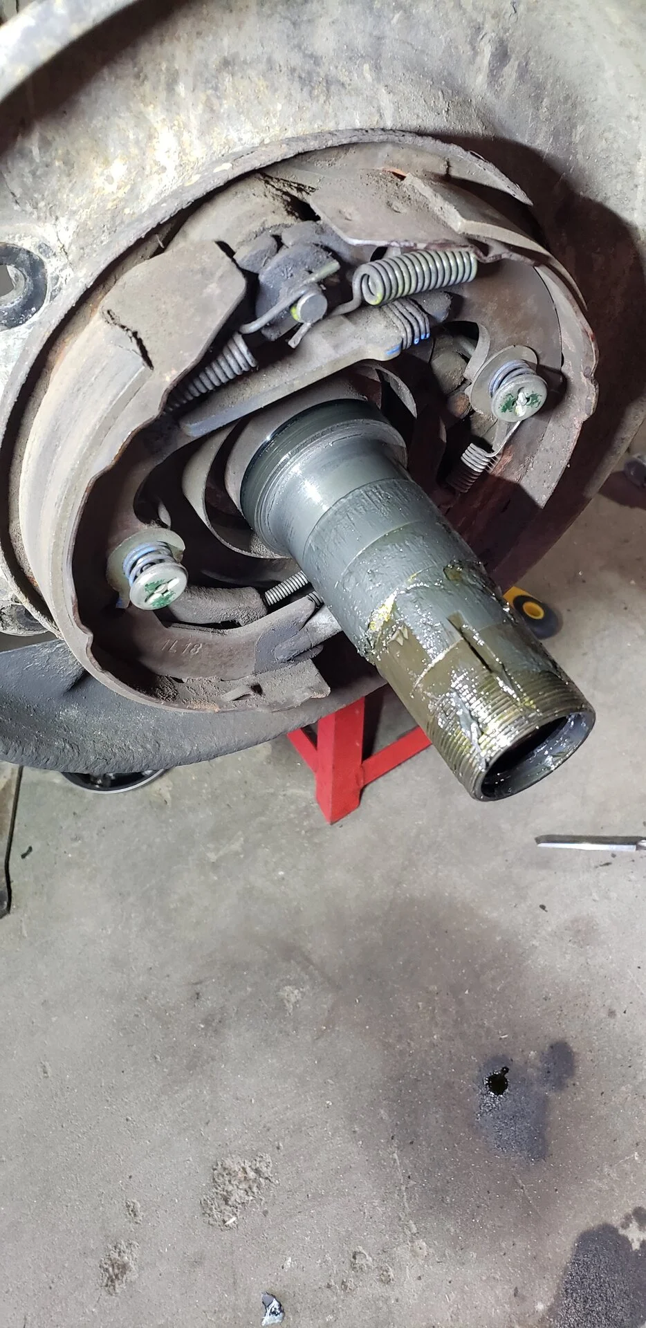

Tomorrow I will get started on removing the hubs and replacing bearings/races/seals, and of course do the emergency brake refresh while the hub is off as it is so much easier.

Don’t ever hit the flange, it deforms it and makes it harder to remove the cone washers. I have always been able to remove the cone washers with a big hammer and a brass drift. Some took a bit more effort to remove this way but eventually they all come loose. Then I put a little bit of anti-sieze on them when installing.

Interesting, I have never heard of the flange deforming. Thanks for the info. And yep, I picked up some anti-sieze already because I couldn't find my little tub of moly-slip. It must still be in a box in my shed. I also put a dab of medium thread locker on the studs for insurance when using anti-sieze lube on the cone washers. :cheers:

I apply anti seize to the inside diameter and outside diameter of the little bastard cone washers
And when using new ones I am especially careful about working up to torque value (25ft lbs iirc) on those wee little M8's and go up in increments.
Having on hand new nuts, cone washers and studs is cheap insurance......I replaced everything except the studs this time

Have one side done already, at least the bearings, races and seal. New emergency brake refresh. Still have to put on the caliper and pads. The other side I will do tomorrow. Then I'll post a few pics, so it did happen. 😜
Cleaned up the cone washers, added anti-sieze and 1 drop of blue thread locker on the studs for insurance.
I’m not home so I can’t take a picture of the flanges on mine, but you definitely can see the abuse from former work
When I had mine apart this weekend I noticed that the area radially outside of each of the holes for the studs where the cone washers seat is surprisingly thin
Pounding on those thin spots with a steel hammer is probably a "Bad Idea ™" and isnt going to accomplish much imho
Better off screwing 2 M8 bolts in the end of the axle flange to help put outward pressude on the flange to separate it from the hub body.....those two studs that seat into the hub body are notorious for rusting and are also candidates for anti sieze lube.

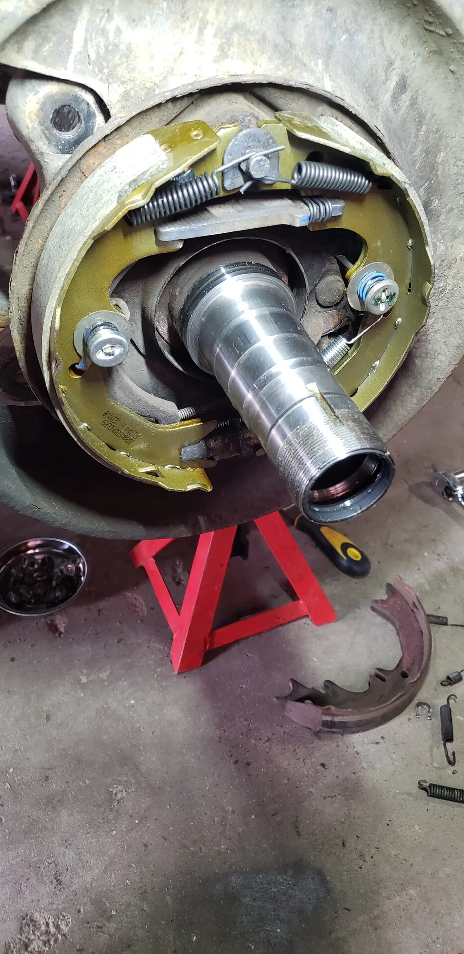

Ok, so brake/bearing seal refresh completed while doing the brakes.
I decided while I was in there to refresh the emergency brake components.
New bearings done and hub and new disk/drum combo

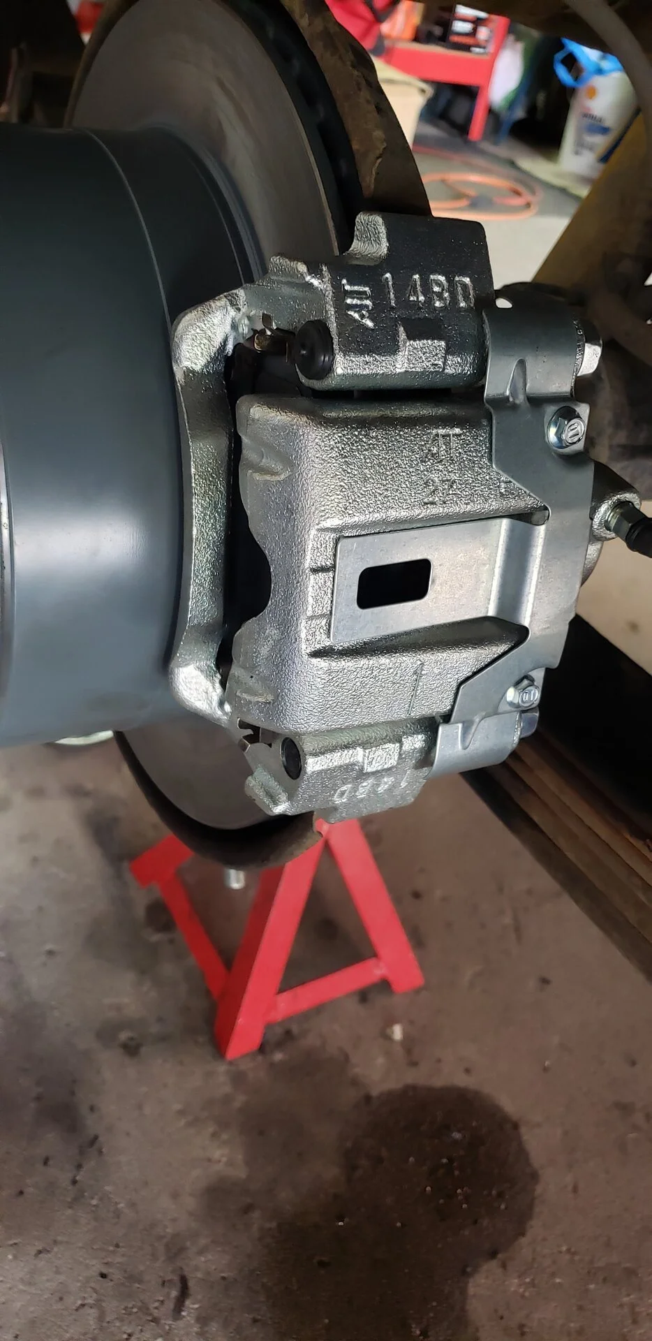

And with the new calipers installed
I have to say that although it is annoying to be basically doing "2 sets of brakes" when doing a complete brake refresh in the rear, the emergency brake system on these 70's are very effective. I can park on a hill with just the emergency brake engaged and it holds the vehicle extremely well. I generally put it in gear as well in that scenario, but I typically find parking spots that I do not have to worry about it.
