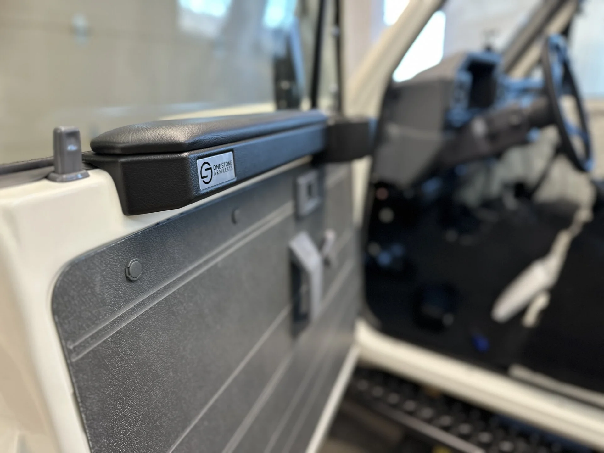

Hey guys it’s a while since I’ve updated been travelling a little since February! I managed to to finish one door on driver side missing a few gromet to do the other side will start the side windows perhaps tomorrow 🤔

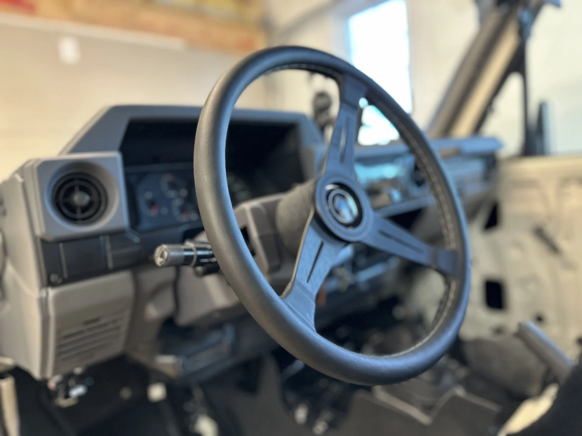

The dash is almost completed too some stuff can’t do until run wiring for switch pro

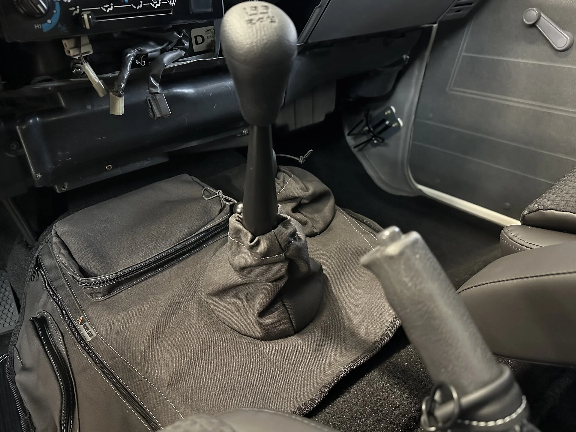

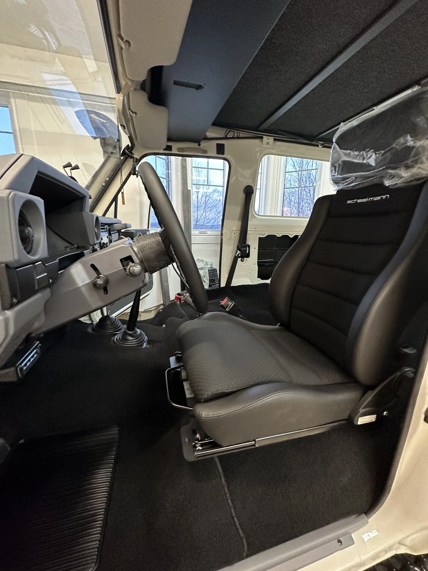

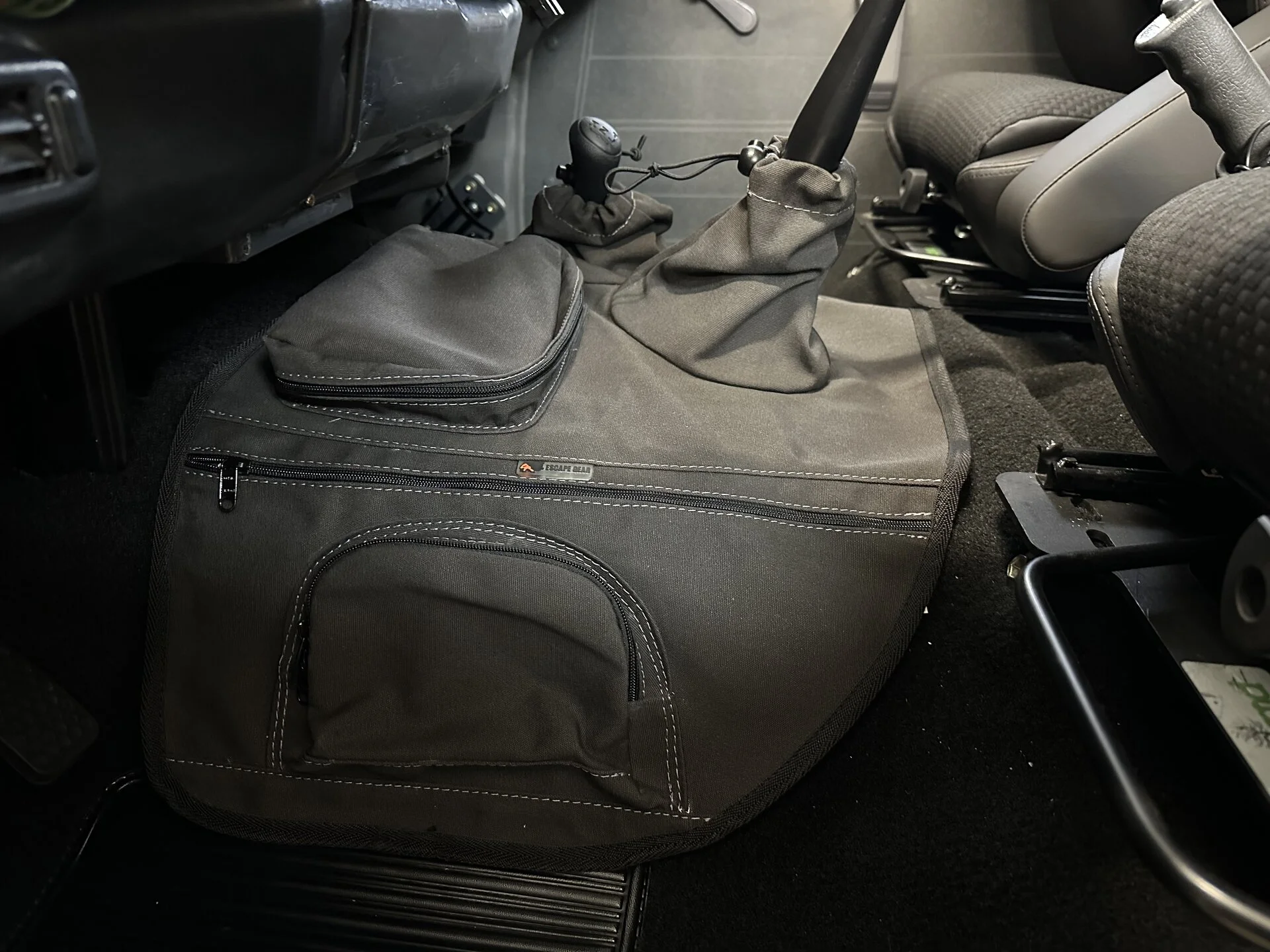

Got to fit the carpet, not so easy with no pre cut mess up a little but managed to get out easy thank to my friend I ordered a transmission cover from escape gear SA

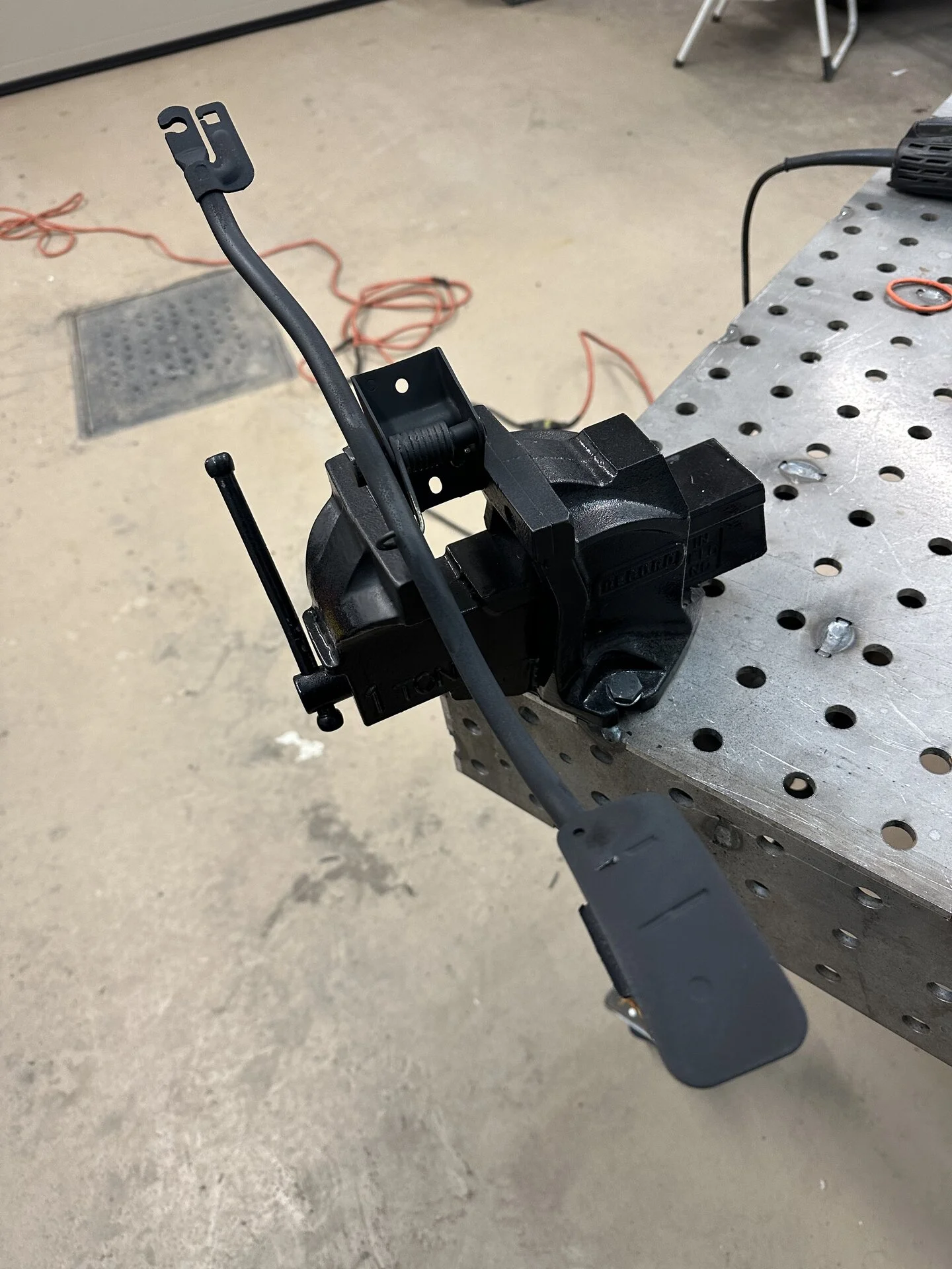

Also waiting on some used floor trims mine are vers warned out. I had to grind a little the gaz pedal with the sound detonating, carpet it was to tight 🤦🏻‍♂️

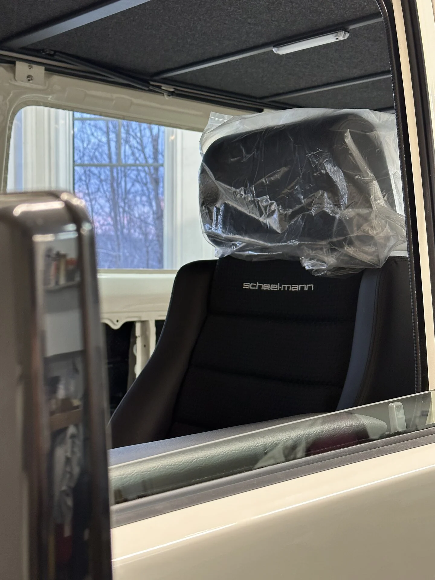

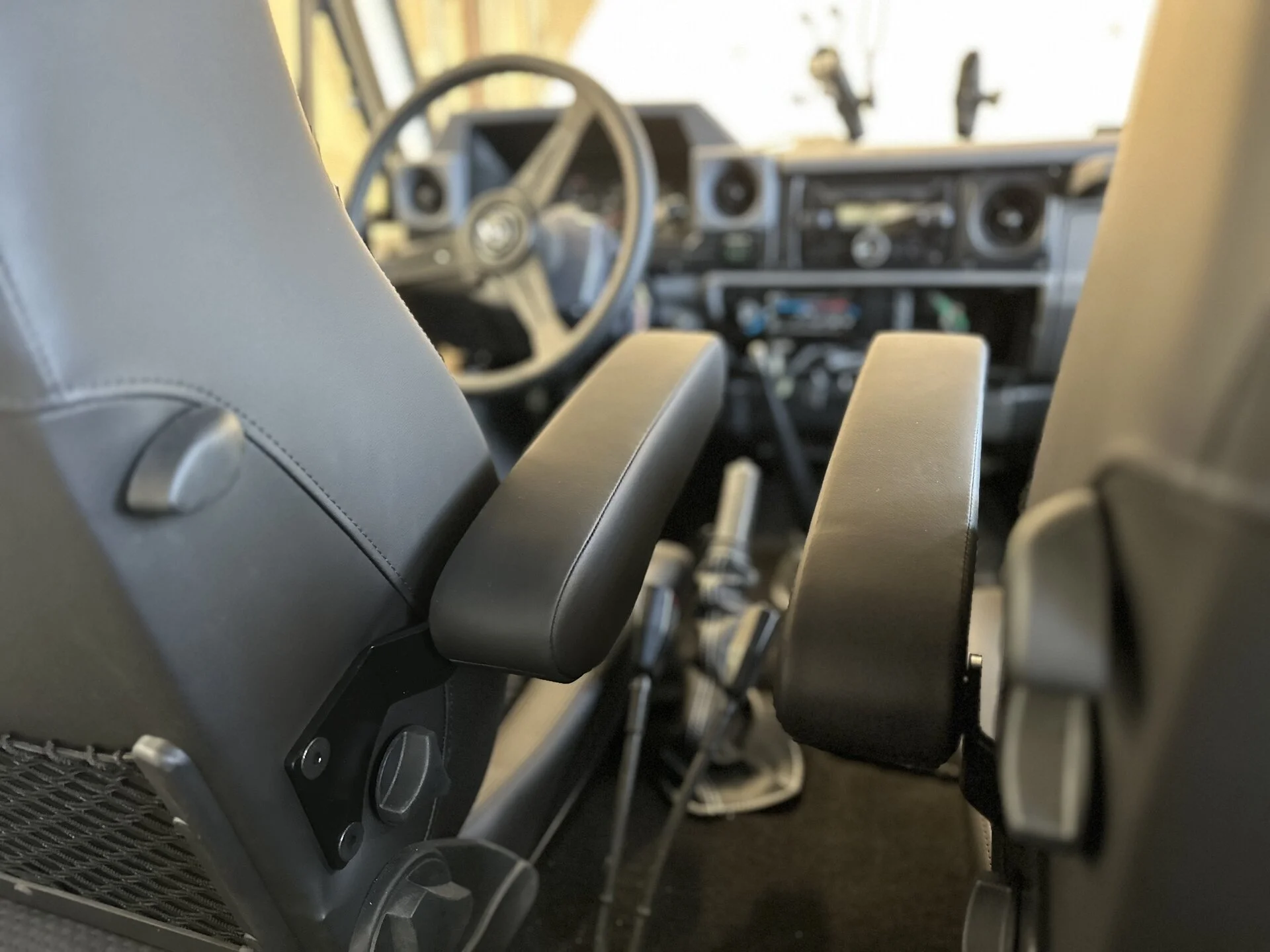

As a bonus got to fit the seat it feel good just to sit there and actually tell your self this is the ride I will drive one day for now now swivel I don’t like to look of it
If anyone has for sale let me know missing one :(

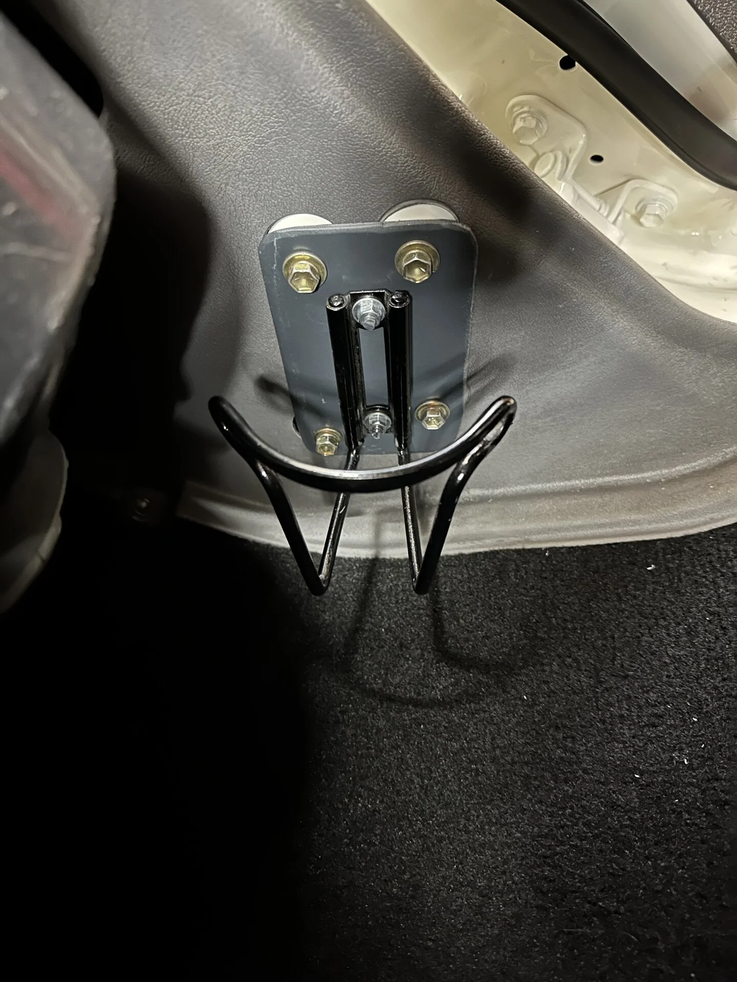

PLUG, ASSIST GRIP​
Genuine Toyota (7461790K00B0)​

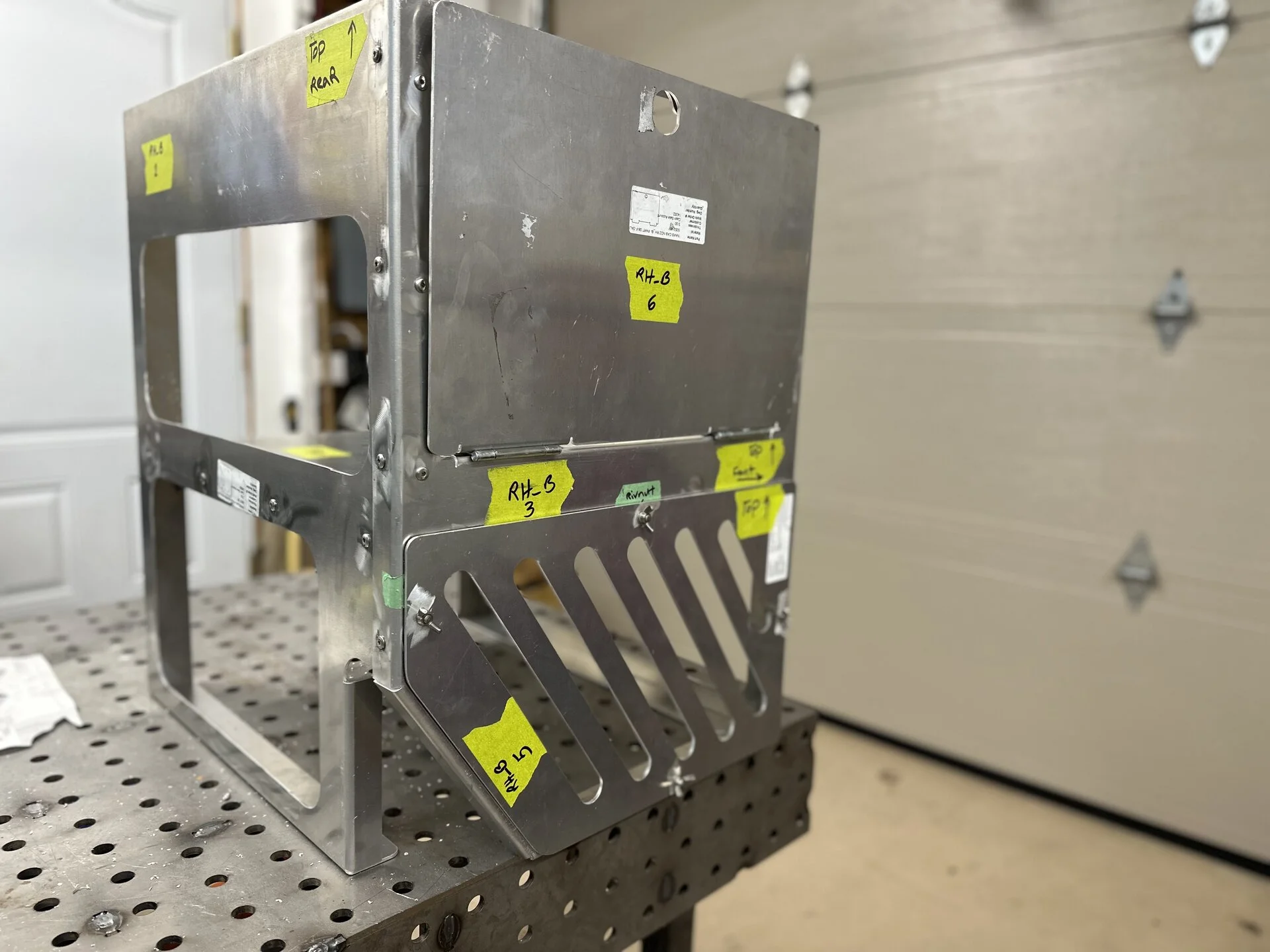

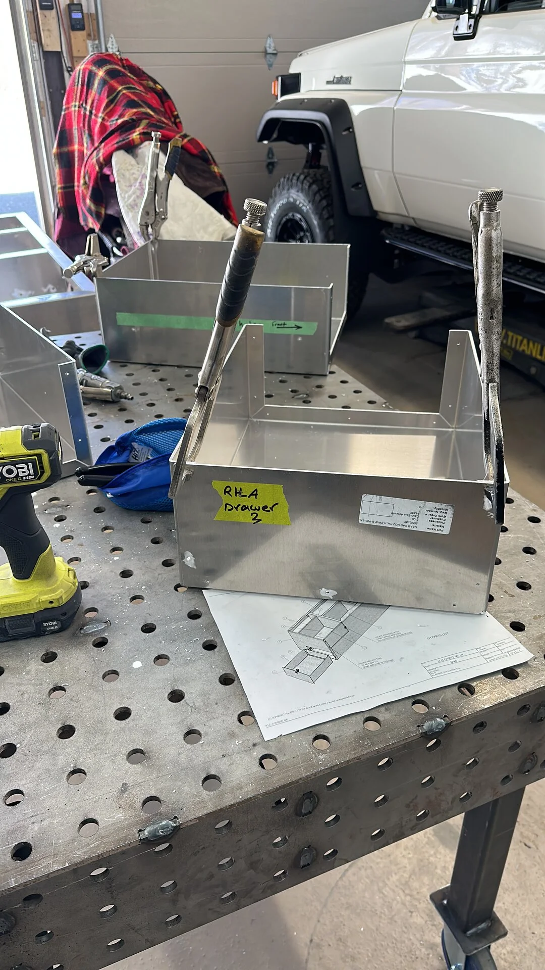

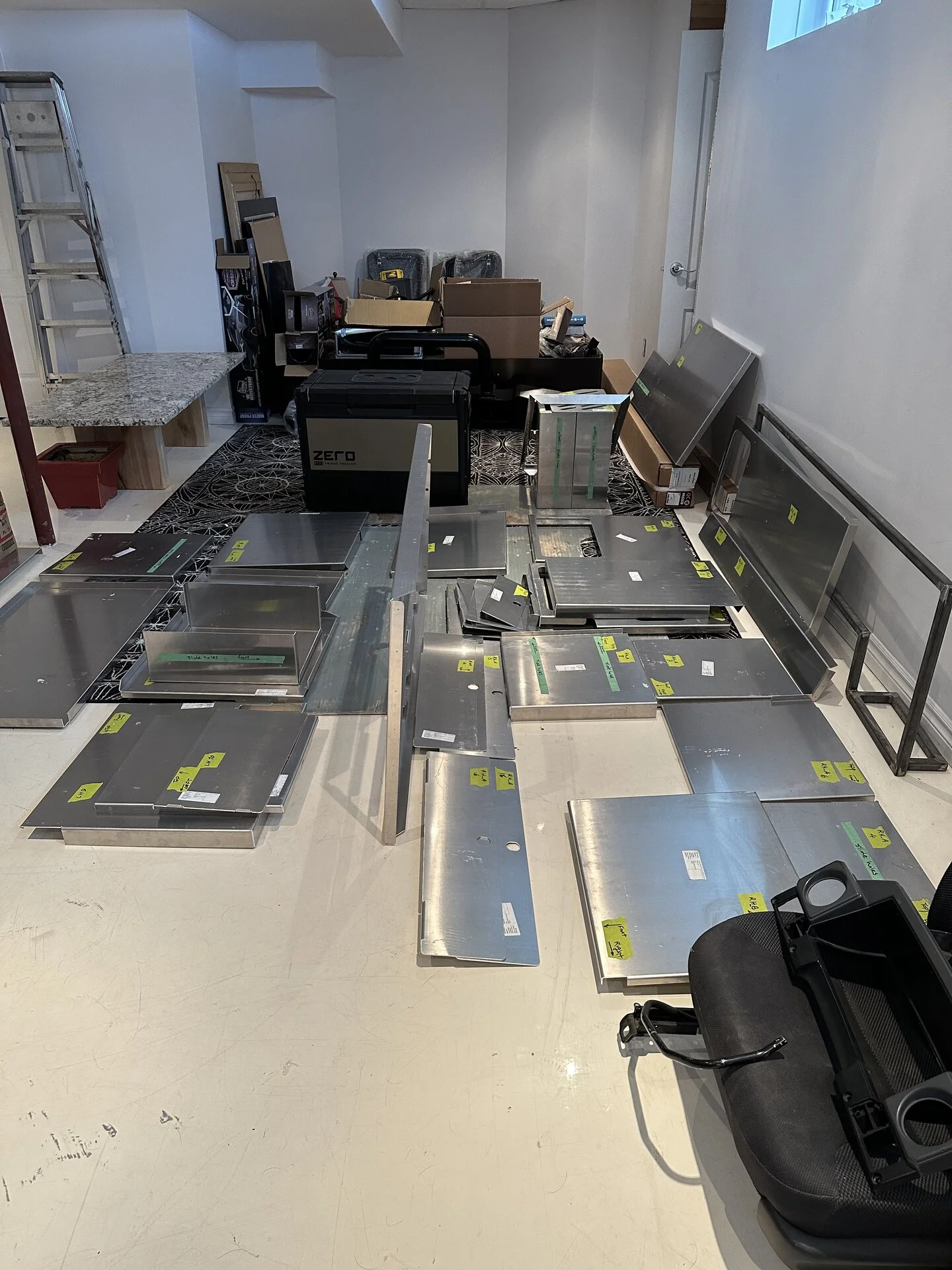

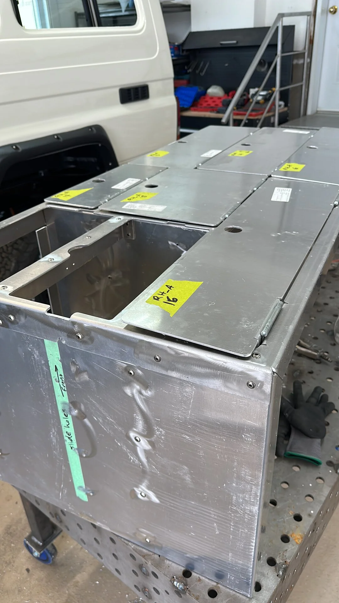

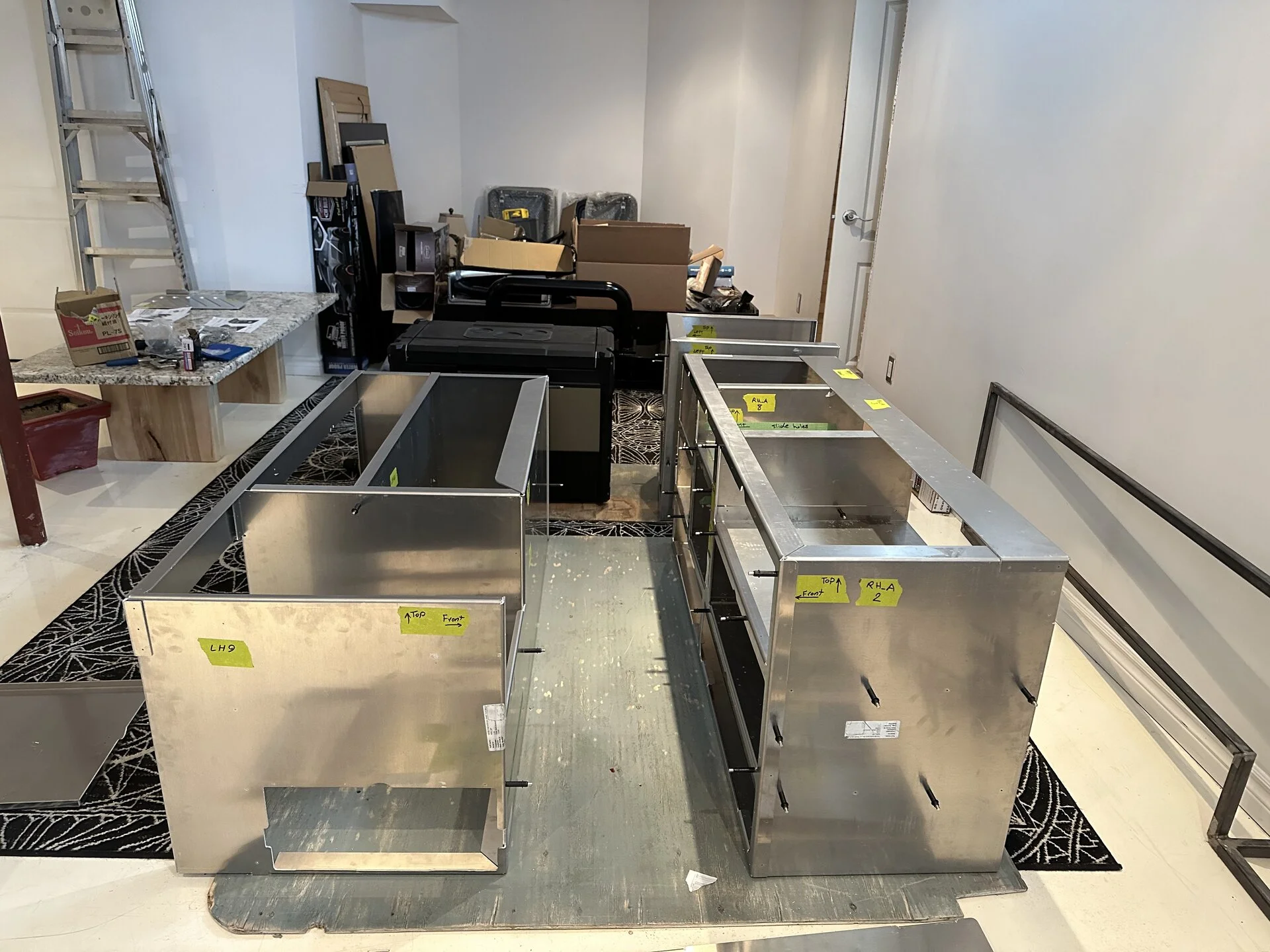

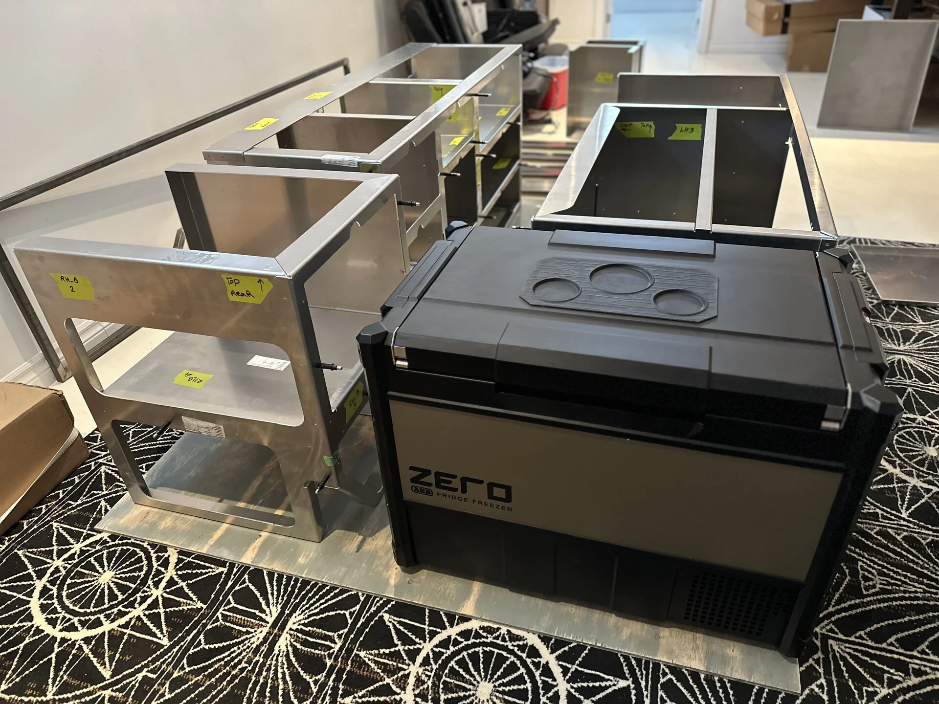

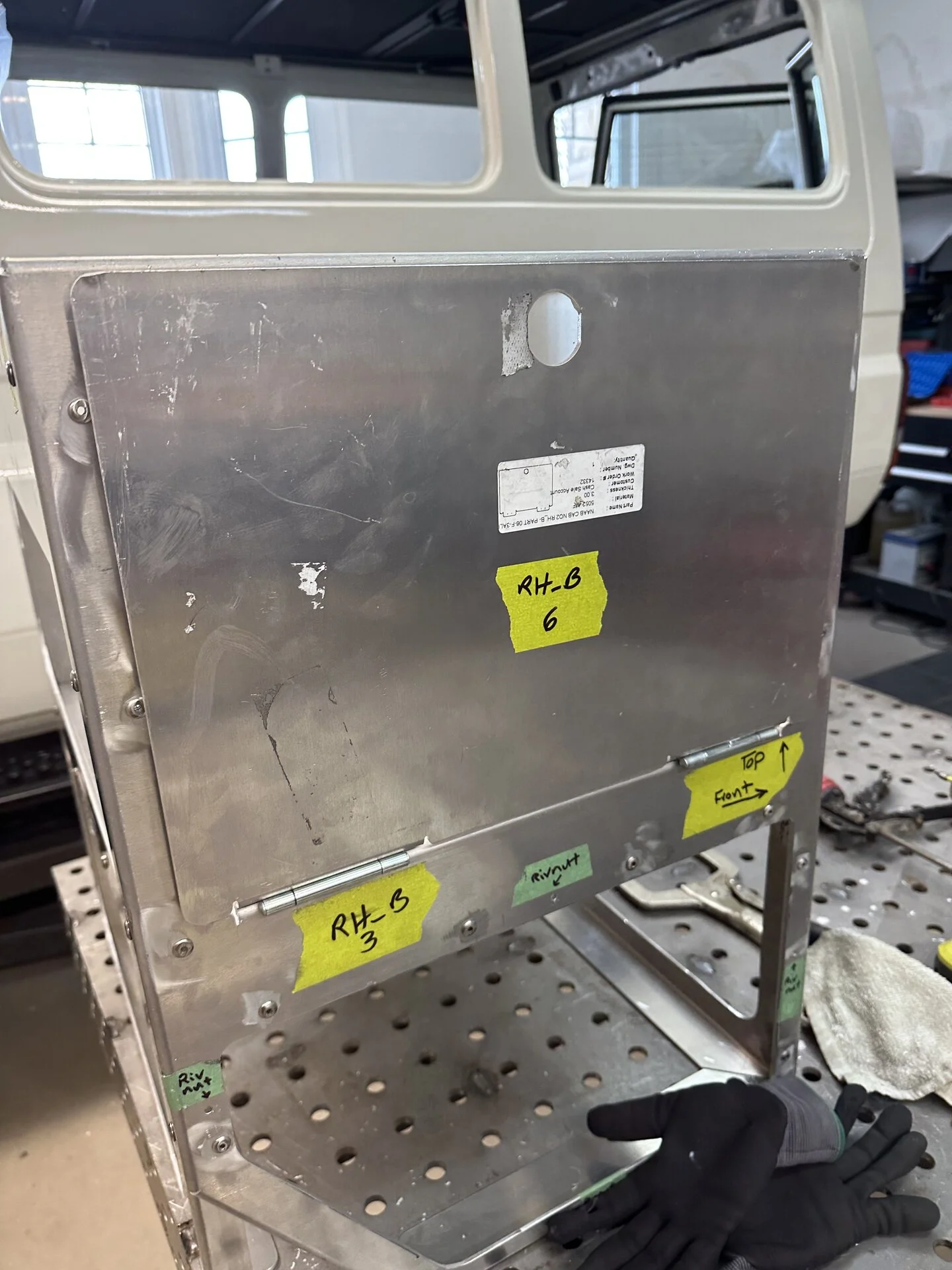

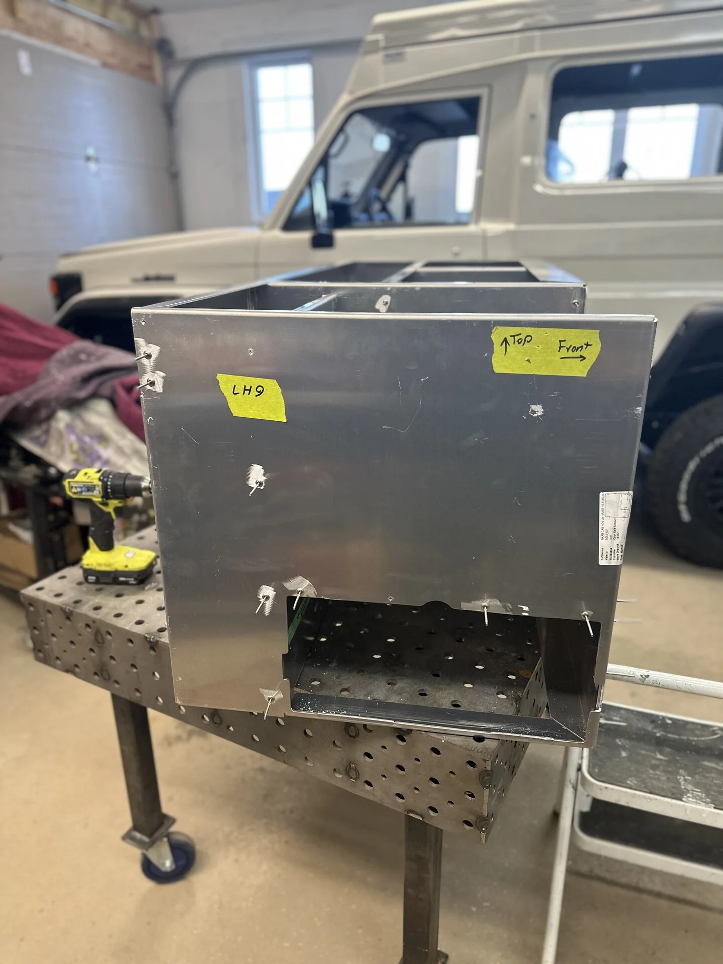

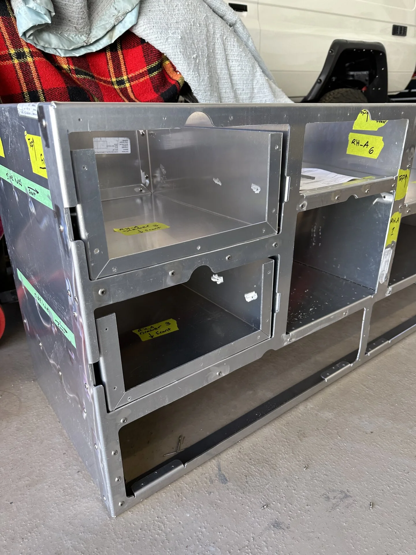

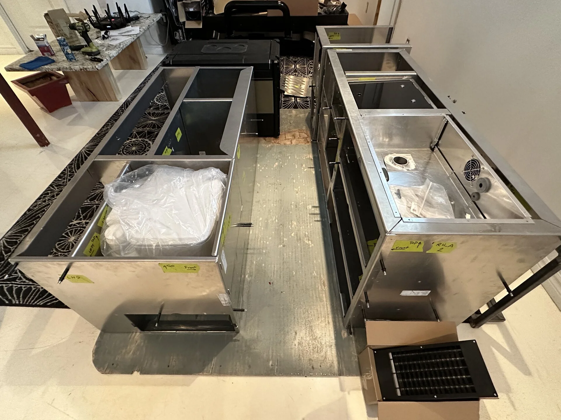

Mook up pretty much done will riveted everything next week if time works… then will build some fixing for coolant tanks and other accessories to go inside the quarter panel once everything is test fitted perfectly paint shop.
Meantime will start working on the counter tops

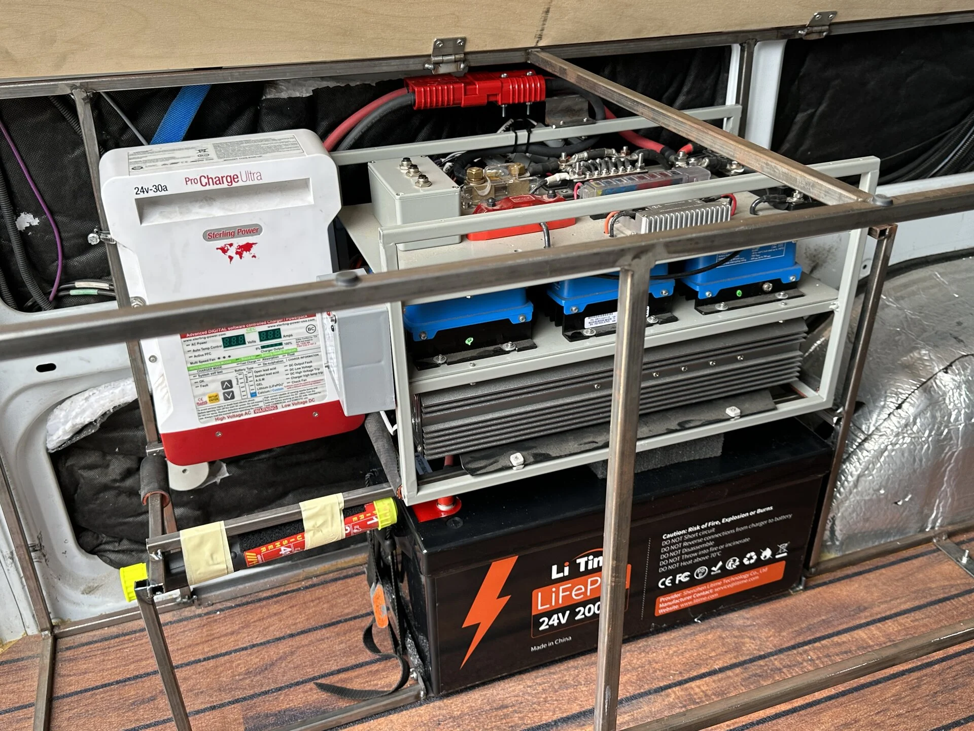

Today was good! Finish the partly the assembly. I need to drill holes for the south co latch and some M6 rivenut tomorrow! Then will pre fit inside the Troopy and start the process of fixing with existing holes in the floors and quarter panel
Completed the battery cabinets today with rivenut.

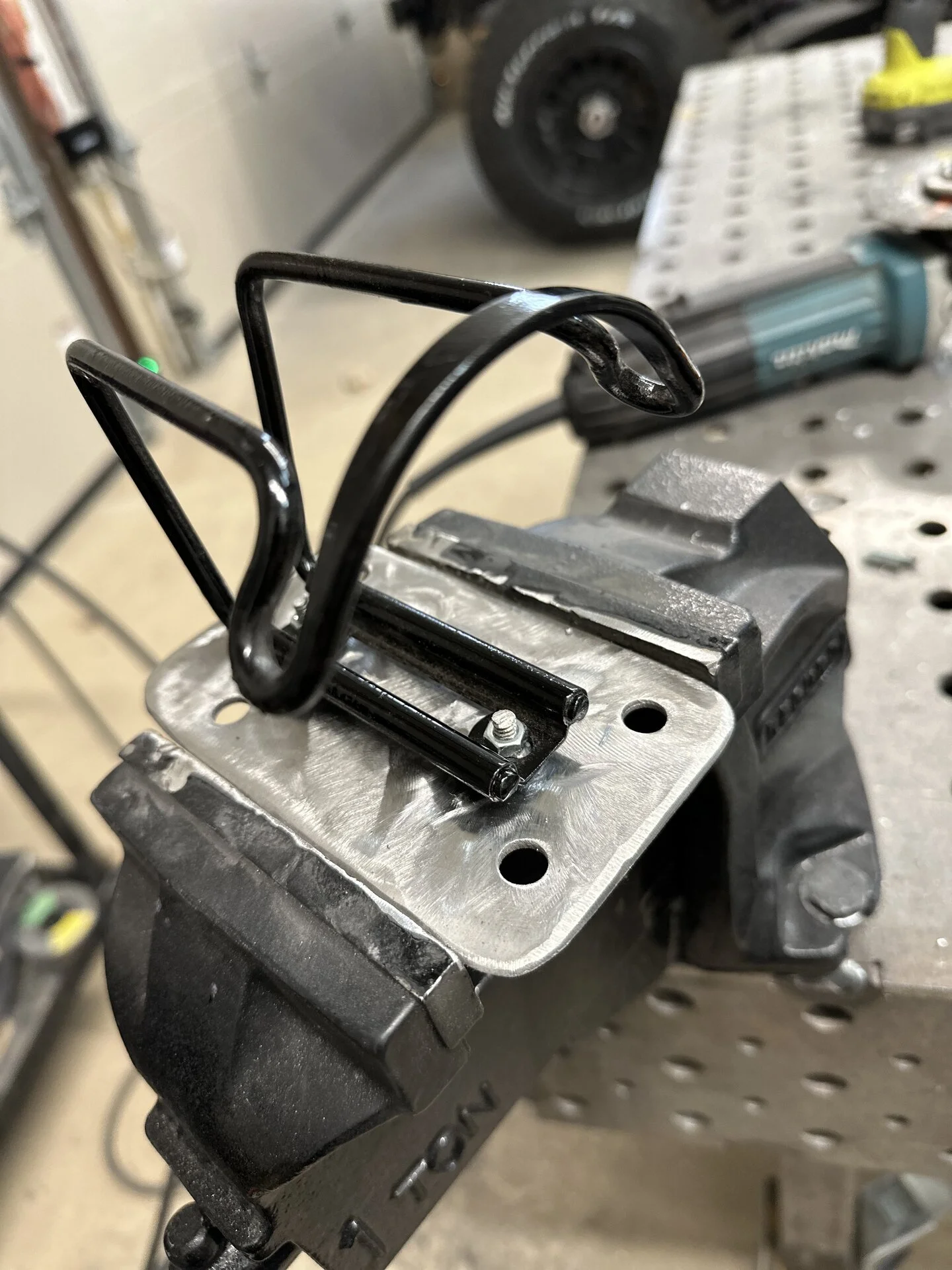

I had this on my mind for a while since my GF drinks a lot water so got it a go

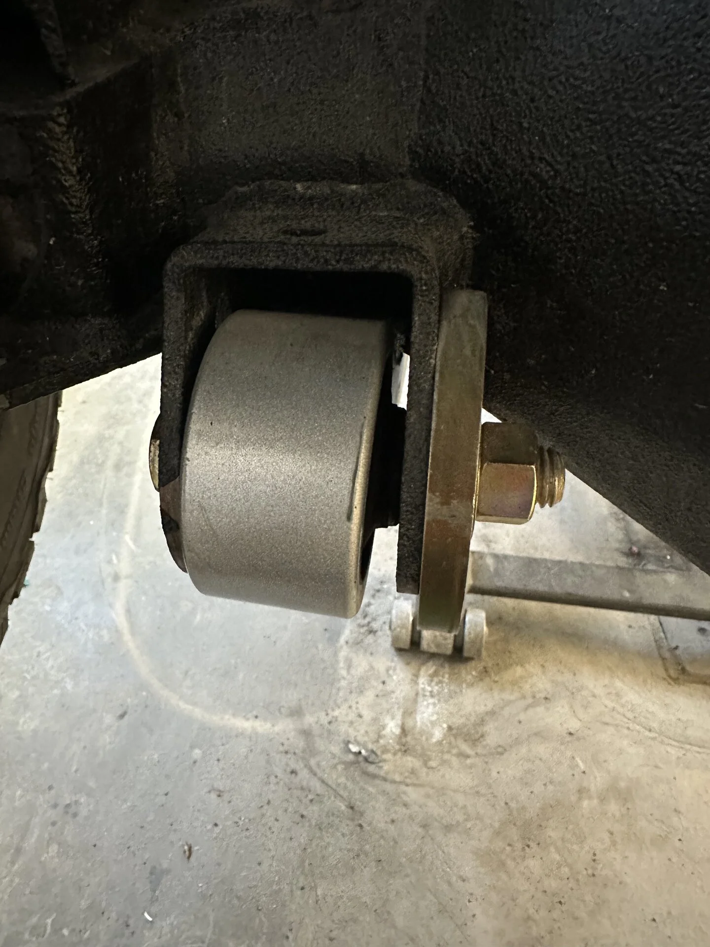

Waiting on DHL to deliver the new Front DIFF housing. Dwizdiffhousings.com.au has been rebuilt for me,
I had to such a great experience as customer service goes they are just fantastic it's the kind of company that keeps their word kinda rare these days!!!
The housing is from VJD so the alignment of the radius arms did not match my HZJ78 we had to move the brackets in order to have less distortion see picture
I ordered new knuckles, and arm pit, and have everything done in new!

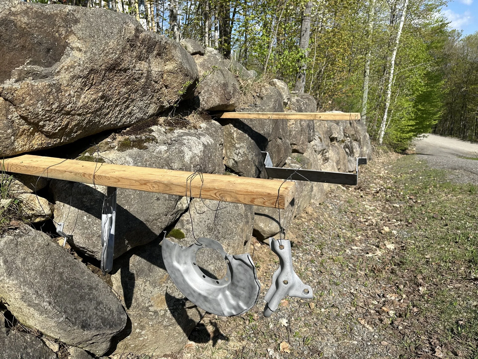

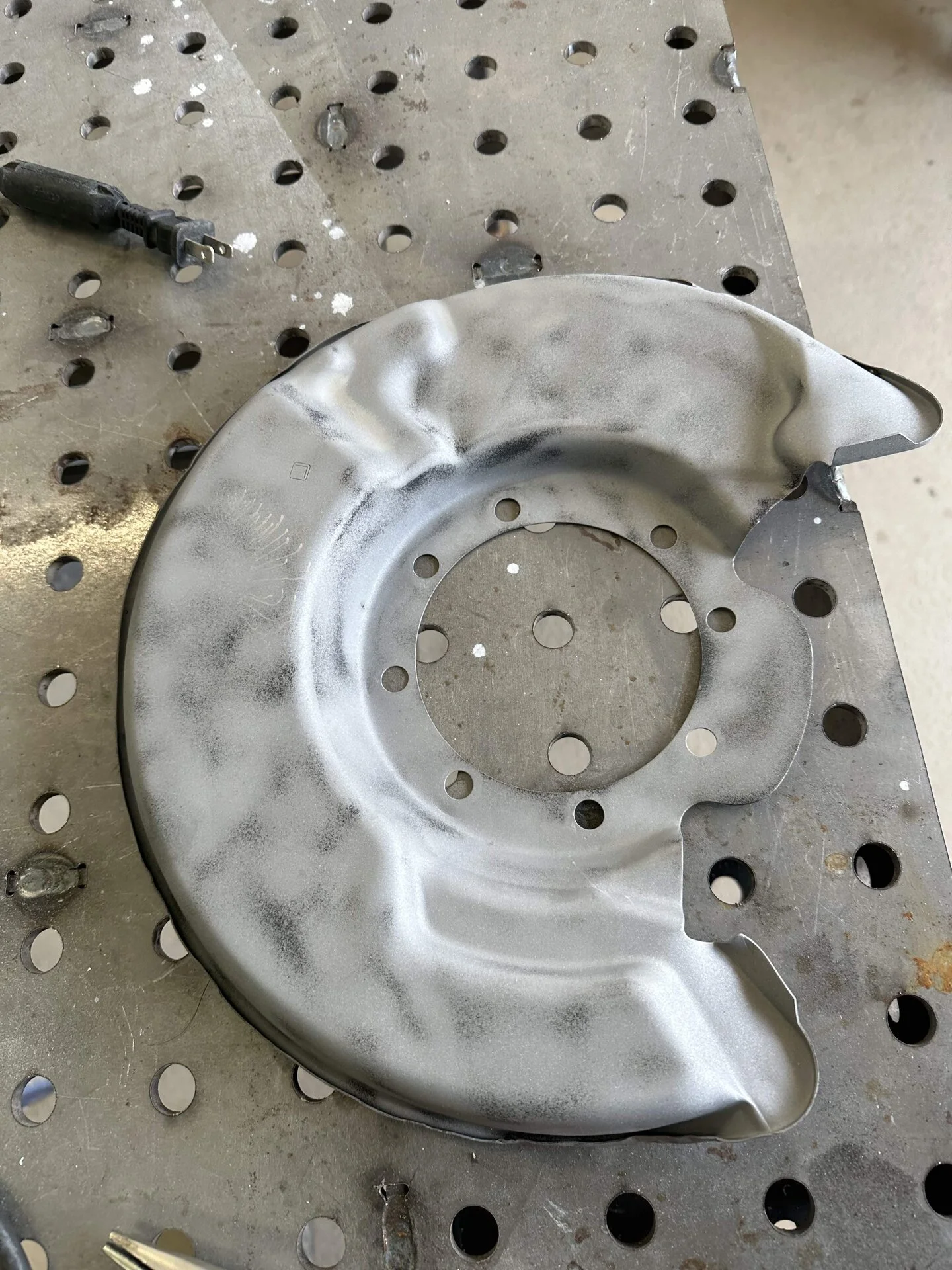

This week will paint the brack covers and other parts to fit the frame's black finish!
Sandblasted the covers need to trim them as well for the rugged brakes to fit too!
