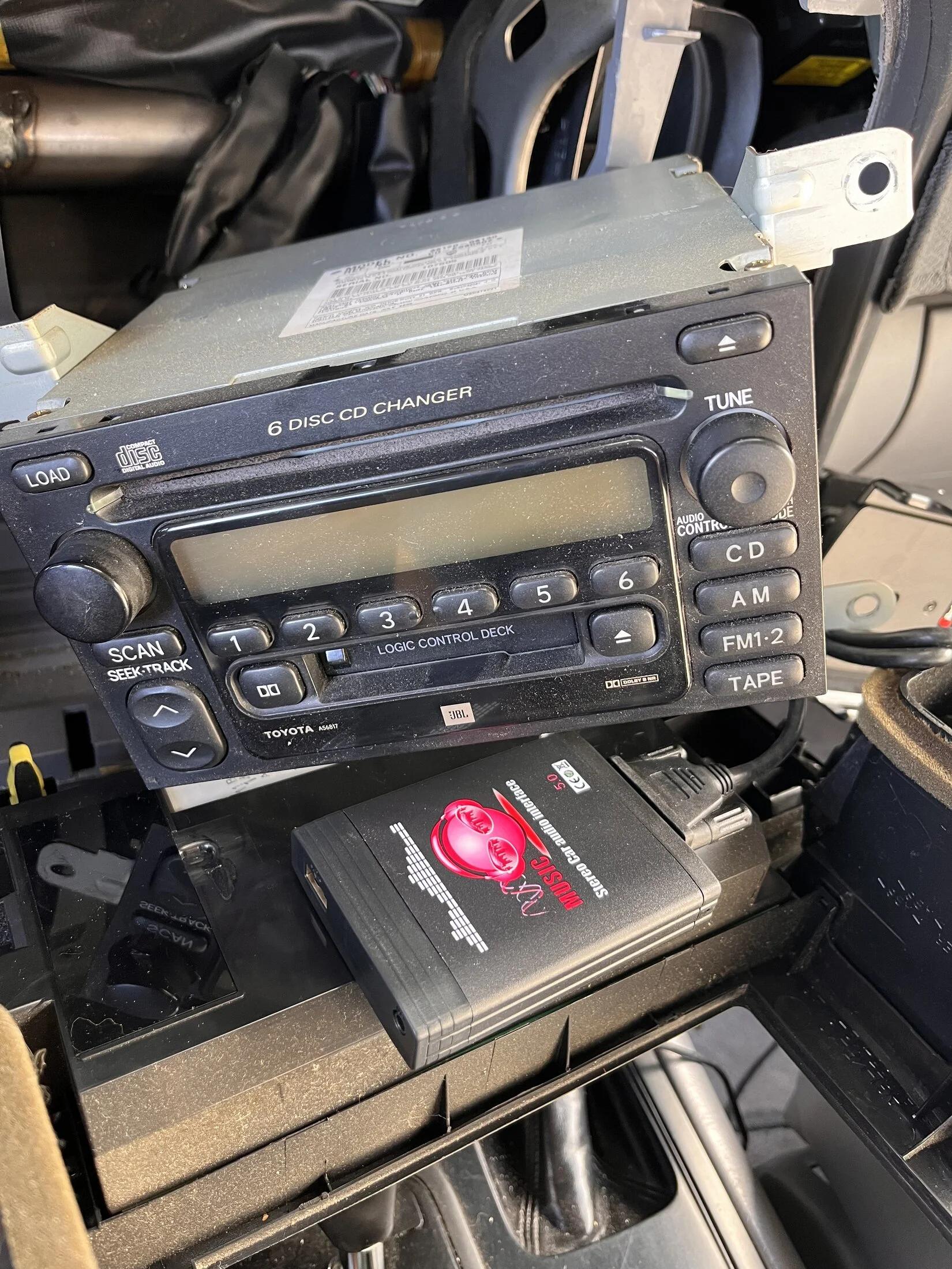

My first upgrade was this Bluetooth adapter onto my factory head unit. Worked amazing and beats those crummy FM transmitters and Bluetooth cassettes (Yes, you read that correctly)
Hooked up where the CD changer would’ve been

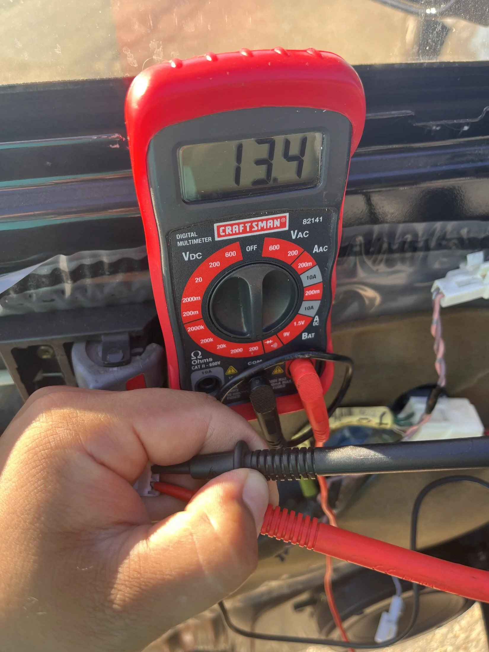

No sound was coming out my speaker. So I reconnected OEM JBL speaker and no sound. Bad possible door harness???

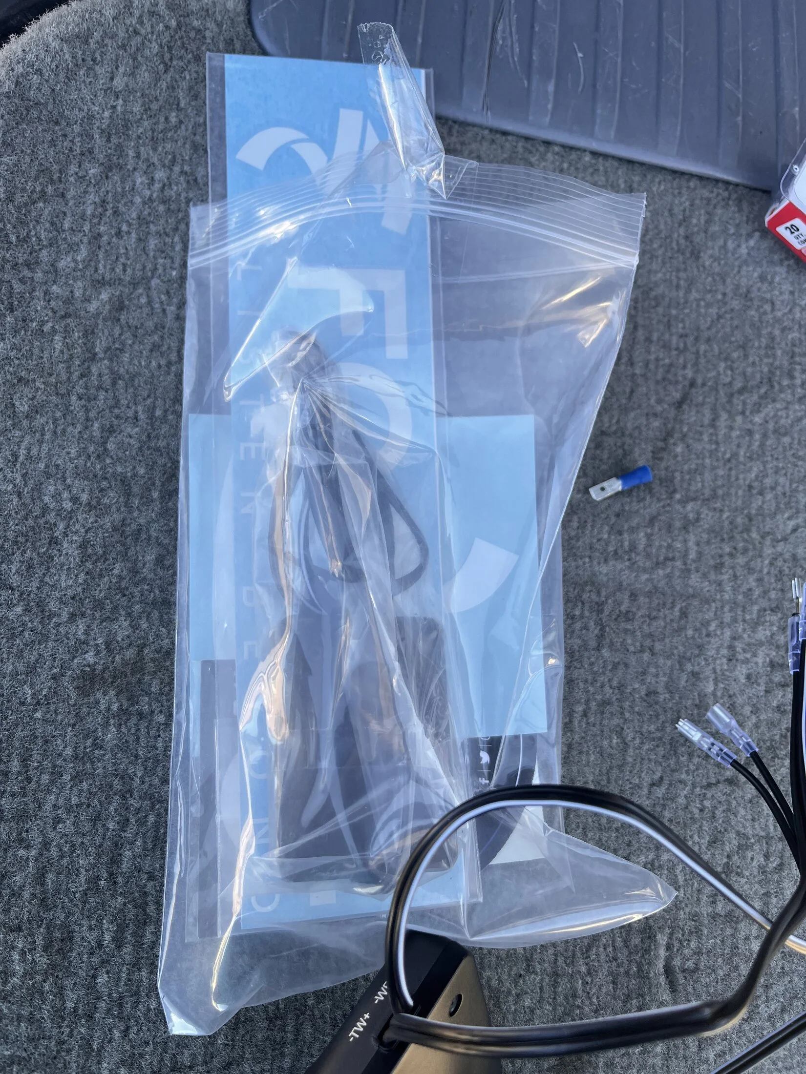

Aha! Nope, door harness was good. So my JBL took its last breath when I disconnected it. That left me a bad crossover from my Focal kit.
The audio gods blessed me. Focal North America branch happened to be a local company. I called and they had given me the crossovers at no extra charge!!!!! I could not believe this!!! Best customer service I have EVER had! Focal fan for life now

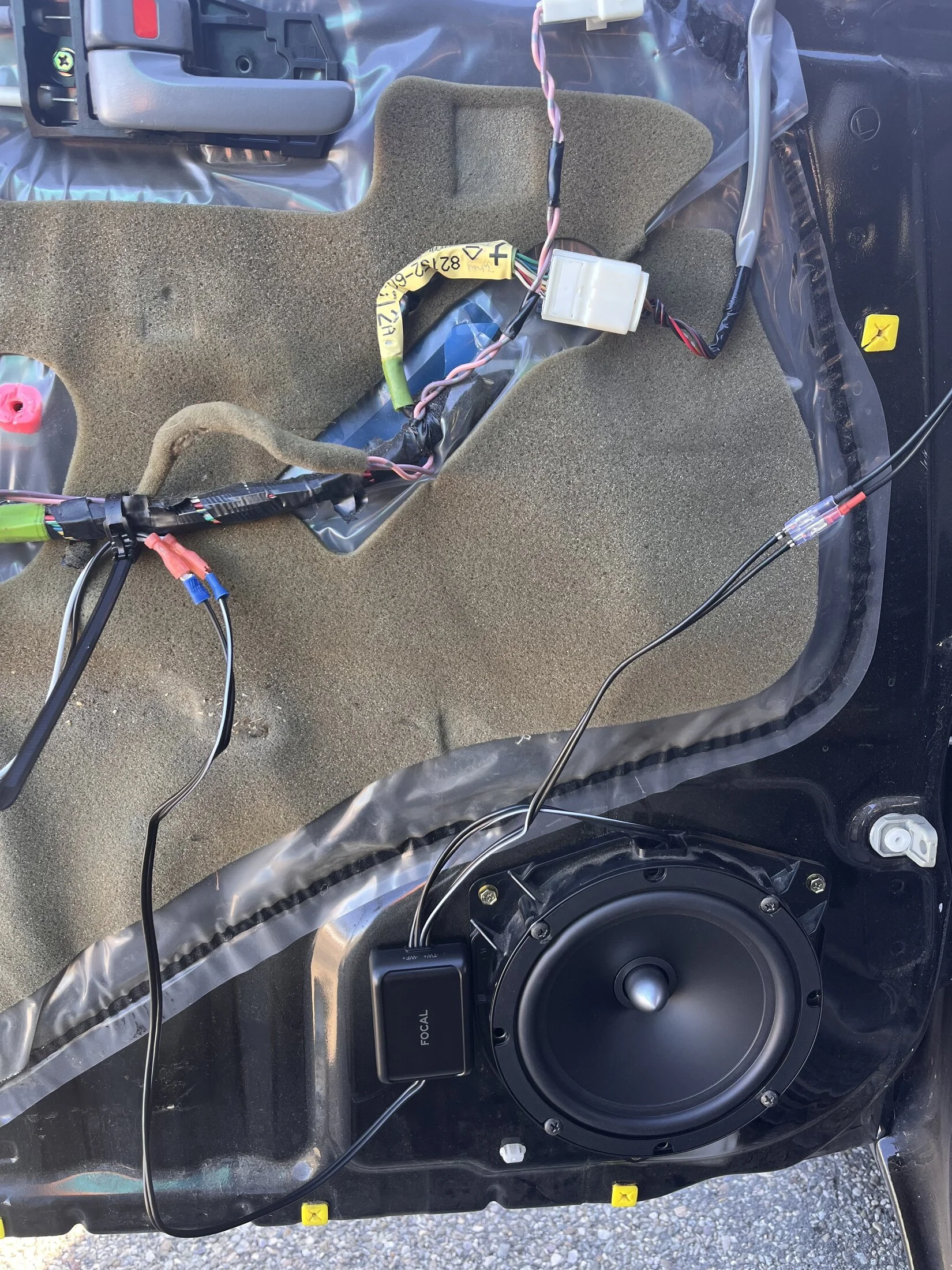

Also to add, Metra speaker adapters were not needed. Pried off JBL speaker (glued on) and Focal speaker screwed on just fine.

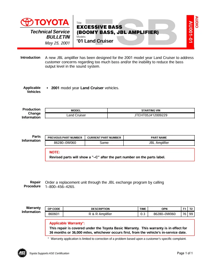

Found this old TSB and highly doubt my amp was replaced when my 100 was under warranty. This issue makes my Focal speakers sound terrible. Bass is way too excessive. This issue alone is also why I'm going to go with a dedicated 4-channel amp, and I want to hear those Focal's sing!

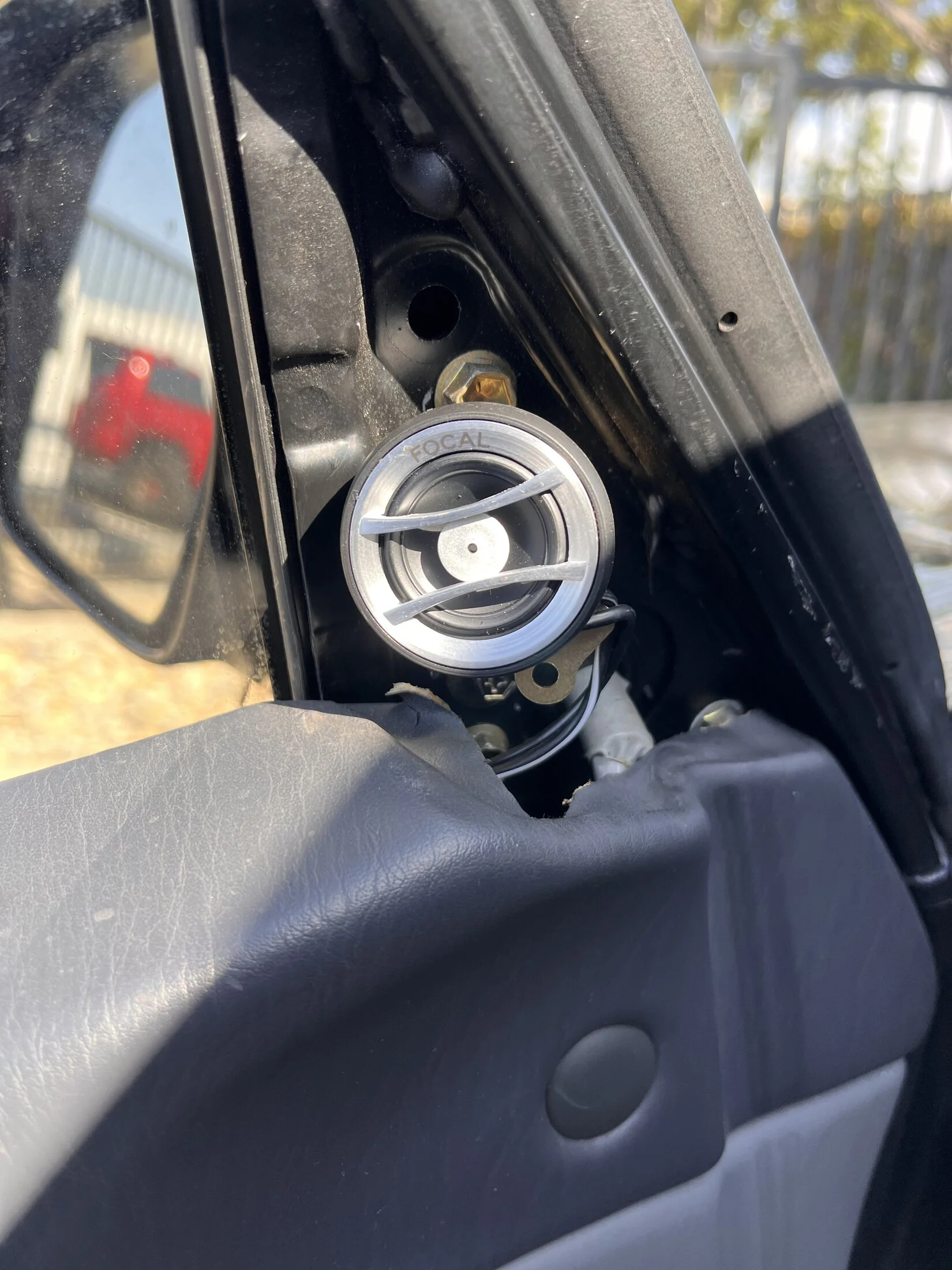

Focal tweeter mounted flawlessly using stock tweeter bracket
Cover mounted easily no issue, no need to modify or trim anything
