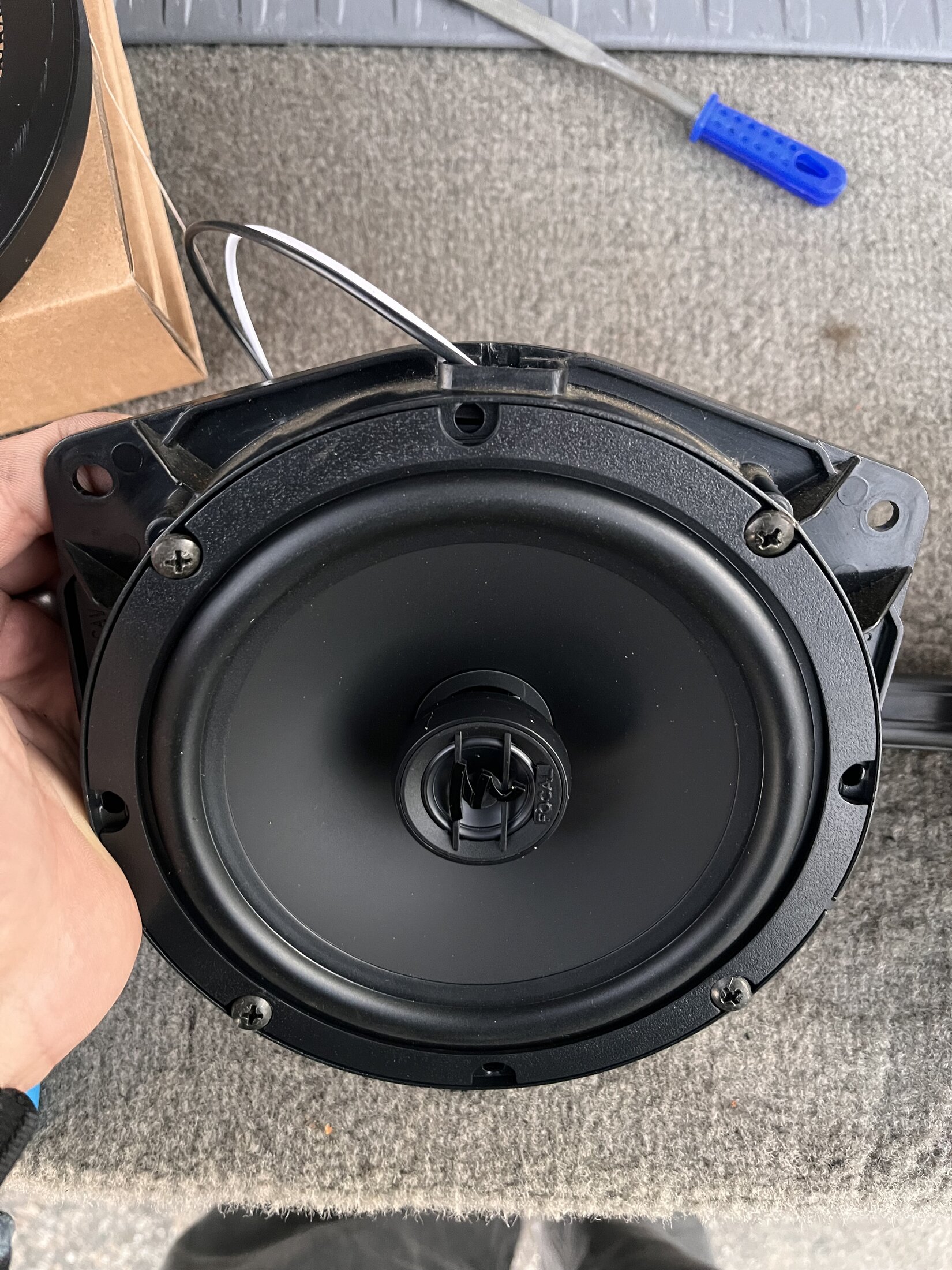

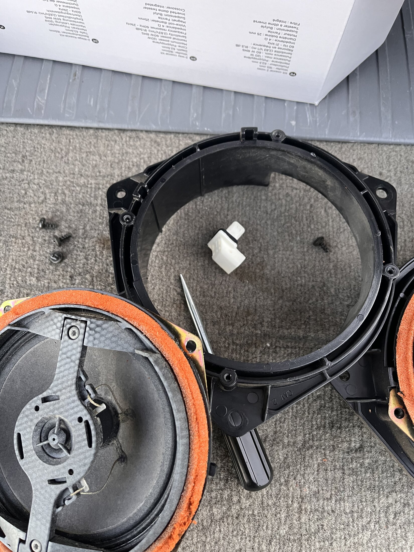

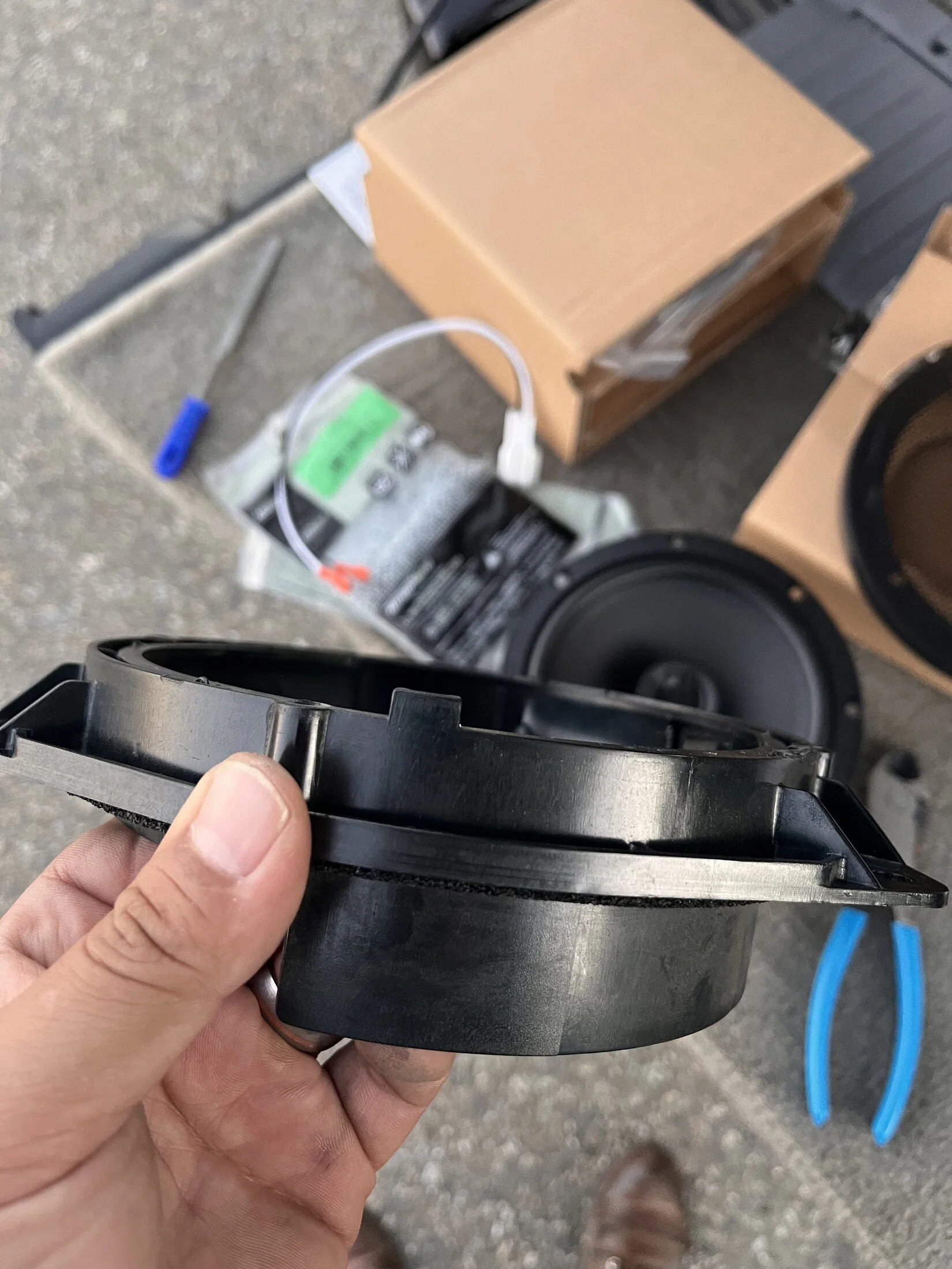

Using the stock speaker housing bracket. Pries off with ease

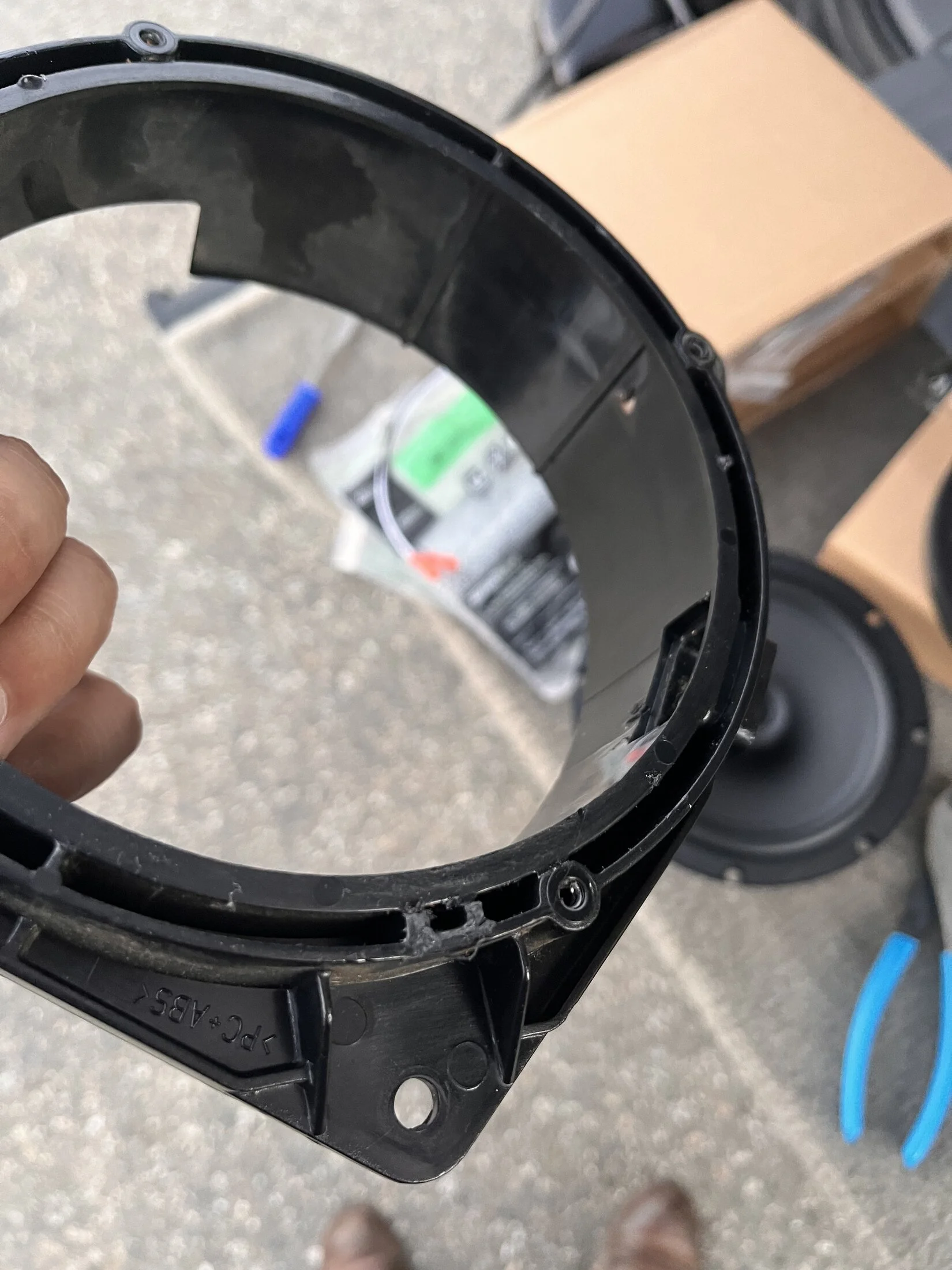

Trim and file down these tabs
Done
