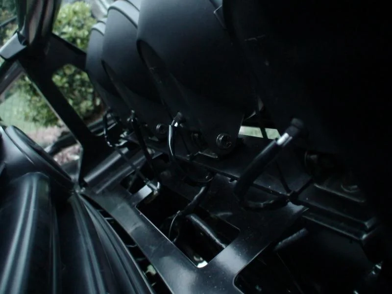

you lost the chrome hoop right? you can probably fit 2 more on the front. Im not sure how the mounting system is but on mine I have a bar with tabs welded on it running across the front to mount stuff with and just made a beam to mount the lights on it.
pics of light mount... how are yours mounted?

I did lose the hoop, and the Hella's are mounted in the stock ARB holes next to the Winch Opening... so, I could probably customize a new bar but honestly I'm not up for adding any more lights... I need sliders first!!! And HID's of course!!
mmmmmmmmmmmm that's nice!
