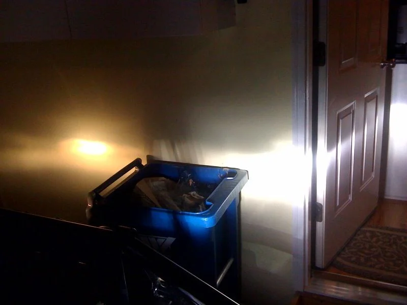

Noboby took a picture on the same road, before and after ?
Only comparison shot. I probably have some of the halogens but I can't find em. I took this with a cell phone, so it couldn't really capture what's left of the cutoff. The door shows a bit of it.

In out if town without my 100 until Friday. Until then I won't have pictures of anything other than a few night shots and crappy engine bay pictures.
Gotta love that pic of the blue bin! :flipoff2:
