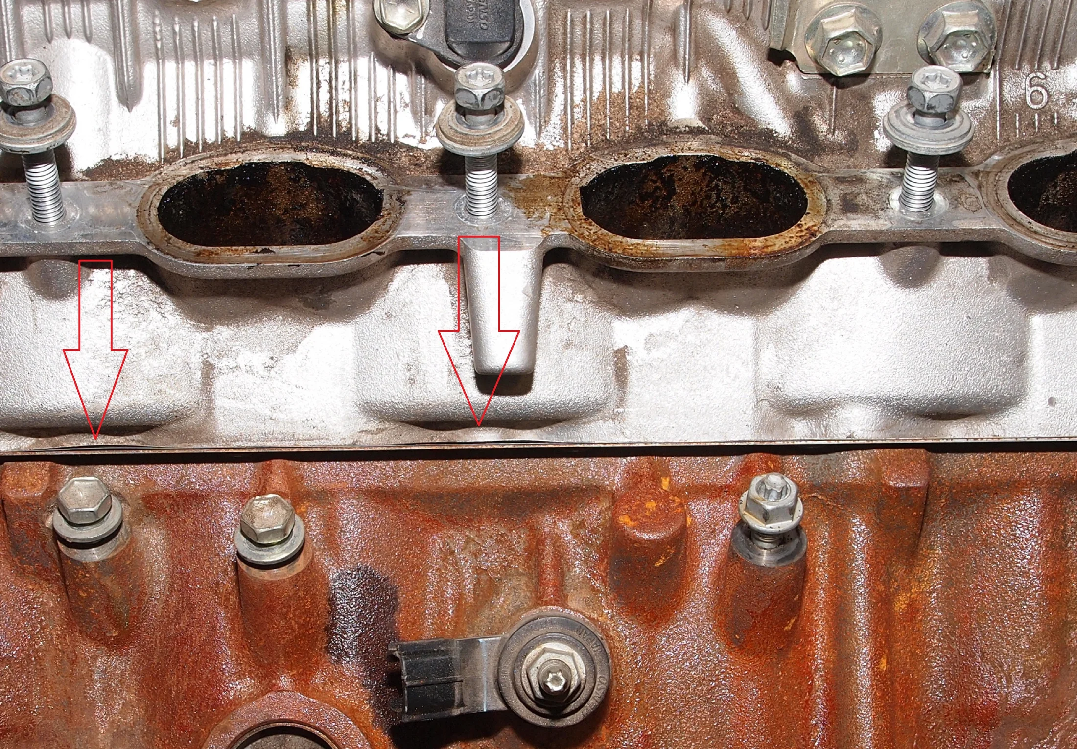

Warped head. We can see in this one, head gasket delamation.

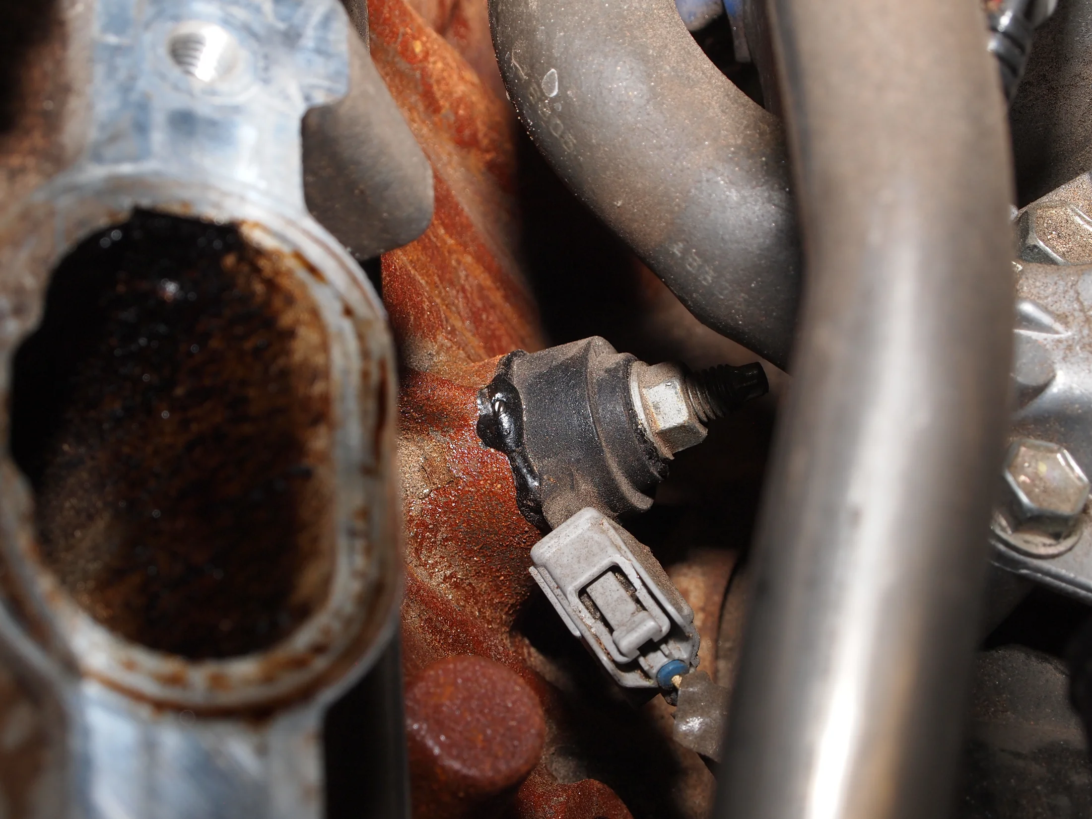

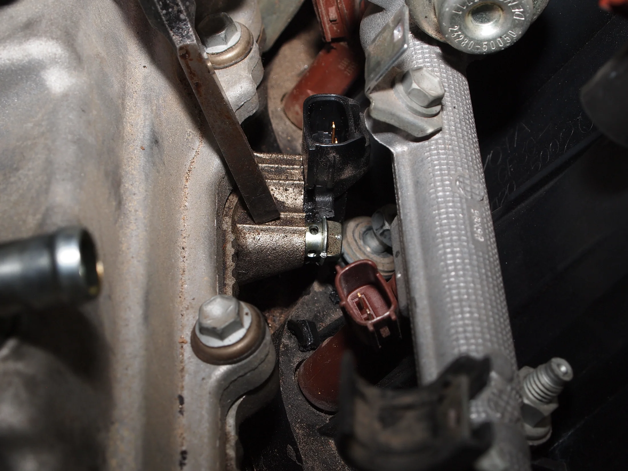

Knock & VVT cam sensors and other plastic, melted

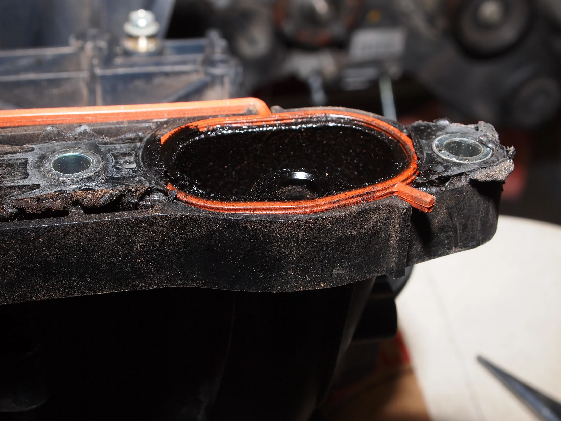

4.7 2UZ-fe VVt has plastic intake manifold, which melted also.

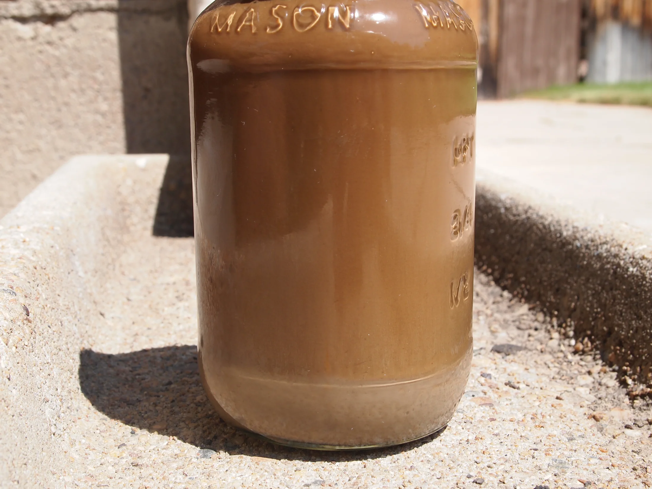

Coolant in oil
Coolant in oil

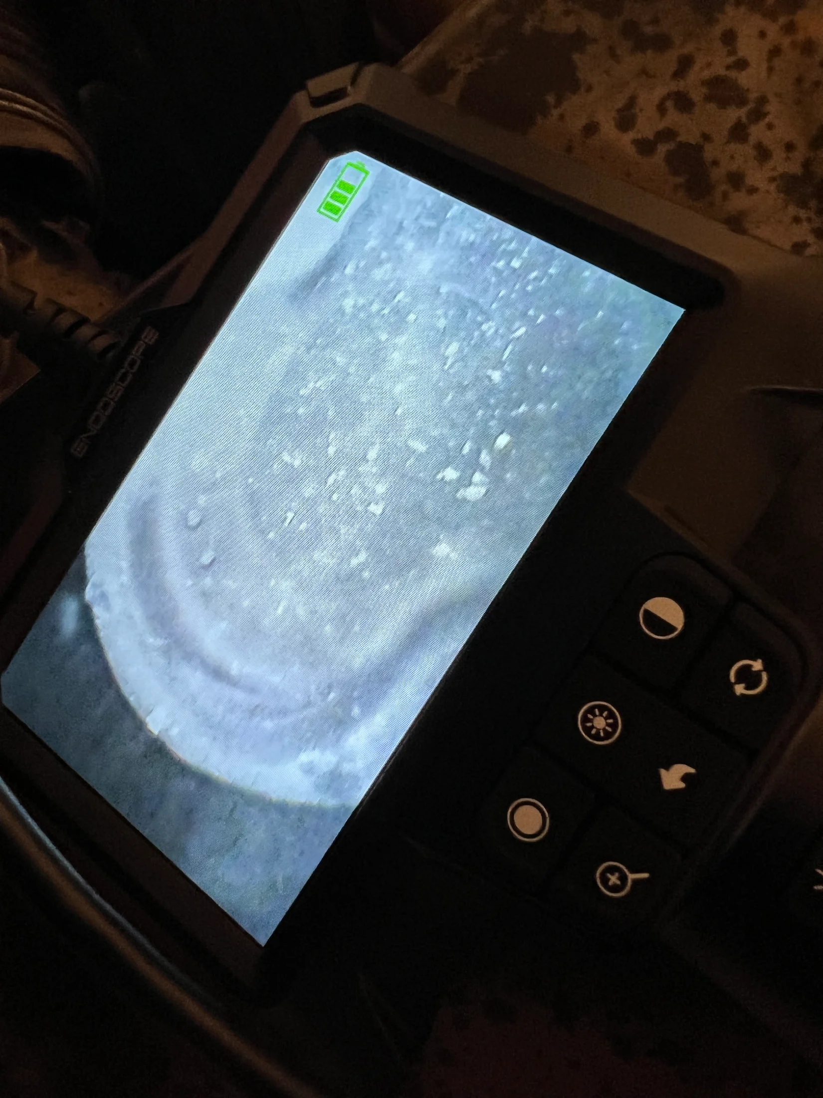

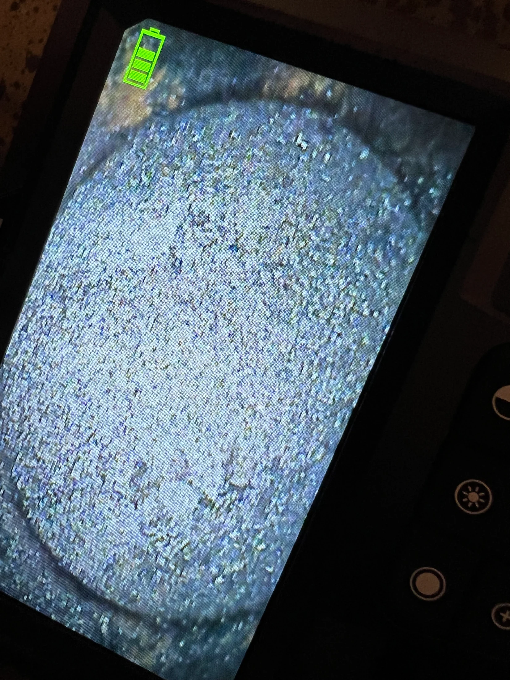

I did scope them myself and do see some scoring, but unsure on the depth and don’t see a crack and not sure about the oblong head shape, they look normal to me. I do see some debris on a few heads and one head is covered in burnt oil but that’s it.

Thanks for the info! The cylinders don’t look great but also not super clean or anything, it’s hard to tell with my crappy scope cam. I guess I can take the heads off before trashing the engine.

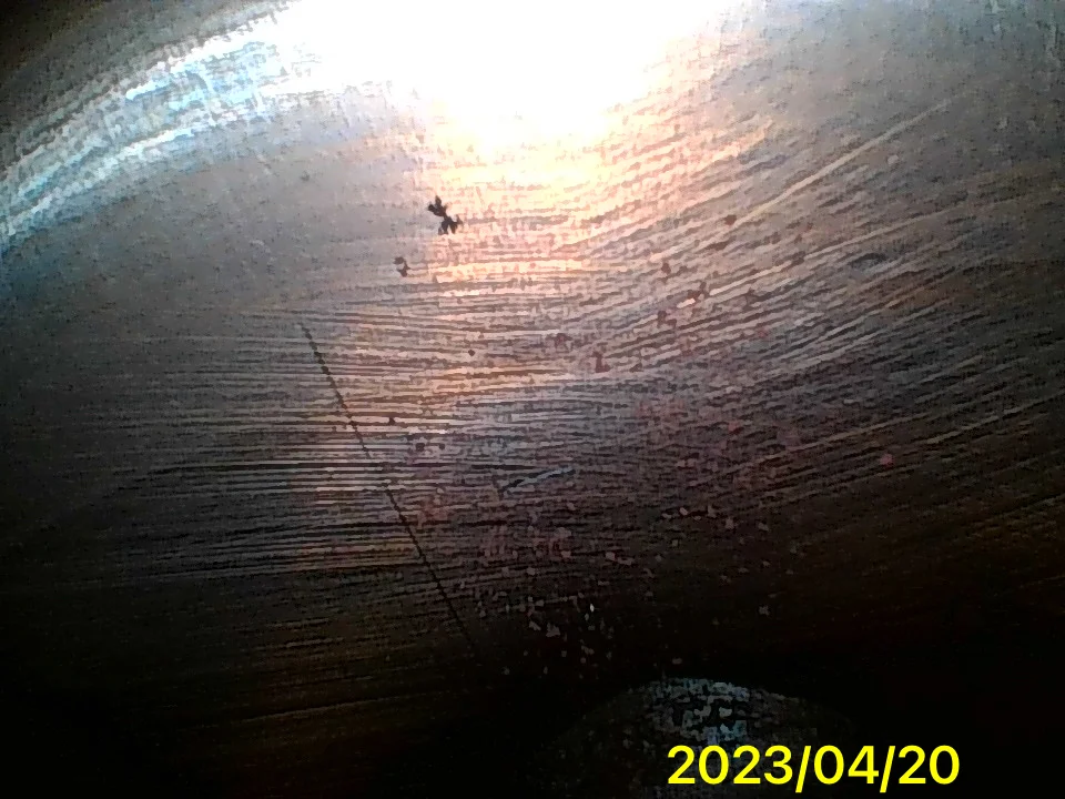

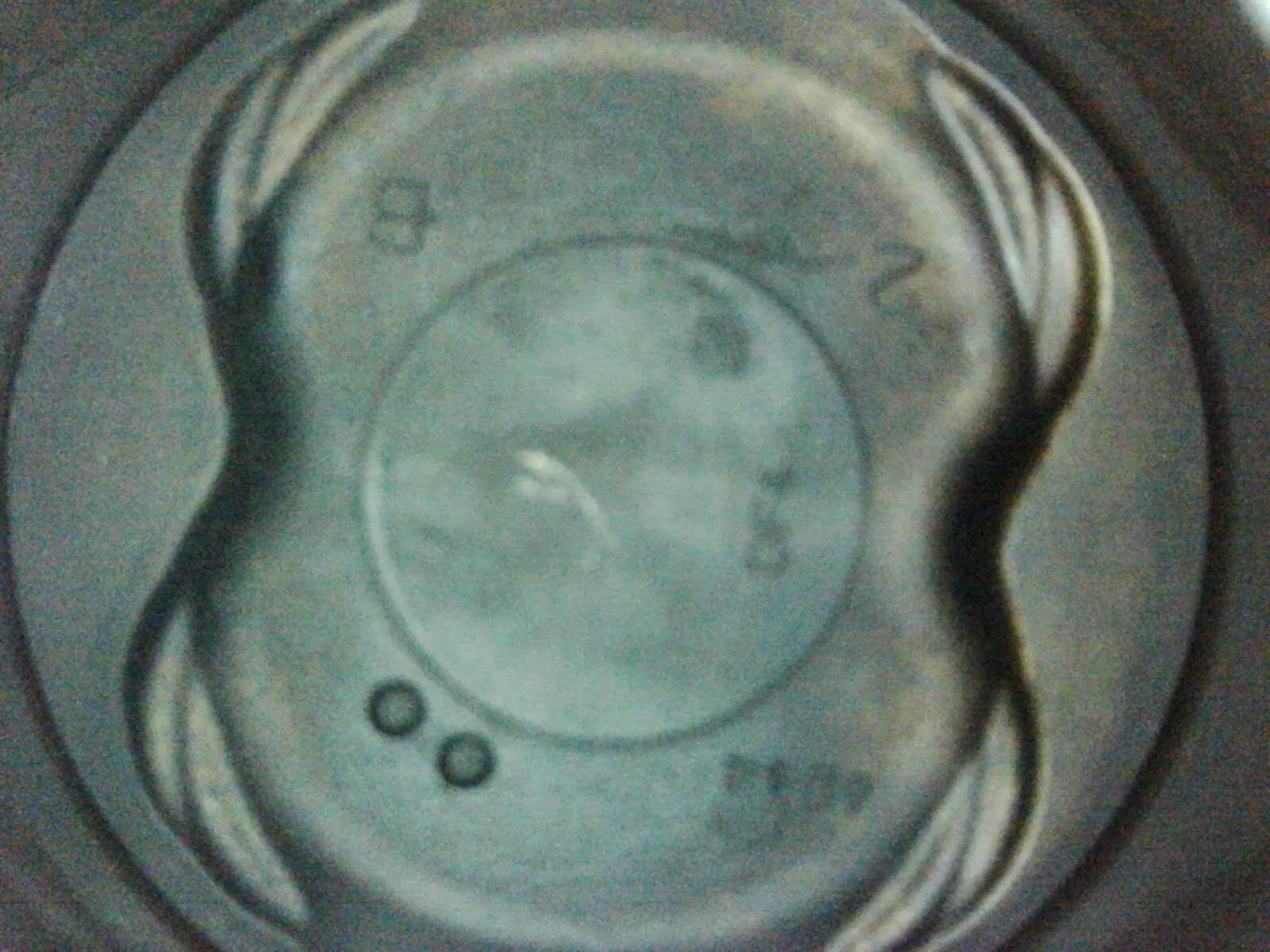

A good cylinder looks like this:
See the cross hatch marks from factory honing. With just one minor vertical score line.
Make sure to turn crank, to get piston to bottom, in each cylinder as you're viewing it. Vertical lines (top to bottom, is scoring.
Wide lines and groups of lines, where you can not see honing hatch marks passing through them, is not good.

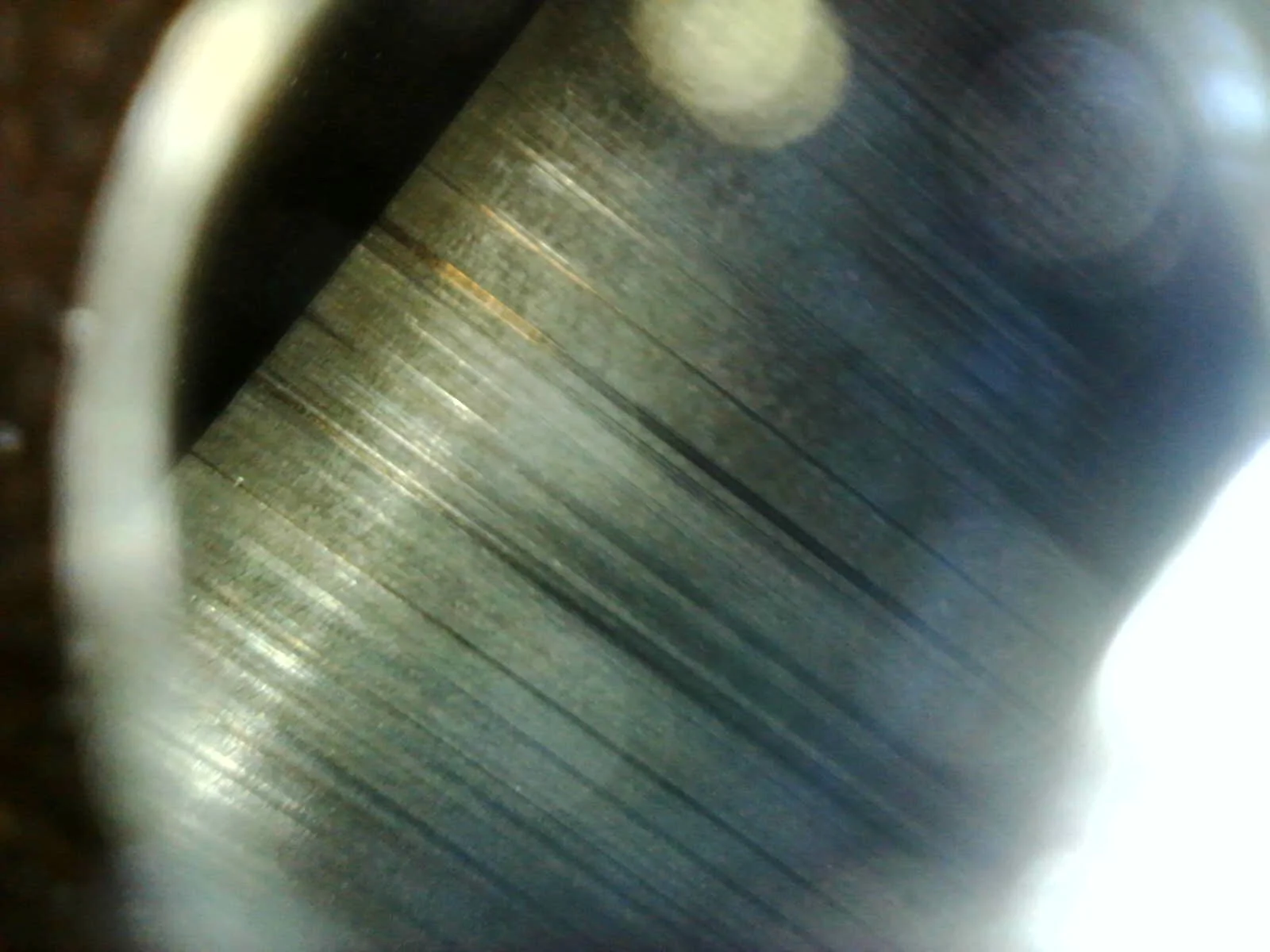

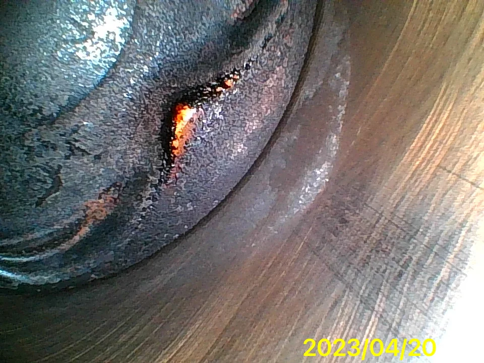

Trashed:
Piston tops or valve clean, not good. This one is steam cleaned, from coolant in combustion camber.
Trashed:
