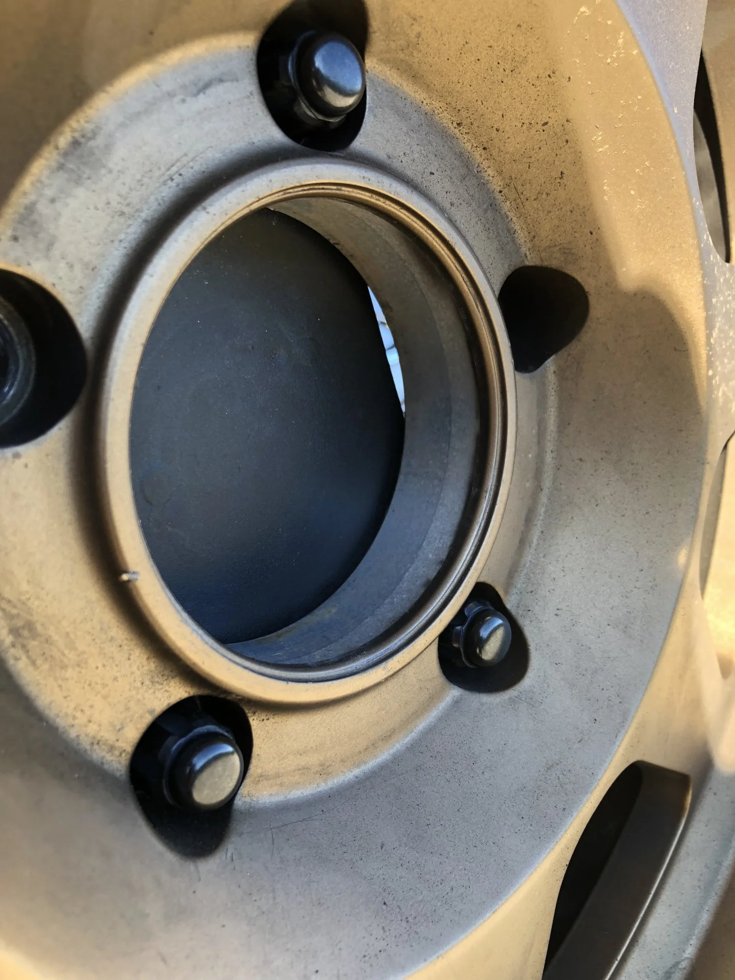

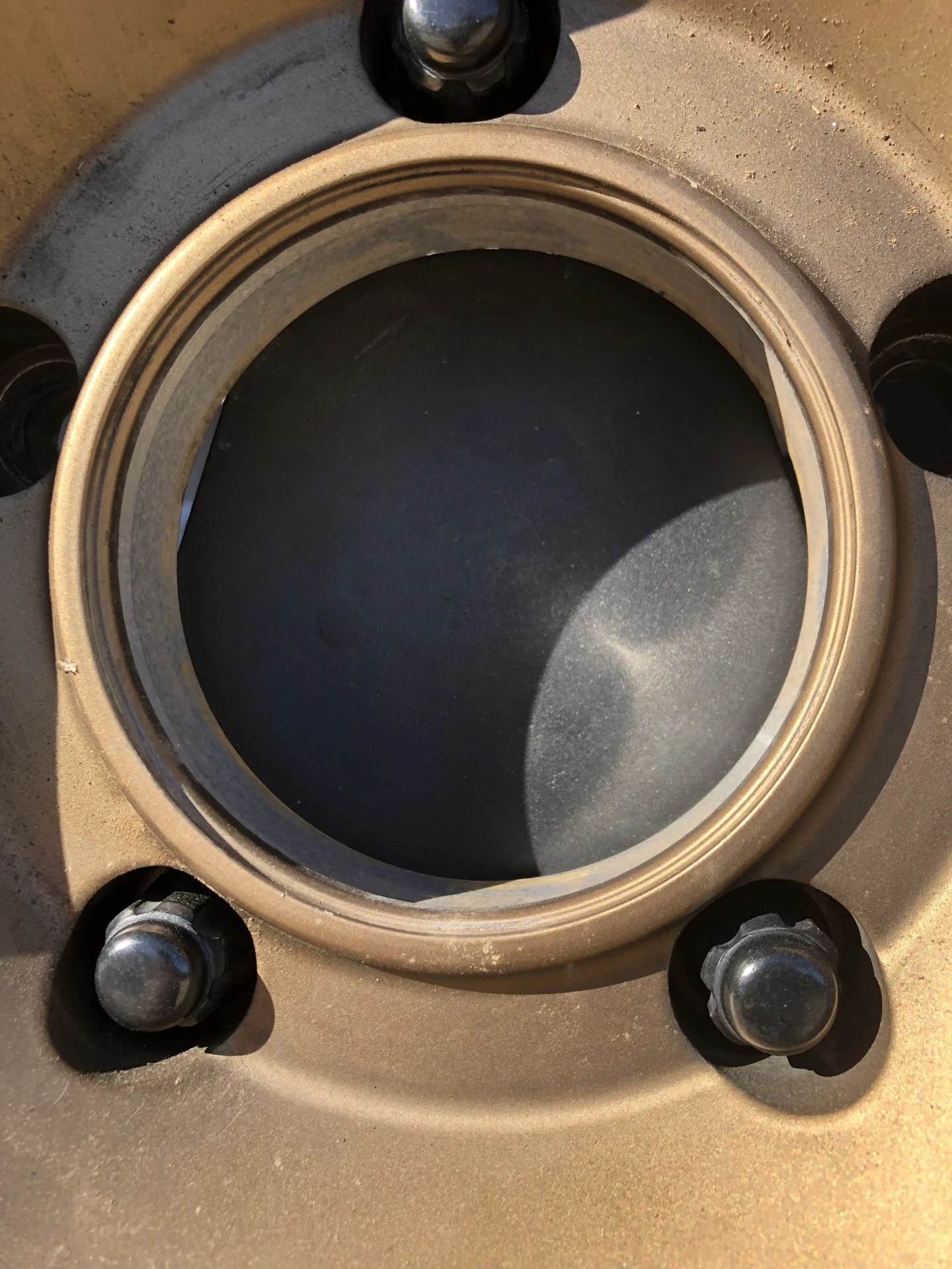

So doesn't look like you had any issues with the center caps fitting. I spoke to method today and they said the big grease fitting in the center of the hub can cause issues with the center cap fitting unless you run a thin spacer to allow clearance. No problems with this on your rig?
No issue at all, the center cap is at least a good 1/2” away from the hub with the wheels’ 25mm offset. That issue may be with the 100 series Land cruisers.
Ok cool! Did you use snap on centers or push through?
There are 2 different size grease caps for the 200 series. They are interchangeable if you need to install the lower profile one. I’ve also heard of people taking a mallet to “adjust” the depth of the bigger caps. (I might be confusing this with something 100 series owners had to do… Point being it can be worked around without using wheel spacers).
Thanks for the share knowledge! That helps a lot!
The wheels came with push on caps the seat about 1/8-1/4" into the center of the wheel.
Good info, thank you!
Here are a couple pictures showing where the cap clips into the wheel.
