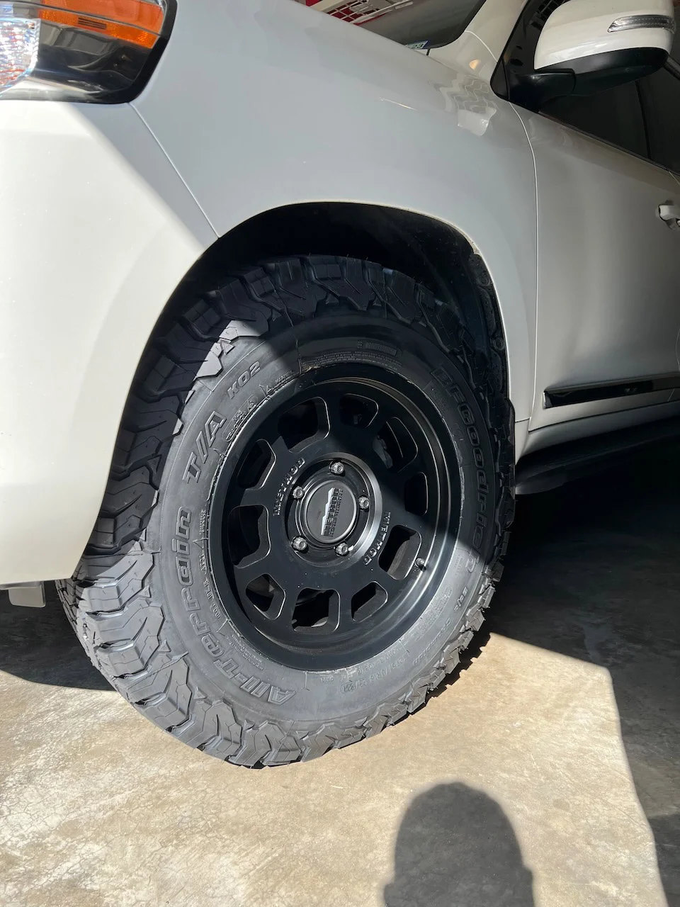

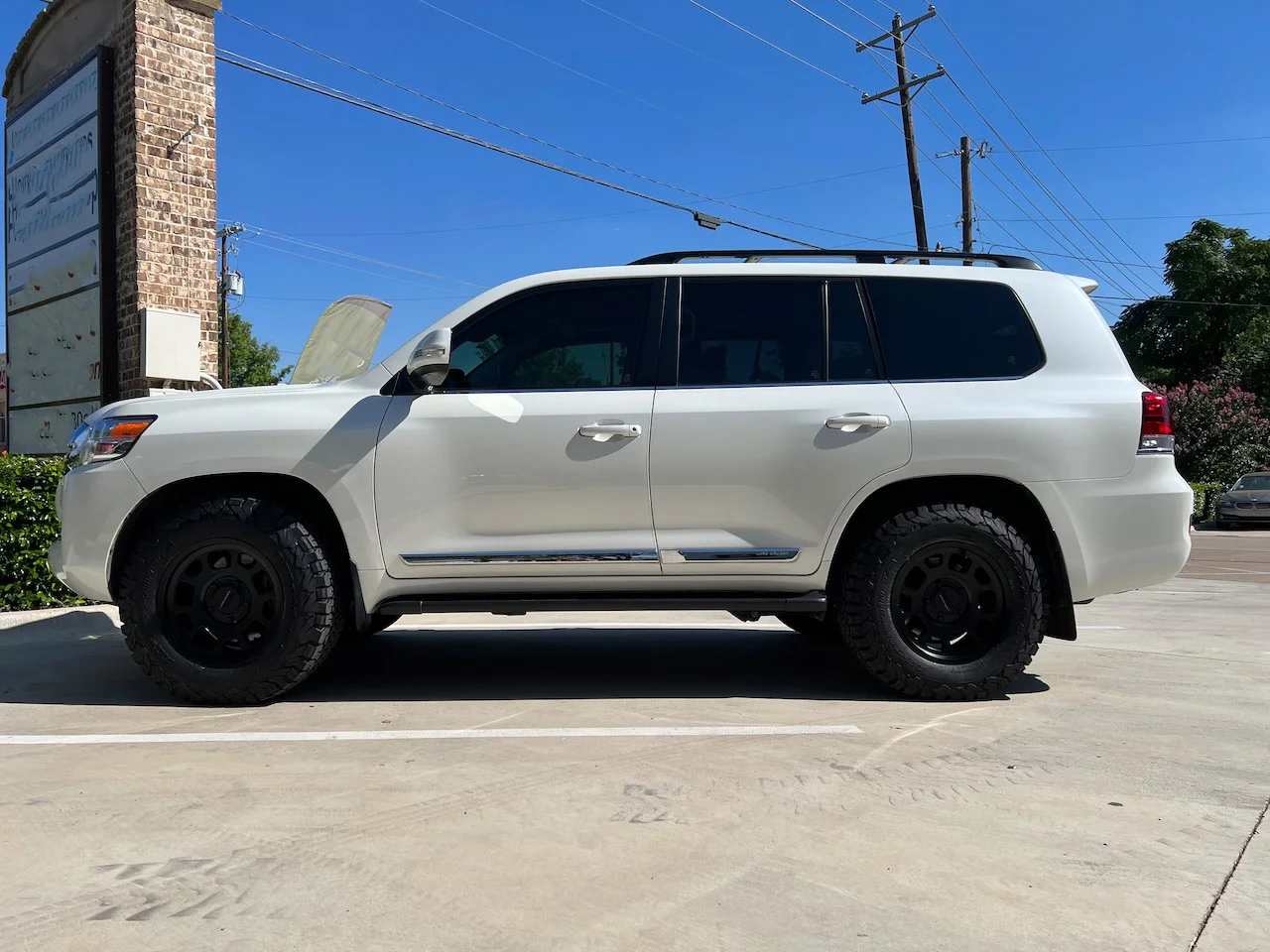

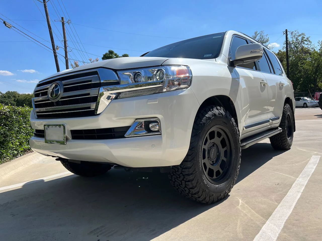

2016LC 200 got some new wheels (Method MR705 18x9 +25 offset) with BFG KO2 275/70 18. Don't see too many LC200's with Method wheels unlike on Tundras or 4Runners. I had analysis paralysis for months but finally made it happen. Minor rubbing on mudflaps but going from 31's to 33's really fills out the wheel well without any lift/suspension upgrades.

View attachment 3121397View attachment 3121398View attachment 3121399

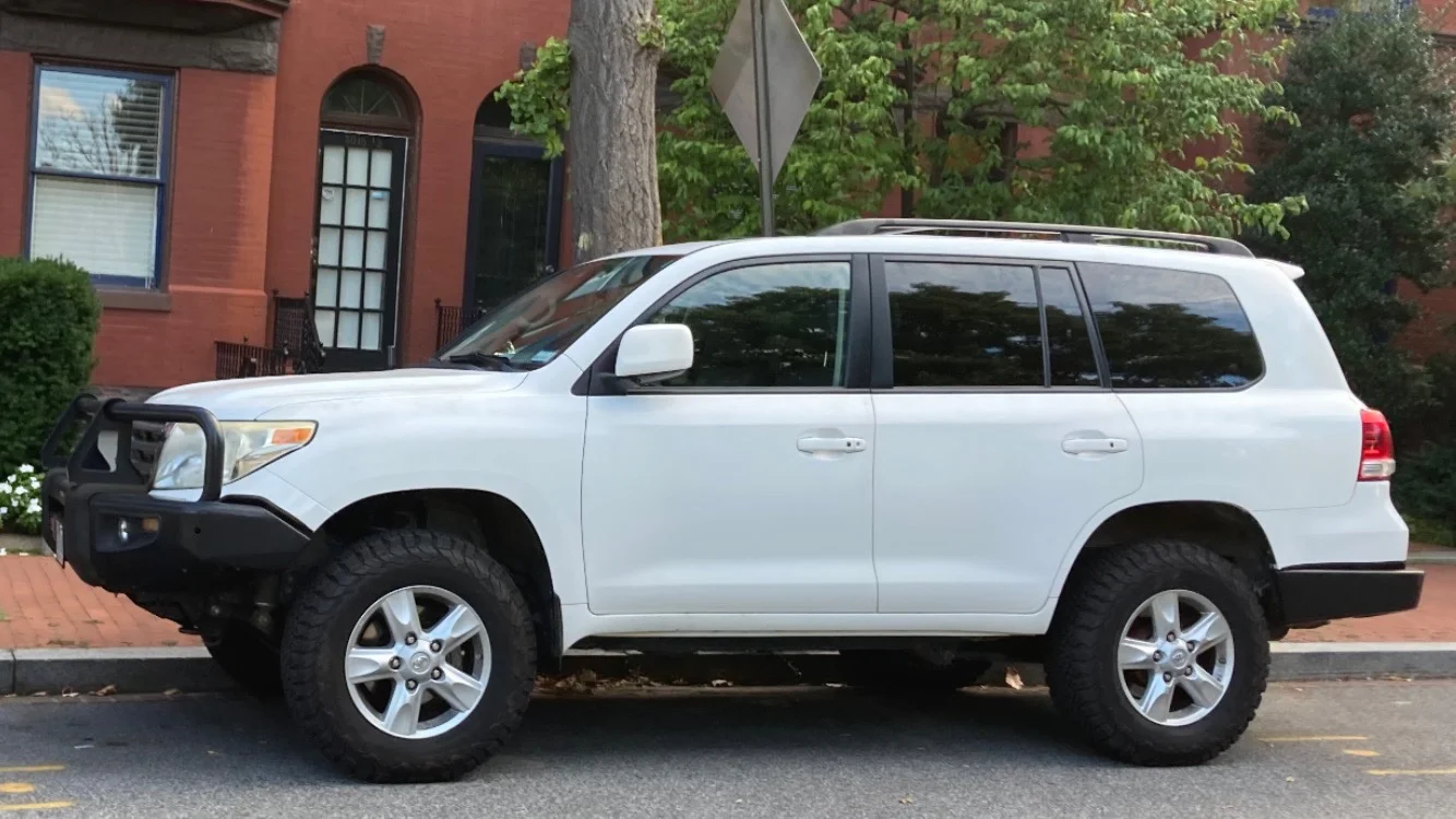

Those tires look much larger when it’s not lifted. Now we need a photo of these tires on a lifted 200 for comparison

I've got some in the garage, different model but same size and I was planning to run them with the 275/70/18's that are currently on the truck with the stock wheels. I was worried about how they'd look but I am digging the stance so thanks for sharing. What part of Texas are you running around in?

DFW area…How bout you?

Yup- Here's my just lifted '08 (Old Man Emu 2" front, 0.75" rear) with Spidertrax 1.25" wheel spacers and 275/70R18 K02 tires on the OEM wheels:
