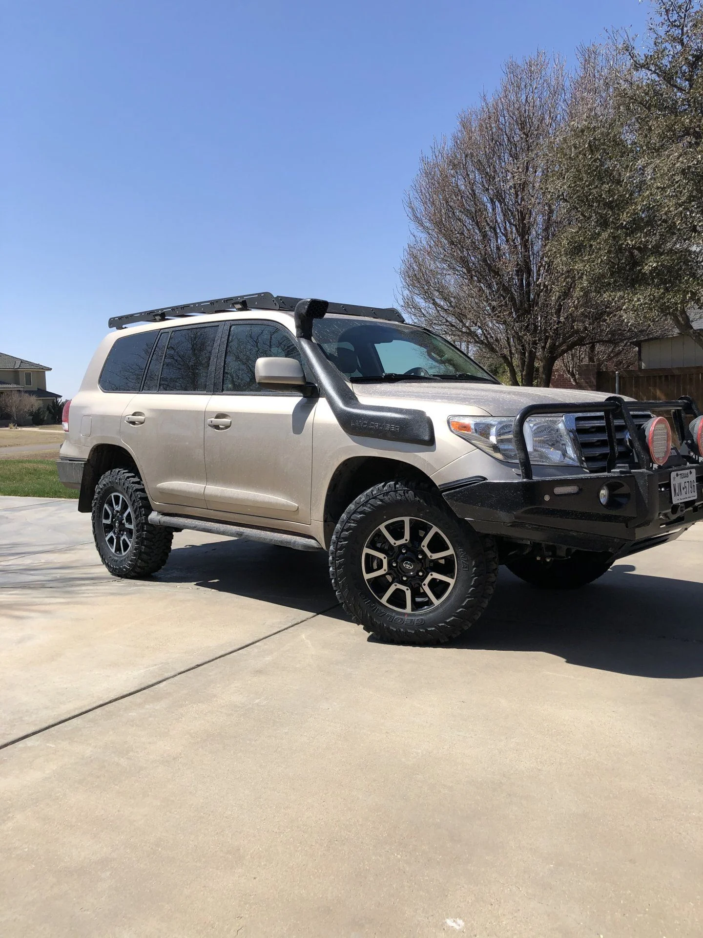

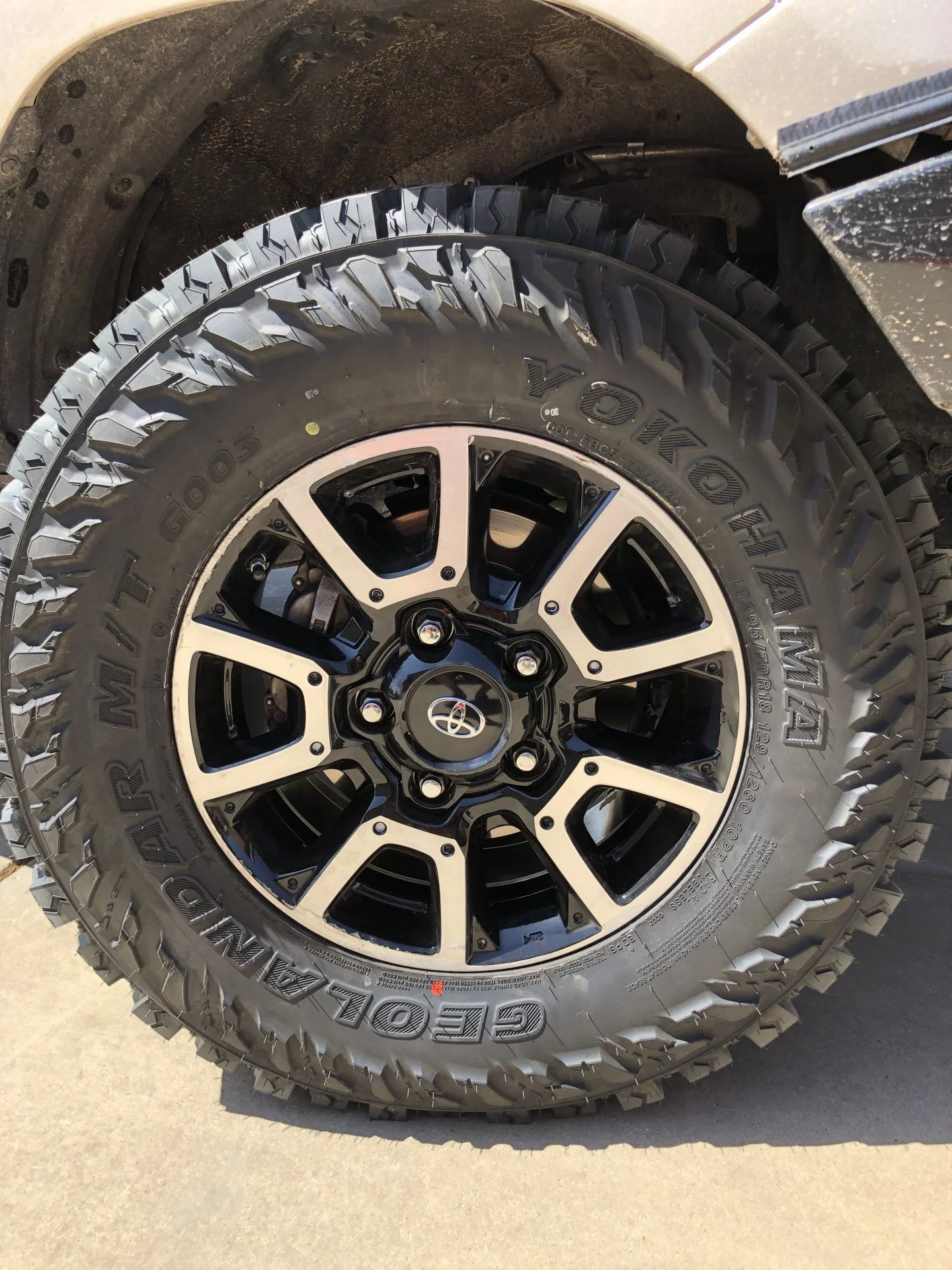

No issues or modifications needed going from 21 inch on my 2017 LX to Tundra 18 inch wheels and Toyo Open Country AT3 in a 275/70r18. Right at 33 inches. Spare fits fine as well.

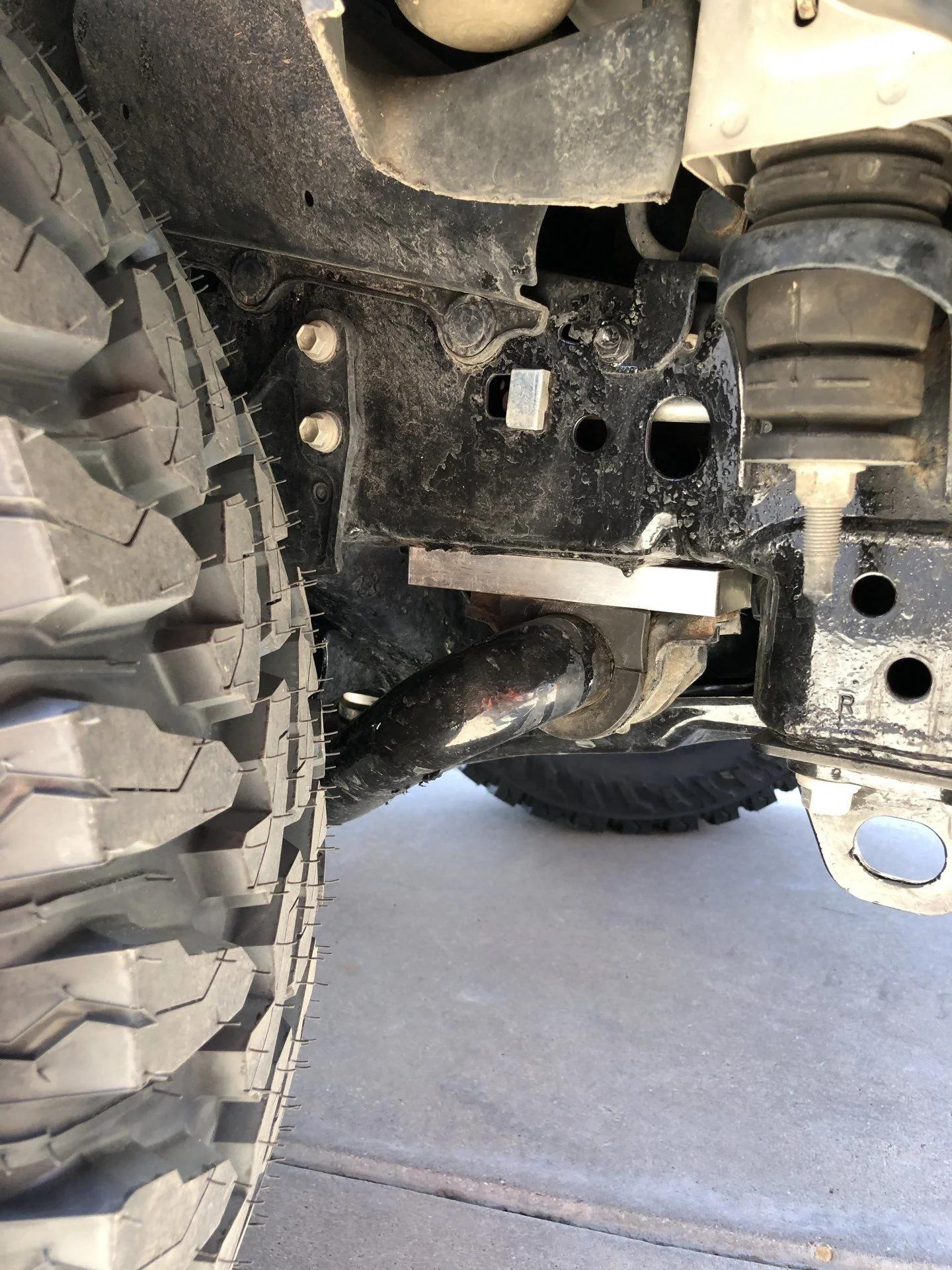

There is no 100% way to avoid rubbing with 34" on KDSS without relocating it.
Stick to ~33" - 285/70/17 for rubfree experience.
