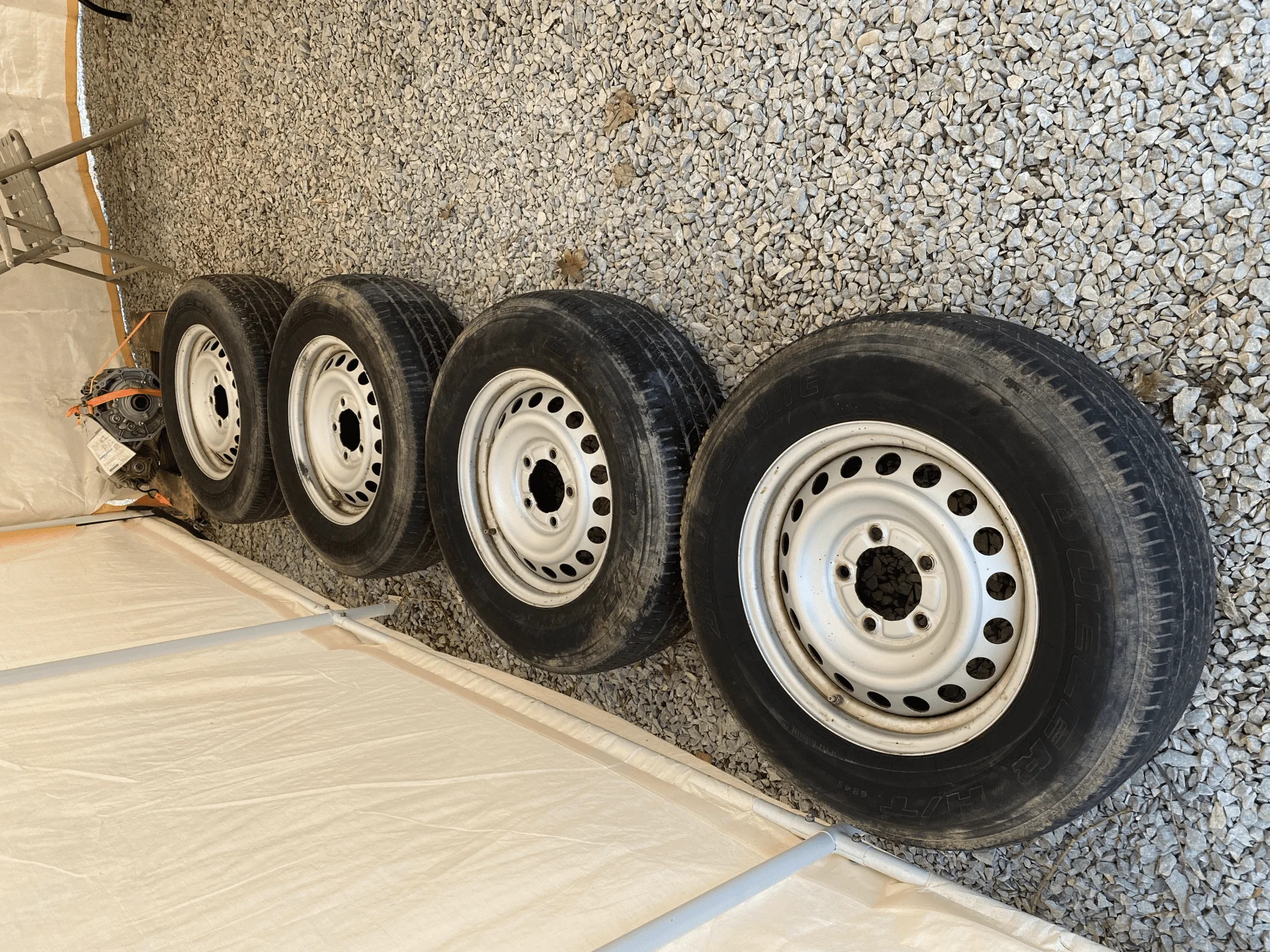

Does anyone know the offset on the factory toyota tundra steelys? Or does anyone know the biggest tire you can do on steel ones? 275/70/18 is all I can find right now. that seem to fit with no rubbing maybe
Pretty sure they're same as most factory +60mm.

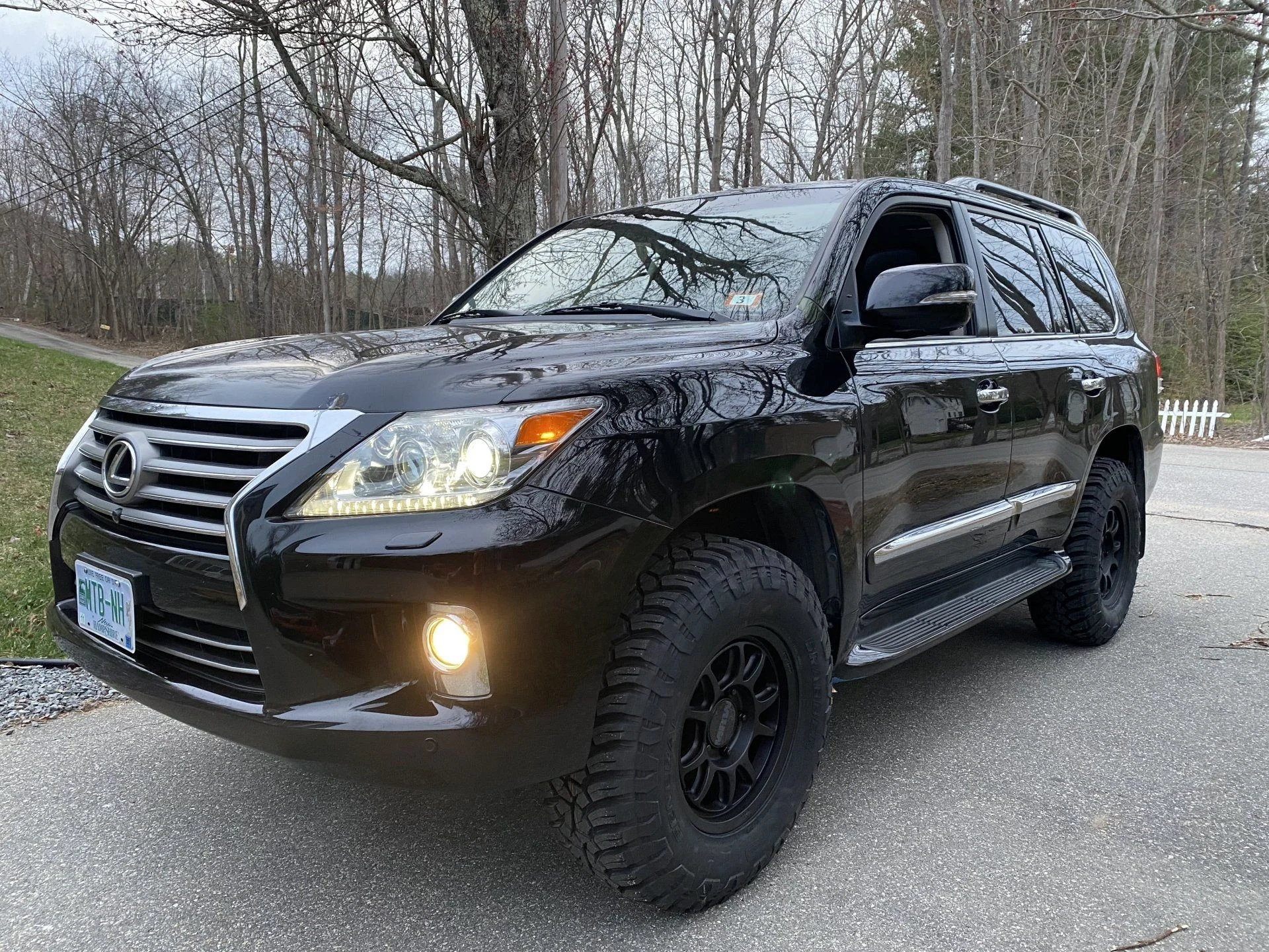

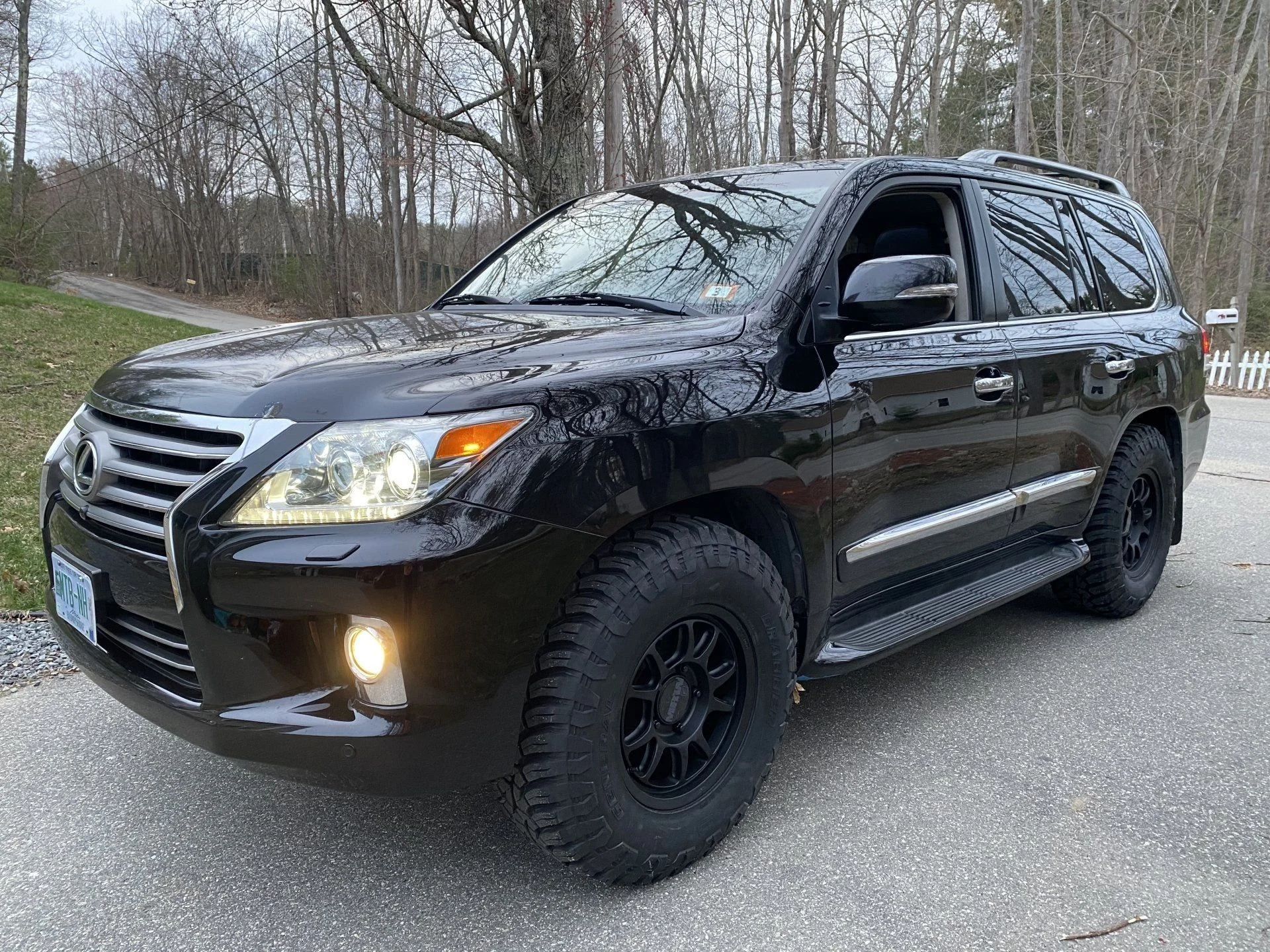

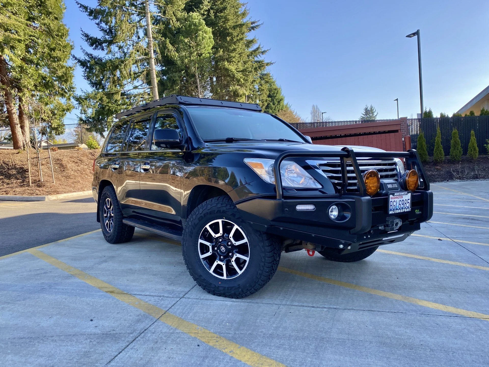

Just installed some new wheels and tires over the weekend. Went with a 295/70/17 M/T. Based on my search on here, doesn't seem to be a popular size. In fact, I think I found only 2 other people on here who are running this size.
Wheels:
Method 313 17" x 8.5"
+25mm offset
23.5lbs each
Tires:
General Grabber X3 295/70/17
Overall diameter 33.3"
Section width 11.8"

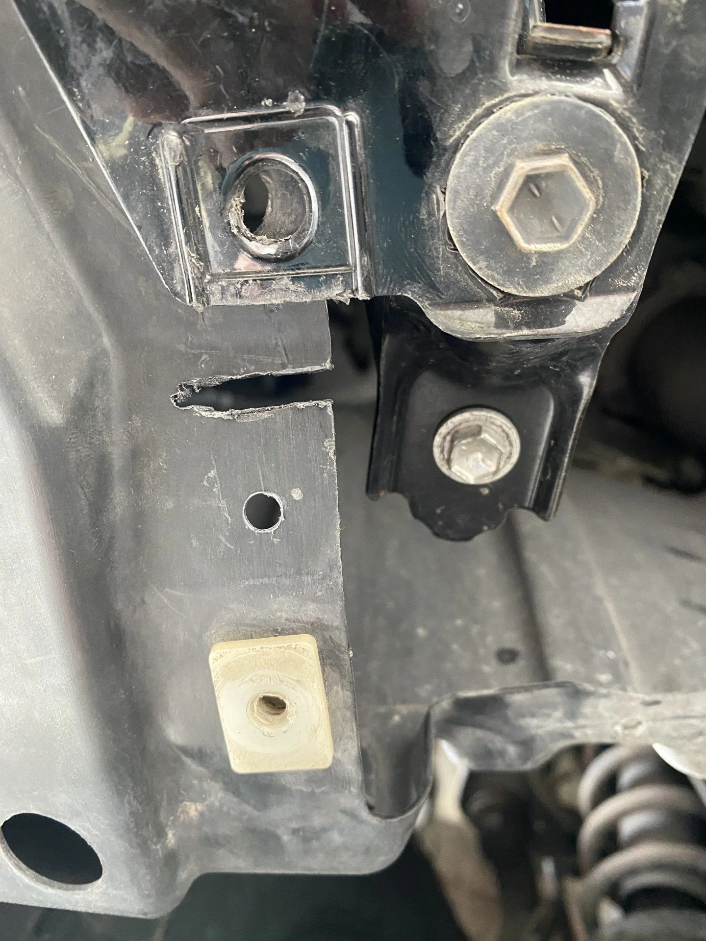

Bought this size knowing I had to do some trimming. The level of trimming was semi involved if you don't mind getting wild with a dremel tool. Doing a similar modification that I had previously done of my 5th gen 4Runner, I was able to move the front liner forward about 1.5" or so. Combined with some trimming of the inner wheel well (lower mudflap?), theres a mile of clearance up front. It get's tricky towards the back. Spent some time with the dremel and a heat gun and I have some solid clearance back there that will hopefully increase once I get realigned with some additional caster.
HI mode:
NORMAL mode:

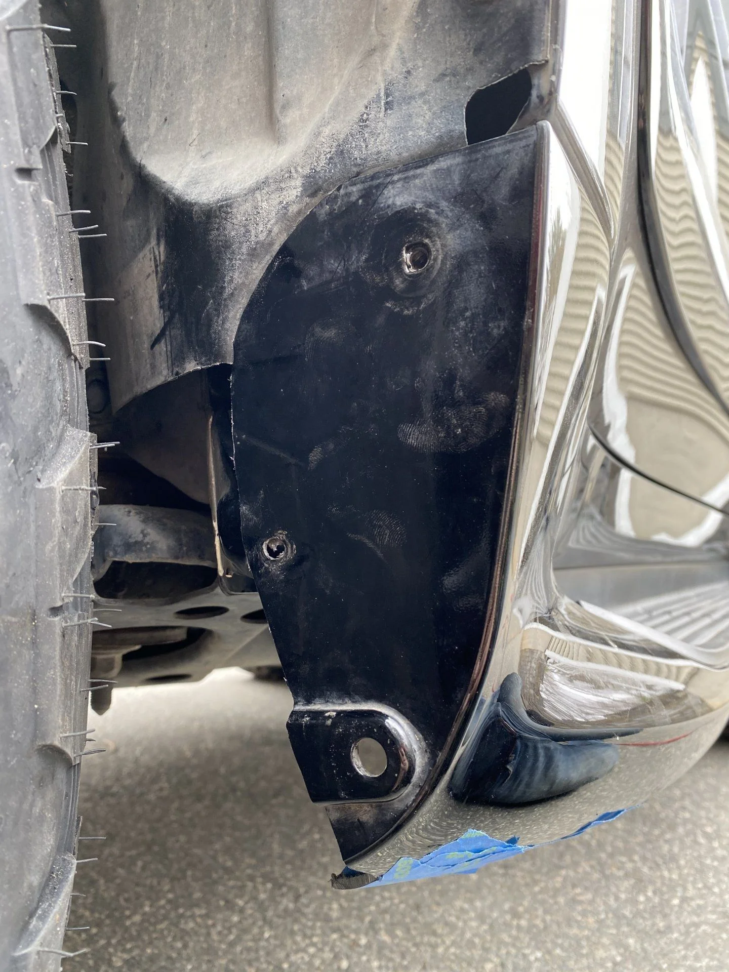

Some of the trimming involved. Sideskirt bracket was bent back, redrilled a new hole and added a longer bolt to pull in this area of the sideskirt. Liner needs to be heated and formed as well, which I performed after taking this photo.
Front fender liner modified:
Wheels:
+25mm offset
23.5lbs each
Tires:
Section width 11.8"
Wheels:
+25mm offset
23.5lbs each
Tires:
Section width 11.8"
That looks so good. Really like the shortie roof rack, too.
I'm looking to running this same set up, how much drama is "without much drama"? lol
Depends on your setup. I’m running them on my LX. Came from a 275/70/18. 20mm spacers and had to do some minor trimming on rocker panel plastic inside wheel well.

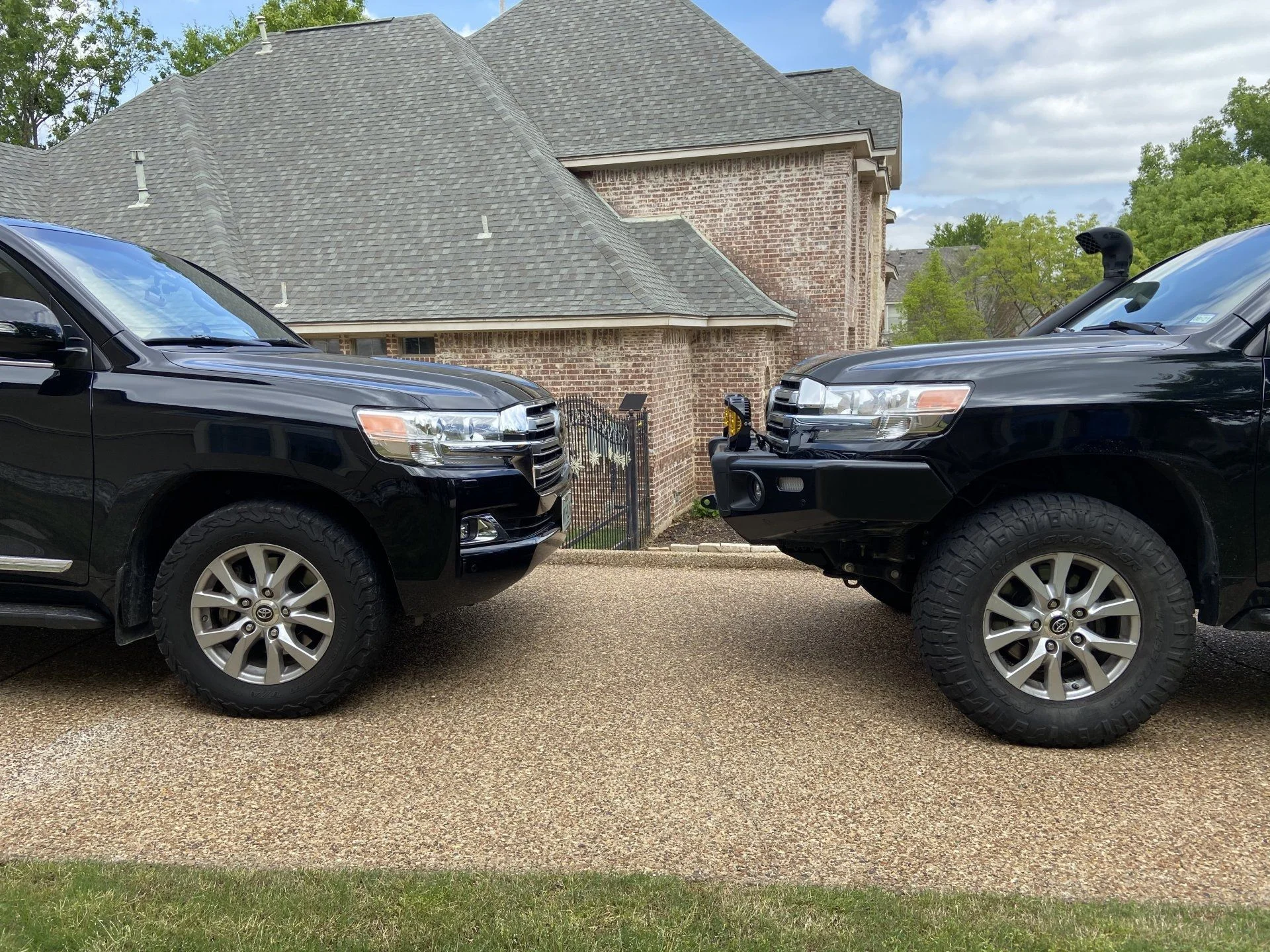

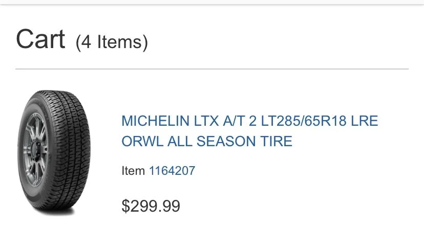

Has anyone being able to convince Costco to install Michelin ATX L/T 2 285 65r18 on a 200 Series LC? Replacing tires on the stock LC on the left
From my understanding they Will only install the stock/OEM Size. You could try asking them if you could drop off the wheels and have them install tires without the car there but I don’t think they will do that or warranty the tires. This Was the reason I ended up not using them for my new tires.

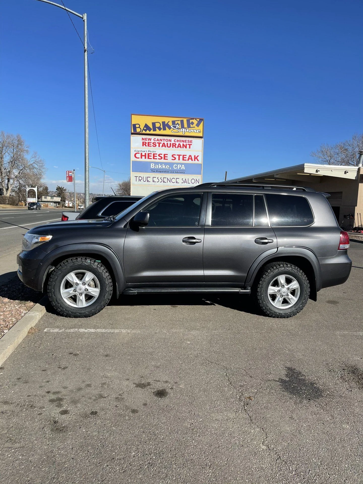

After much deliberation and research for tires, I ended up going with 285/65 r18 KO2’s on stock height and wheels. I’m incredibly happy with how they drive, how they fit, and my fuel economy surprisingly went up from my previous tires (possibly due to PSI not being right in my old tires). Hopefully this helps someone out there going down a research rabbit hole!
Can you please confirm if there is no rubbing full lock to full lock? Contemplating on a set these or a set of Falken Wildpeak AT3W.

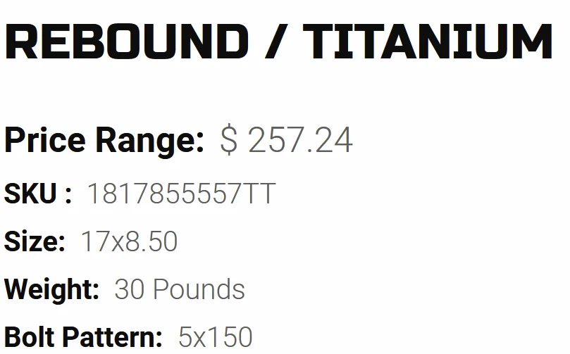

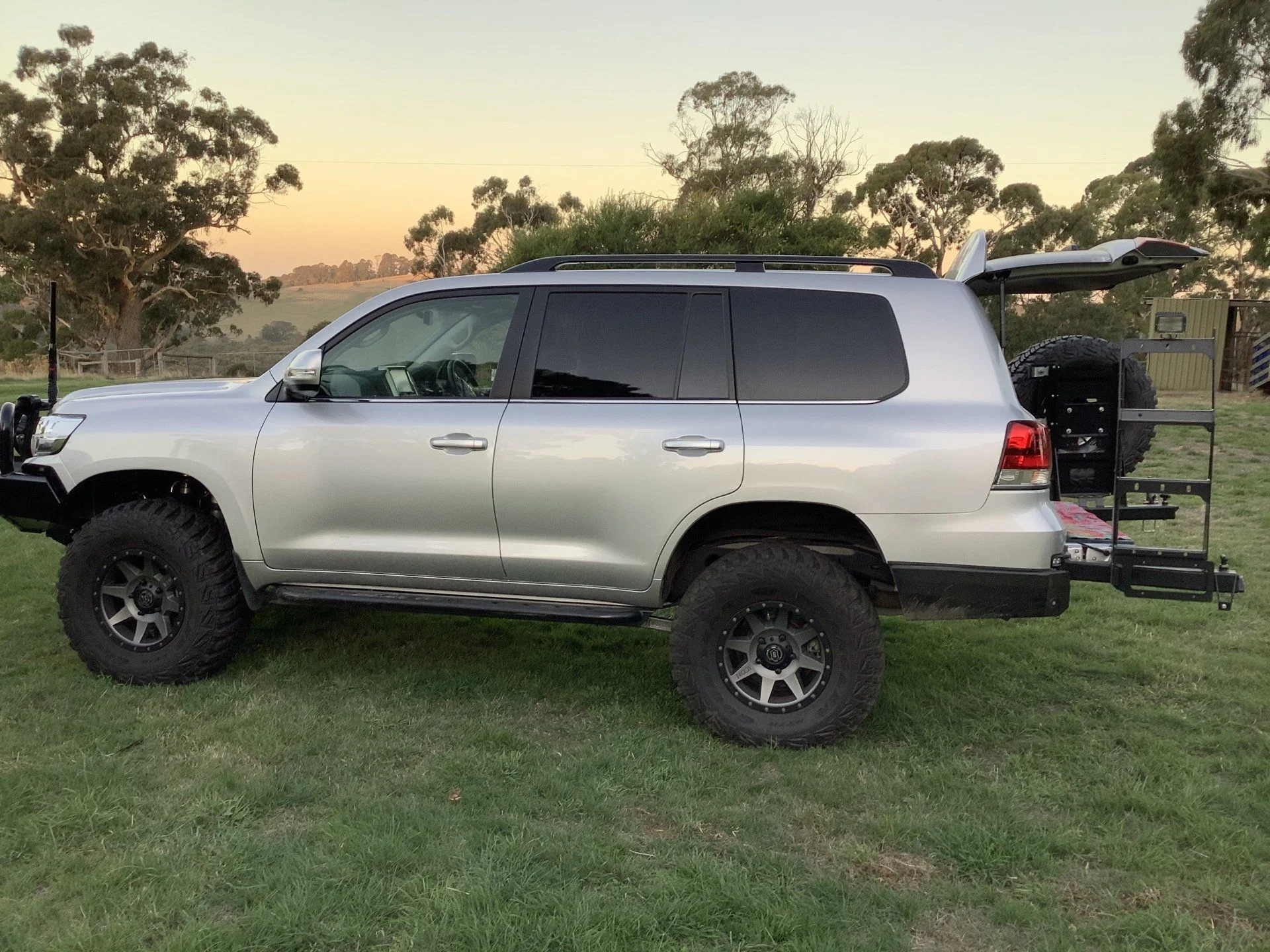

Ironman stage 3 lift (2") and SPC control arms will be installed next week.
Running these wheels, what is the largest tire I can run without rubbing or modifications to the fender liner or anything else.
Wheel detail:
ICON Rebound. 5 on 150mm – Bronze / Black​
  • Bolt Pattern: 5 on 150 mm
  • Offset: 25 mm
  • Size: 17″ x 8.5″
  • Bore: 110 mm
  • Backspace 5.75″
  • Check on wheel cap compatibility
In a perfect world, the tires would be flush with the fender. Are spacers needed?

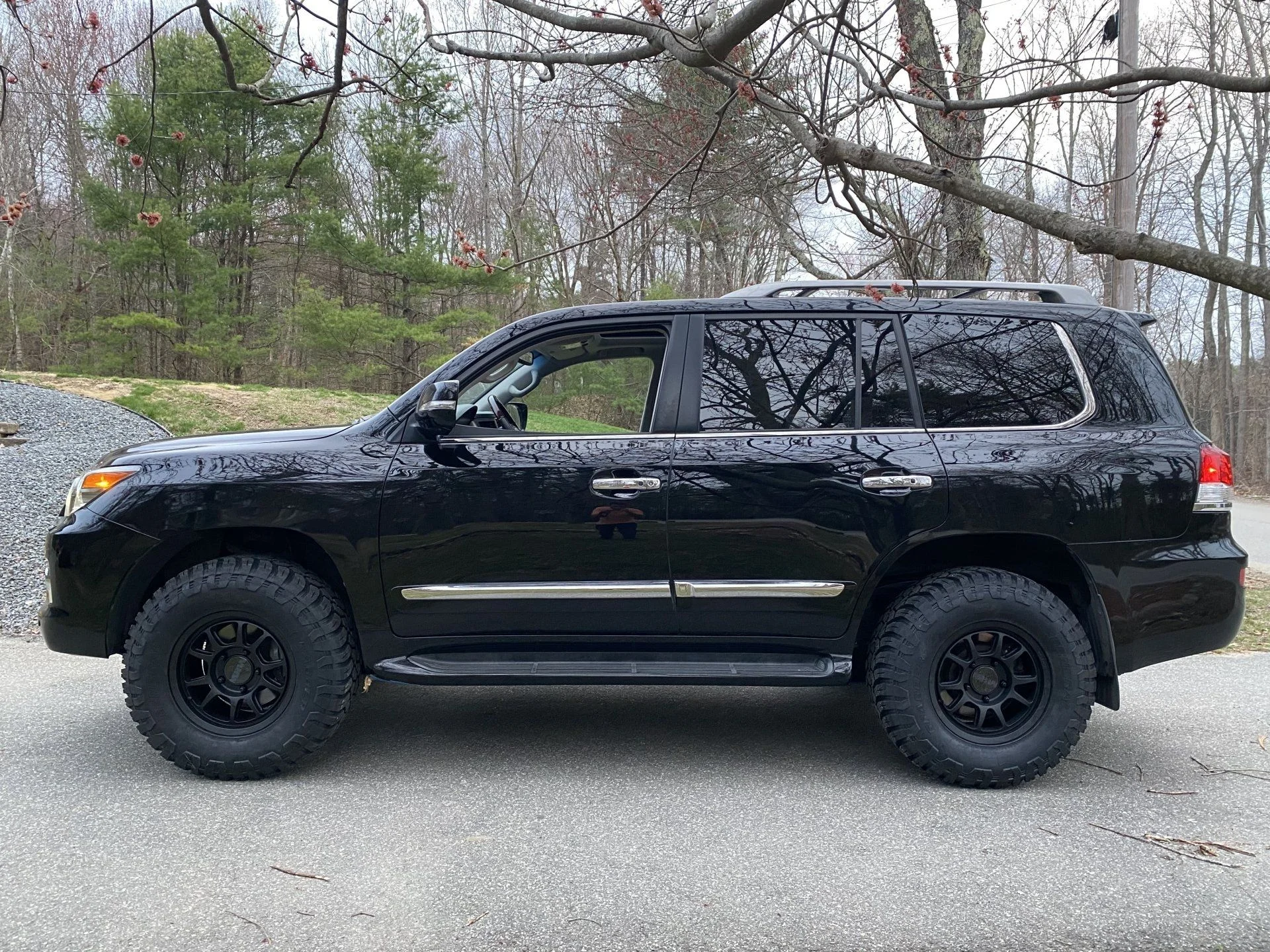

I am running Icon HD Rebounds in Titanium with MTR Kevlar 315/70/17 with just a little massaging of the inner fenders and mud flaps
