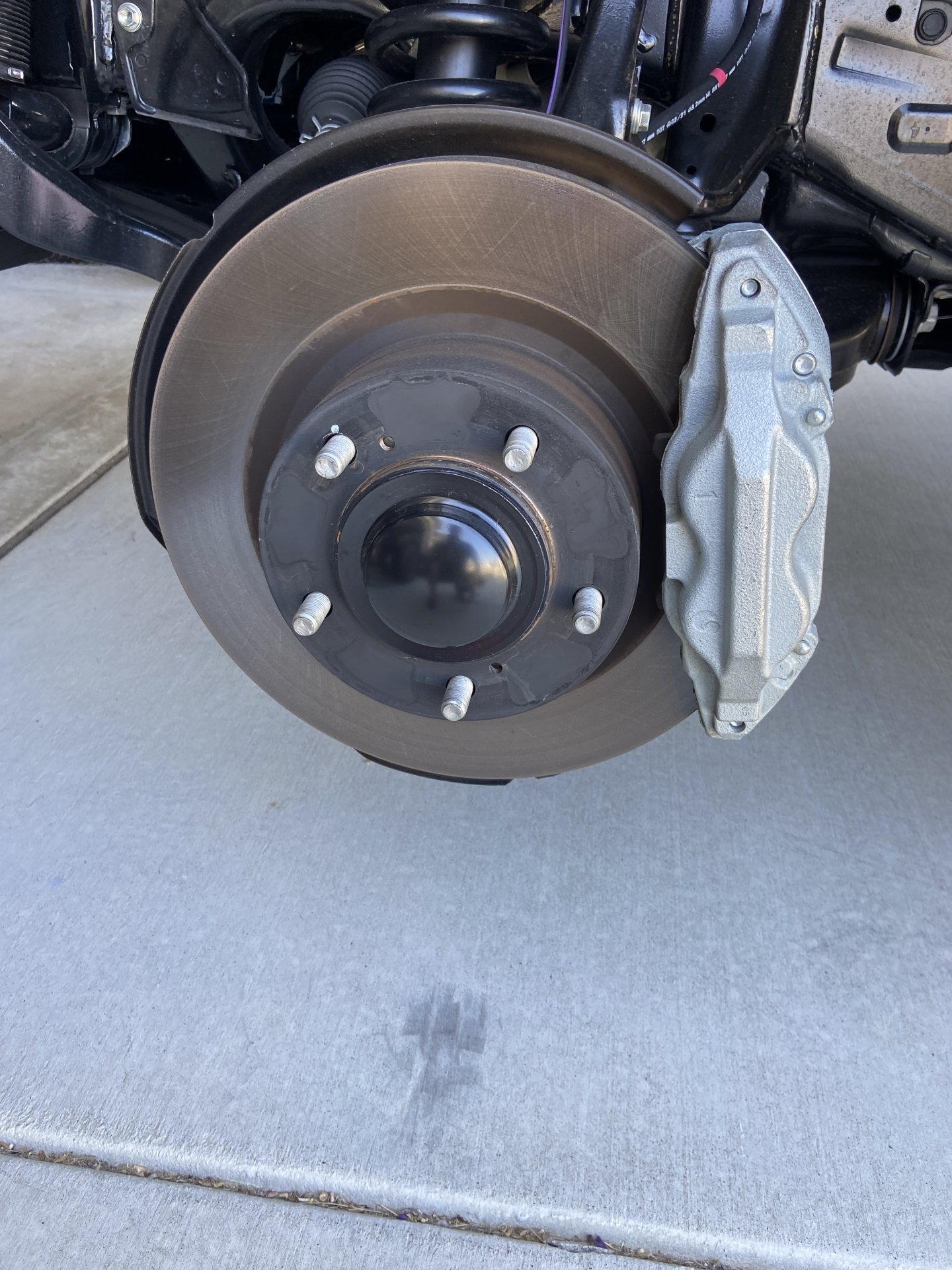

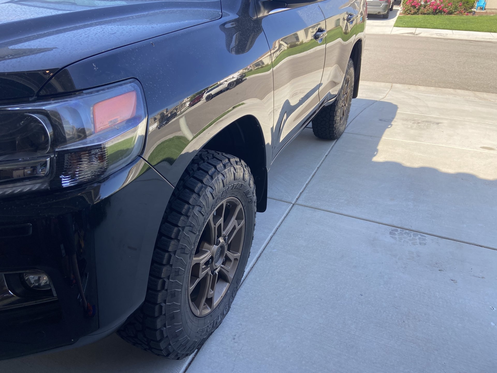

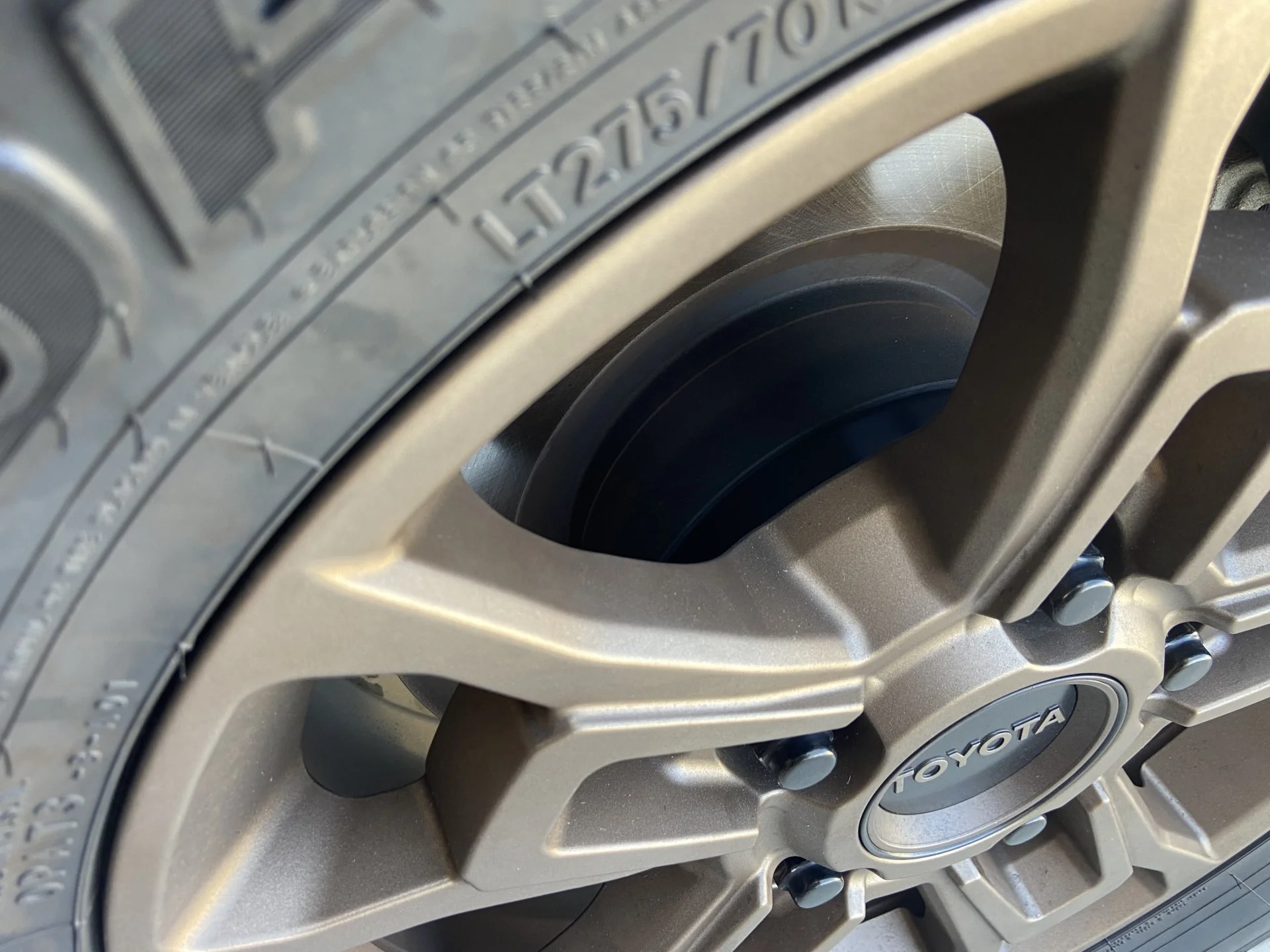

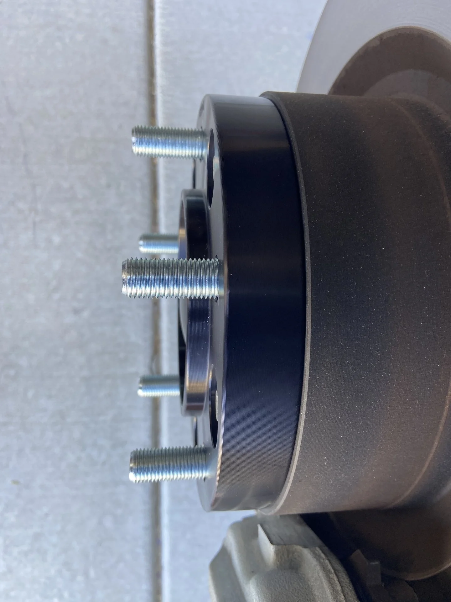

Yes they work! Have seen tons of questions about "what's the thinnest spacer you can run". Most claim it's 1.25". Well, installed my Bora 1" spacers today and they work perfectly. The rear axle seems to have a touch longer studs than the front axle, but given the recess in the BBS HE wheels zero issues with getting these on.

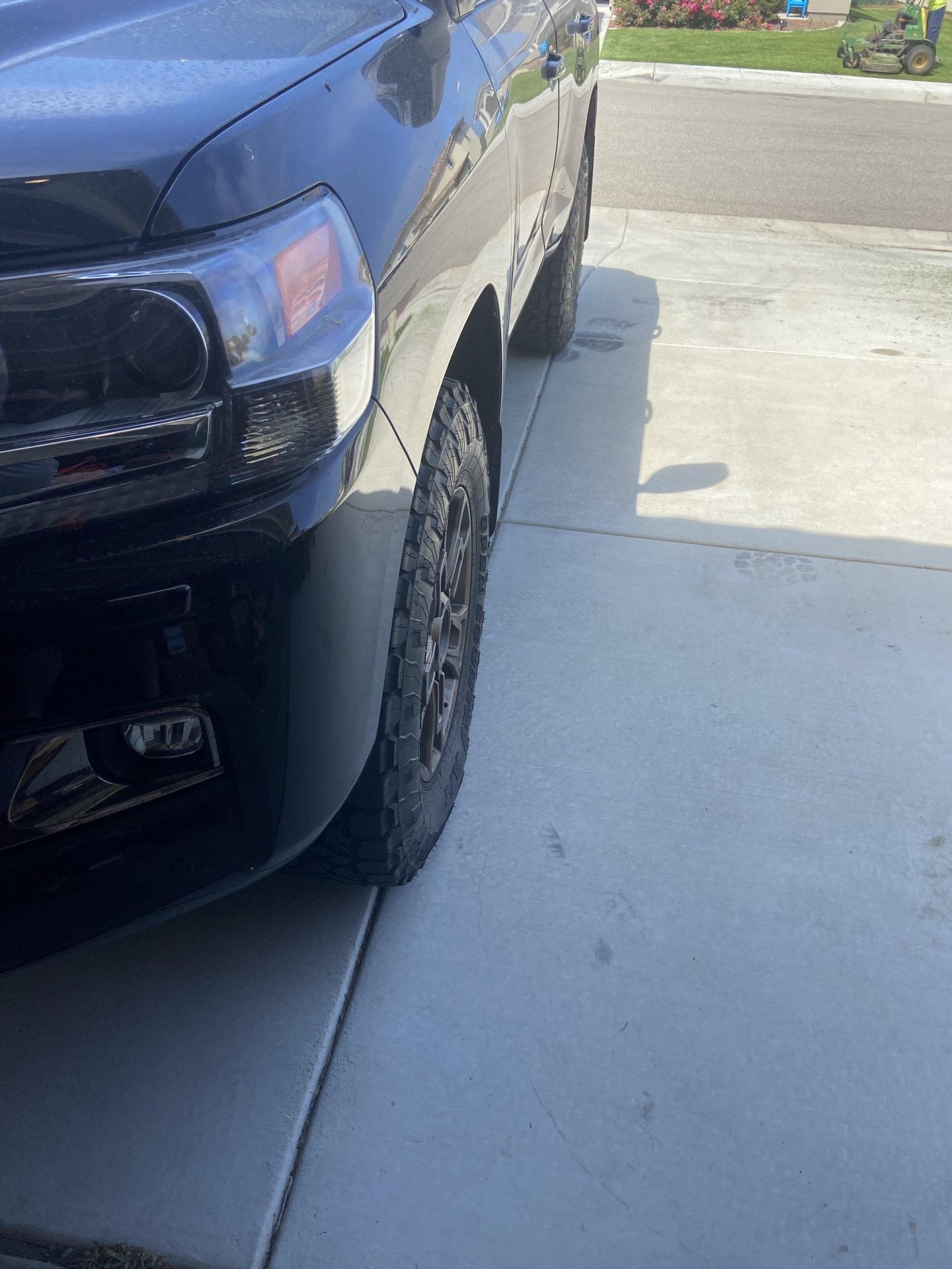

First photo is stock with 275/70R18 Toyo AT3s. Second is with the spacer installed on only the front wheel.

Front drivers side install

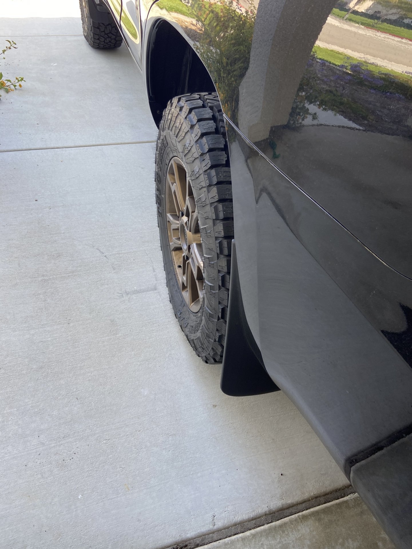

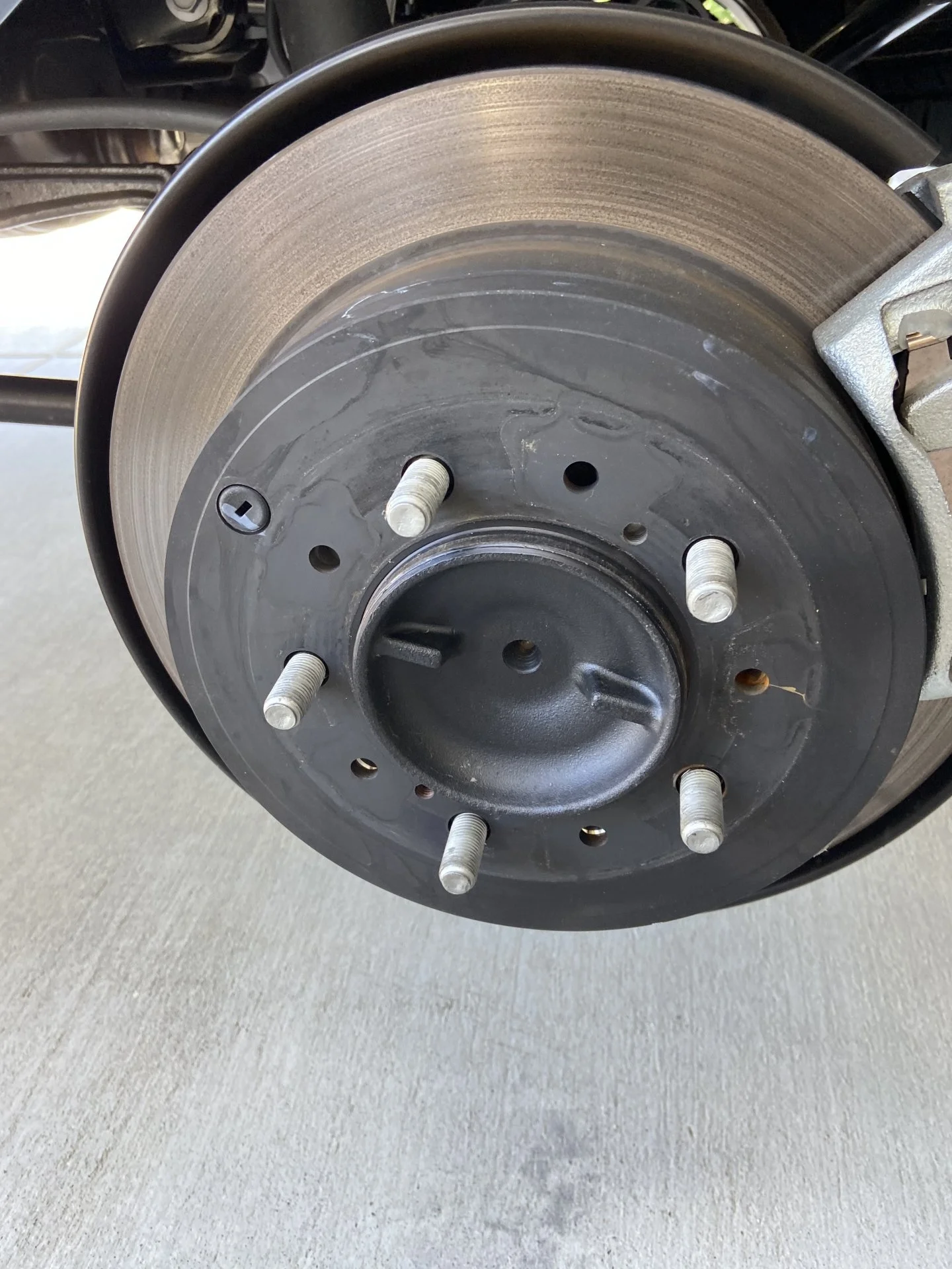

Rear. You can see the stock studs protrude just a bit, but no issues.

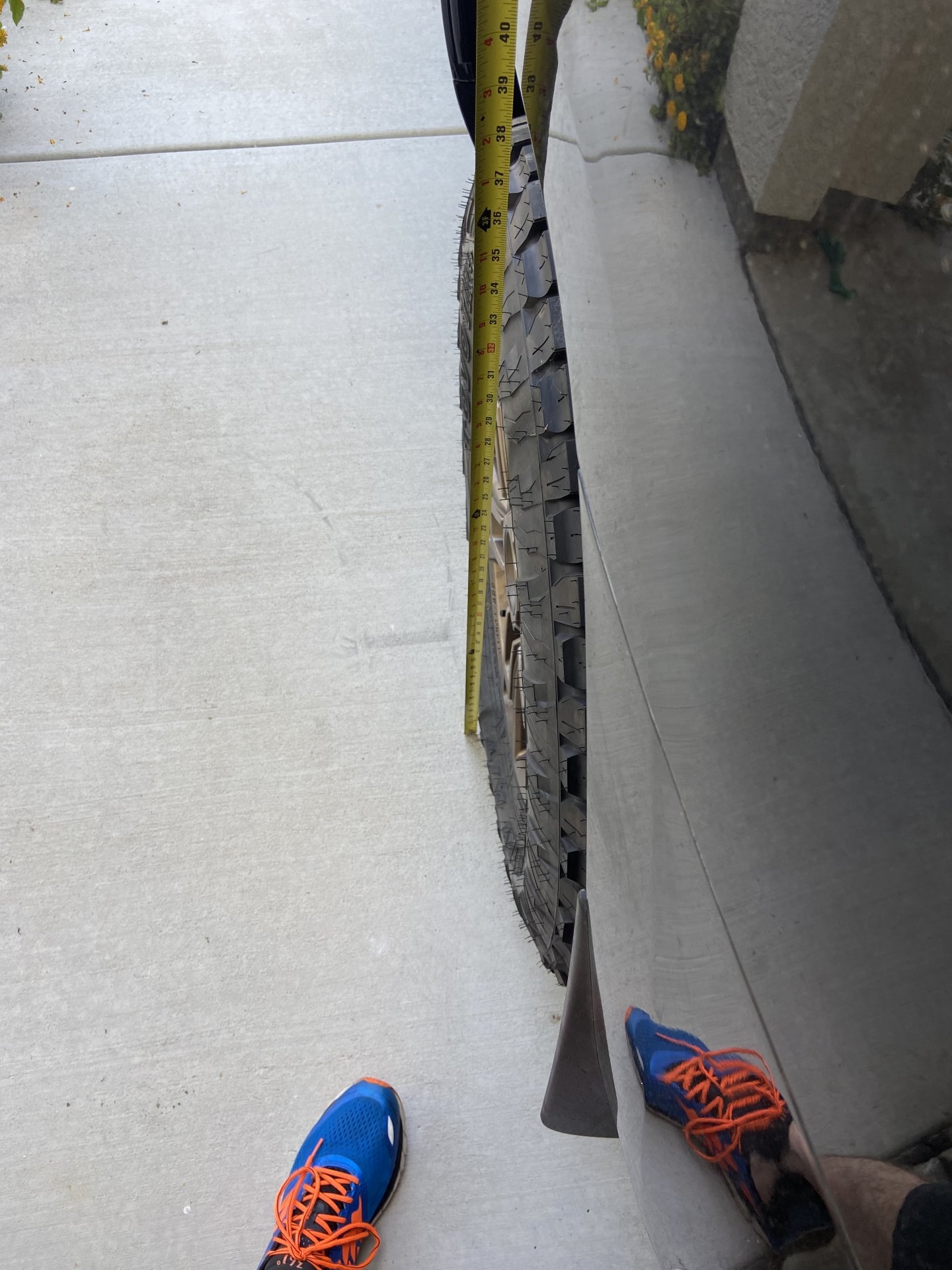

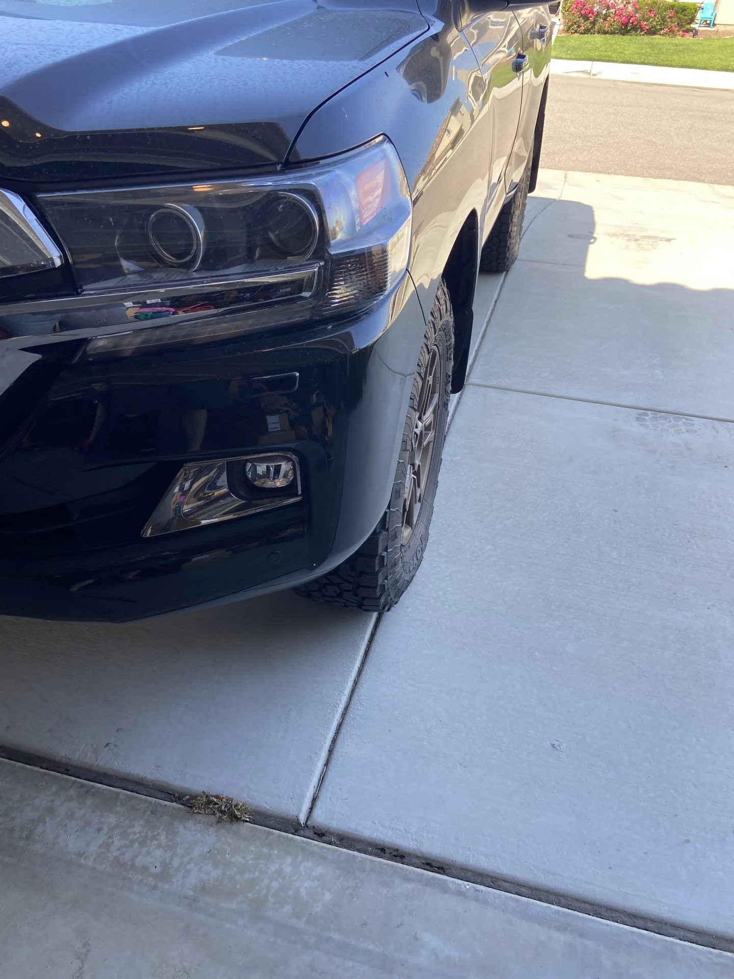

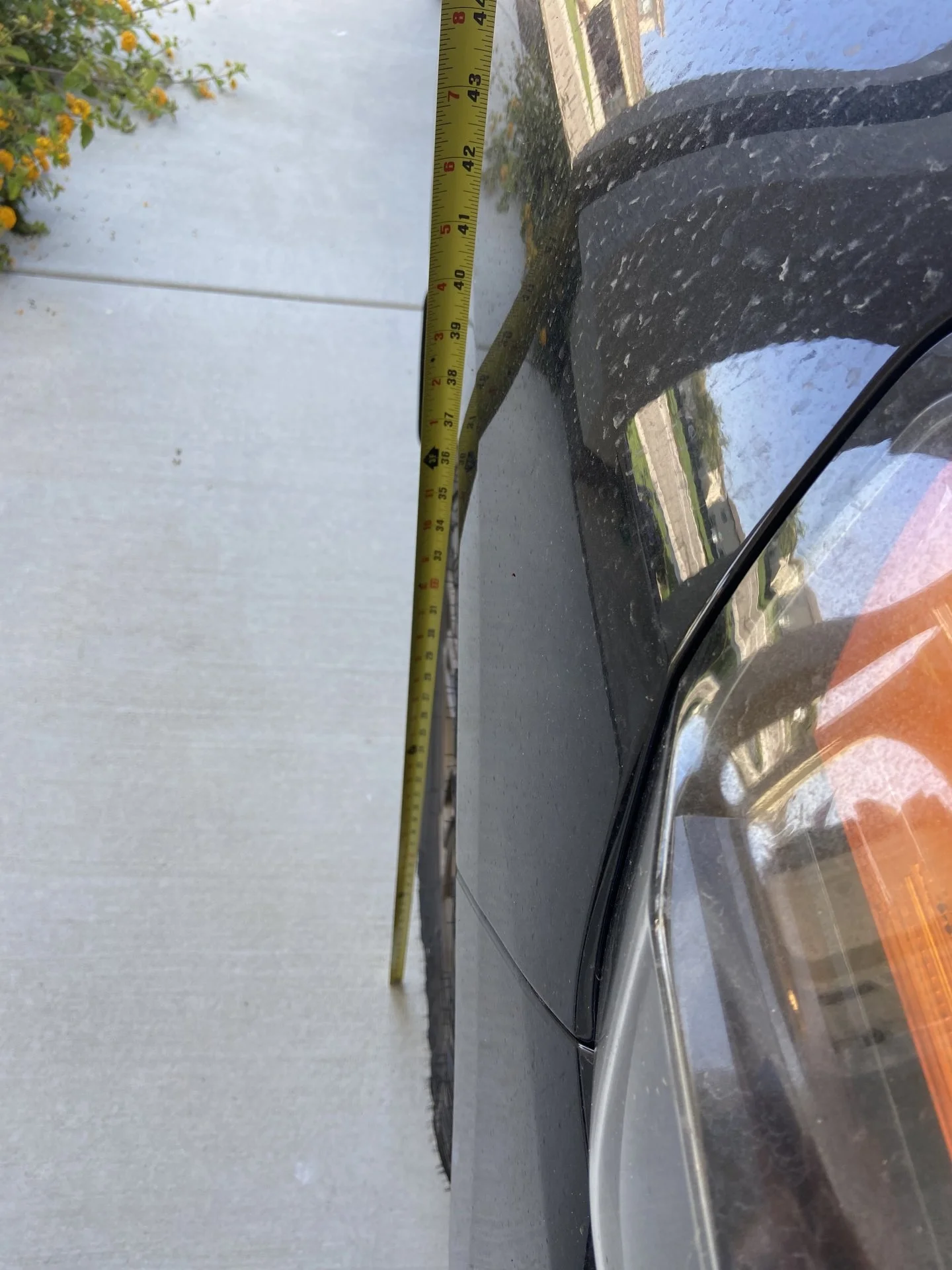

Done! Tape measure pics are just to show how "flush" wheels are with the fender

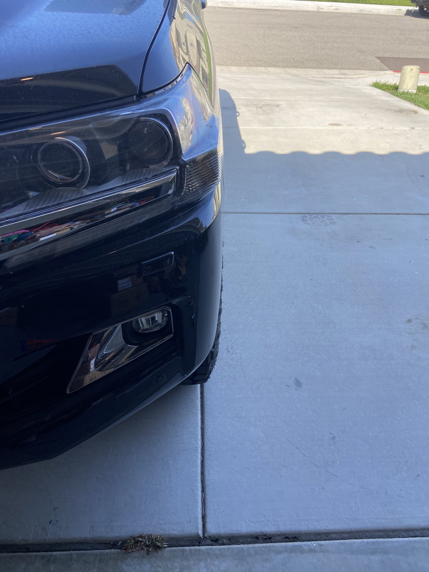

Looks great! Quick question. Does the tire thread edge (not side tire bulge) reached inner metal fender edge. I want a slightly wider stance but would like to avoid rocks coming off from tire threads and hitting the inner lip of fenders (causing chips / corrosion, etc).
Tire tread does not, so you should theoretically be good. Here is a better head on picture.
