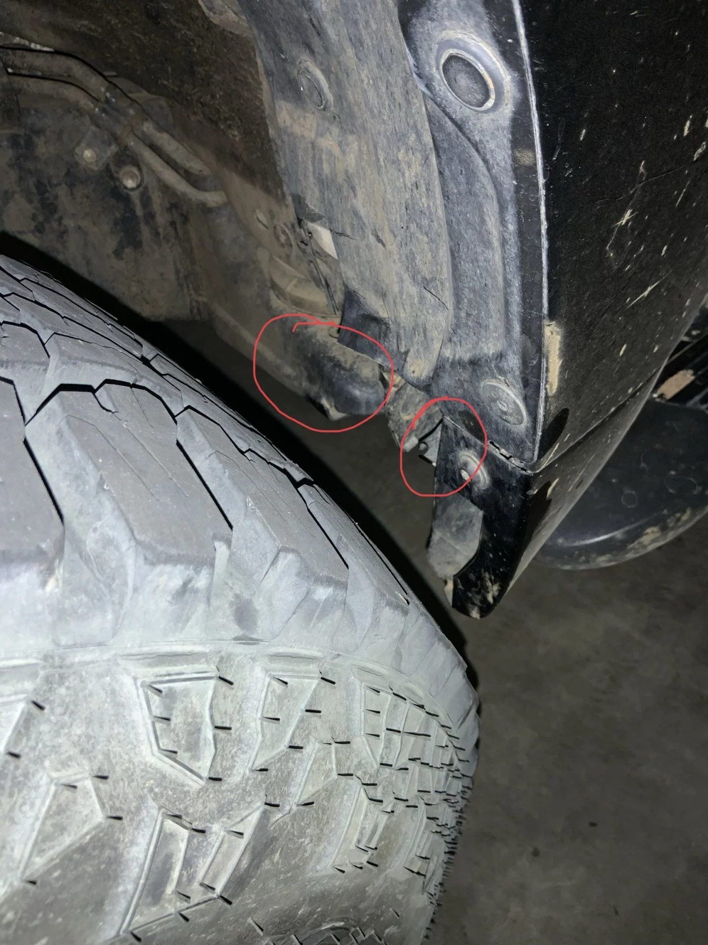

Hi @gaijin need some help here. I’m running 275/70/18 Goodyear ultraterrians. I have theOME Nitro stocks and coils. I’m rubbing all the way back to the body mount. I have trimmed everything but hitting frame with minimal articulation. I’m running the tires on fuel hostage wheels 18x9 with 20mm offset? Any suggestions?
Interesting rub spot for 275/70/18s. I imagine the 20mm offset is a big reason for the rub spot. Are you running aftermarket upper control arms with your lift and Do you know your alignment specs (camber/caster) as that could be a contriubuting factor.

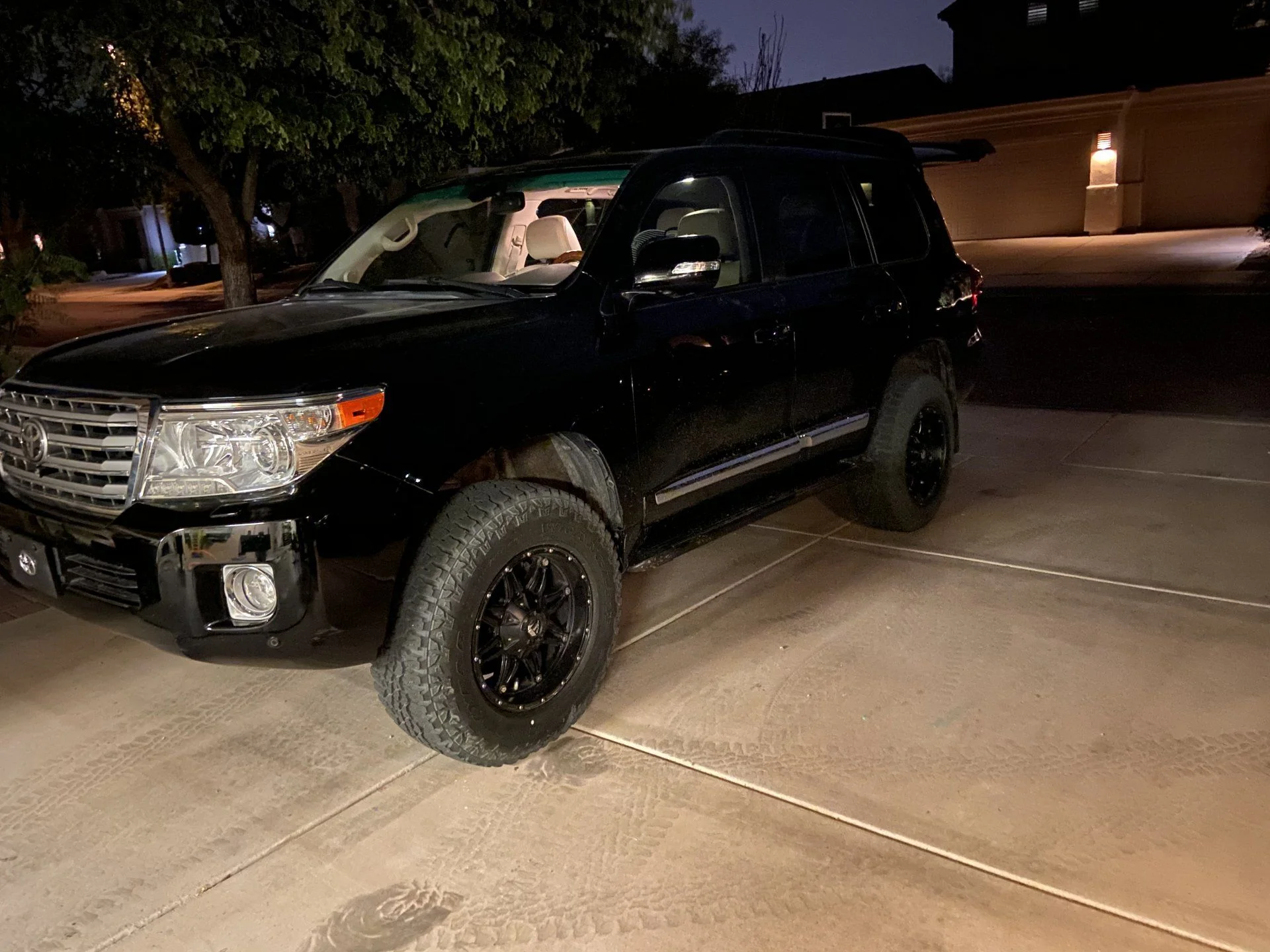

Not that anyone would be surprised these would fit, but I went from the Michelin Tour HP in 285/50 R20 to the BFG KO2 in a LT275/55 R20 without issue.
A bit narrower and a bit taller than stock. Ride is noticeably stiffer (in a good way IMO); mileage as-yet untested. Not that I would change them anyway.
Pictures in H, fresh from the tire shop.

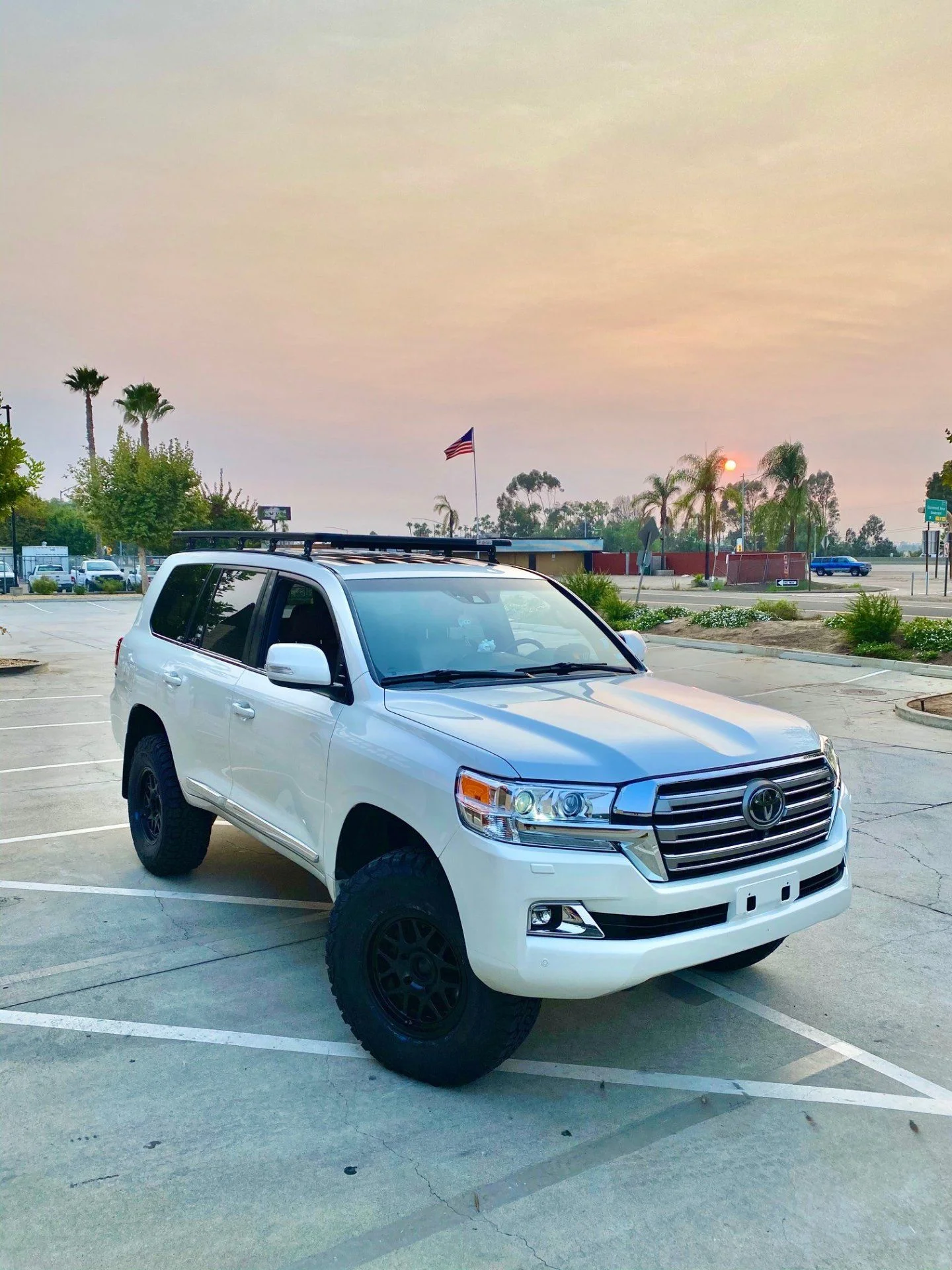

Do 285/75r17 on rock warriors rub the UCA at full bump?
Running 285/75r17 BFGs on KMC KM717 Bully OL wheels. I have the OME 2 inch lift with the new OME UCAs. I had do some trimming on the fender liner in front of the front wheels and remove front mudflaps. Also I do touch the KDSS but only in full lock in reverse. Love the look! The BFGs are E rated so they ride a little rough but thankful for the sidewall protection on the trails :cheers:.
View attachment 2437508View attachment 2437509
Truck looks great! Could you add your info to the database via this survey? Results are here.
