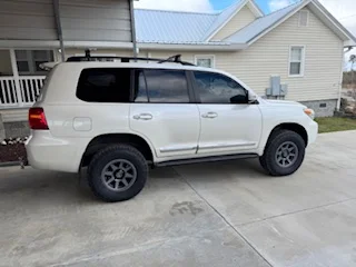

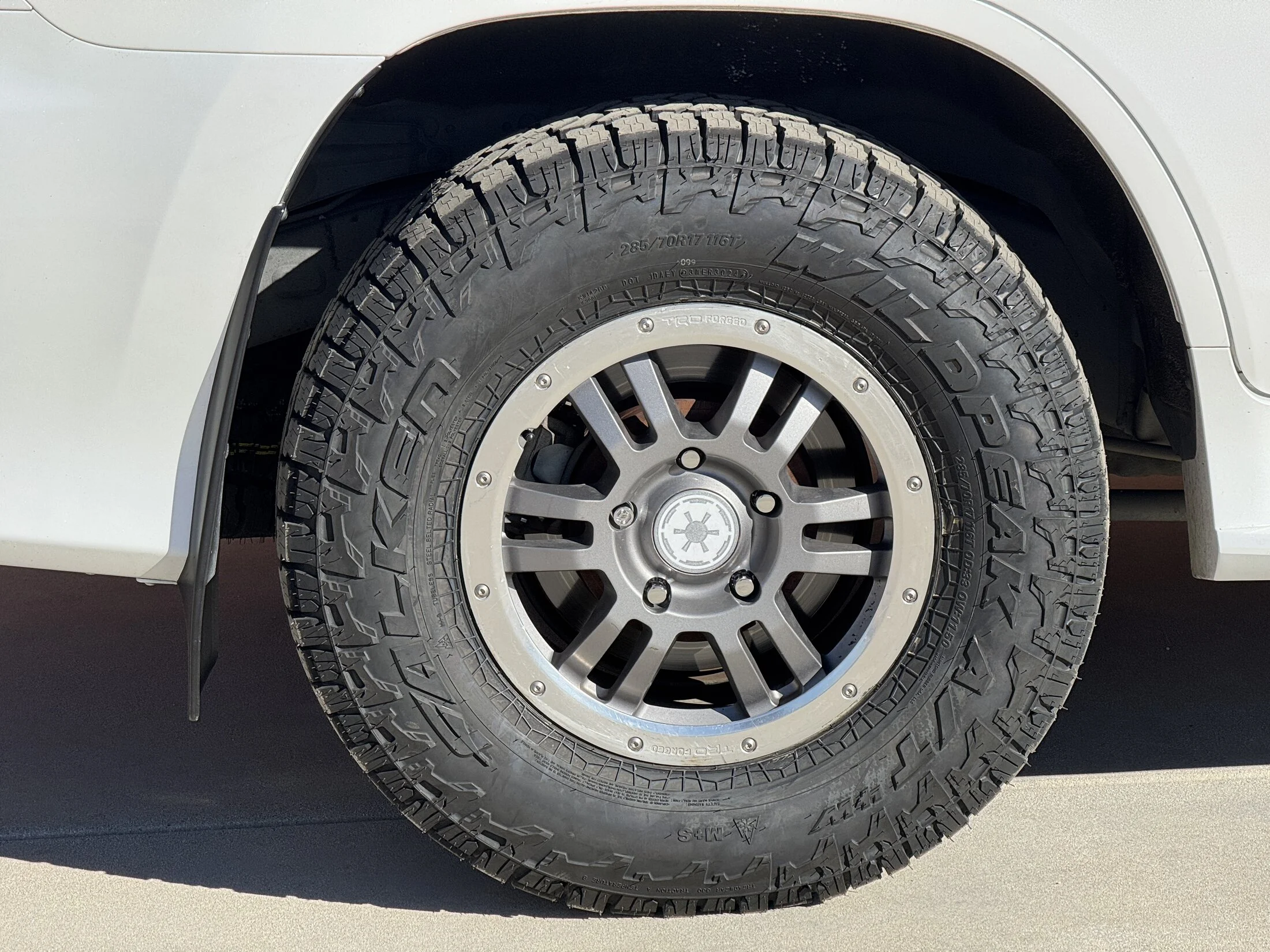

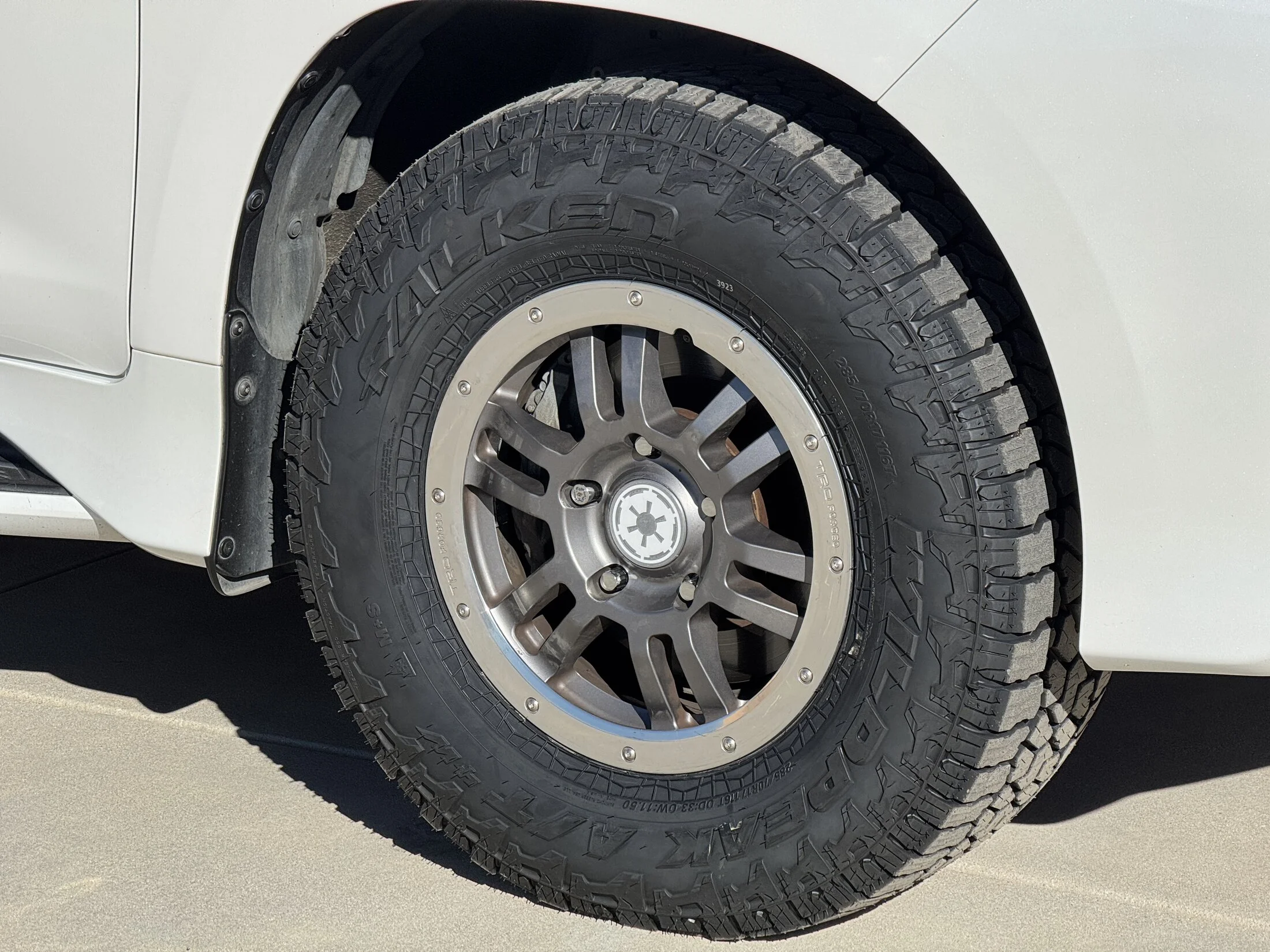

Kenda Klever RT 35x10.5r17 wheels nomads 0 offset. Smidge of rubbing on front fender liner and rear plastic
Hooooly god that looks so tough, the rims are epic and the stepping board delete *chefs kiss*
It’ll be getting rock sliders eventually

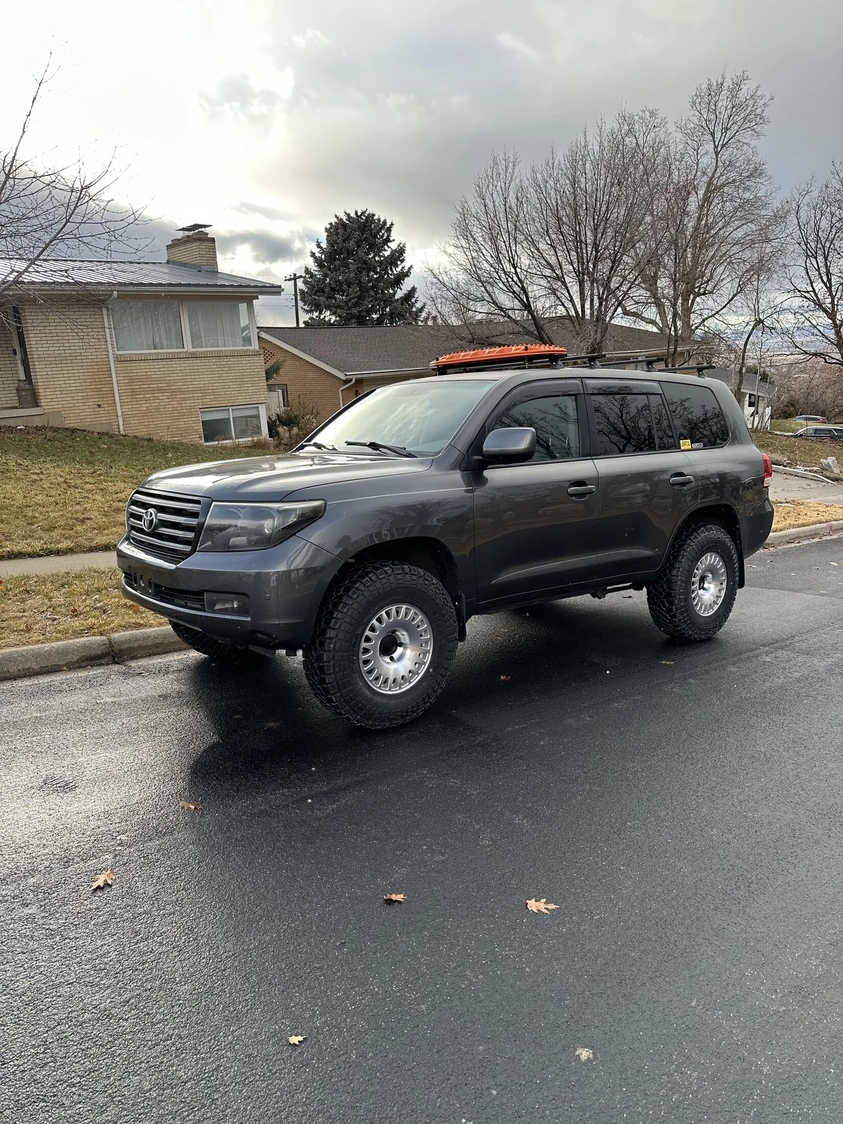

Got the Icon Rebound Pro 17x8.5 +25mm offset on sale and mounted some 285/70R17 Nitto Recon Grapplers. I took off the front mud flaps and the little flap on the front. No rubbing with the Ironman 2” lift and UCAs.

Looks great. Did you have any issues with a tire shop following the extra mounting instructions for the beadlock bolts?

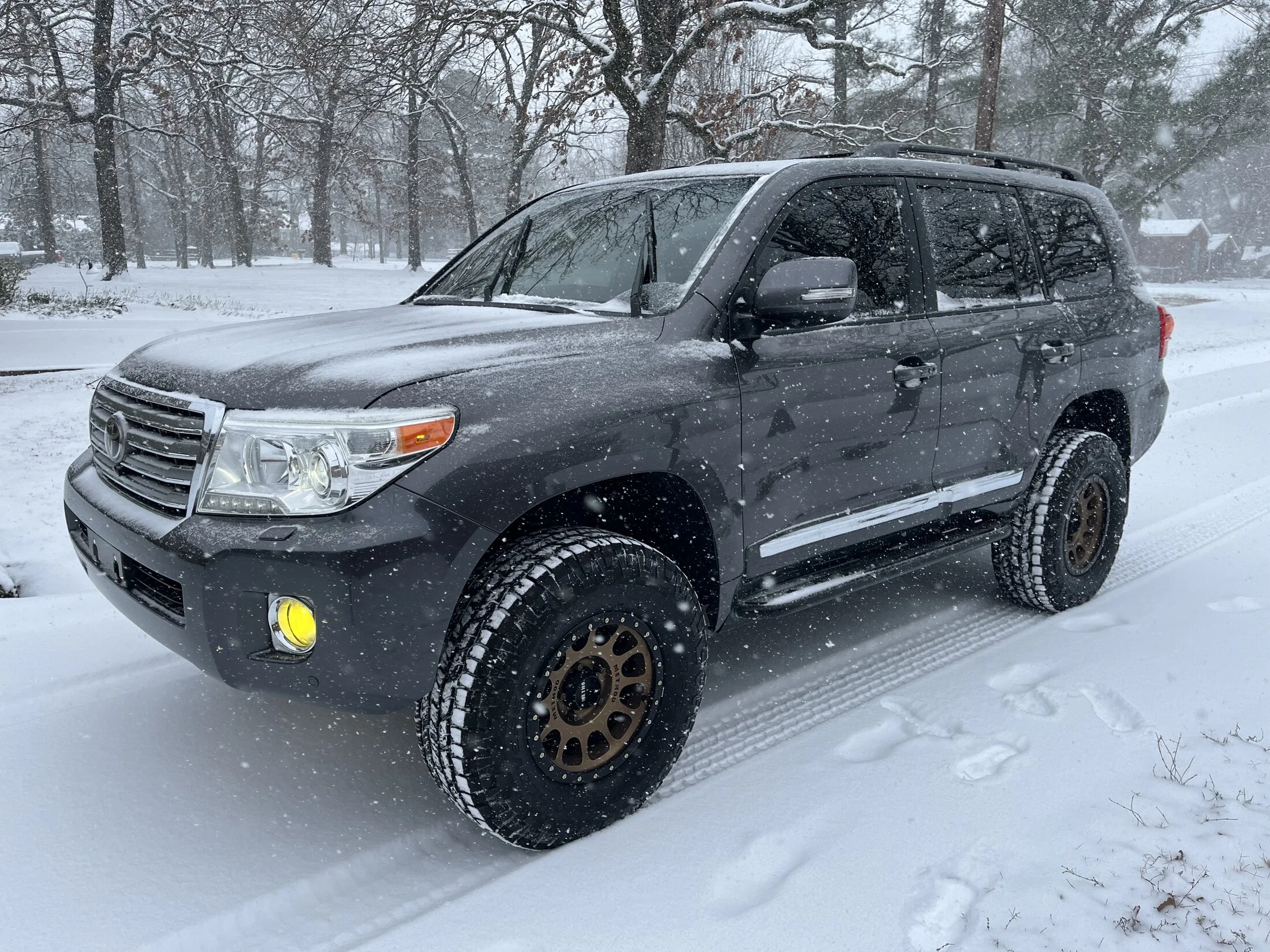

I’m sure this has been asked before, but I want to downsize to 285/70r17 on +25 wheels. I’m currently in 285/75s on 0 offset methods. I want to keep my 2.5-3” lift, but I don’t want it to look too scrawny with the smaller tires. Anyone have pictures of this setup: 285/70s and. 2”+ lift?
This is how I currently look:

What is your goal? Why not keep the same tire size and get a 25mm offset methods?
Yeah, that's what I'm going to start with. I've just been running that tire size for a while now and I'd like to get into something with better road manners and wanted to see some examples with my lift size.
