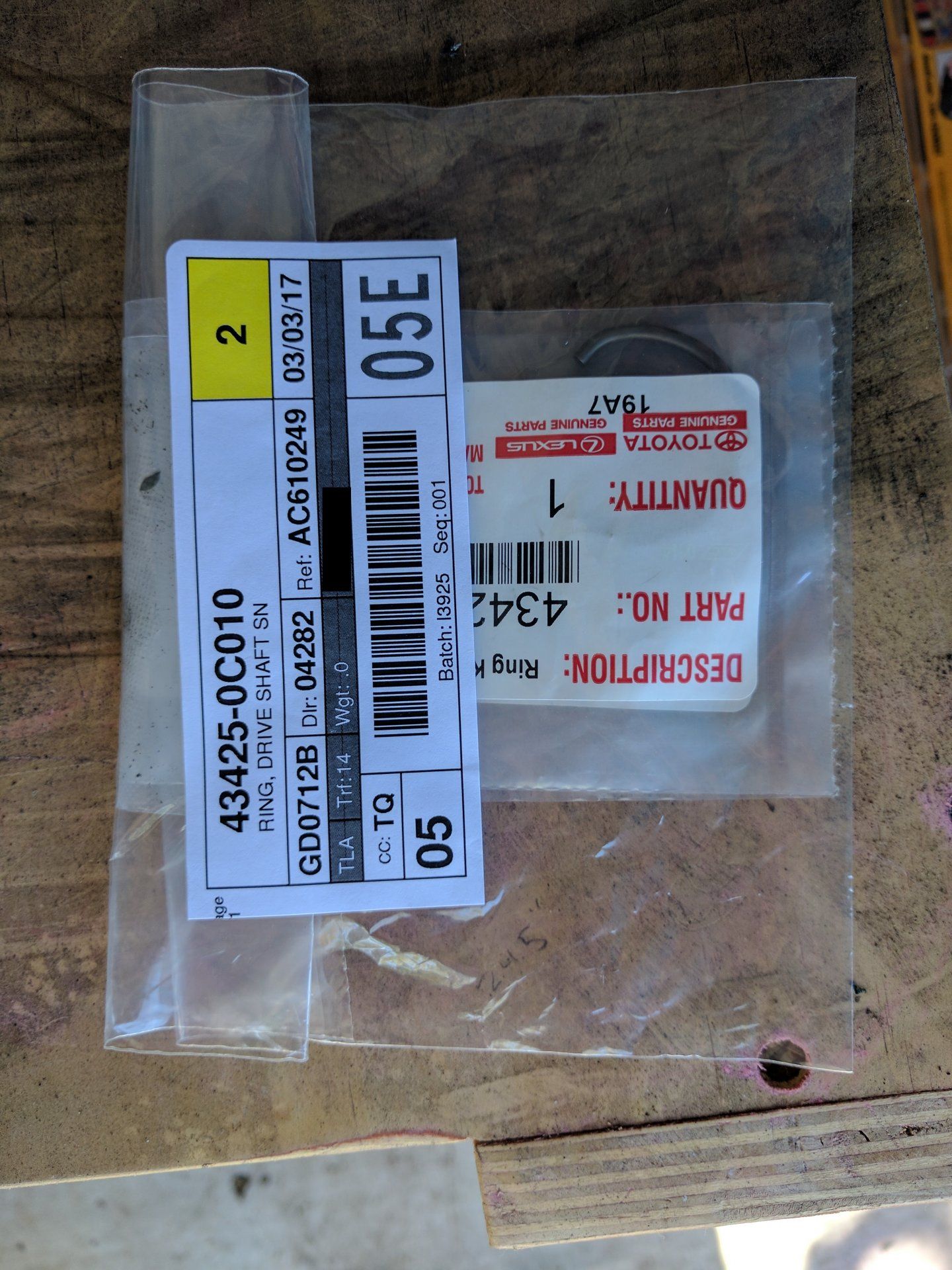

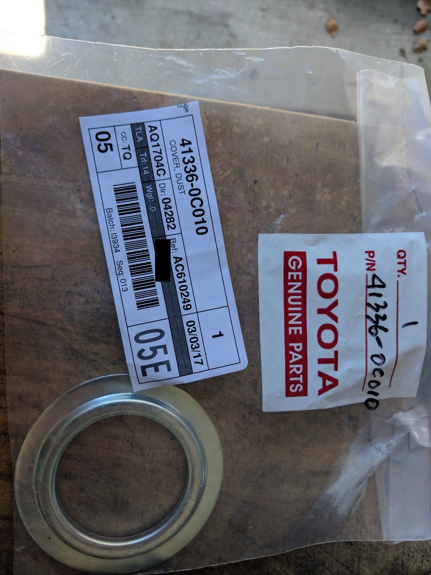

The parts are piling up, getting excited. Just awaiting Crown Performance SS brake lines (shout out to @Atwalz for getting them prop extended lengths, they can now duplicate for anyone else needing). Next up Bilstein 6112s up front, OME Nitros in the rear, those SPC cam alignment bolts and a few odds n ends and I should be lifted within the month. PS I put the last few pics because identifying the part numbers for replacement dust shields were tough to nail down so it might be helpful for anyone else who decides to purchase Tundra CV take-offs and needs to replace these parts, which tend to get damaged during removal. Eventually I'll compile into a single thread.

You are almost ready to get your hands dirty. I started this swap two Sunday ago and worked everyday after work for few days. Everything was buttoned up within 5 days. My rear Icon shocks were delayed for a day due signature requirement. Otherwise I could have saved a day. Your may battle getting the axle out and installing replacement. I used brass punches to remove and install them.
Once you have the knuckles out of the way, use the axle like a slide hammer and forcefully "jiggle" the center section in and out. The snap ring will let go after your 3rd or 4th cuss word. No damage done, no prying on bendy parts.
Haha nice. And any hints on getting leverage to get the new ones in? Same thing but in reverse?
Yep
