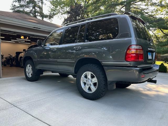

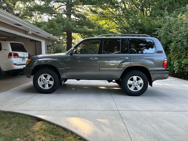

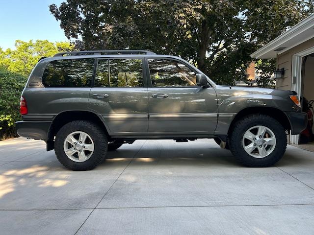

LC200 wheels on my 2000 LC100, no spacers required with these wheels. On General Grabber 275/70R18 A/TX.
Love this look. Been trying to track these down to put on my river rock green LC. Are you running a lift or stock height?
Tundra 18" for rough stuff
And Tundra Limited 20" for everyday driving
Thanks, its lifted.
Dobinsons C59-169 rear coils, re-indexed factory torsion bars, Dobinsons UCA's, Dobinsons extended travel IMS shocks up front and Dobinsons IFP rear shocks.
