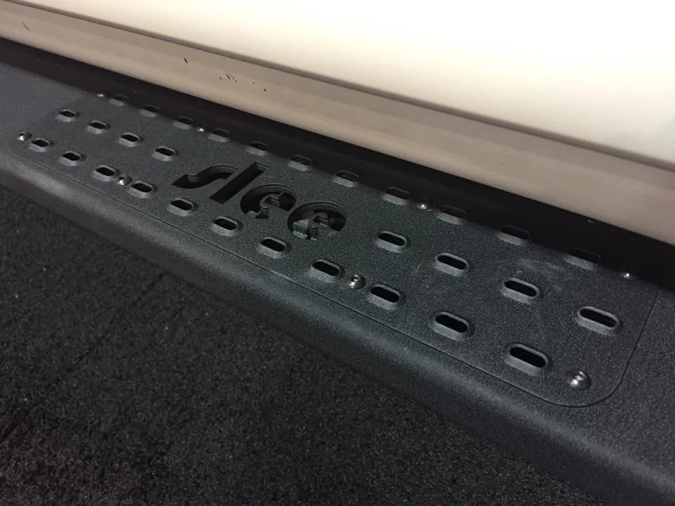

As someone who will never go rock crawling, I like the SLEE steps for being very discreet. If I actually used mine I would go with Bud Built for its design. I was impressed with the stoutness of @linuxgod White Knuckle Sliders. Looked much beefier than mine.
I am quite sure you could use a hi-lift and jack up the vehicle via the slider and it would not flex.
I don't intend to remove mine but I do prefer the self-tapping bolts to rivnuts.

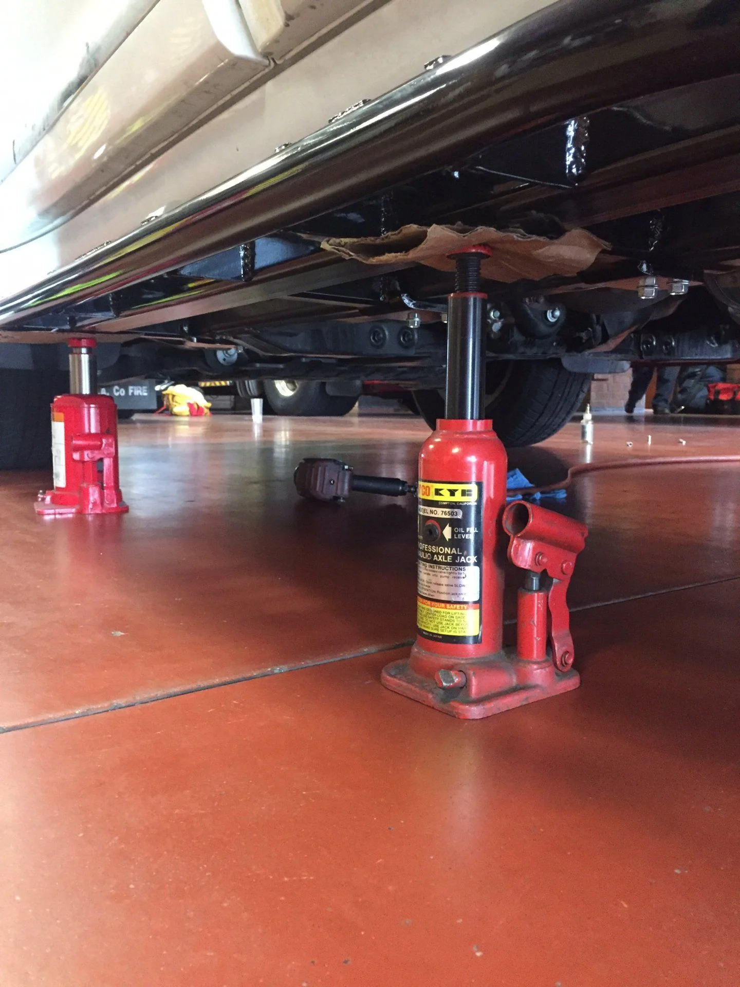

Looks like I'm just following you all over huh? How hard was the install? You did yourself? Are you able to lift them yourself or did you use jack stands? Any feedback is appreciated
I installed myself. Used floor jacks to position the sliders. Did not raise the LC. It was none stock.
I installed myself. Used floor jacks to position the sliders. Did not raise the LC. It was bone stock.

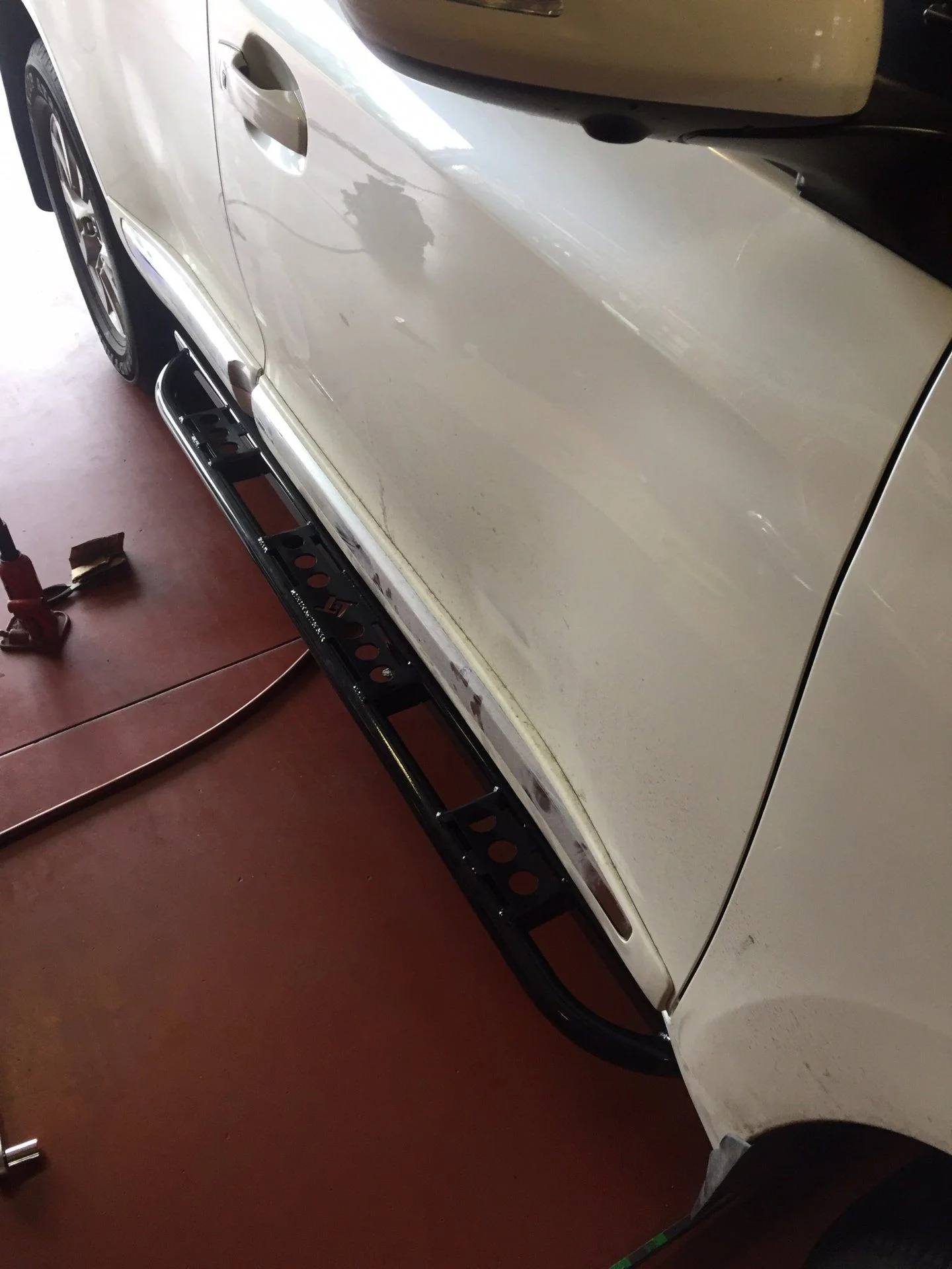

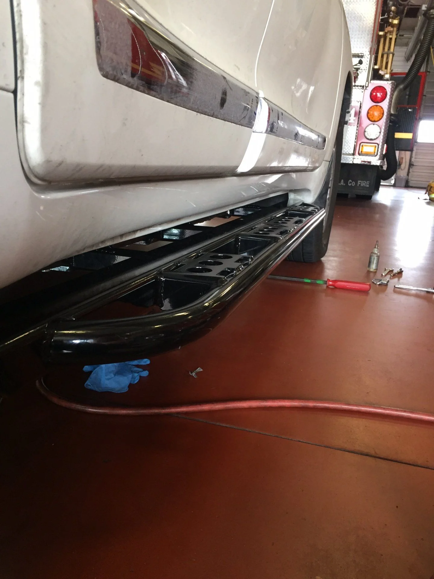

I beat the piss out of my previous TT sliders. The new version is about twice as stout.
Pic just taken. My top plates are a bit different than SQRRL's. But he can weld on whichever style.

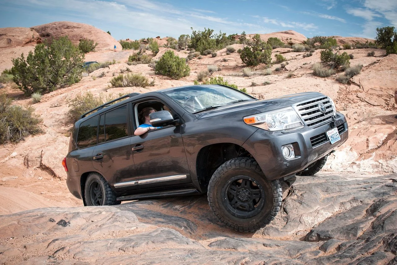

Metaltechs have been good to me for the past couple years, beat on them all the time!
