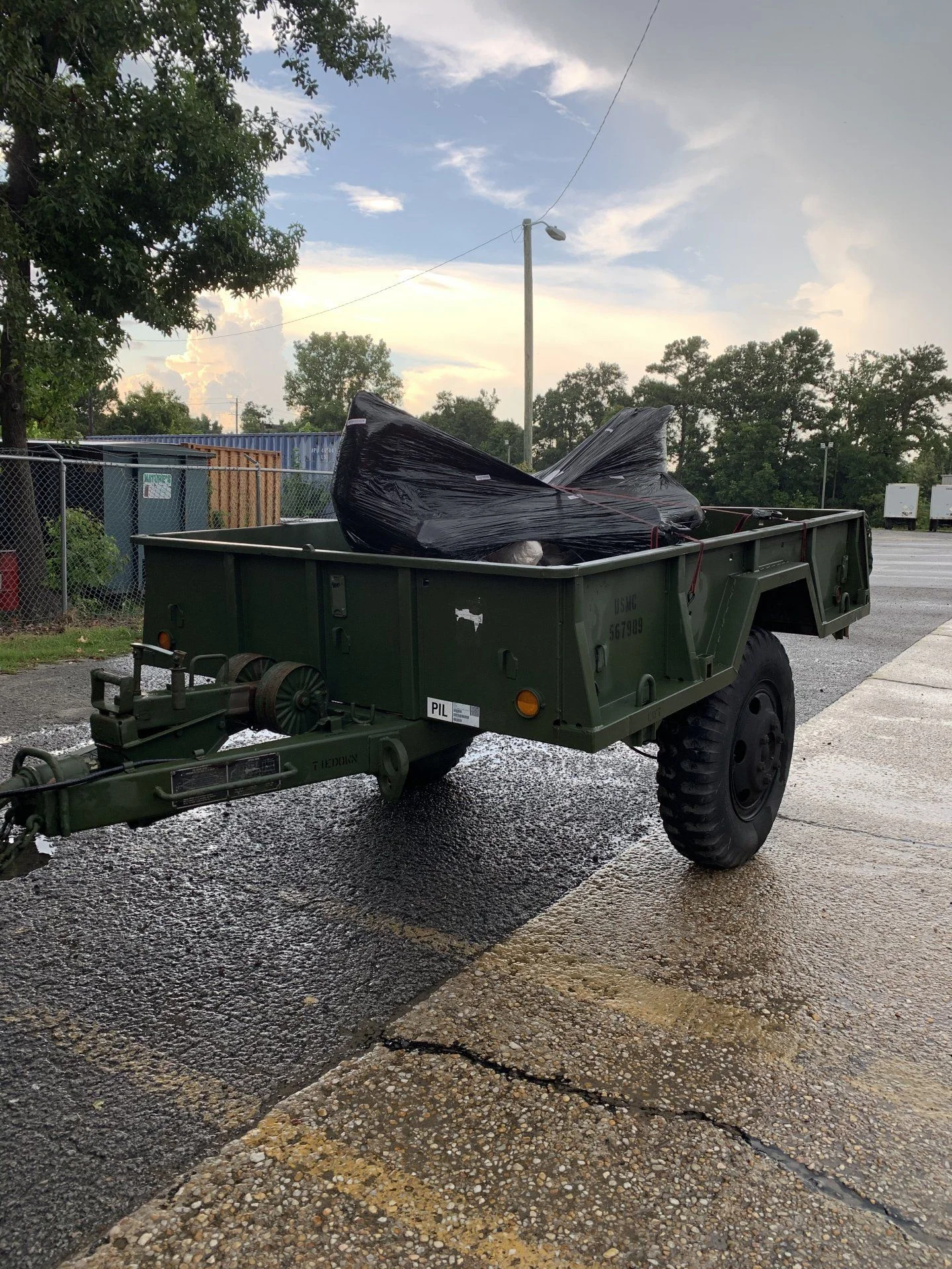

@scott johnson !!! Thanks for the heads up on the Pelican Cases. I dropped by and picked up (2ea) today. They’re offering 20% off total purchase and 10% off for veterans when you buy more than 2.
Glad to hear. I took mine to the car was to get all the dust off them and check the seals. All good and most of the paint pen came off. I may go back and get a couple more once I figure out my load plan.

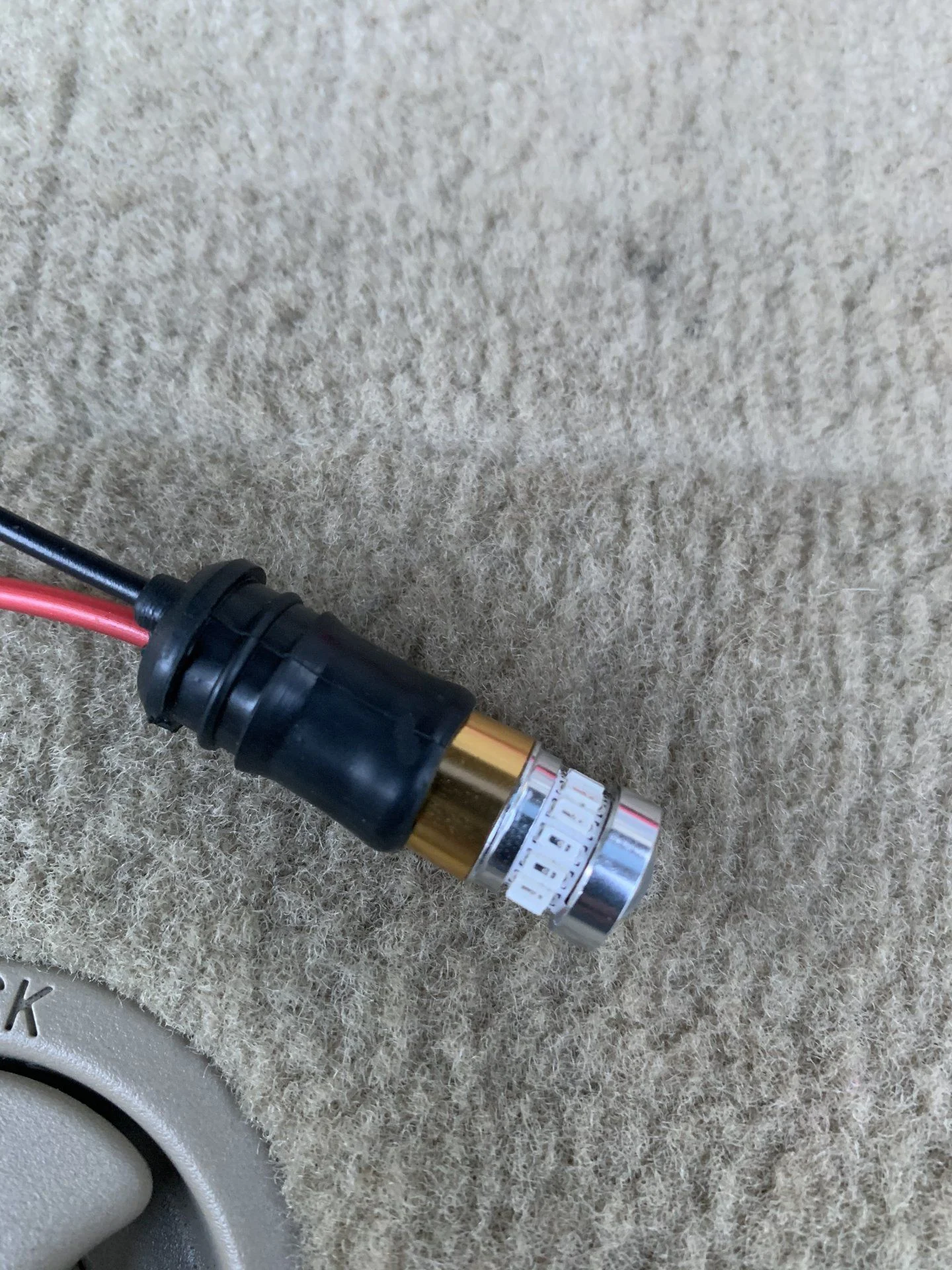

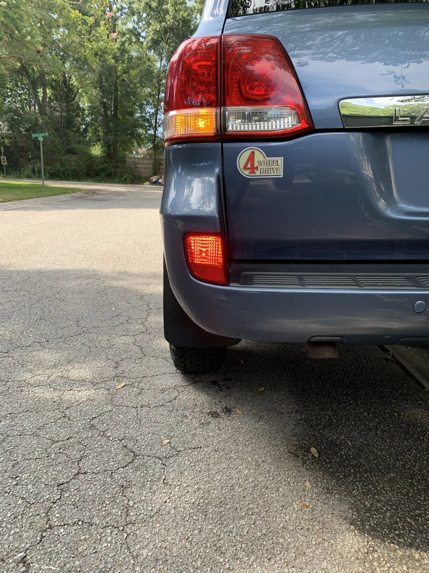

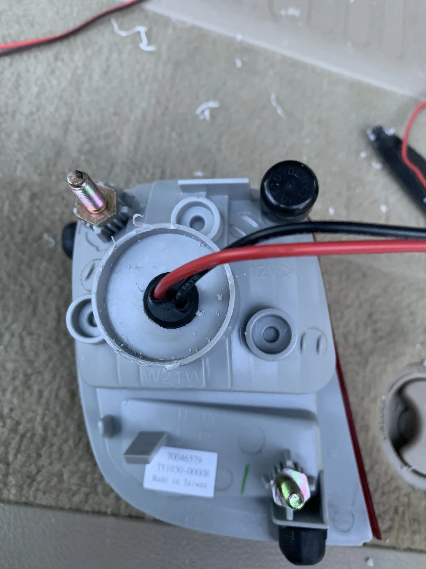

Added some extra lights in the reflectors. Wired them into the trailer lights. They
work with the brake lights, turn signals, and hazards!
TOMALL T10 Socket Pre-wired Connector for LED Light Bulbs 194 Female Plug (Pack of 4) Amazon product ASIN B07BDJMXCT
iBrightstar Newest 12-24V Super... Amazon product ASIN B07H2CXKZ9

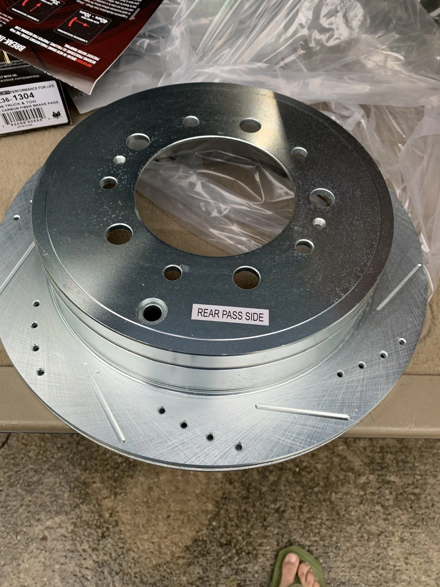

Rotors were pretty bad and I was getting some pulsating. Especially towing so I went ahead and replaced the rotors and pads with the Power Stop heavy duty Ones. Drilled and slotted with their pads. The front worked out perfectly and I’m impressed with how they feel. Back not so much. The rotors they sent for the back rubbed on the backing plates and I couldn’t use them. I am using the ceramic pads all the way around though. Waiting to hear back from power stop for a replacement set of rotors for the rear.

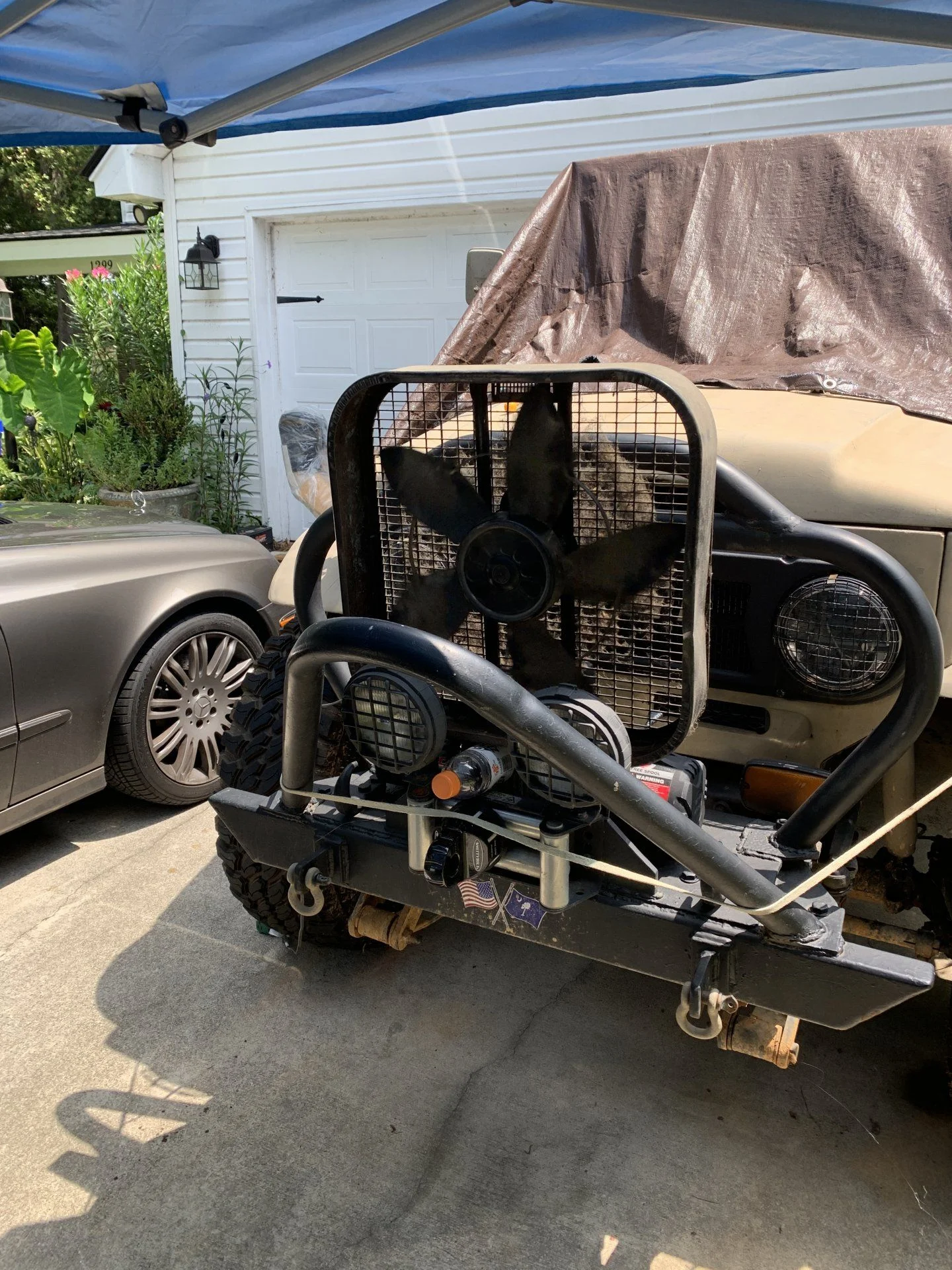

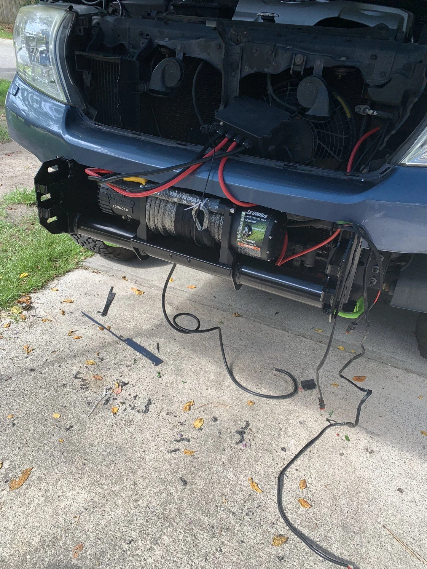

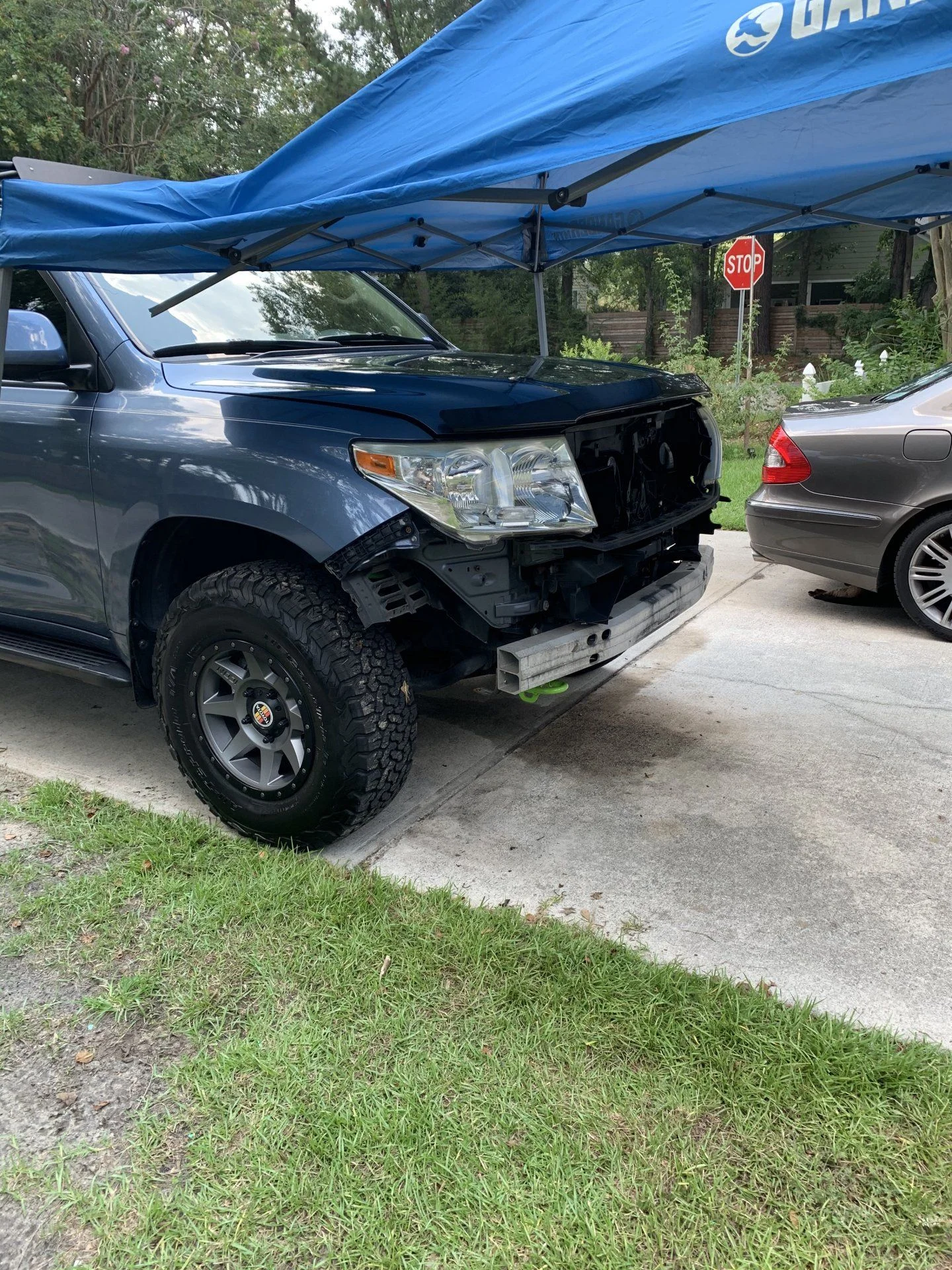

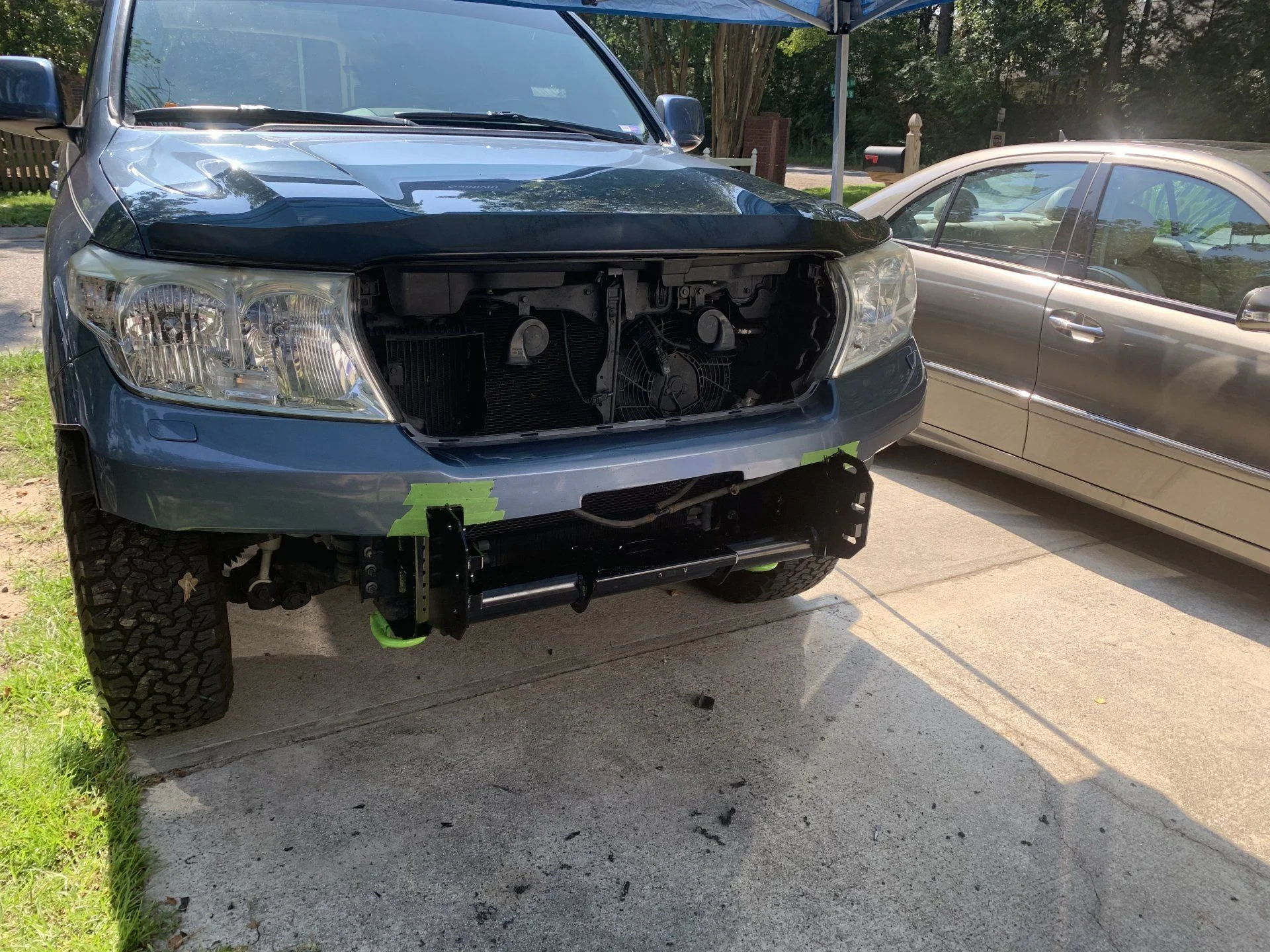

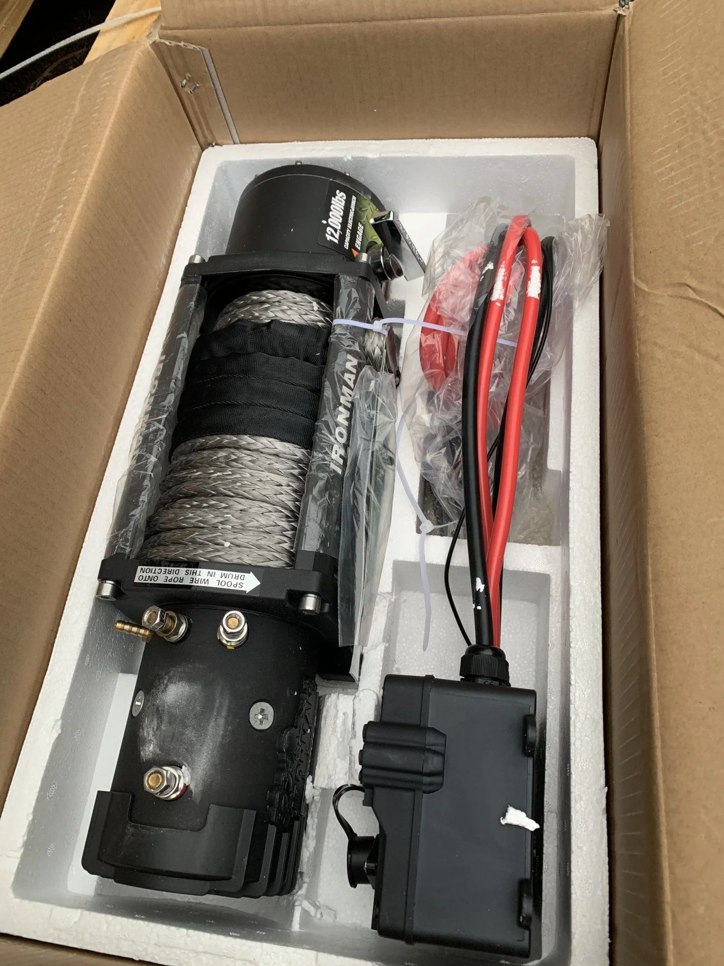

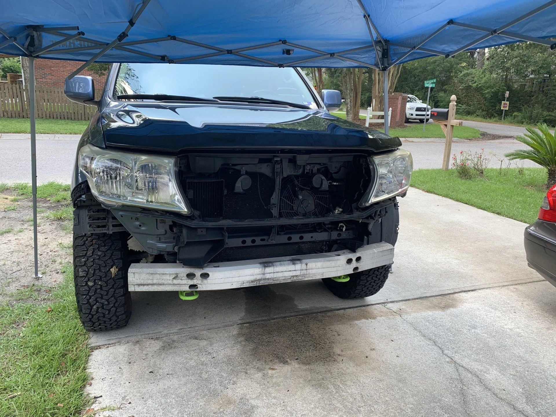

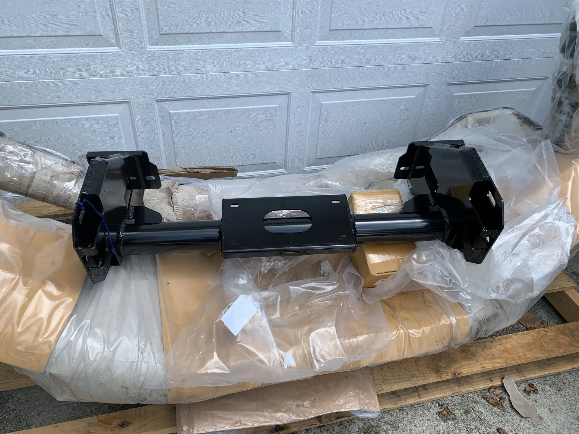

Lots of hardware and I have to take the winch partially apart to rotate the lever around to where you can reach it. Had to get the “easy up” out to get some shade to work under and use the 40 to hold the fan. Lol Had to work this afternoon so this is as far as I got

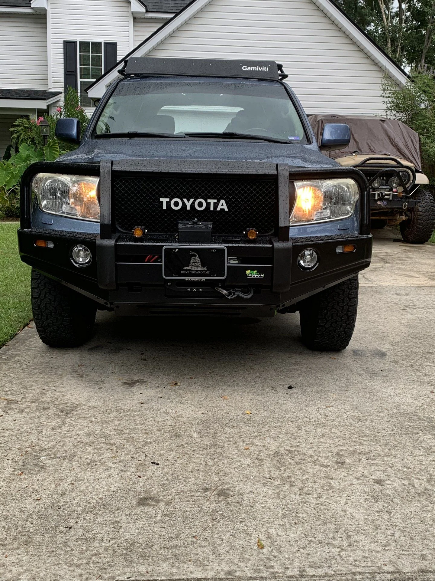

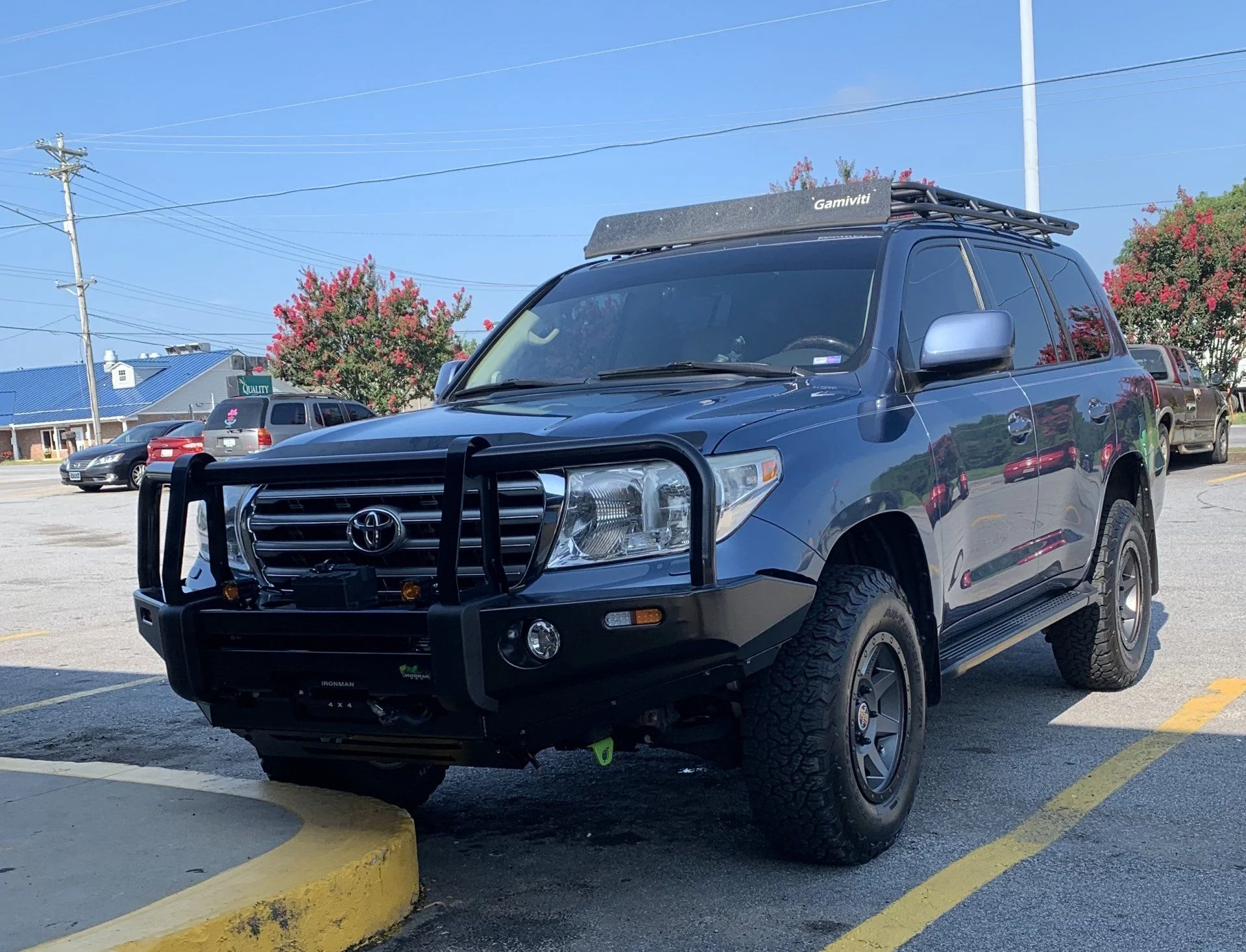

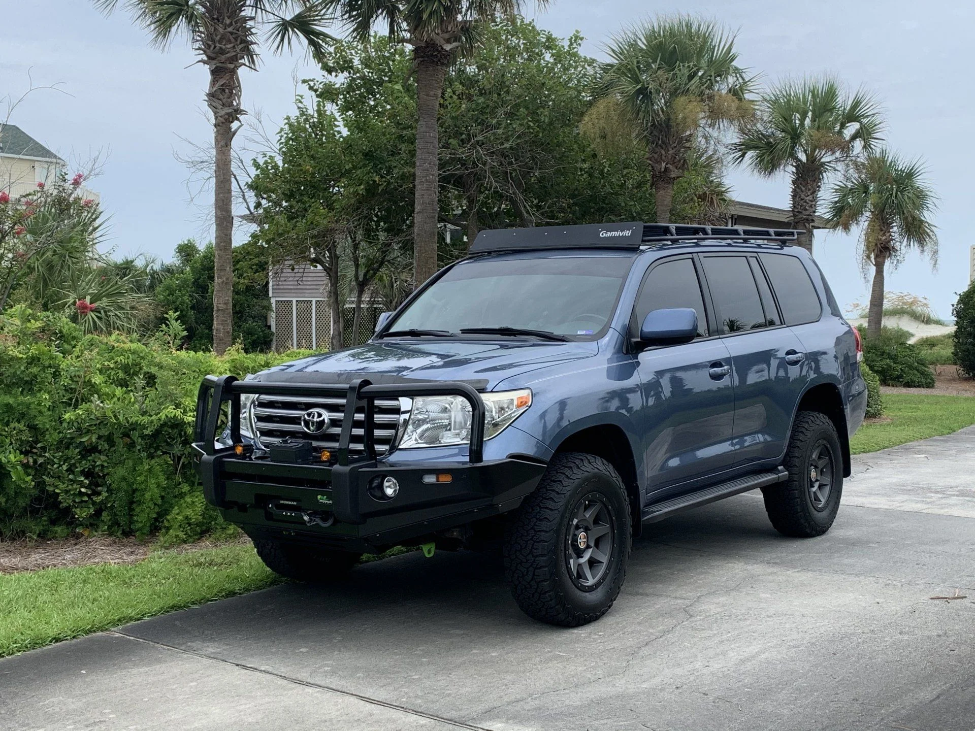

Lots of Iron Man on your rig - How do you like the suspension? Was considering it as an alternative to BP51 which is about 2X those. Appreciate any info you can provide on the lift.. Cheers
Price was right. I like the suspension a lot. Rides nice and doesn’t nosedive anymore. I got the suspension and the bumper when they were on sale. Hard to beat their prices, especially with free shipping.

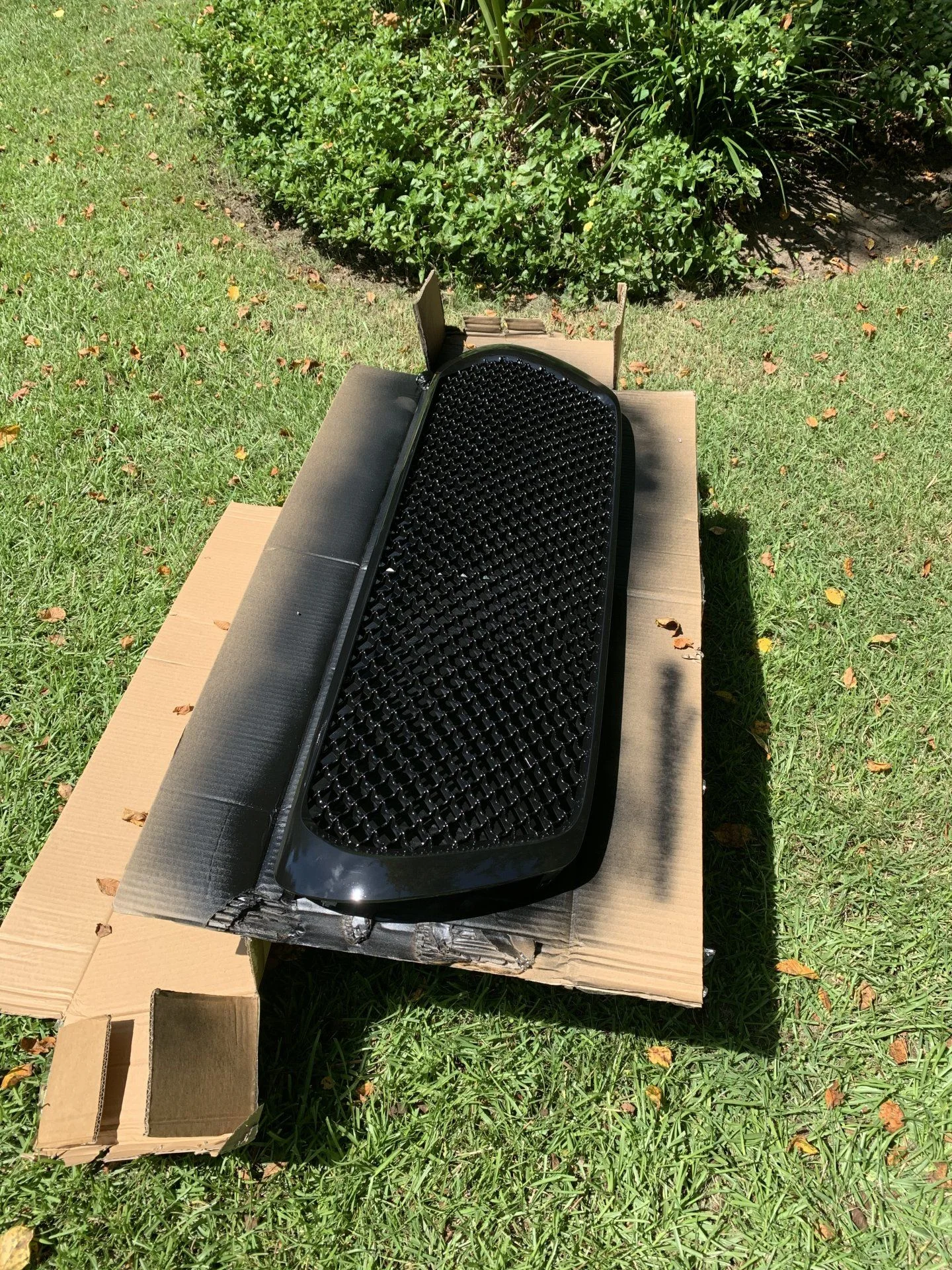

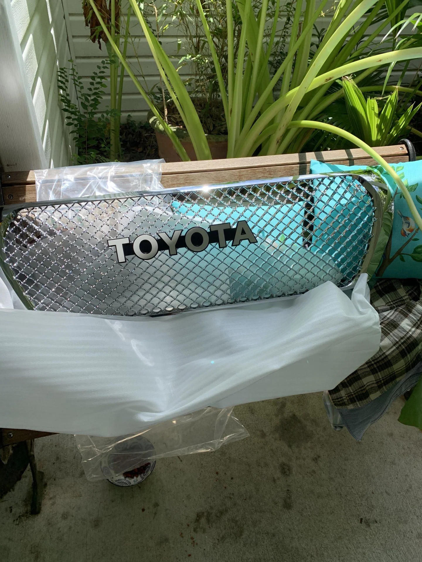

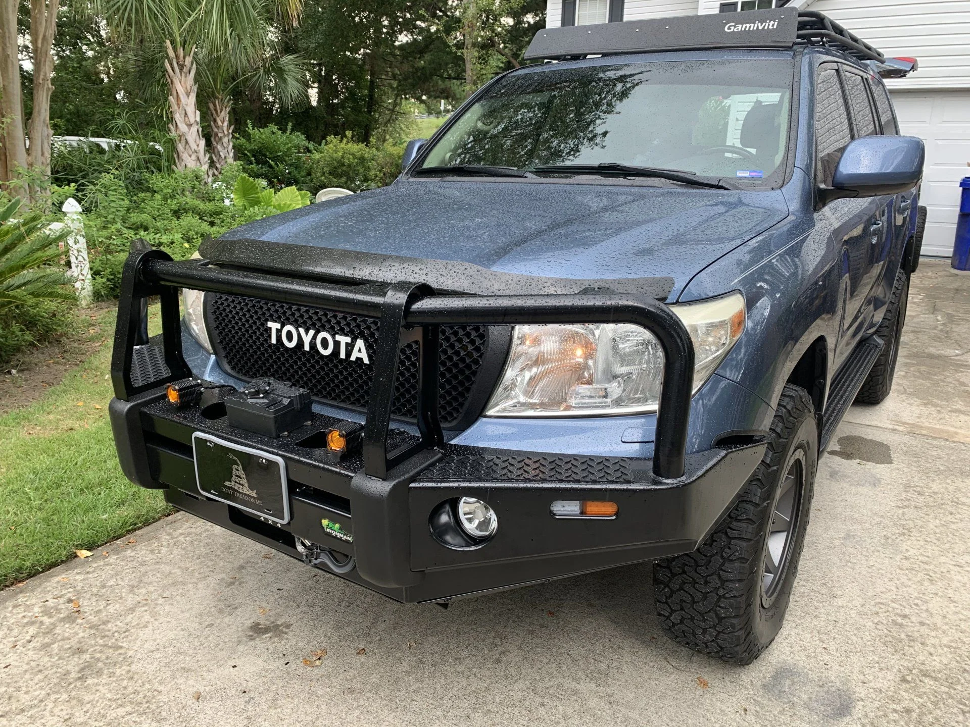

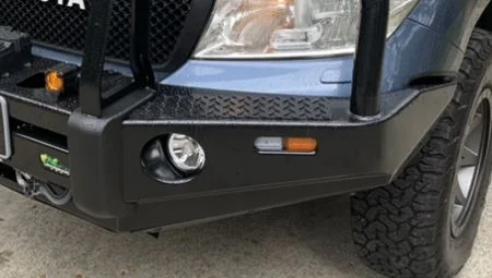

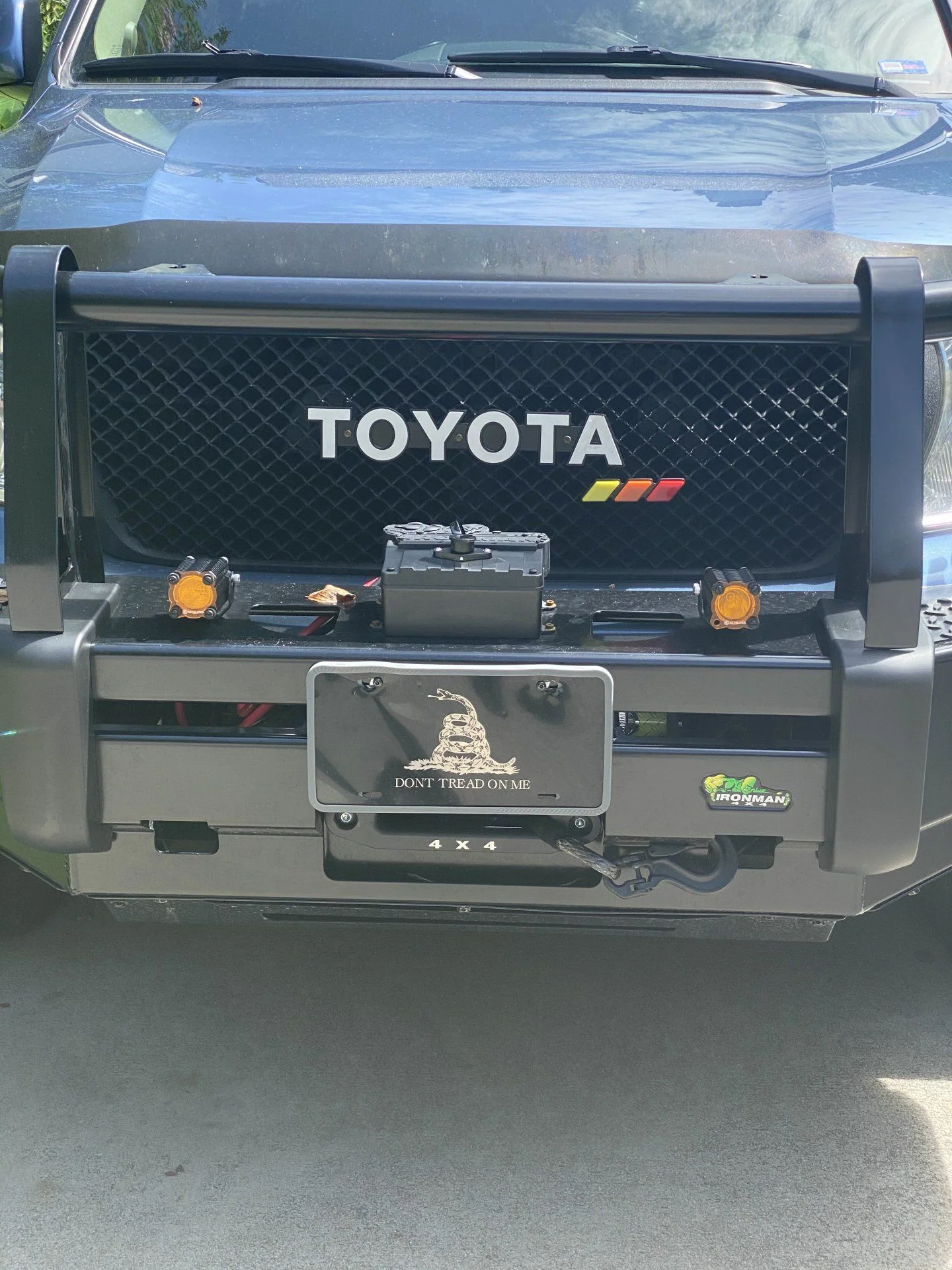

Grill is done. Also added some heavy rubber traction pads. After setting a couple of tools down there I figured I’d better put something there to protect the paint. Also nice in case I need to stand there.
