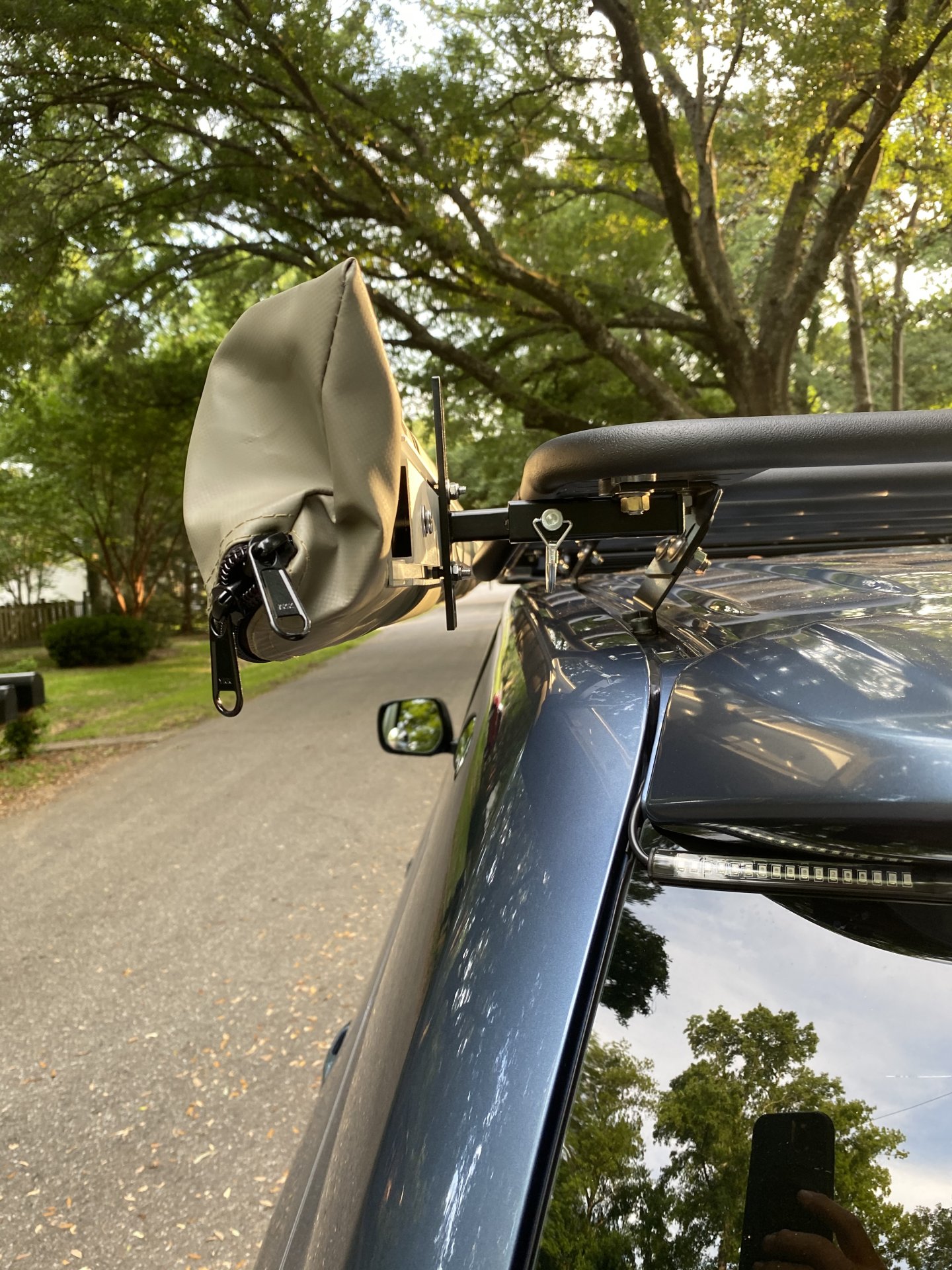

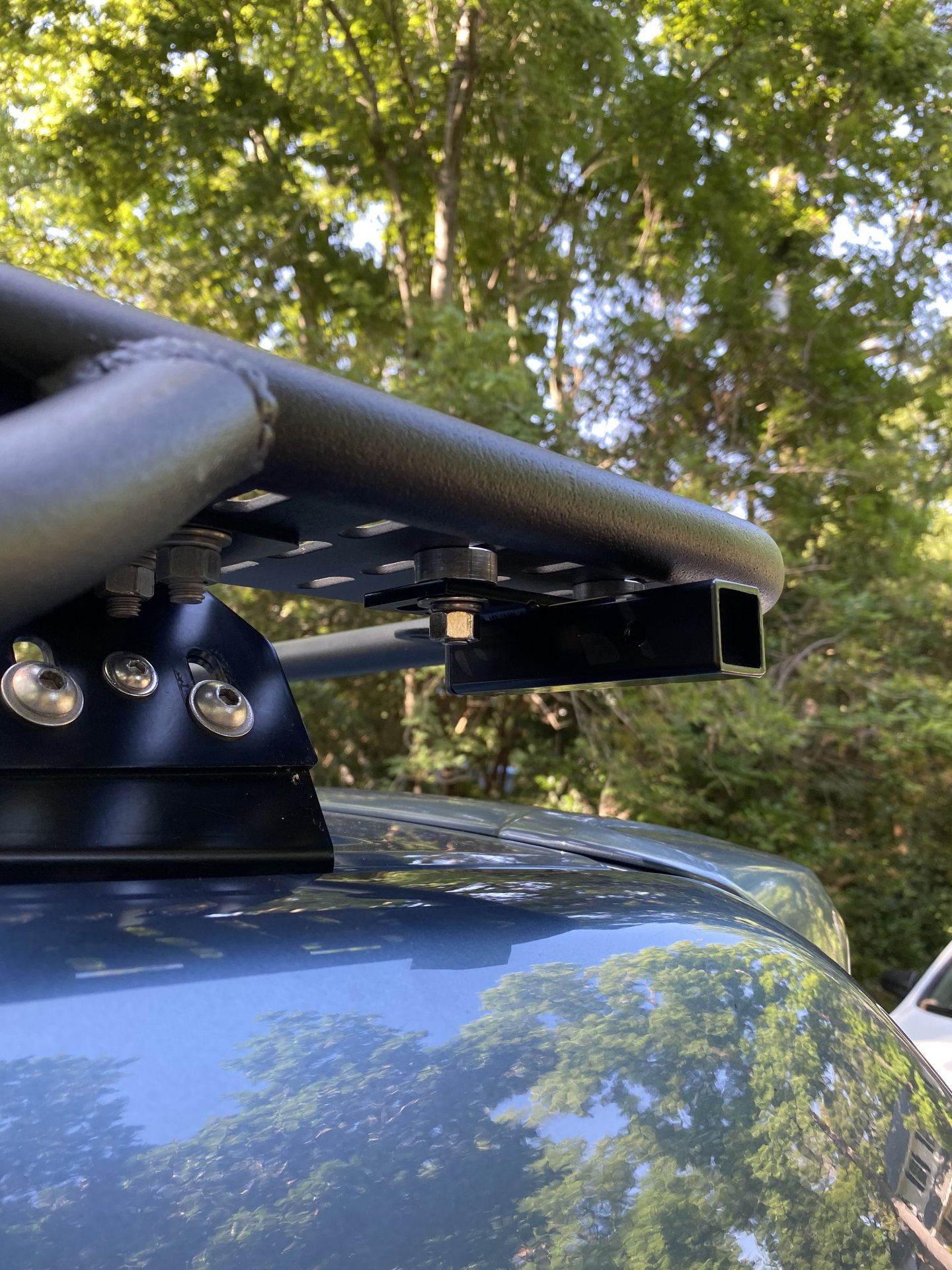

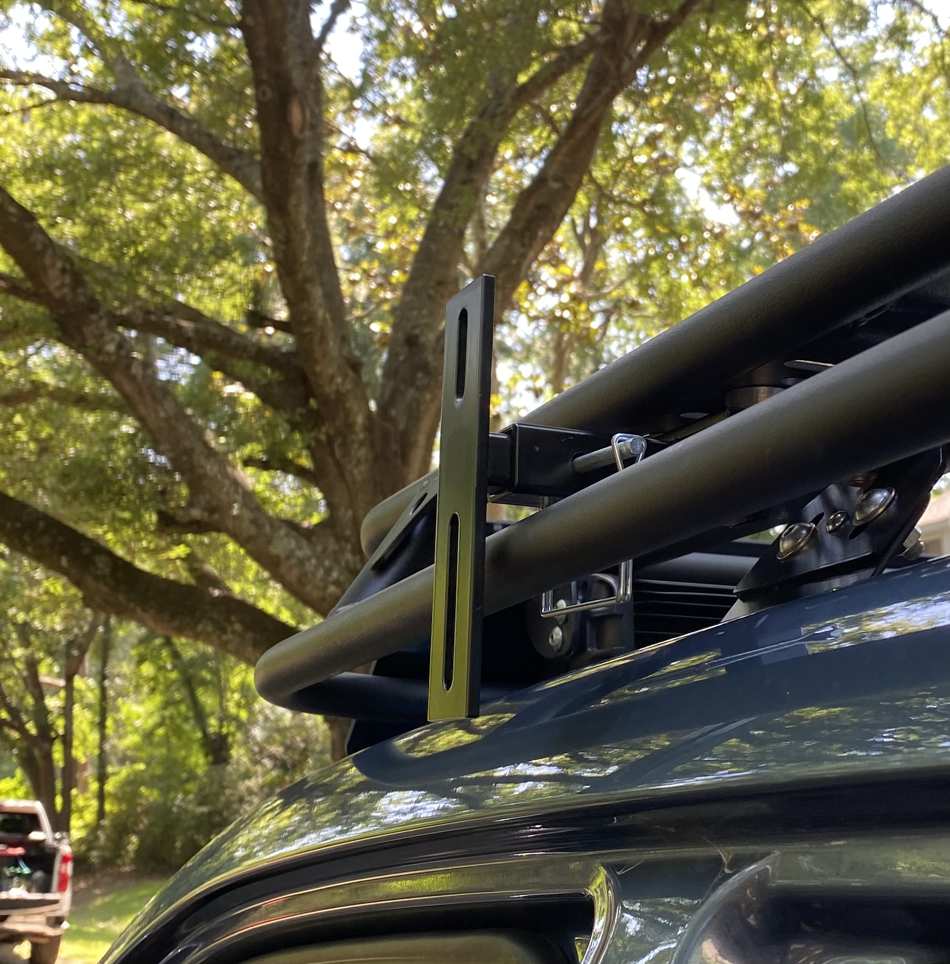

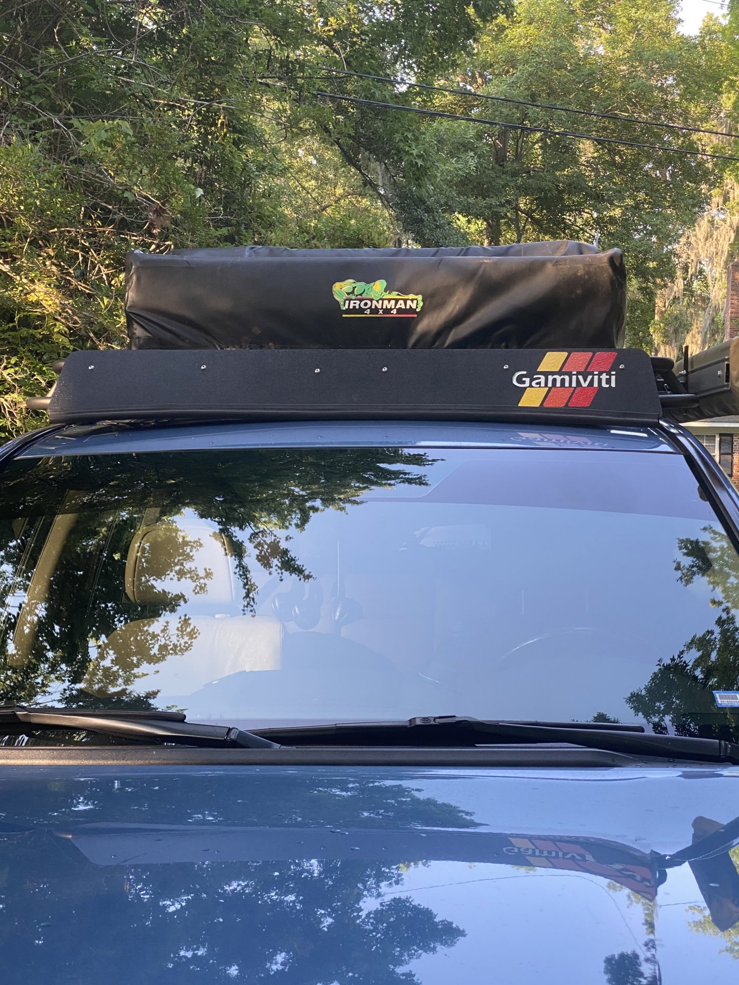

Got my quick release brackets for my awning installed. Now just have to get the awning here before Relic. Called them today. Should here Wednesday.

I really like the quick connects so you can’t take the awning on and off easily. Has pins that hold it in and it will also fit a small padlock to slow someone down if they try to steal it.

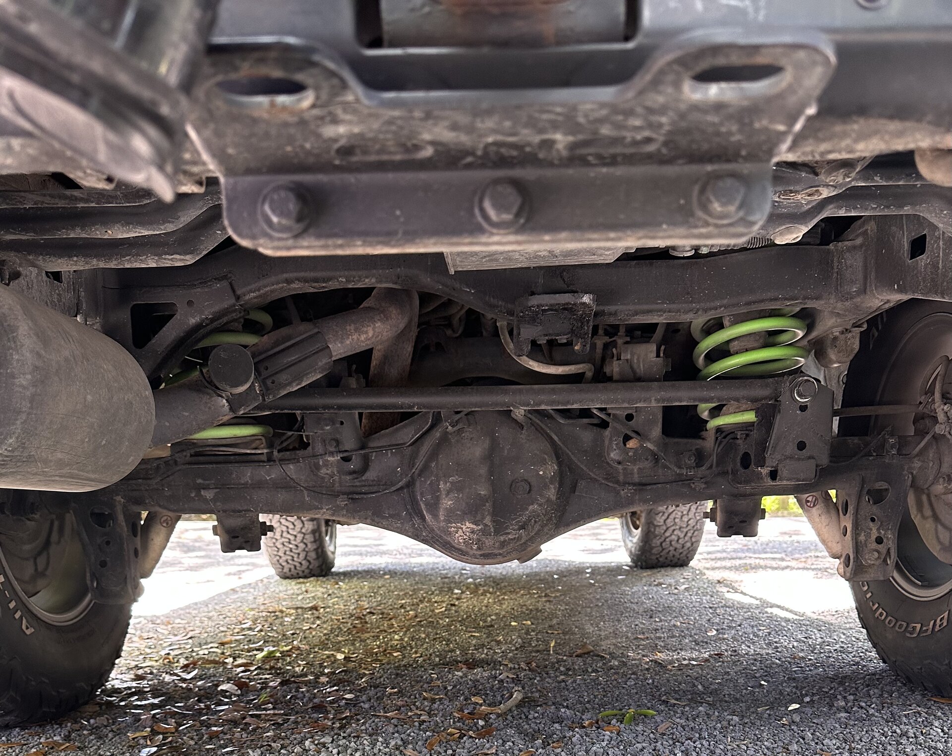

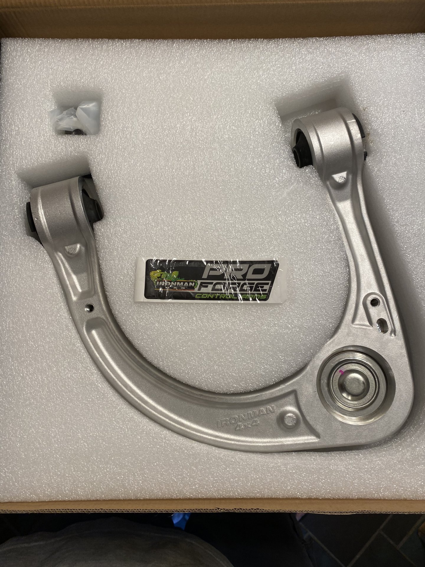

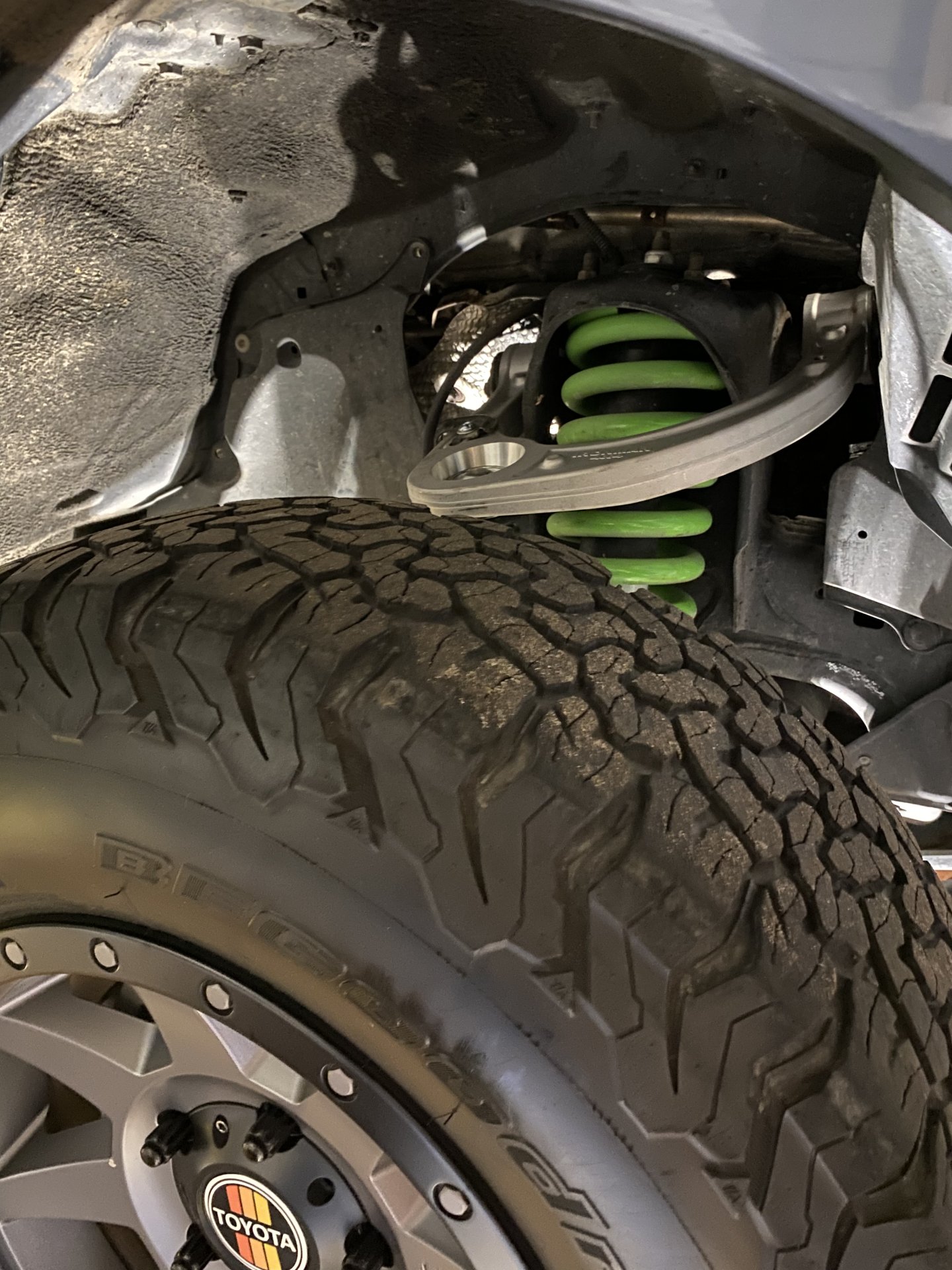

Nope. Ordered them and they showed up at my front door about 5 days later. Besides I probably should have gotten them when I originally got the lift. I researched it and most of the stuff I read said you didn’t have to do them with the two inch but… they couldn’t get the alignment dial in and it’s wearing my front tires more than it should. Tires are so damn expensive the UCA’s will be cheaper than having to replace tires as often.
