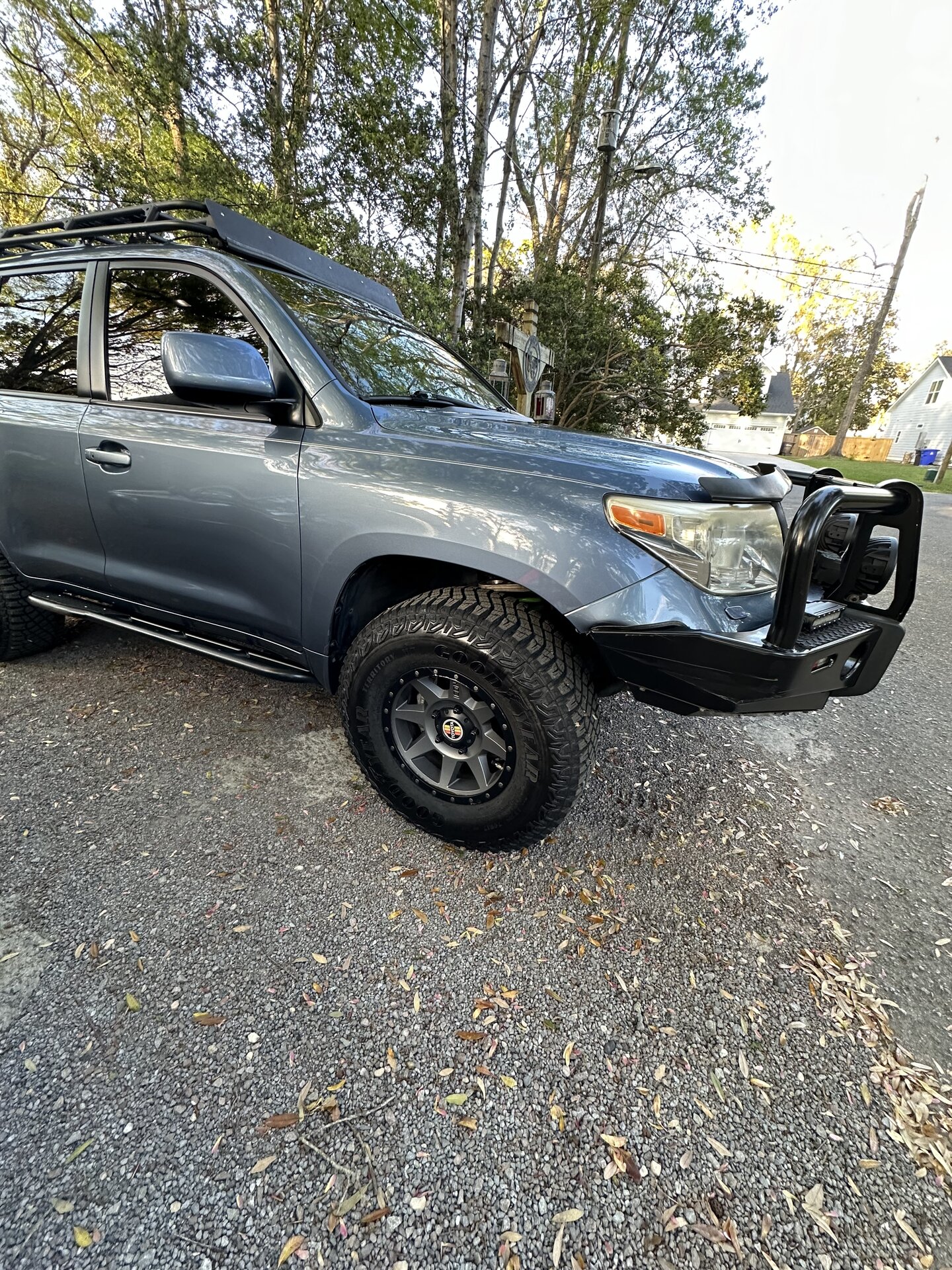

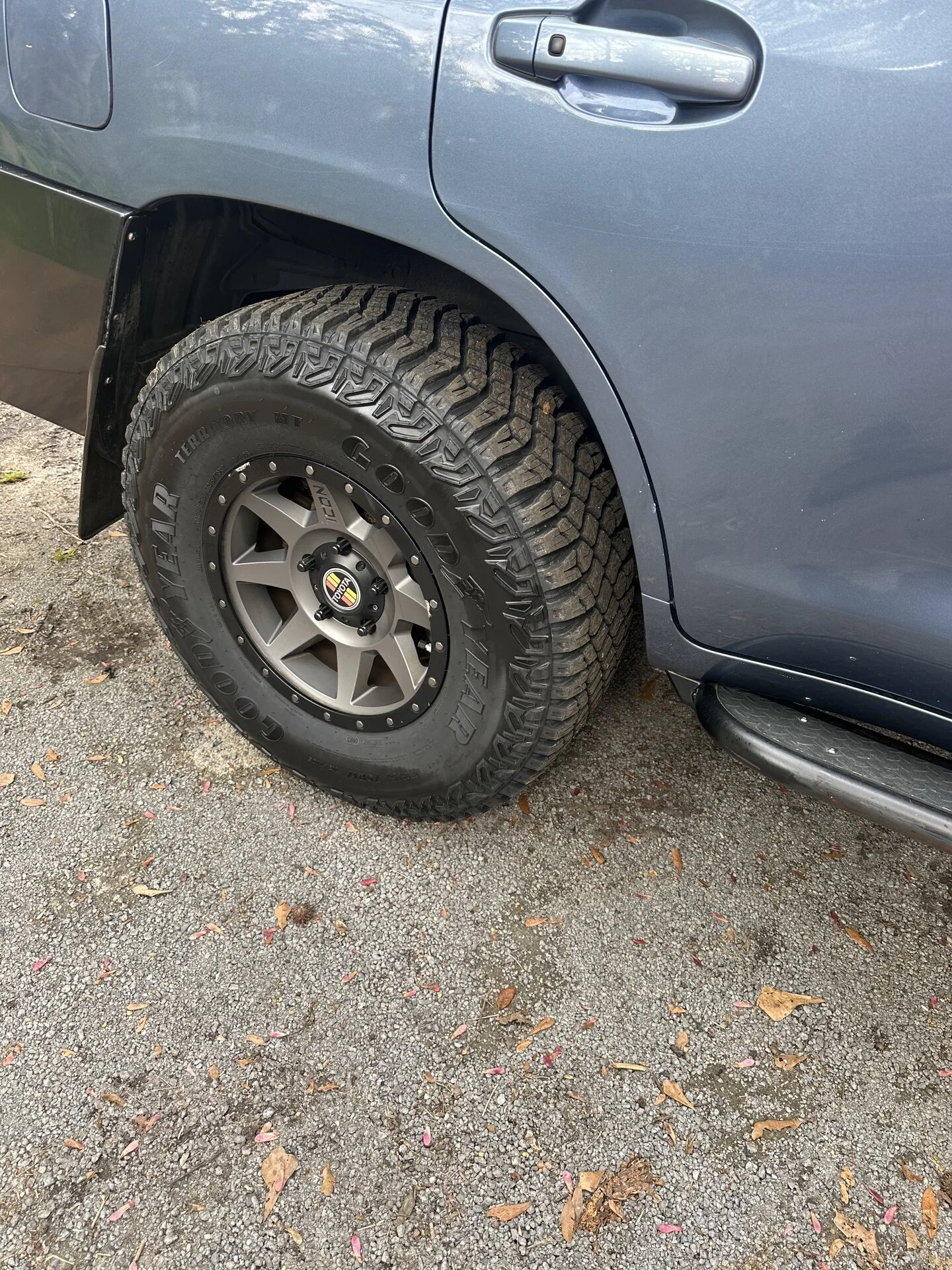

happy birthday! Baby got a new pair of shoes!! 315 70 17’s. Actual measurement is 34.4 x 12.50
Great price for 35’s if anyone is interested. So far they ride really nicely and aren’t real loud.

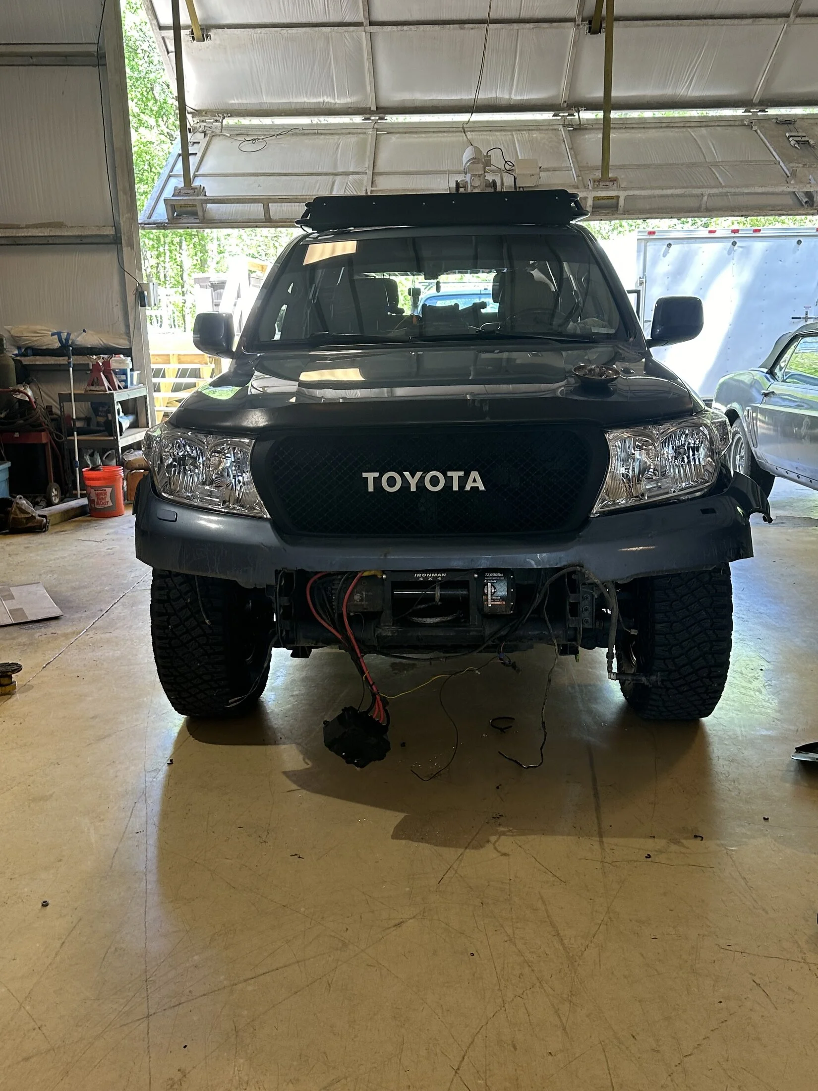

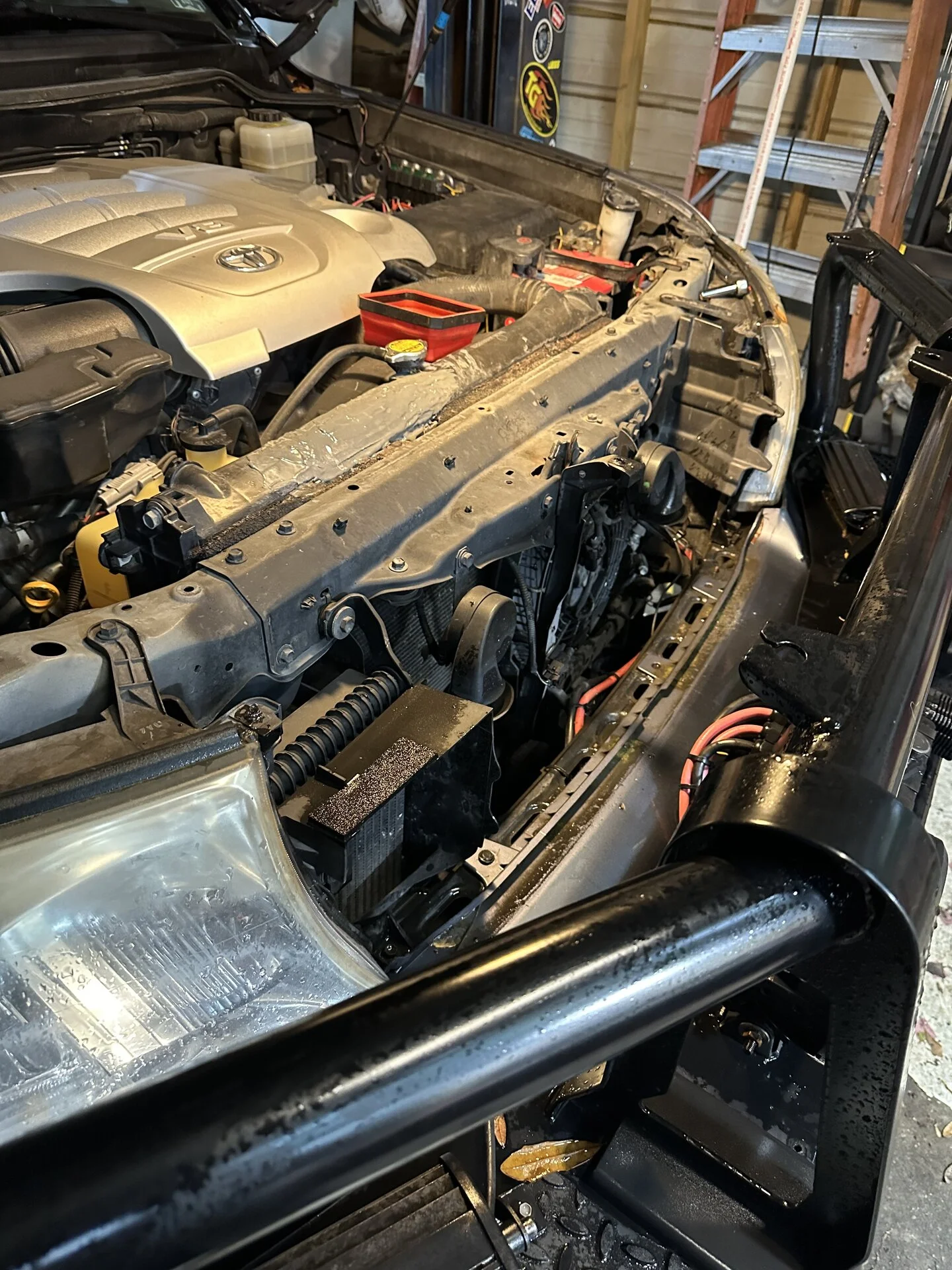

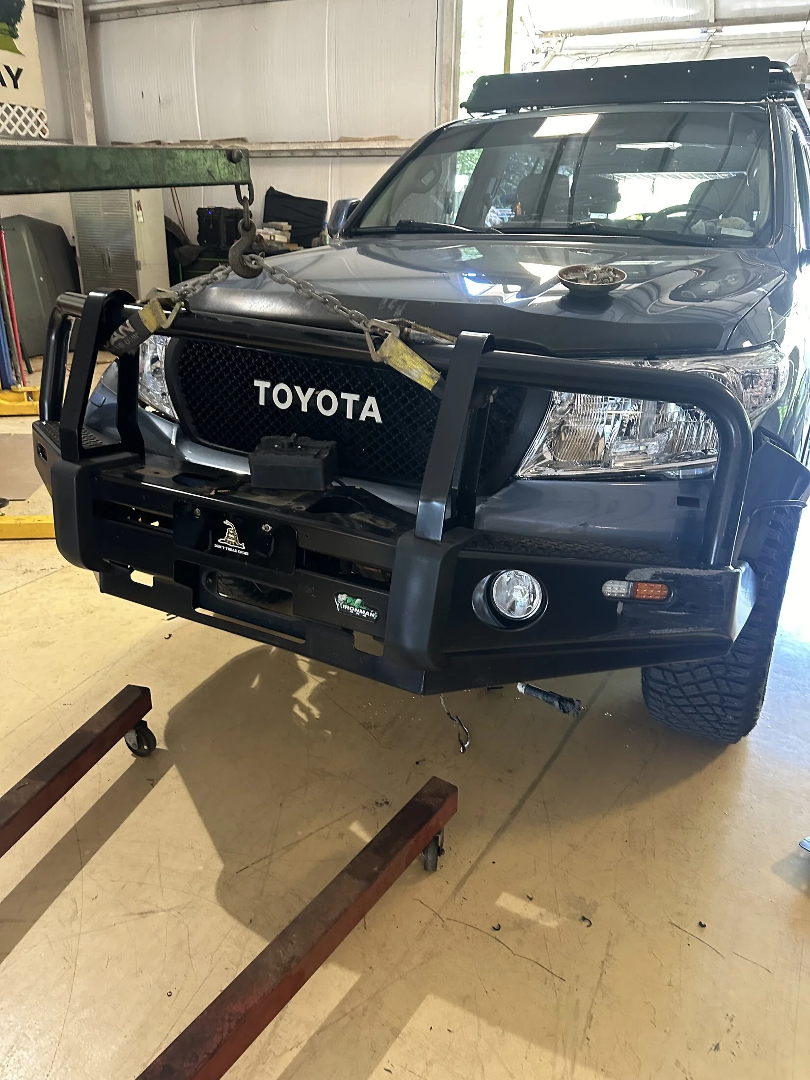

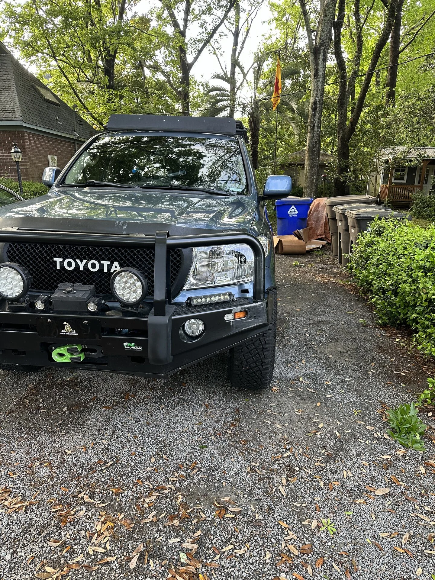

Now that we have replaced the right front upper and lower ball joints, hard and soft brake lines, and the CV Axle the truck is back on the road. Still have to install the new front bumper and some OEM parts ( headlights, lower, control arm, and alignment parts when they come in.

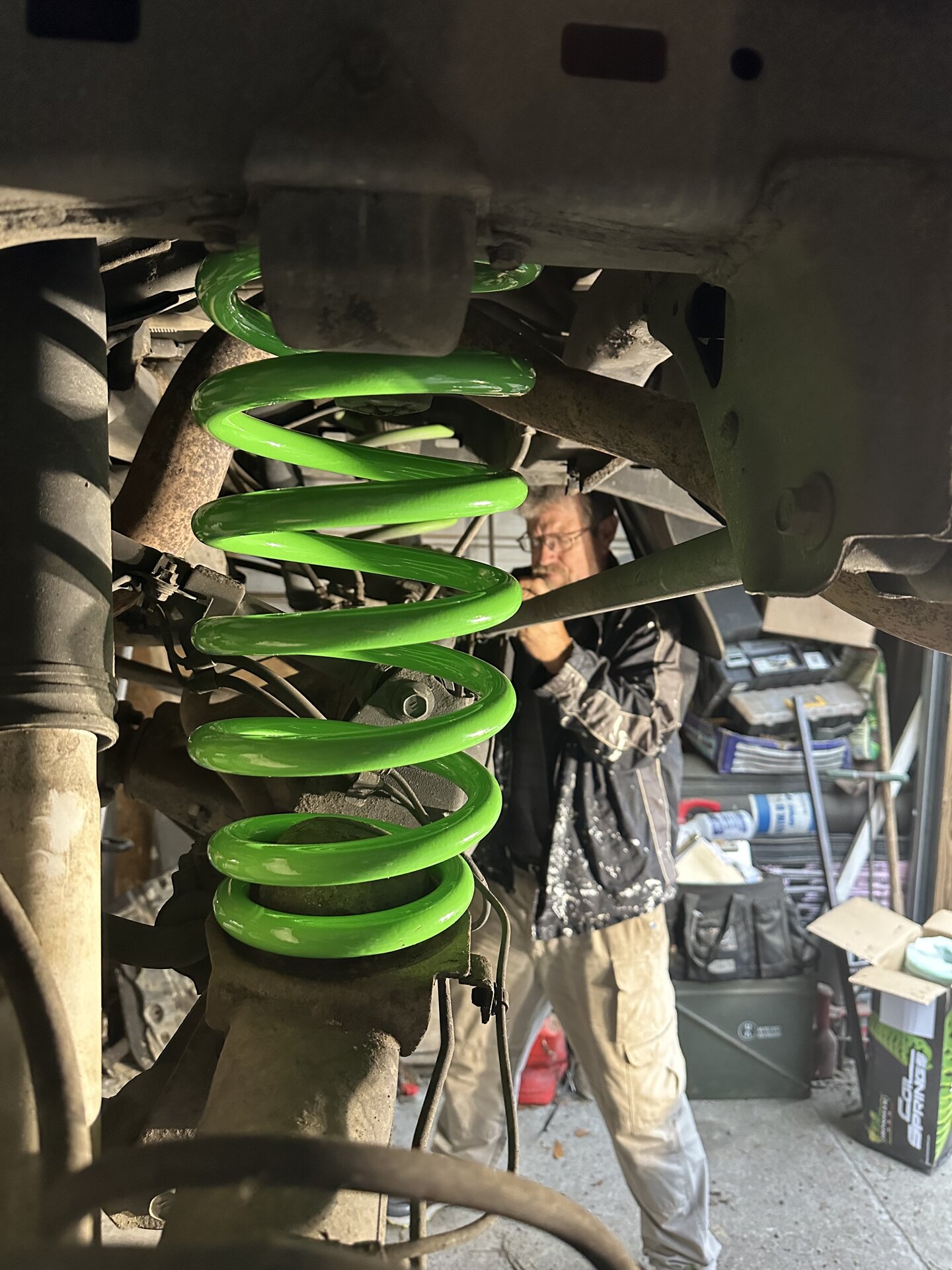

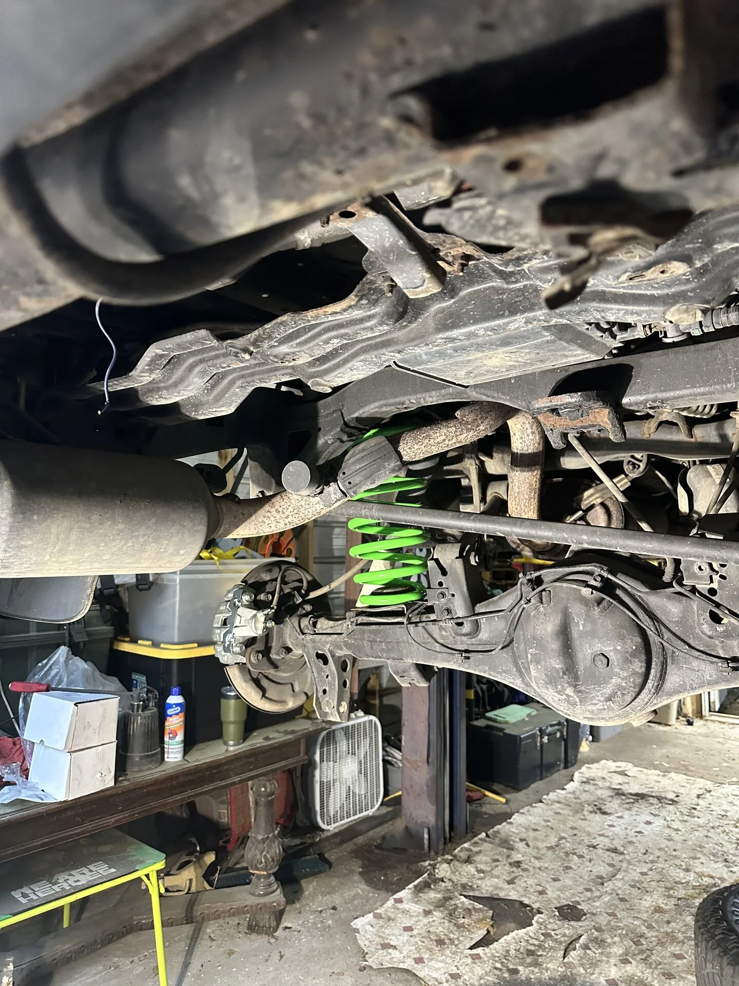

Meanwhile doing some other needed maintenance. New HD towing rotors with ceramic pads along with new calipers. Also swapped out my standard 2” lift springs with a set of mediums to handle the extra weight. When we originally did the lift I wasn’t planning on doing a. Heavy bumper with swing outs. With gear and the Dobinson bumper and now a 35 on the carrier I needed the upgraded rear springs.

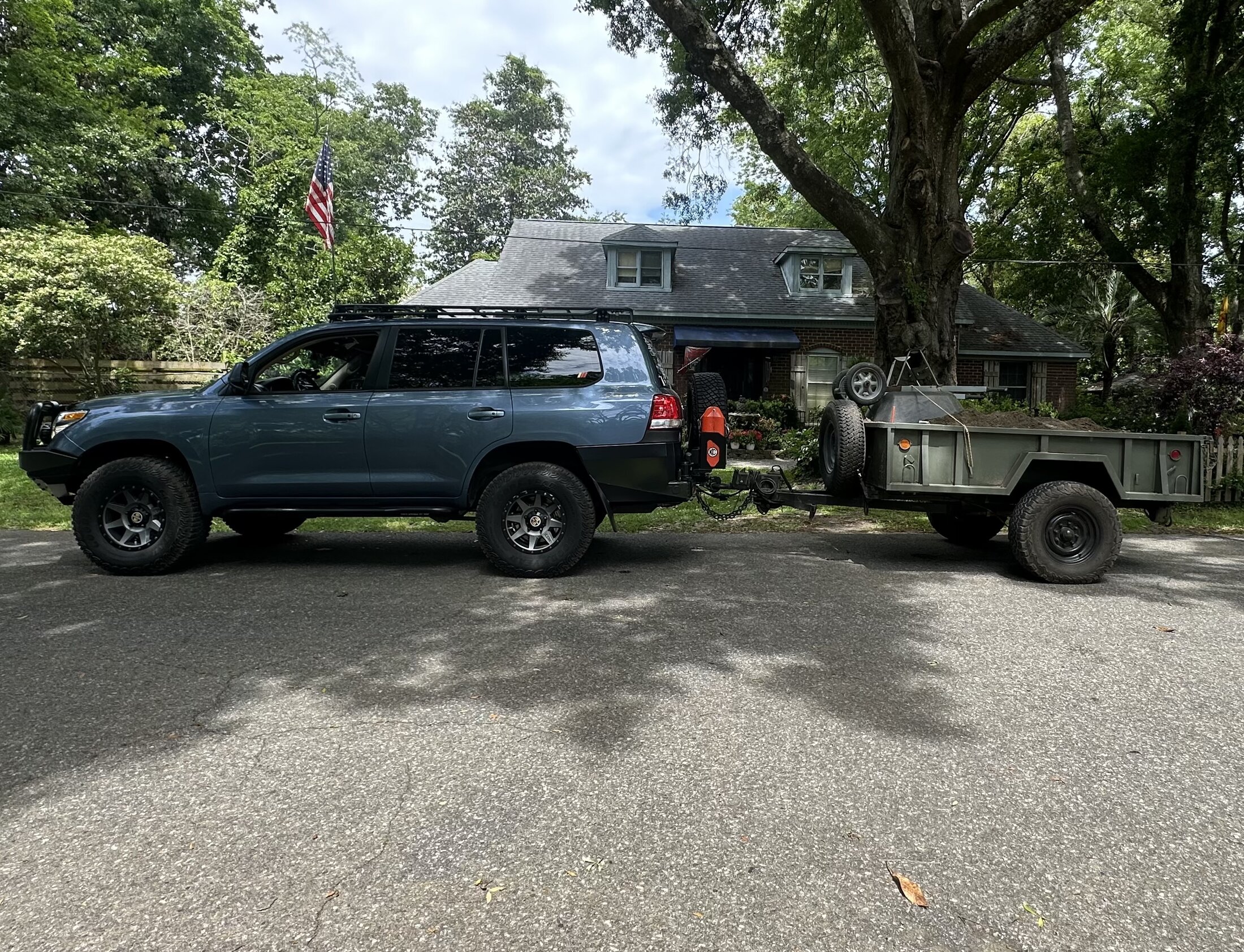

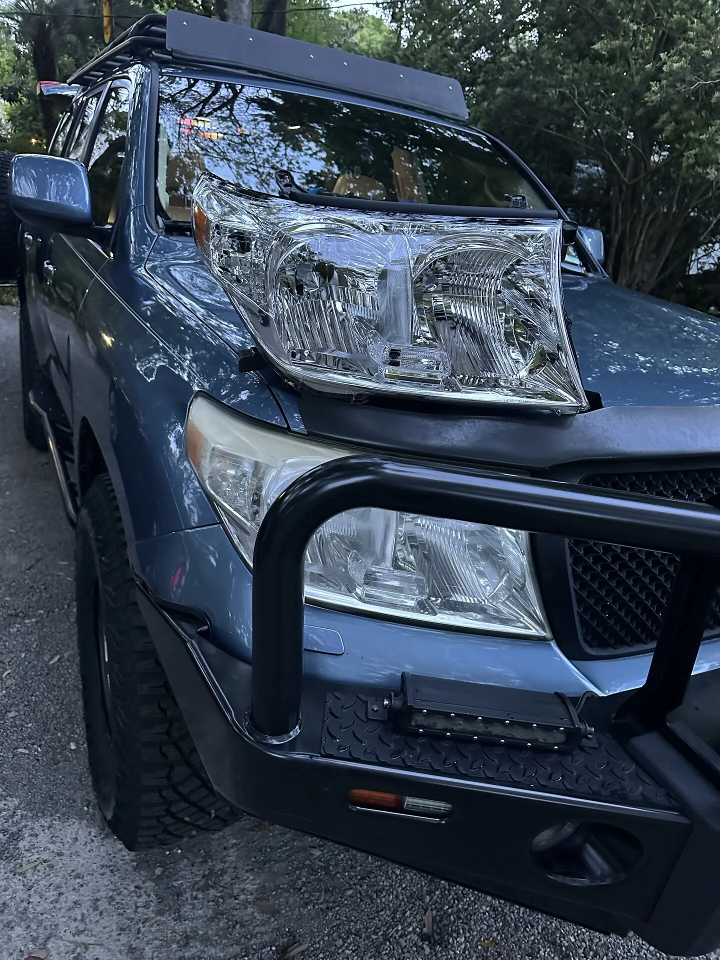

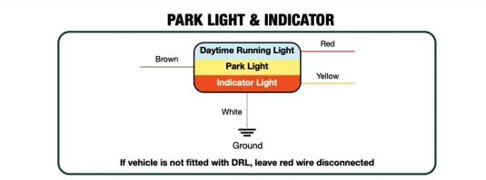

Got the new bumper on and the lights wired up. The new medium spring in the back make a huge difference towing. Towing the 80 to CRR was a breeze and so is towing g my military trailer with 2.5 yards of dirt.

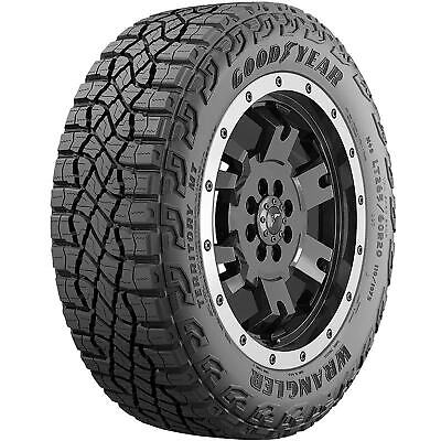

Time for new shoes again. 🤦‍♂️
Kenda Klever RT’s 35x10.50. Load range D . Watched a lot of reviews and talked to some people running them. All good reviews. I’ve done about 100 miles on them so far and they ride a lot better than the Goodyears. Goodyears were great for a while but they were LRC’s . Trucks a little heavy for them.
*** side note. I had two different shops do horrible alignments which contributed to the demise of the Goodyears.
2” lift
17 x 8.5 Icon Rebounds with -25 offset
Iron Man forged UCA’s
Everything clears except full lock toward passenger side if you compress the suspension. Tire rubs the KDSS but it’s not bad.
