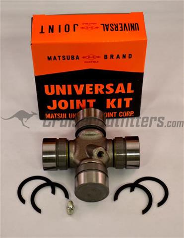

I ordered 4x u joints about a year ago from one of my main suppliers and I got a brand I've never used before SKF.
Skf usually makes bearings I think, but I've only ever seen skf u joints this one time.
If this one won't hold up, I'll try a Spicer, or maybe go with factory toyota... Since I've got a stock F engine, I'm going to step out on a limb and say it was probably installer error that caused that joint to fail early. Probably can rile out horsepower as the cause of failure... I put in another SKF, because that's what I had sitting on the shelf. Only time will tell.
Slip joint has some play but it's miniscule compared to that u joint. The hand dial indicator says .005" or less. I'm calling that within tolerance.

I had the exact same thing happen with Spicer U-joints.
Kurt @cruiseroutfit had me try his Matsuba - Japanese U-Joints and they solved all my issues.
Nice! I'll use up my stock of what I've got and if problems still persist, I'll give the matsubas a try.
One thing I need to source soon is u joints for my steering shaft maybe Matsuba will have them, I'll check them first... Thanks for the heads up!
The Matsuba's rock. Made in Japan, great applications for Land Cruisers and they are robust. We've got customer racing on them, customers driving around the world on them and thousands and thousand of daily drivers. Zero complaints!
