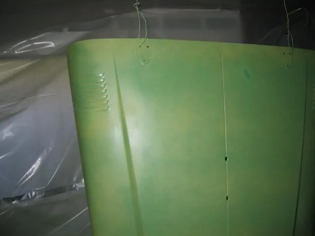

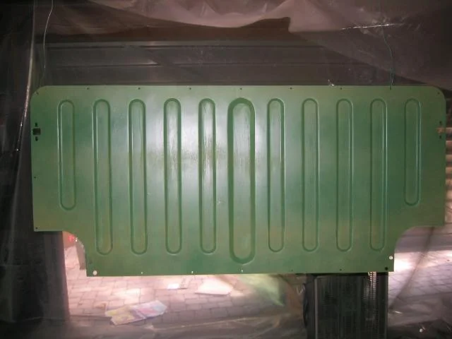

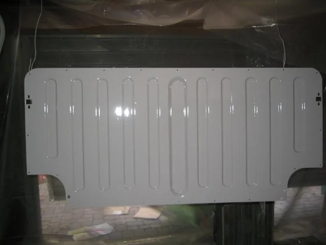

Today I painted sealer and the light color.
Don't have any time to write, but I need some input on these pics.
Question:
1. One the parts that are painted green, is there enough coverage? The green is the sealer/primer.
2. I am getting some orange peel with the light color. What am I doing wrong? Am I moving the gun too fast. Am I not sanding properly? Or is this normal?

Hi Dave,
Sure look good in the pics, nice and shiny :cool:
As far as the green, I think you have enough. You could go a tad heavier, but a light coat of epoxy over the ureathane primer is fine.
As far as orange peel usually 2 causes....the one you mentioned, moving the gun to fast and not laying down enough material. The 2nd is either not enough reducer or the wrong temp reducer. Either will not allow the paint to flow out for the seconds or minutes needed to lay flat and flow out.
Still looks great!!!
Hope that helps, Matt

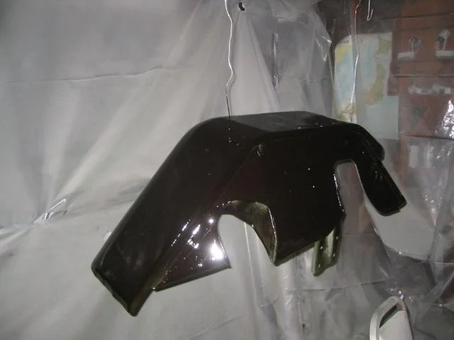

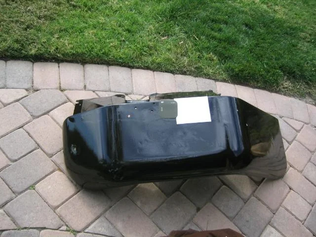

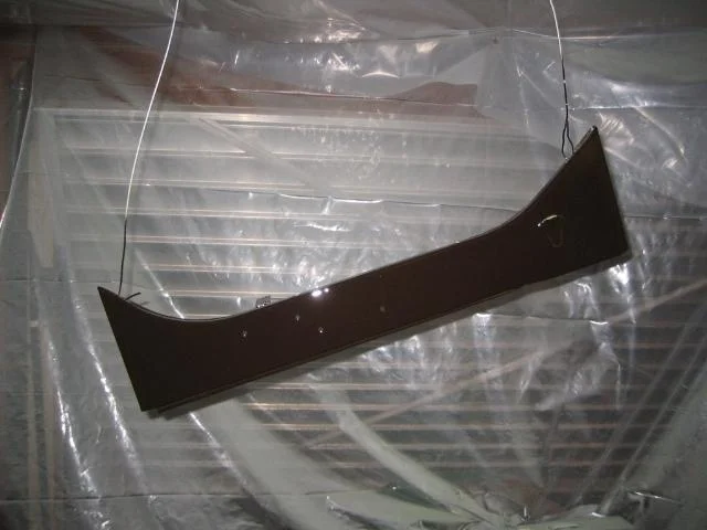

Here are my black.....errrr I mean Olive Green parts. Haven't had them out in the daylight, but I am almost positive that there is a hint of green in them. I will post some pics once they are dry. Even though the color is very dark, I couldn't be more happy.
Taking Matt's advice and not running the gun so fast did help in some areas. However there are still signs of orange peel. Still happy with it.
The one thing that I haven't delt with yet is dust. This whole plastic booth thing has worked out fairly nice. Ya gotta do what ya gotta do and it actually is working. I've got chelsea running the glorified bike pump in the back and my gerry-rig vent system, things are working out much better then expected.

Ok, here ya go. Say hello to my brown fender. In one of the pics you can see the color I wanted it to be, a white envelope and my brown shirt.
I'm not upset with the color. I would just like to know what went wrong. Is it the guy pulling the trigger or the guy mixing the paint. Not that it matters, but consider it an answer to a leason soon to be learned.
I just hope the rest of my olive green, i mean brown will turn out the same color.
Dave
OKAY, enough of this TRAVESTY. I think that the best course of action is to just send the truck back to me (don't worry, I will help pay for half of the shipping). Just kidding. The truck is looking great. You are doing a very nice job on everything. Looking at the color that the fenders turned out, I would say the paint was mixed wrong. That isn't just a little variation. If it were me, I would load up some of the dark parts, take the remainder of the paint, and then visit the paint shop. If they mix the correct paint before you shoot the rest of the car, you could re-do just the parts already painted. And end up with the color you wanted.

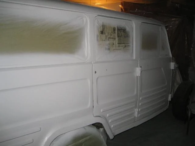

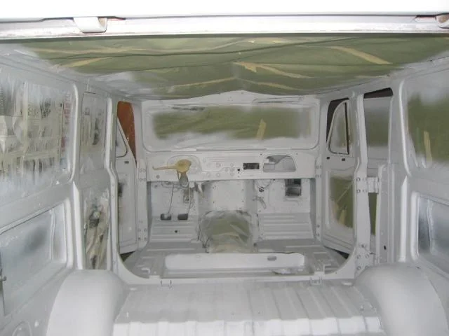

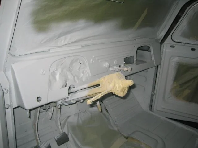

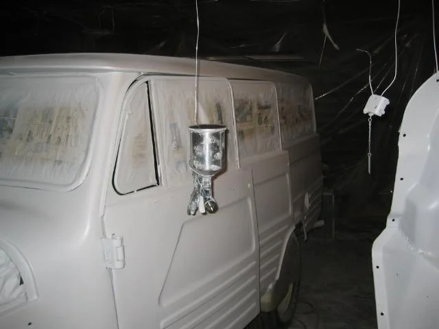

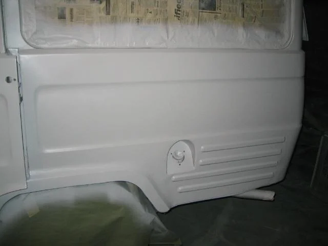

Finally I have a vehicle that is one color.
Today Chelsea and I spent plenty of time getting the wagon ready for paint. Our plans were to put on the base primer and the building primer. As you can tell we only accomplished the base primer. First thing in the morning we will shoot the building primer. After a 4 hr wait for that to dry we will then sand down the building primer.
After that the sealer comes and then the first day of light color.
I hope you are all enjoying my post of the same pic. twice. Yes, I am stupid when it comes to computers. Yes, I am the one who wears the skirt when it comes to computers.
