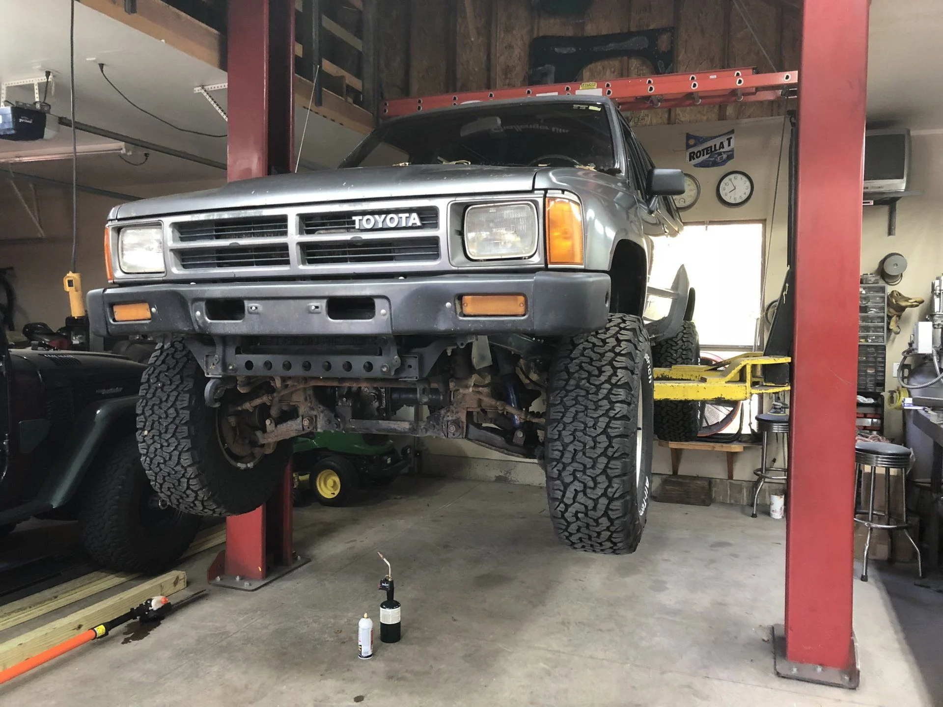

After recently buying an ‘88 4Runner on the cheap, I decided the Dodge looking grille and Jeep XJ head lights had to go. They’ve always been my biggest dislike about the 1st gen 4runners. On the flip side I have always loved the 79-81 pick ups with their grilles and round headlights.
With my 4runner being in less than pristine shape, and me not being quite a “keep it original” person, I decided it was time to change it up.
Here’s the grille I had. I’ve noticed there are some variations out there, but this one is my least favorite. You can see all the distortion in my front bumper. Pushed in and up in places and overall not uniform.

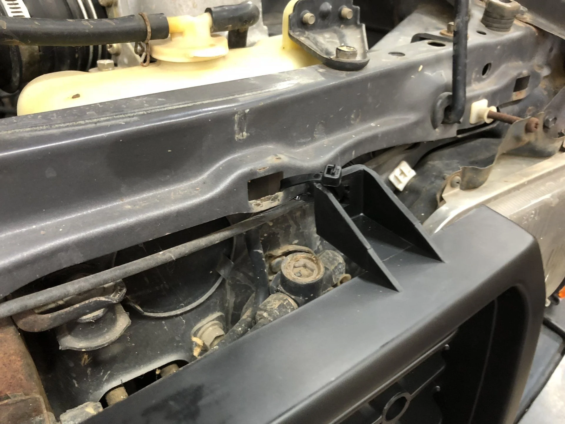

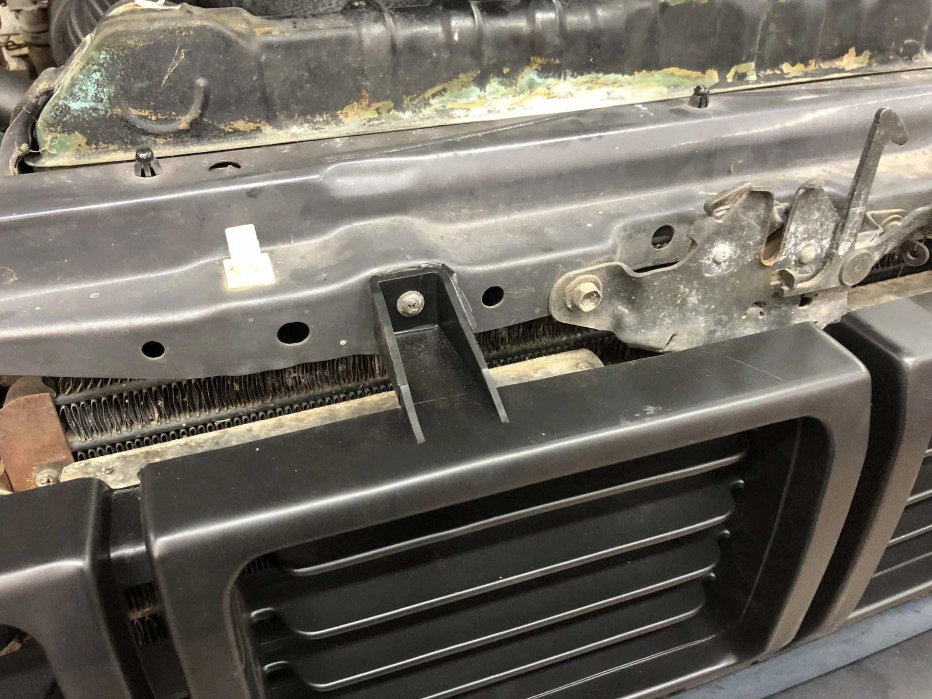

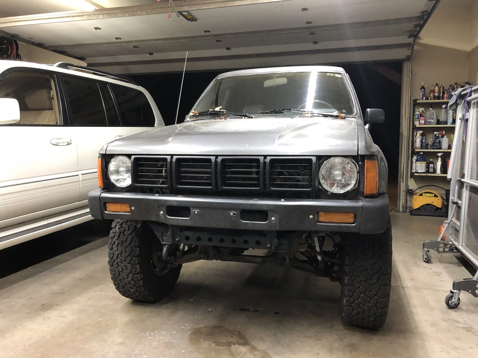

“Installing” the grille was fairly easy. The top two middle mounts (screw and clip) line up with the 4runner’s mounts. So I installed those. Then for the outside mounts I ran zip ties in the cleanest manner possible. There are also zip ties securing the outside bottom mounts. The grille is rock solid but I still don’t like the idea of zip ties so I’ll be changing this up some day in the future if I go about doing s full respray and decide to add metal where it’s needed.

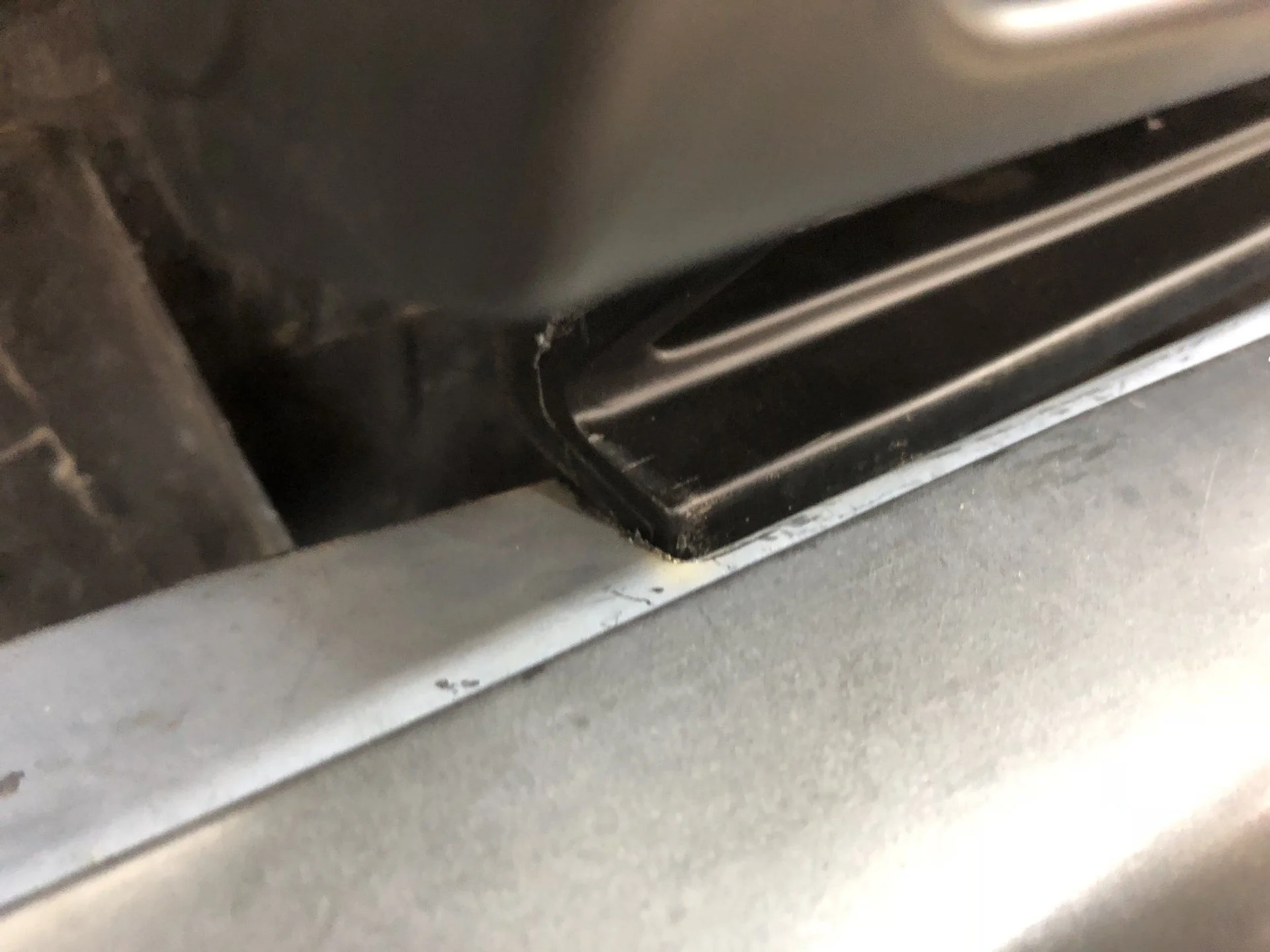

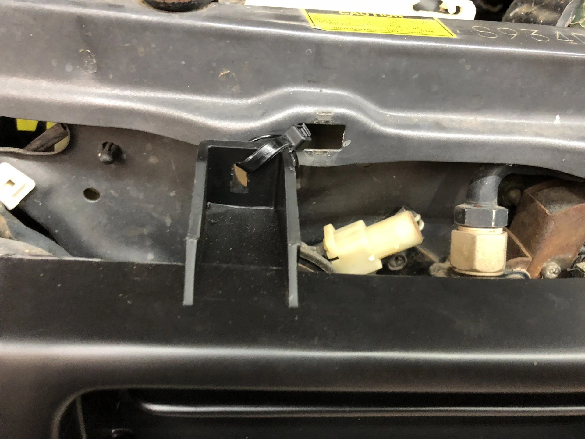

I did have to cut the mount on the back of the grille off as it was interfering with the AC drier. I also cut the full panel behind the front bumper. If you have a pristine front bumper or aftermarket bumper this might not need to be done, but my front bumper is bent in every direction so I made two relief cuts and folded it down and out of the way.
Here is it contacting

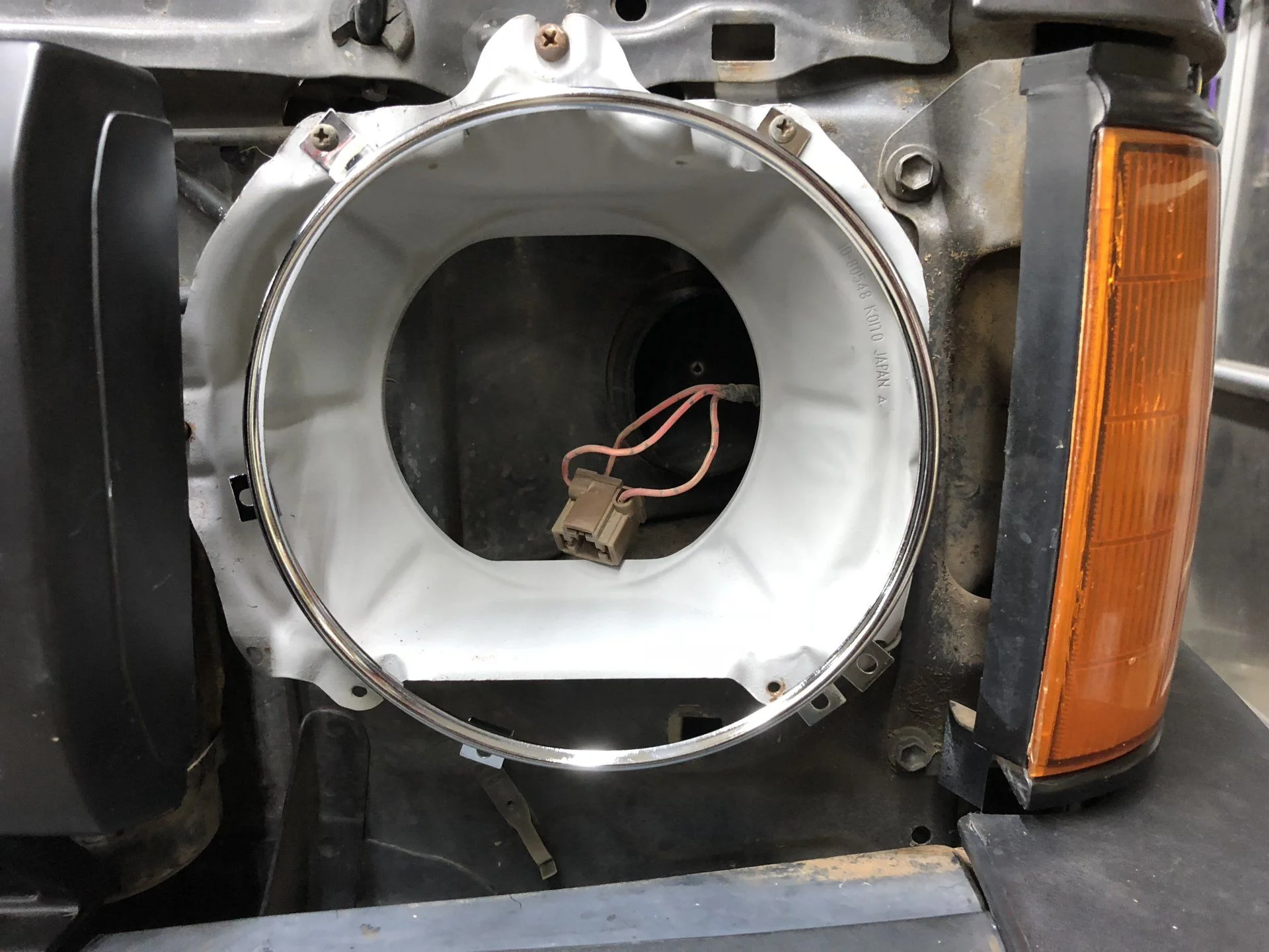

I searched around for a bit and stumbled across Dorman 42408 7” universal headlight retaining rings on amazon. $22 later and they were on the way.

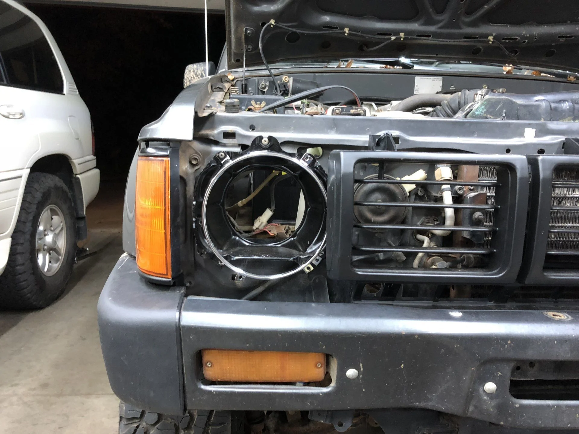

The driver’s side installed perfectly and just how I wanted. I wouldn’t be opposed to having the headlights stick further out, but I will need to space the factory headlight buckets out or make custom ones.
I used two of the old short screws on the top and then one long supplied screw to snug it all together on the bottom right. It took about 10-15 minutes to figure out the orientation to get the most screw holes to line up while also keeping the headlight happy in the housing. I did have to play with the tabs slightly.
Now the passenger side is a little different. The tabs orient the light closer to the corner light on the driver’s side, but on the passenger side, they push the light closer into the grille. It’s only about 3/8” and doesn’t block any light, but it kind of bugs me. It would have been amazing if all the tabs had been mirrored across a vertical plane, but not wanting to break out the welder today, I left it be.
I was able to finagle it slightly more towards the corner light than this picture shows but it gives you the idea.

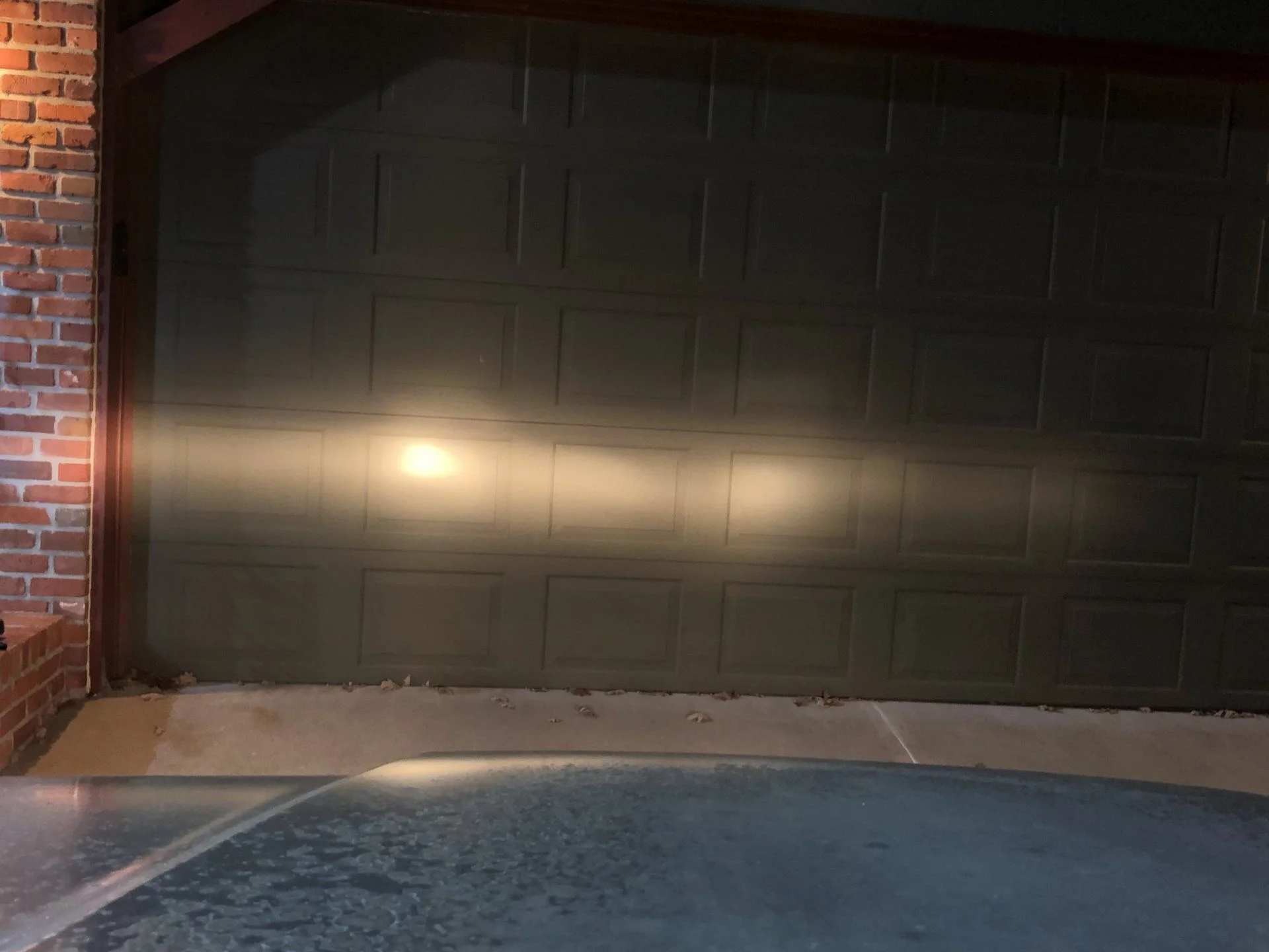

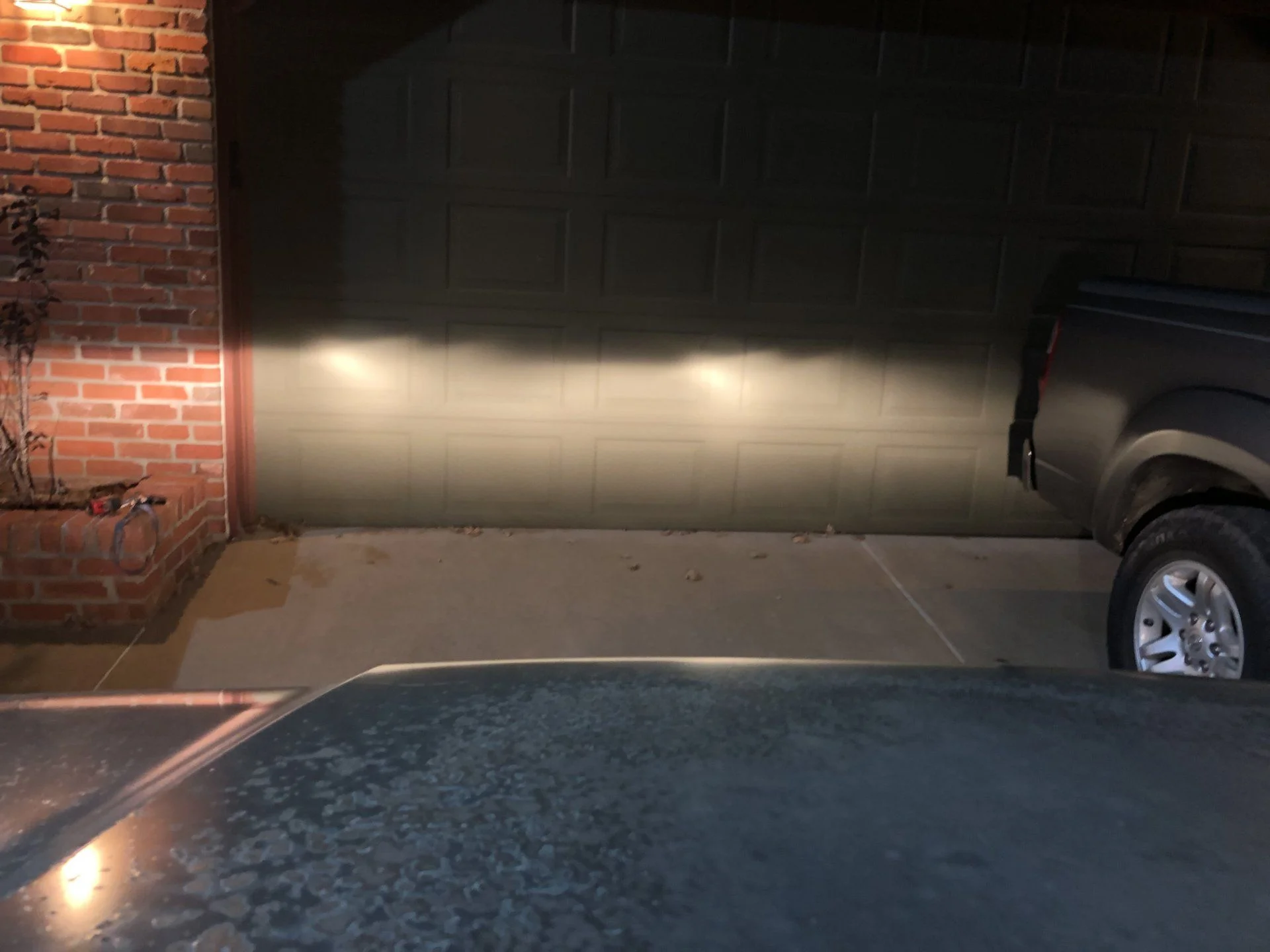

From 12’ away, the original lights were dim on the garage door and this thing was sketch to drive at night to say the least.

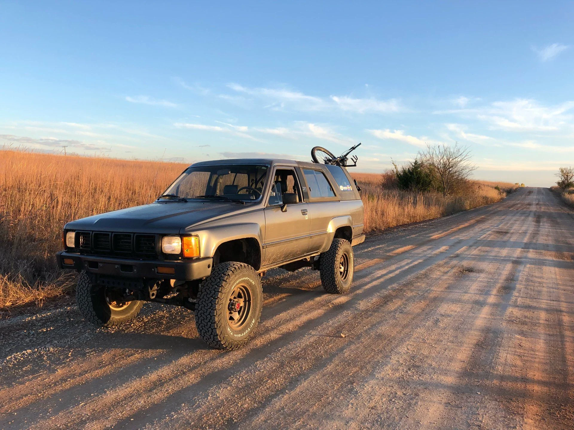

Here it is from the same distance with some nice Hella’s. Output is night and day different. The low beams are more light the old high beams, and these actually throw light into the ditches as well.
All in all, for less than $60 *which is less than what I’ve seen the oem emblems for the grille going for* and a couple hours of work, I’d say it was money and time well spent, but due to my mangled front bumper and quick need to use the stock headlight buckets I am not completely satisfied with the overall install. As time goes on, I’m sure I’ll revisit the mounting positions and maybe even design and print some ABS surrounds that make the front end flow from corner light to grille.

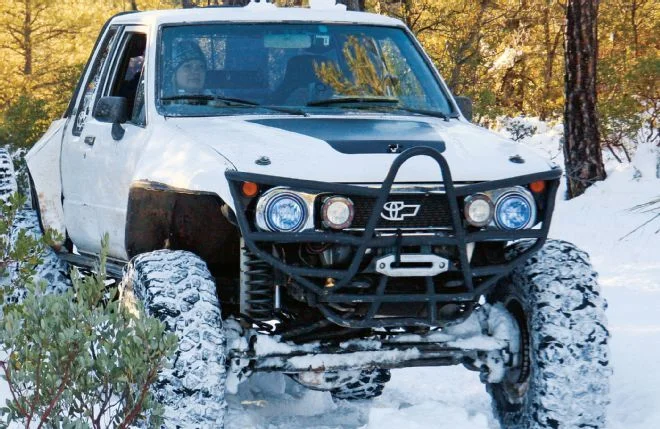

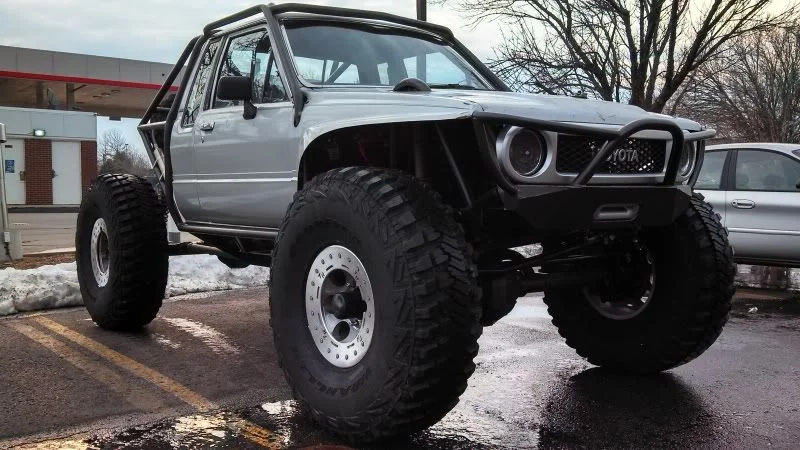

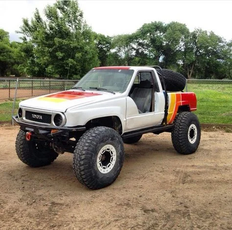

I've seen a few people use an FJ Cruiser grill on pickups/4Runners, but the older grill is a unique option as well.
Interesting. I have never seen that. Not quite sure how I feel about it.

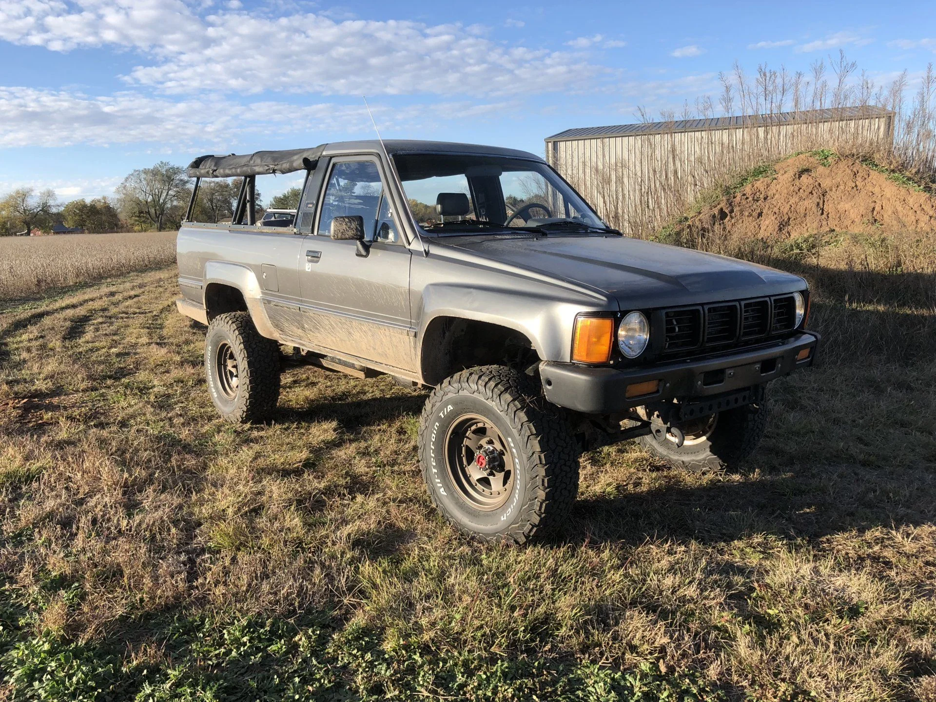

I put my $50 soft top on yesterday. Turns out it is a canback. Wish the P.O. hadn’t leak sealed and spray painted it but $50 is $50.
It's hard to tell from that picture, but I'd expect it was doved at least somewhat.
Here are a couple more - less "finished" than the first one. I thought I had a picture saved of another one that was "finished" rather than just slapped on, but I cannot find it.
