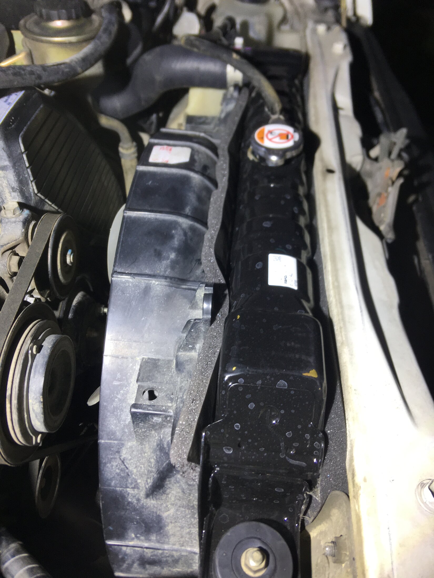

does anyone know the fan shroud that fits the 16400-17080? i have a 1hz 1997 RHD HZJ77? thanks the old shroud doesnt bolt up to it and right now its zipped tues in place.
Look up your radiator PN and/or VIN on Megazip, toyodiy or similar an see what shroud matches up... I found this to be compatible with your radiator, but not 100% sure it's what you need: 16711-17020
What it looks like
What it looks like
This is correct, or rather, the 16711-17020 to 16711-17090 substitution.
I have a 1992 HZJ77 with a manual transmission 16400-17080 radiator in it. I am running the 16711-17090 shroud, and it bolts up perfectly.
Thanks everyone for the help! that shroud does look like it will fit. now i can get rid of the zip ties.
