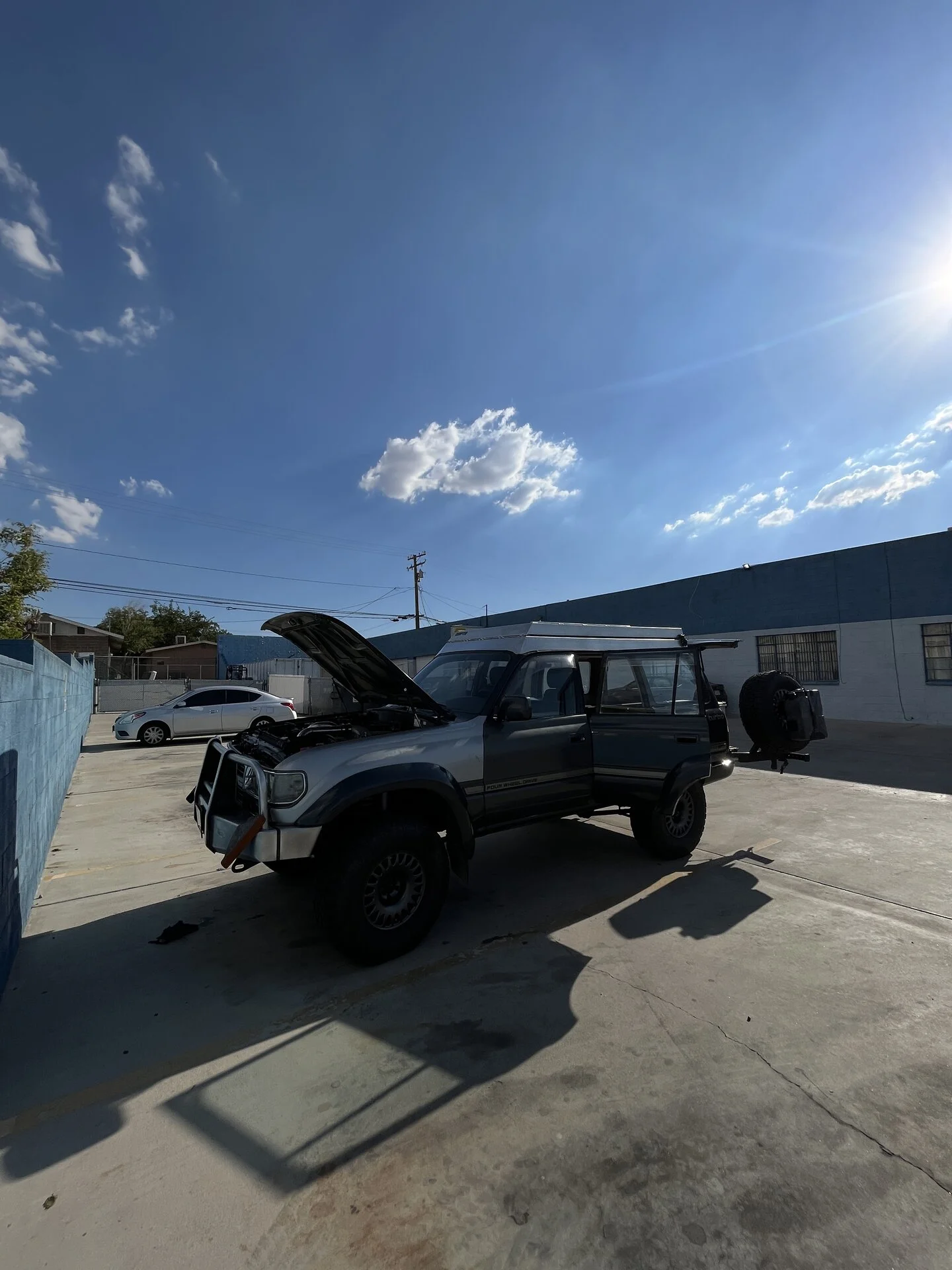

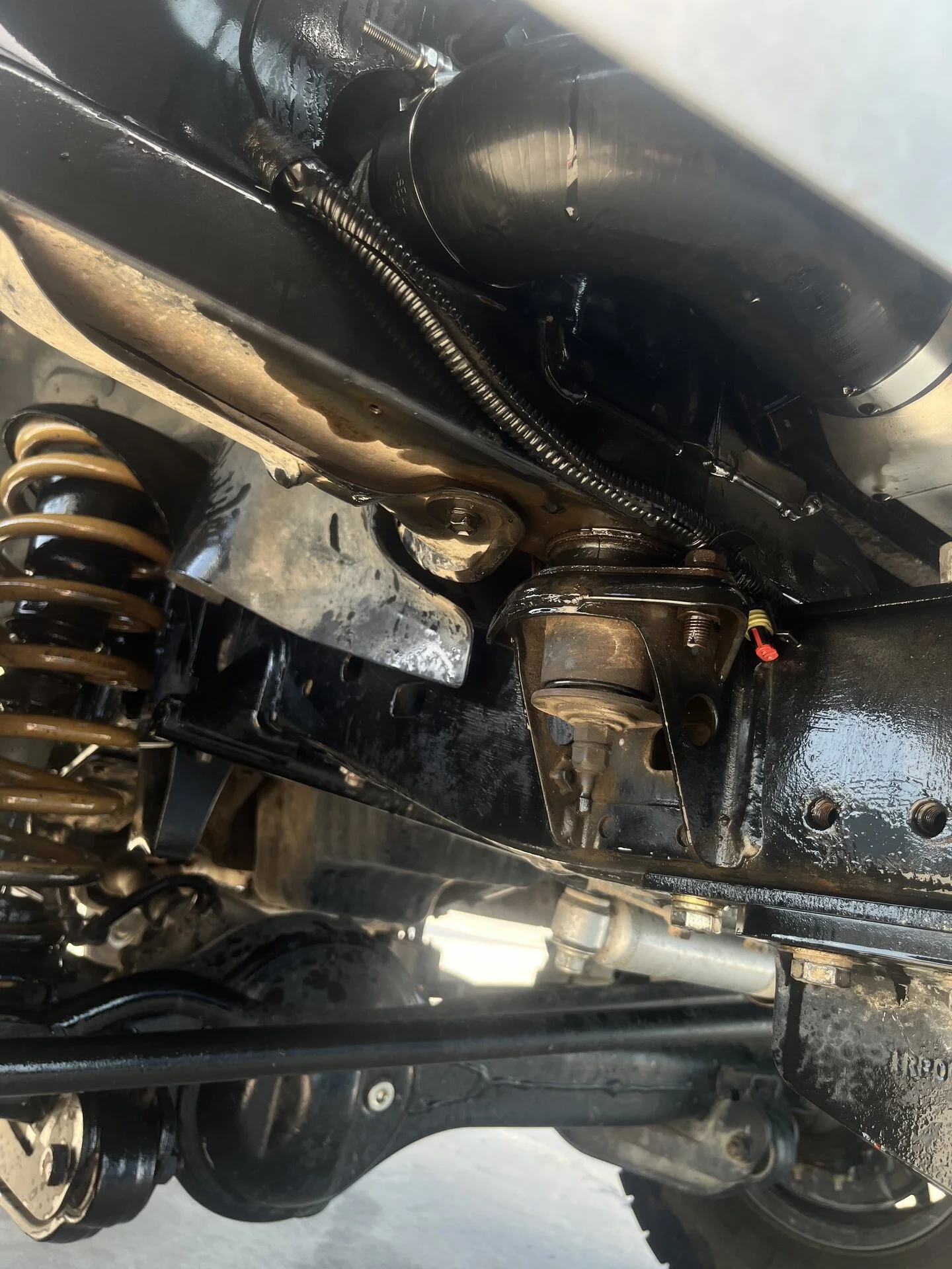

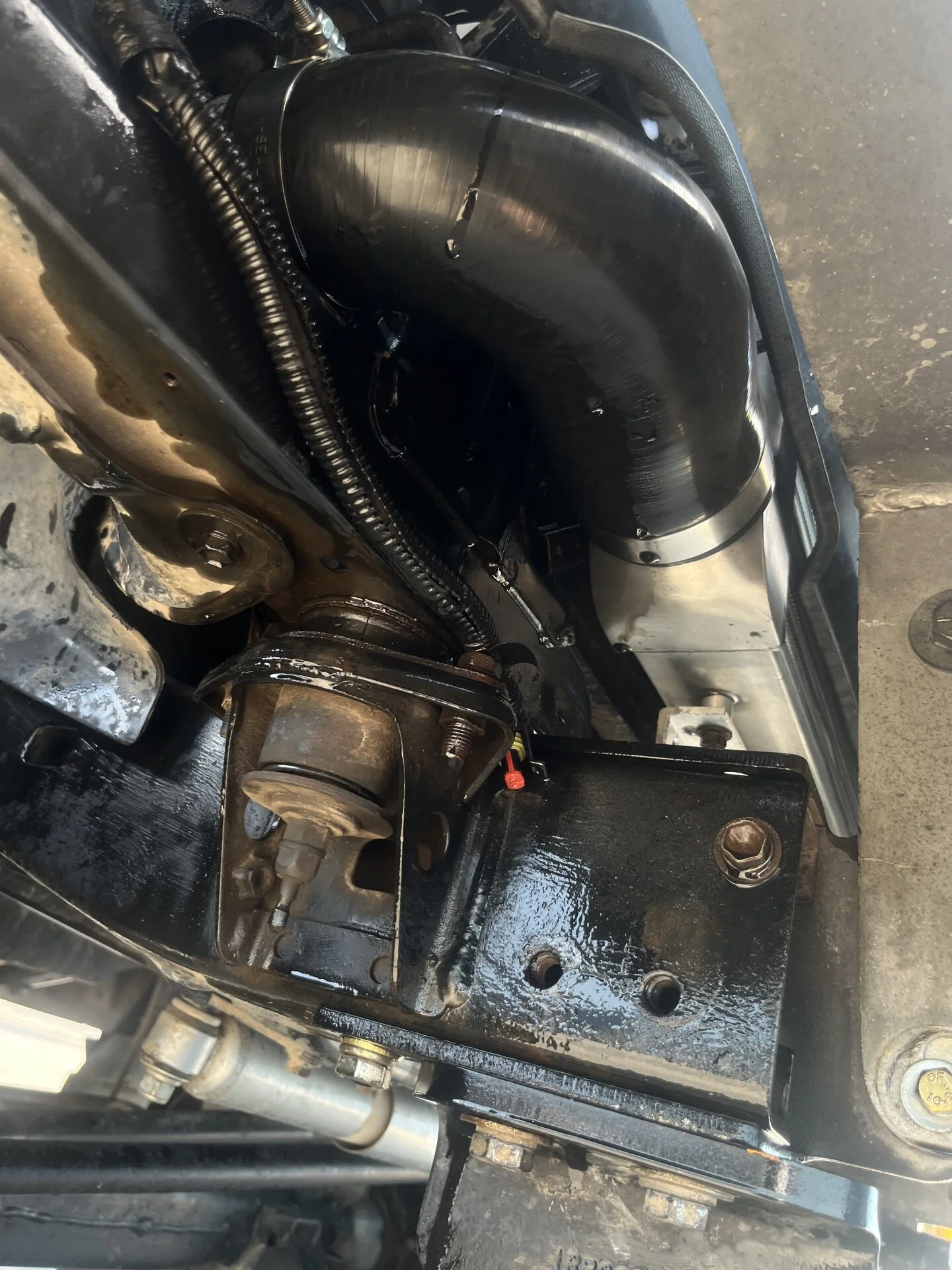

I recently built and installed a front mount air-to-air intercooler in the hopes of lowering my EGTs on long hauls and mountain passes. After the install, everything worked as it should for 200 miles or so, until the silicon coupler slipped on the highway. I (limped) drove on the highway for about 20 more minutes until I could get to a flat NAPA parking lot. When I got out of the car, I found excessive oil everywhere! OH NO! Blown turbo? maybe worse?
The odd thing was the Intercooler pipe had spewed out black and used oil... I had changed my oil to just before this 200 mile trip, so if this was oil straight from the motor, it should still be relatively golden still. I checked my Provent 200 catch can and it was FULL FULL... more full than I would ever let it get. I feel like the intercooler being installed made the catch can fill up faster than normal possibly? Is this possible? I should note there is zero blowby.

Which hose slipped off? Was it the intercooler inlet hose where it passes through the firewall, above where all the oil leaked out?
