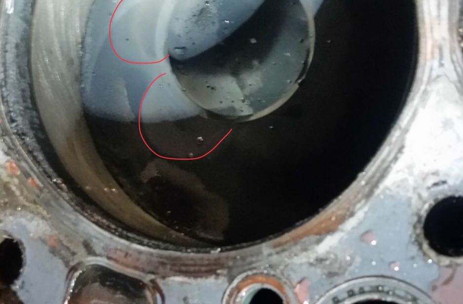

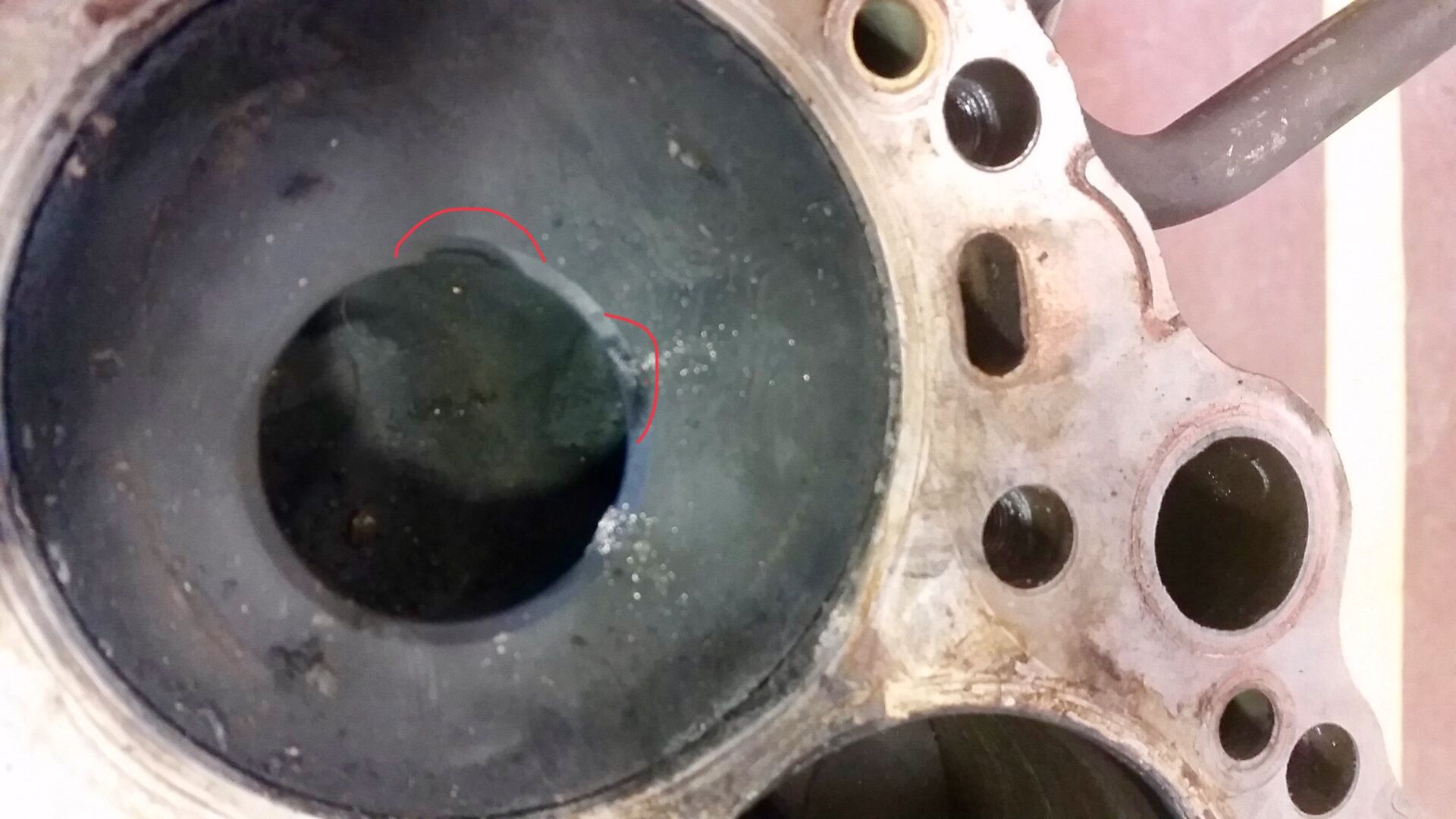

I noticed that with stock 1HDT injection timing the spray pattern on the piston top is almost all in the bowl with only a very small wash pattern on piston top.
When you advance the timing the injector cracks earlier in the piston stroke before TDC and sprays fuel on the piston top or squish face. I suspect some of this fuel on the crown doesnt burn because of quenching with the cooler head and piston. Or it burns at the wrong time producing soot and wasted fuel.
Is Riverena making the bowl opening larger to allow for advanced pump timing so all the fuel sprays in the bowel?????
The first pic is stock timing the second poor pic is advanced timing. Notice the spray pattern on the advanced pic. It is way outside of the bowl washing carbon off.
Stock the pattern is capured in the bowl.
Now that is a very interesting observation. The spray pattern from memory is suppose to be partially split on the bowl edge itself but not equally split. If they have had good results it would support what your saying. This is pretty cool stuff I must say. Timing the split of the injection spray on the edge of the bowl is doable but you'd have to measure particulate, egt and nox to determine a positive change. Cool thing is once you do the machining it's all just timing adjustments after that .you could do a dyno each time but dyno results can vary wildly between each run.
