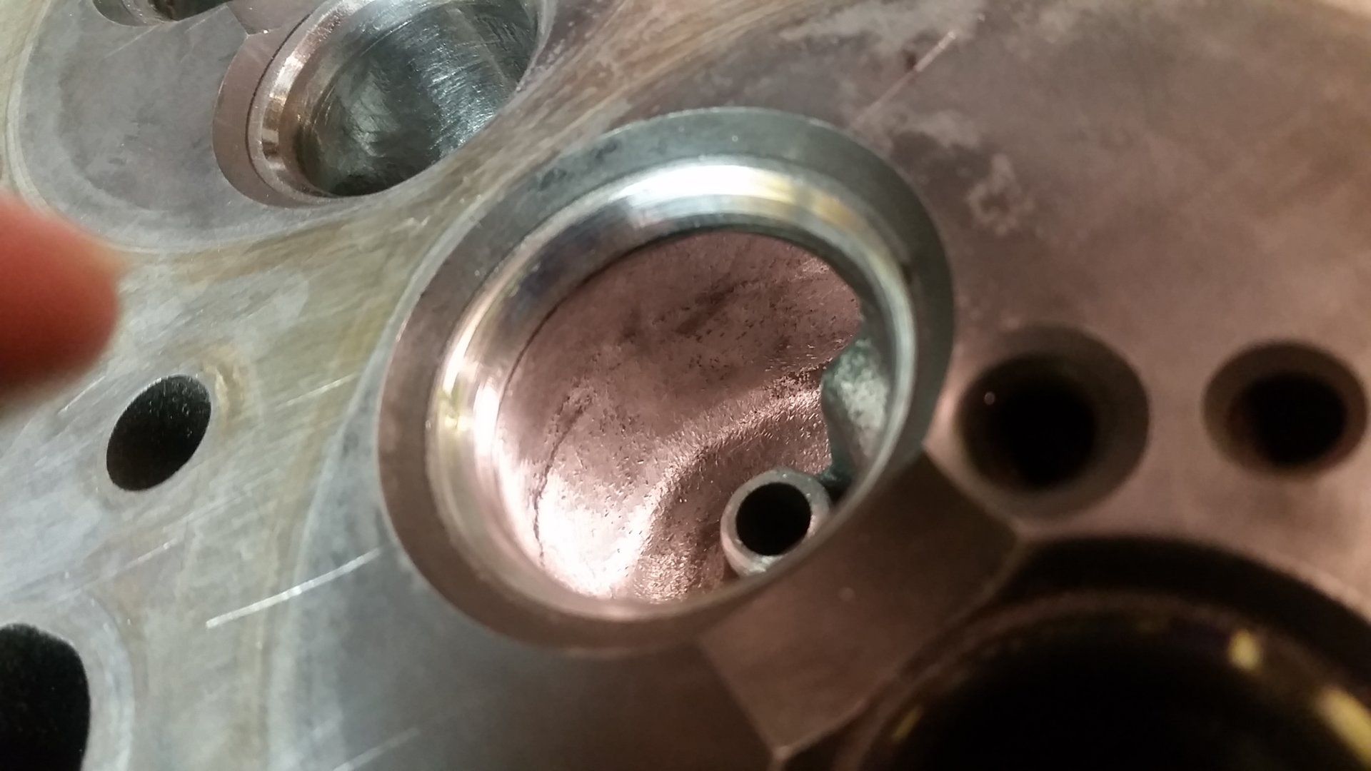

I tryed blending the rough die grinder finish with a flap wheel . Contour is much better.
Posted a couple of early pics of port progress.....with any luck more power too.

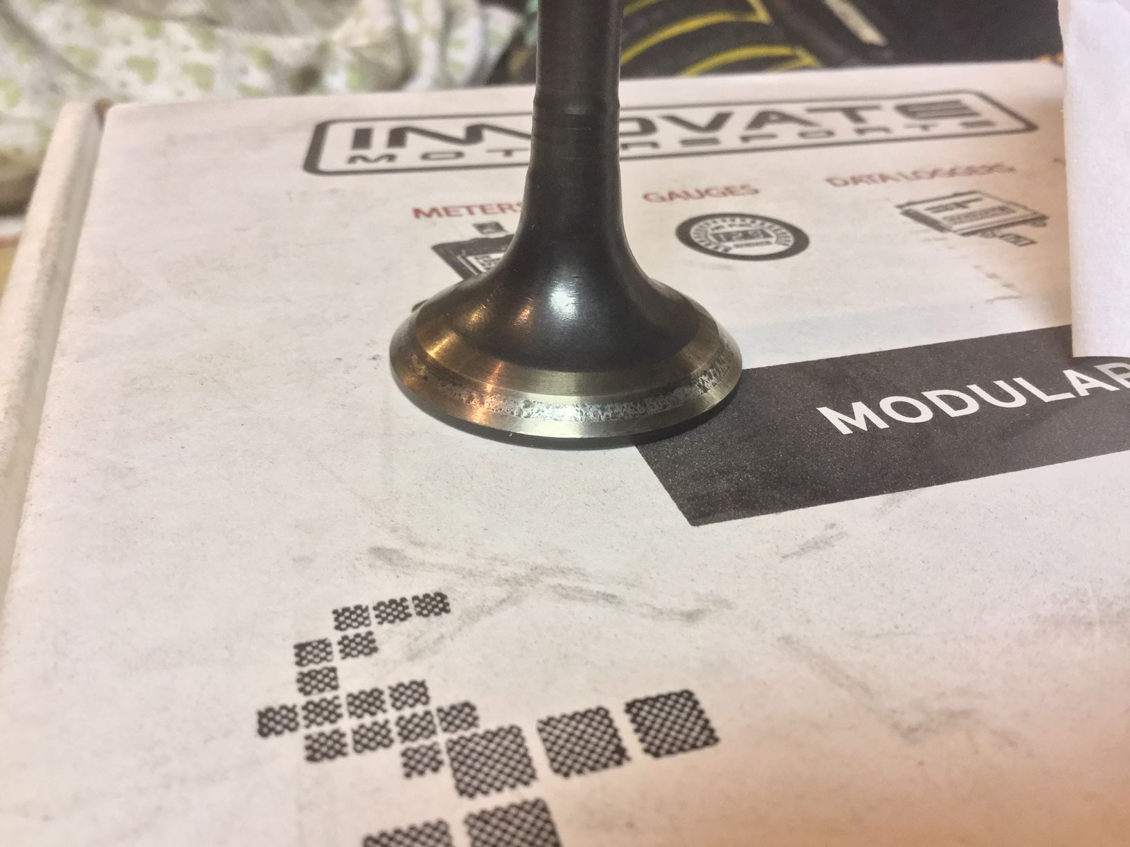

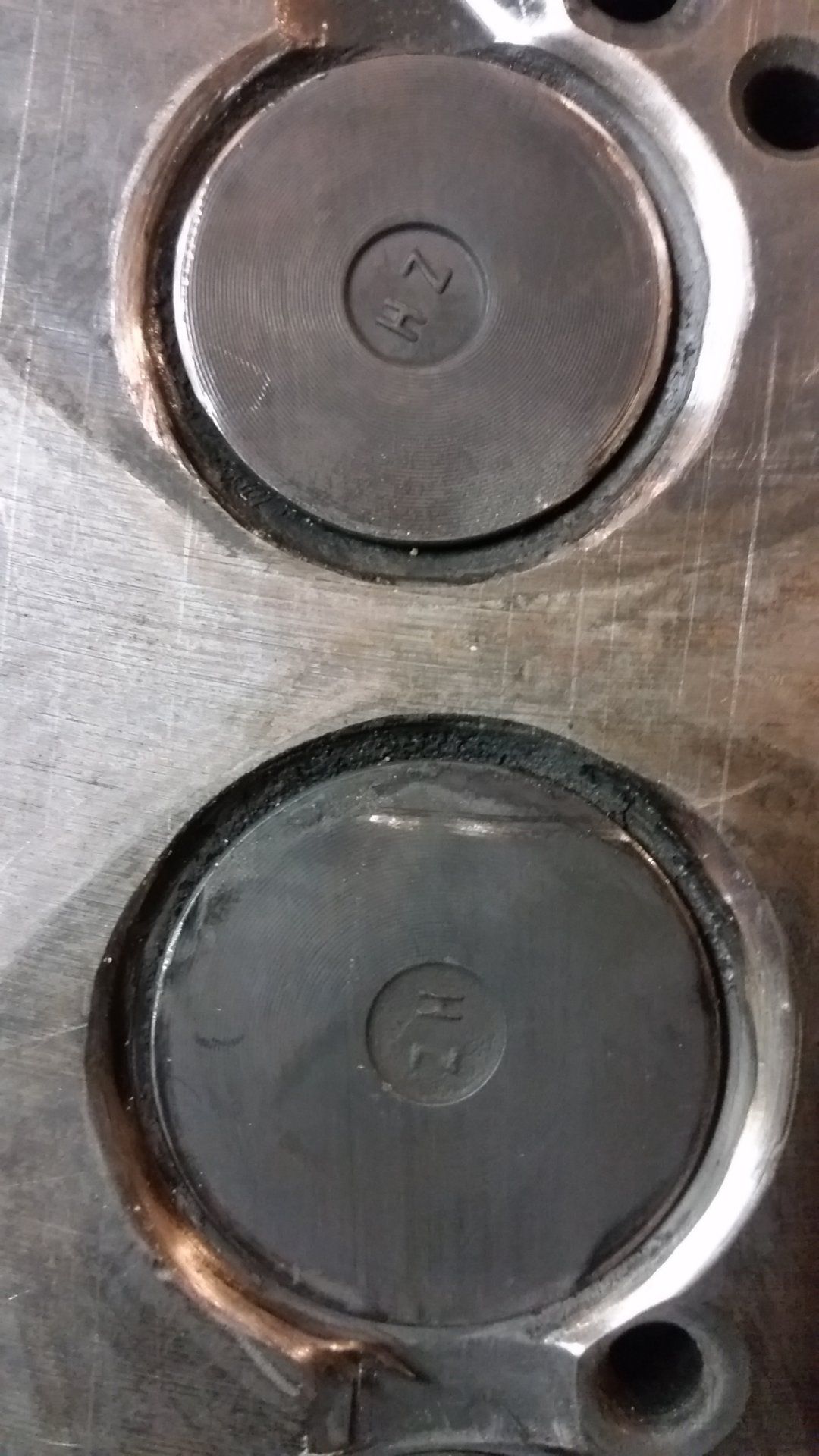

Before bolting on the cylinder head I decided to make sure my head is still straight. Cylinder head that is, we all know that my head is warped. Turns out that my head is warped again about .003". Within spec but I am not taking any chances. I dissassembled the head expecting valves and seats to be fine with only 15,000km since valve job. Intake valves and seats looked perfect exhaust seat was good but the exhaust valves were extremely pitted. FML.
Not sure of the cause.
Heat has been sited as a possible cause from a couple of different people. I do monitor EGT.s and have never been over 1200F. To much EMP? Bad sender on egt?

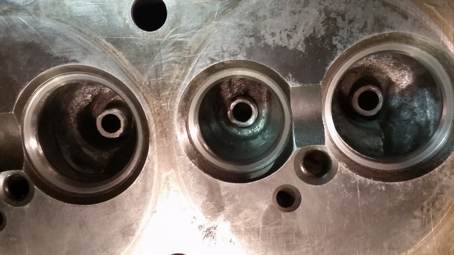

I think possibly the problem is too narrow of a valve seat. Spec is 1.8mm to 2.2mm my seats were about 1.2mm wide.
The valve gets cooled by seat to valve contact when closed. So I recut seats to 2.0mm.
Narrow on left.

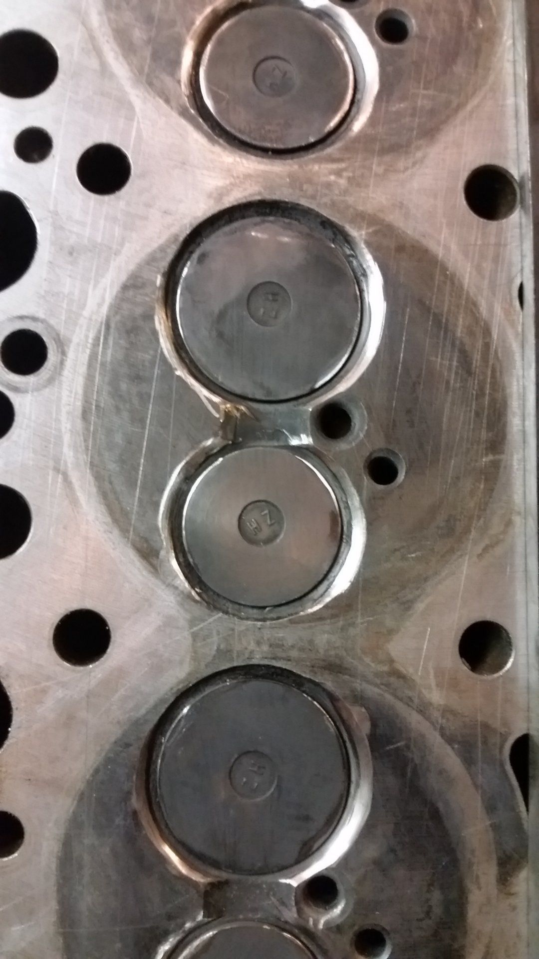

Head is planed again valves done. Diesels Unlimited has some porting notes on there facebook page to improve the 1HDT exhaust port flow which is quite poor.
To port or not to port, that is the question....
Where is the die grinder???
:hmm:

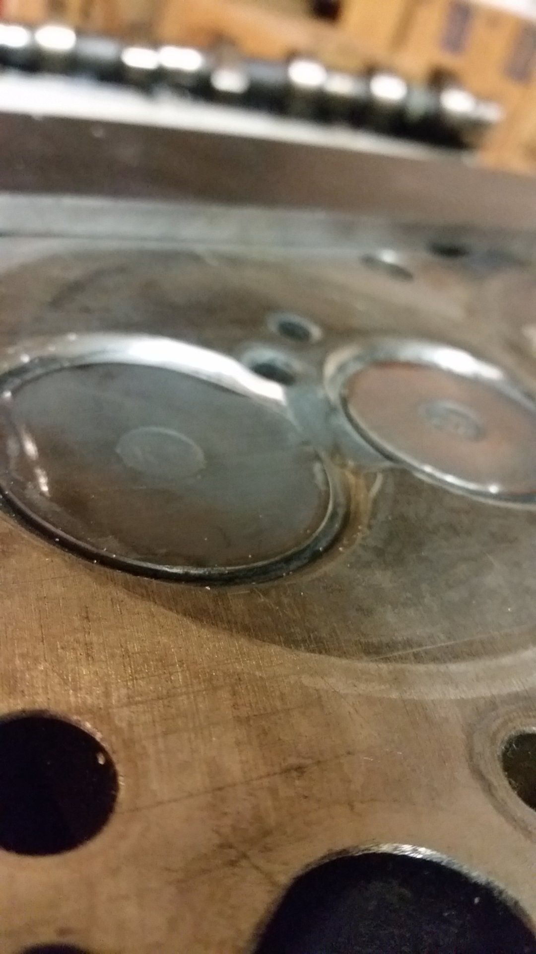

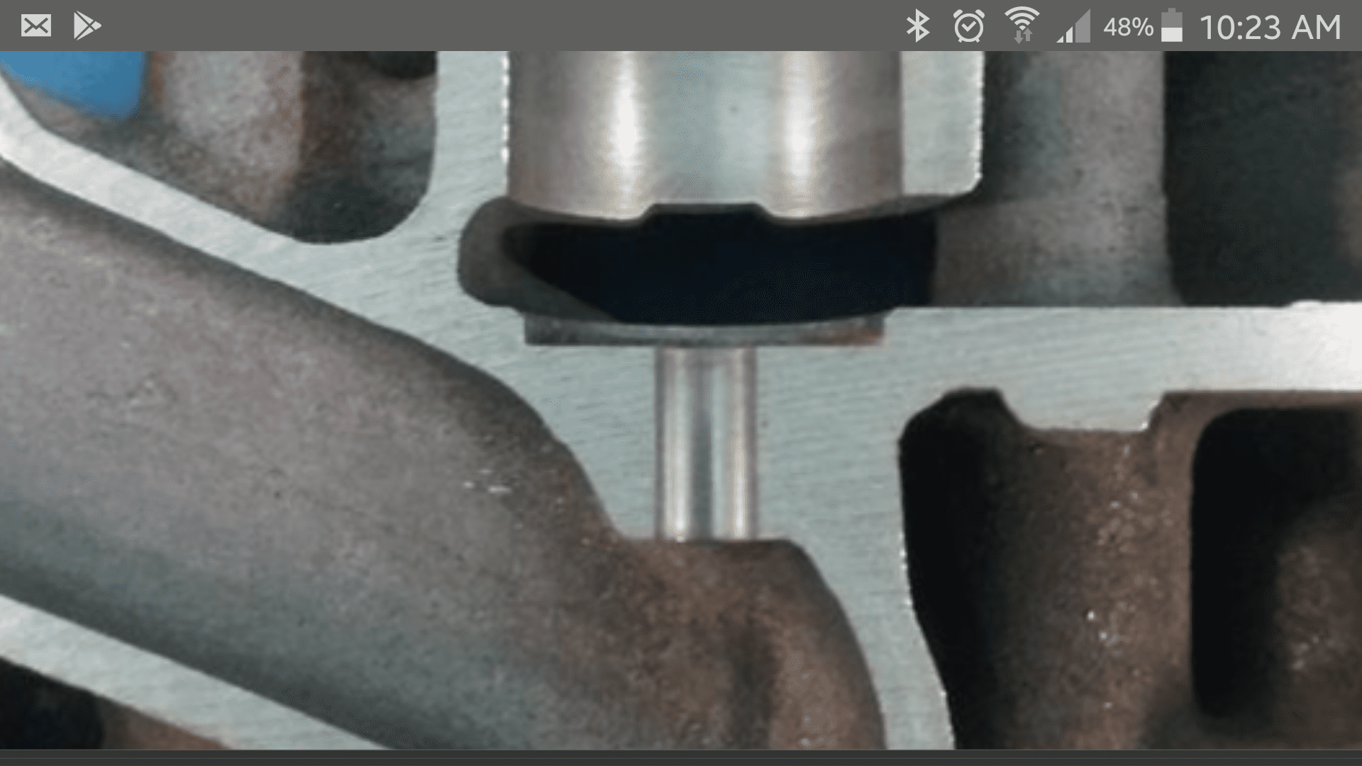

Ported the exhaust port a little bit more as you can see from the pic below there is a significant restriction from the valve guide boss protruding into the top of the port.
The valve guide is sticking out past that about 2
mm.
So I trimmed the guide off and reshaped around guide. Widen around where the valve stem runs thru and tapered it alittle.

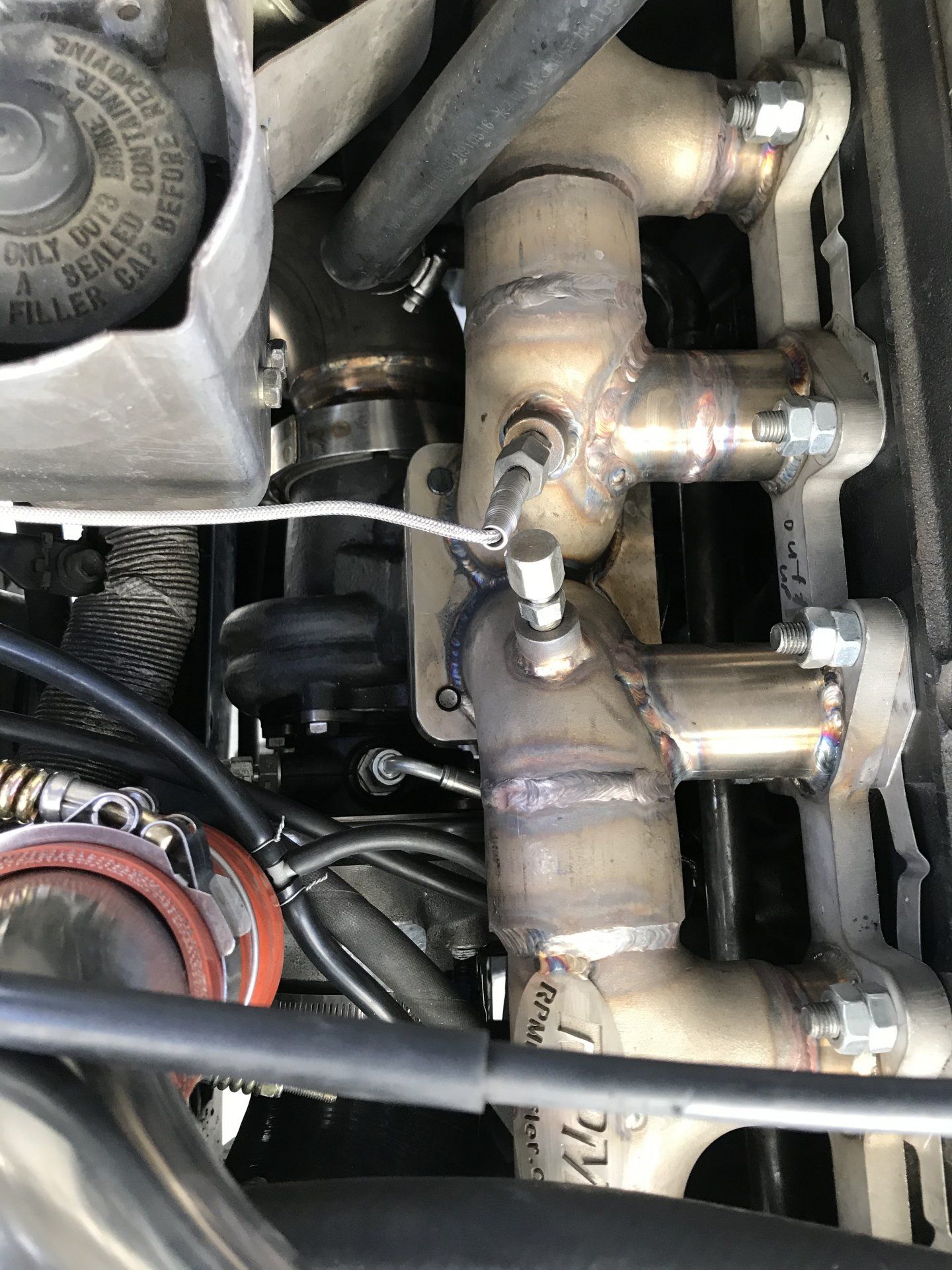

Exhaust manifold has been cleaned up as well. Matched the exhaust ports to the gaskets. Also matched the turbo to the manifold. One place that was particularly restricted was the rear portion of the exhaust manifold where it joins to the front part.
I often put thegasket in place and then spray paint the opening to show where material needs to be removed.
Turbo has a big step where it meets the manifold.
Die grinder takes care of that.
Matching manifold to turbo and trying to improve the flow out of the manifold by trying to increase the short side radius at the dump into the turbo.

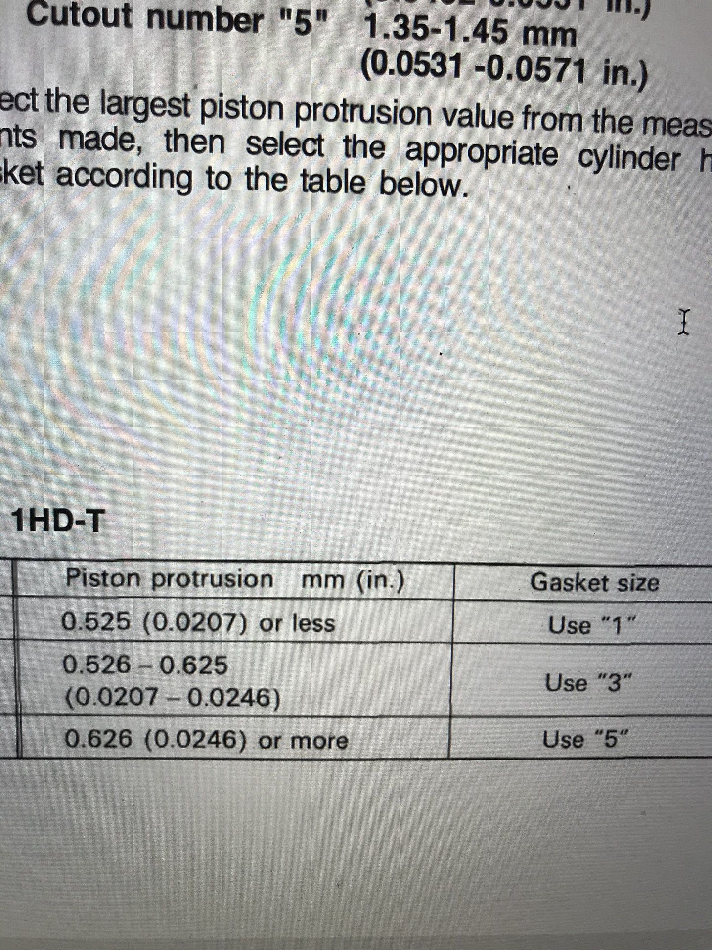

I wanted to ask this hear as a lot of bright minds in this thread involving head work. When I originally got my new short block 1hdt from Toyota in Japan the guy measured my protrusion and his findings were .40mm and .50mm and selected the 5 notch gasket. As per the FSM for a 1hdt .525 or less is a notch 1. Notch 5 seems to be way overkill.
I bring this up because I am soon to be removing the head and installing head studs. Not because I am having issues but because I plan to be running around 27psi and just want peace of mind. Knowing the importance of squish I reckon if when I measure protrusion and find the same number should I run the notch 1 or 3 as it seems even 3 may be overkill. But I also can't pretend I know exactly what goes on in an engine over time or the danger of running it too close to the cutoff as per the FSM other than the piston contactin the valves which is obviously bad.
Any feedback is appreciated.
Your measurements of protrusion is .4 and .5 mm correct? According to the pic of the FSM that would indicate a "1 notch" gasket.
That is the correct gasket. Putting the 5 notch gasket in place " to be safe" is a waste.
It results in.....slower squish velocites, poor fuel air bowl mixing, smoke and reduced off boost power. Follow the manual. Toyota knows better than most of us.
I am running less squish clearance than the FSM with no problems. I also run premium fuel.
