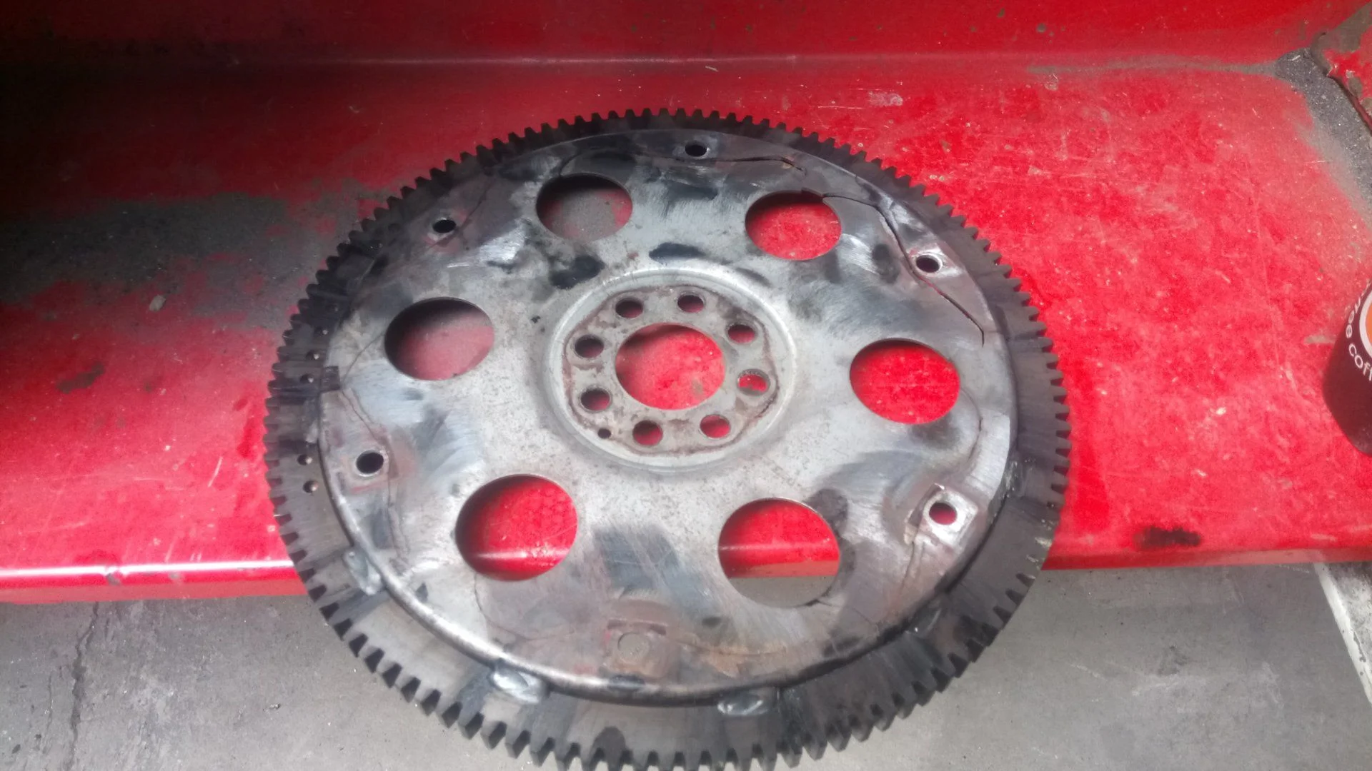

I got this once. Loud ticking noise on idle, sounds almost like big ends but non rhitmyc
full
And it was a cracked flexplate? There’s no inspection hole on an auto, is there?
