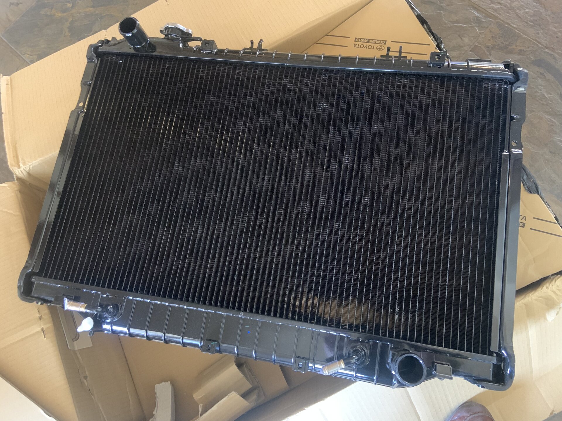

  • The diesel radiator and fan shroud are diesel specific as the water pump is in a slightly different location from the gas version. Some people have been able to rig solutions to keep the petrol radiator by fabbing brackets to adapt the diesel radiator. I opted to buy the correct diesel radiator and shroud so everything was bolt in.

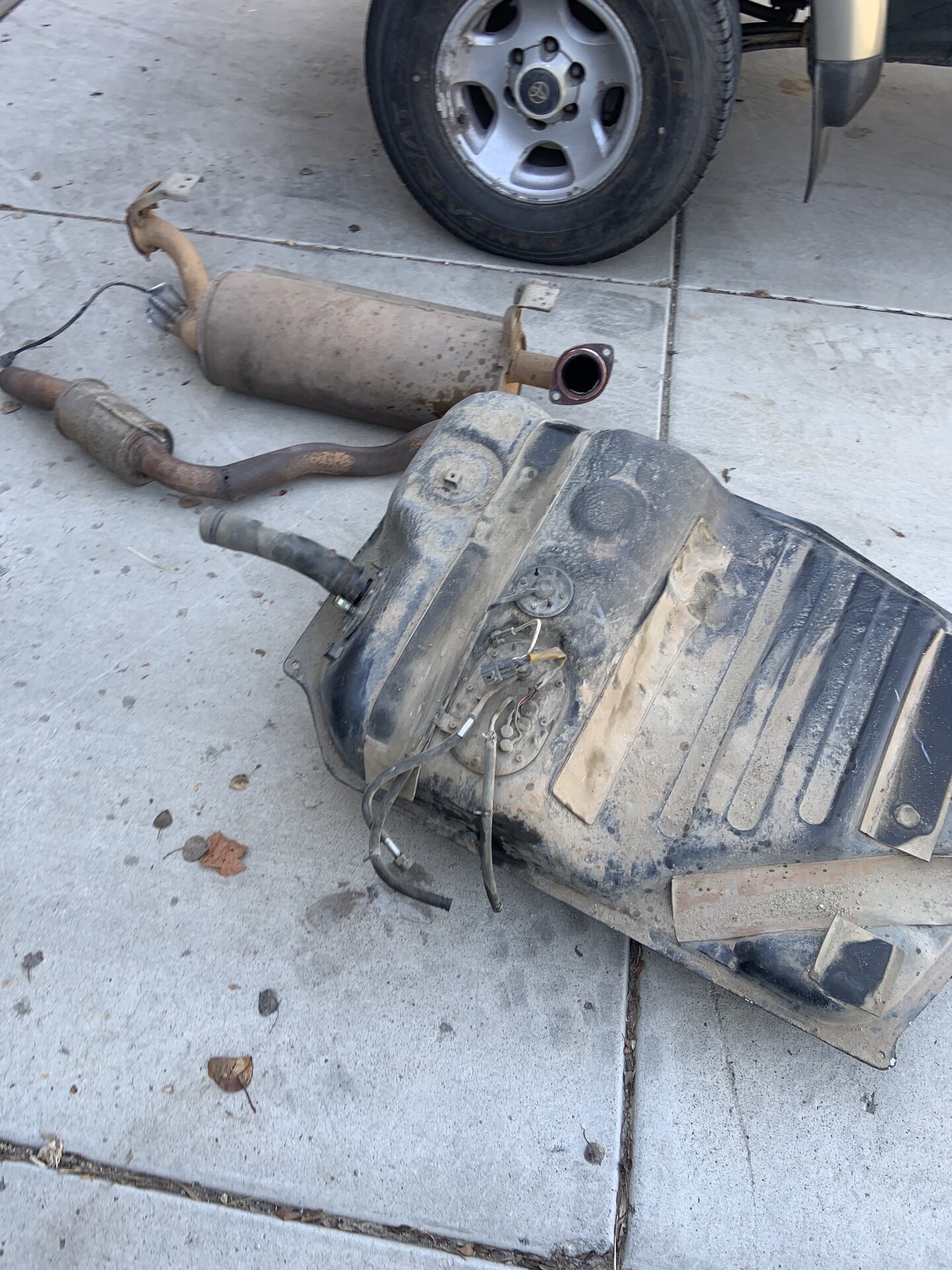

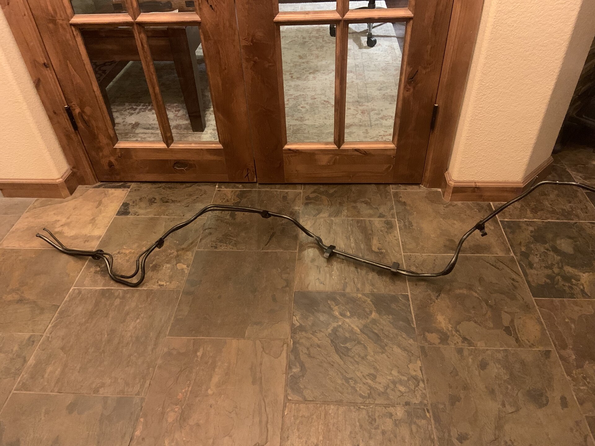

  • For the fuel system, all that was required was dropping the fuel tank and removing the filler neck (which required cutting into two pieces). The restrictor was cut out of the fuel neck and I swapped the EFI petrol fuel pump assembly with a diesel specific pickup I found on the classifieds. I made up my own hard lines using the original as a template.

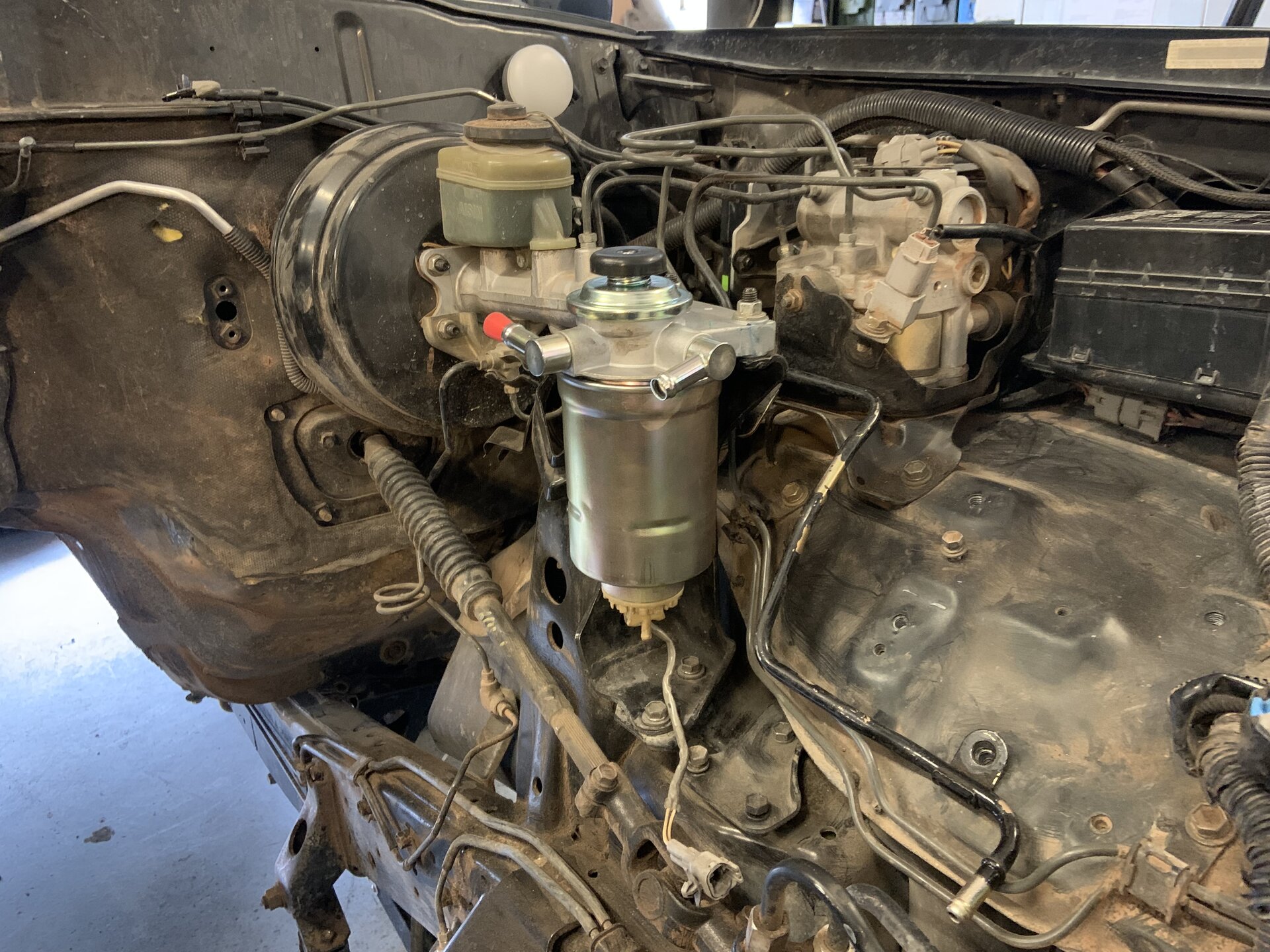

  • I bought a HDJ80 vacuum canister, fuel filter bracket, and a couple other HDJ80-specific parts to make everything easier.

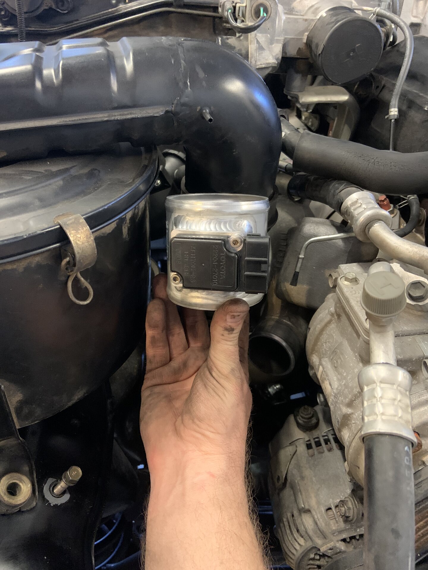

  • The late-model FTEs actually came with a MAF in the air cleaner lid. Since I planned to use a HDJ80 air cleaner lid, I needed to come up with a solution. Luckily the Denso MAF used on this engine is the same form factor used in Chevy Duramax engines so I was able to find a weld-on bung to a 3" pipe union (just be sure you don't put it in upside down).
