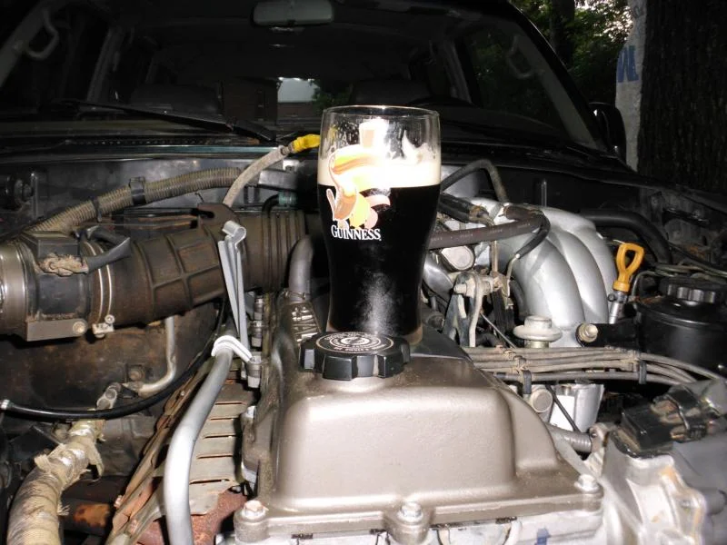

Here are some pics from today.
pulled the wiring harness into the glove box and snapped everything up and tight. Also drained the fuel and i'm glad i did. It looked brown and nasty.

Here's the deal... Went out this morning and had a fully charged battery. Double checked fluid levels and cranked it. Started really quick. Let it run and within a few seconds i had good oil pressure. Spent the next 20-30 seconds getting the PS fluid full and trying to get all the air out of the system.
After that, checked the oil pressure and it was still good, but it has a clicking in what sounds like the valves. I turned it off because i was a little worried about the tapping i was hearing. I kind of thought that would go away as it built oil pressure.
