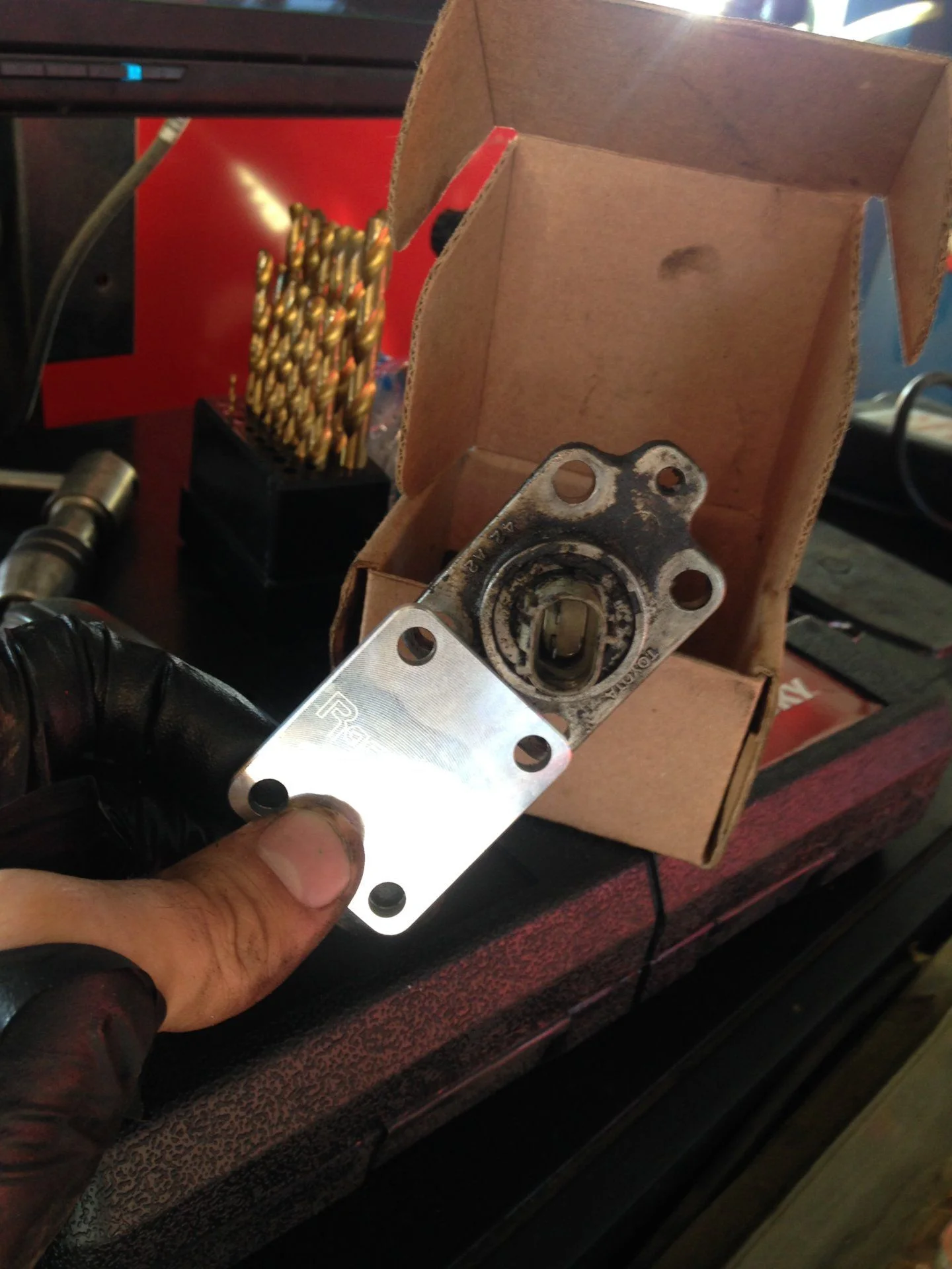

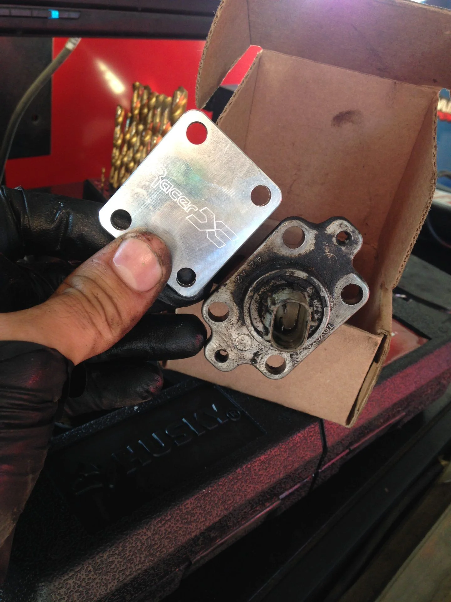

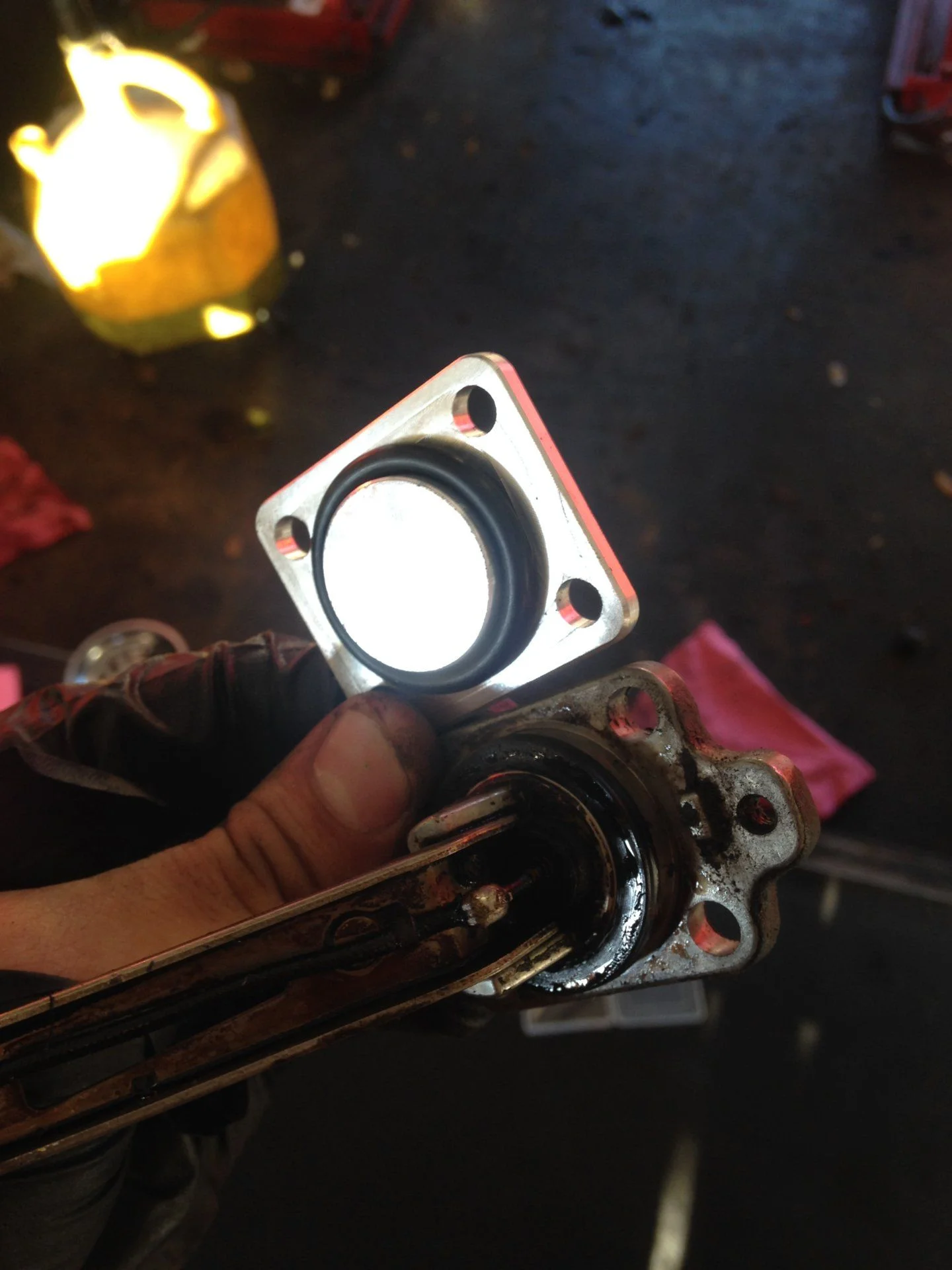

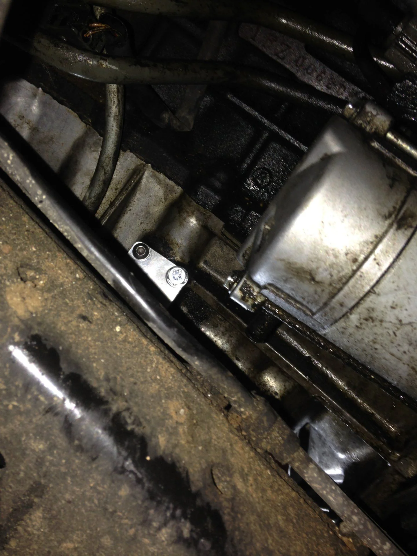

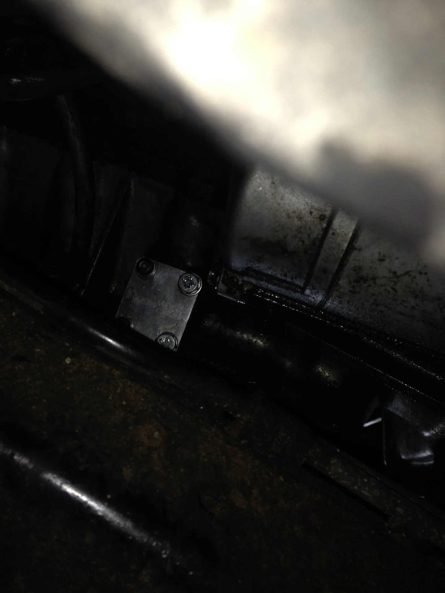

Sorry all about taking so damn long to update this, the 3SGTE block off DOES fit the 1FZFE, been running it for a couple of weeks now with no leaks! Attached are side by side comparison photos of the block off plate and the oem oil level sensor, and some of it after install. I had to tap some of the bolt holes because the threads were stripped. However I couldn't fit a die and tap in there, so I took the next size up (M8 I believe?) and used a dremel to make some notches, essentially a DIY tap. worked beautifully! Also took out the oil level warning buld :cheers:
