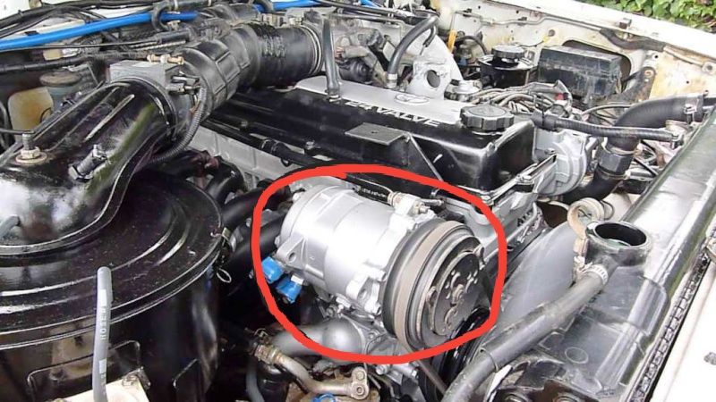

Hi, what is this thing? (Circled) I don't have that on my truck, but there is few empty bolt holes..
No, it's not. Well, it may be made by York, and it is a compressor, but it is not the reciprocating York AC compressor that everyone uses as an air compressor. You wouldn't be able to use the pictured compressor to air up unless you fed it a mist of oil into its intake. The reciprocating York 210, 209 and 206 that are used as air compressors have a separate oil supply in their crank case and are splash lubricated the same way a lawn mower engine is.
Picture of a York 210 as a comparison:
