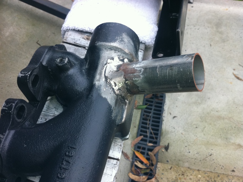

Here's some more pics from my archives...
I used a genuine Safari manifold I found on eBay and welded in a piece of piece of pipe for the external wastegate.
