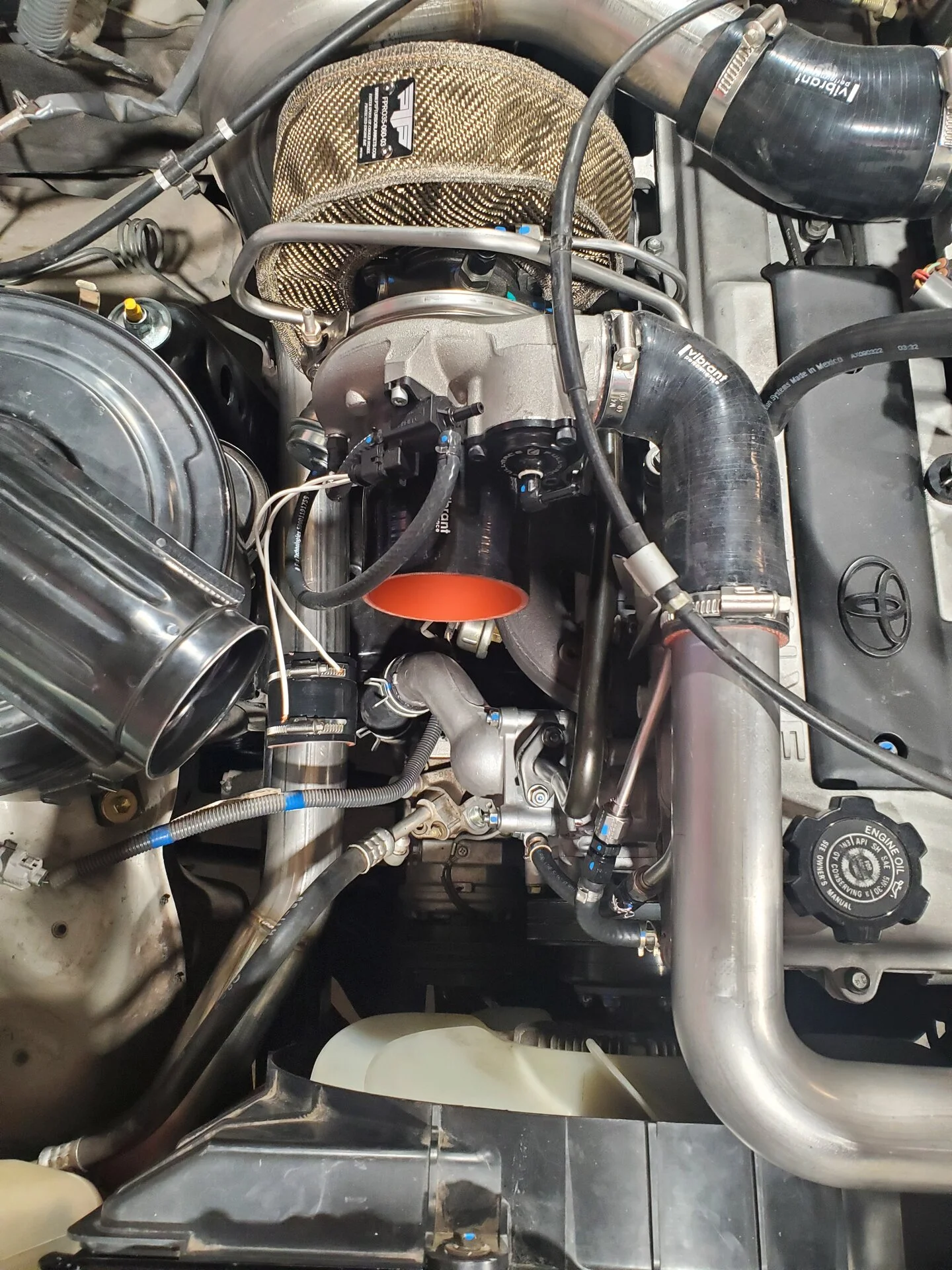

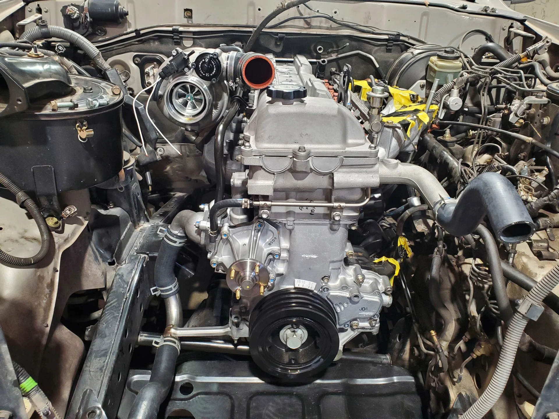

There's a turbo in there. I have proof:
I can see the turbo, but I don't see a transmission. Is it already gone? :rofl:

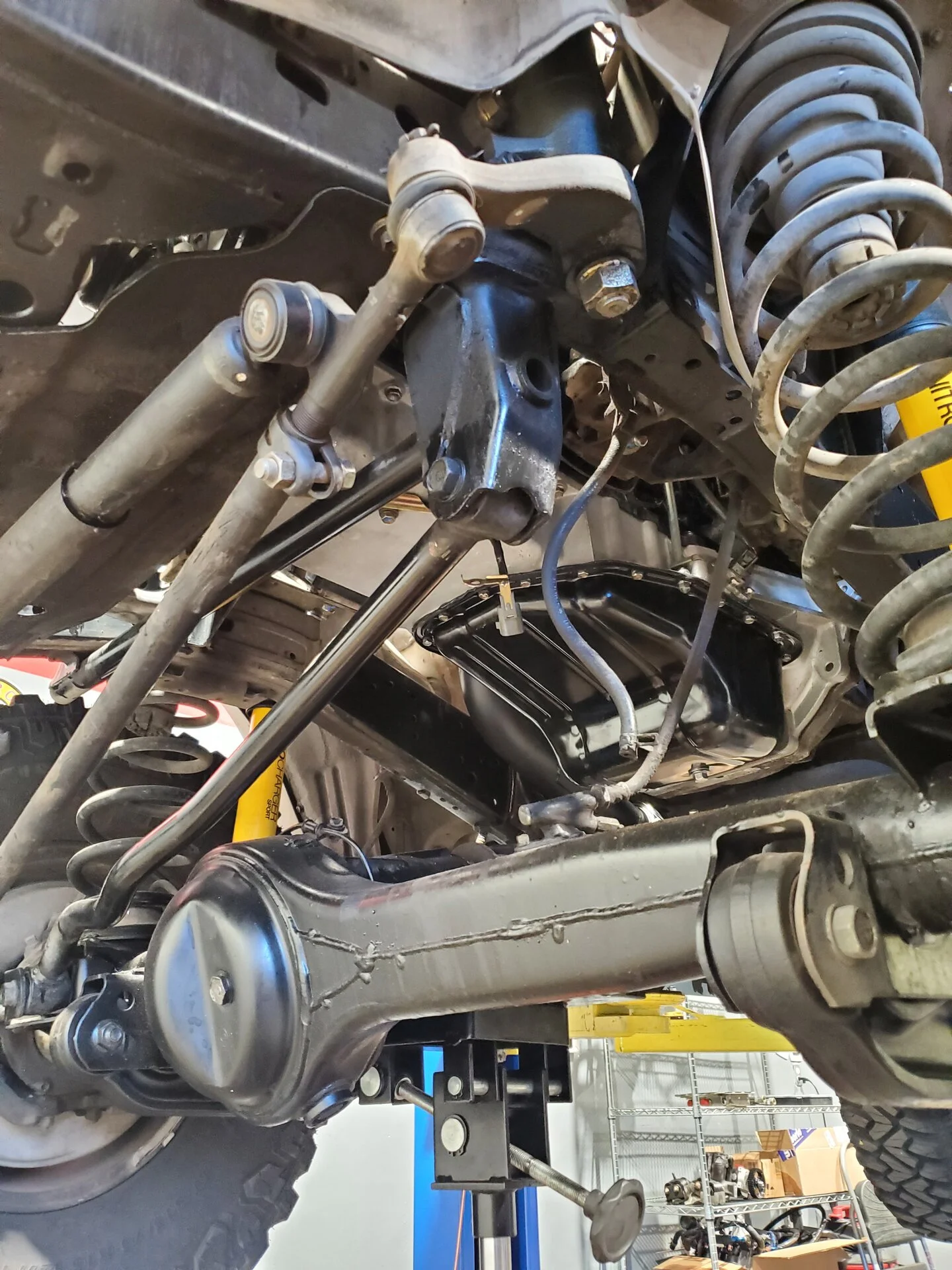

Looks great ! And the brake line doubles as a limiting strap 🤔🤣
If you’re going there, the diff breather his pull off as well 😜

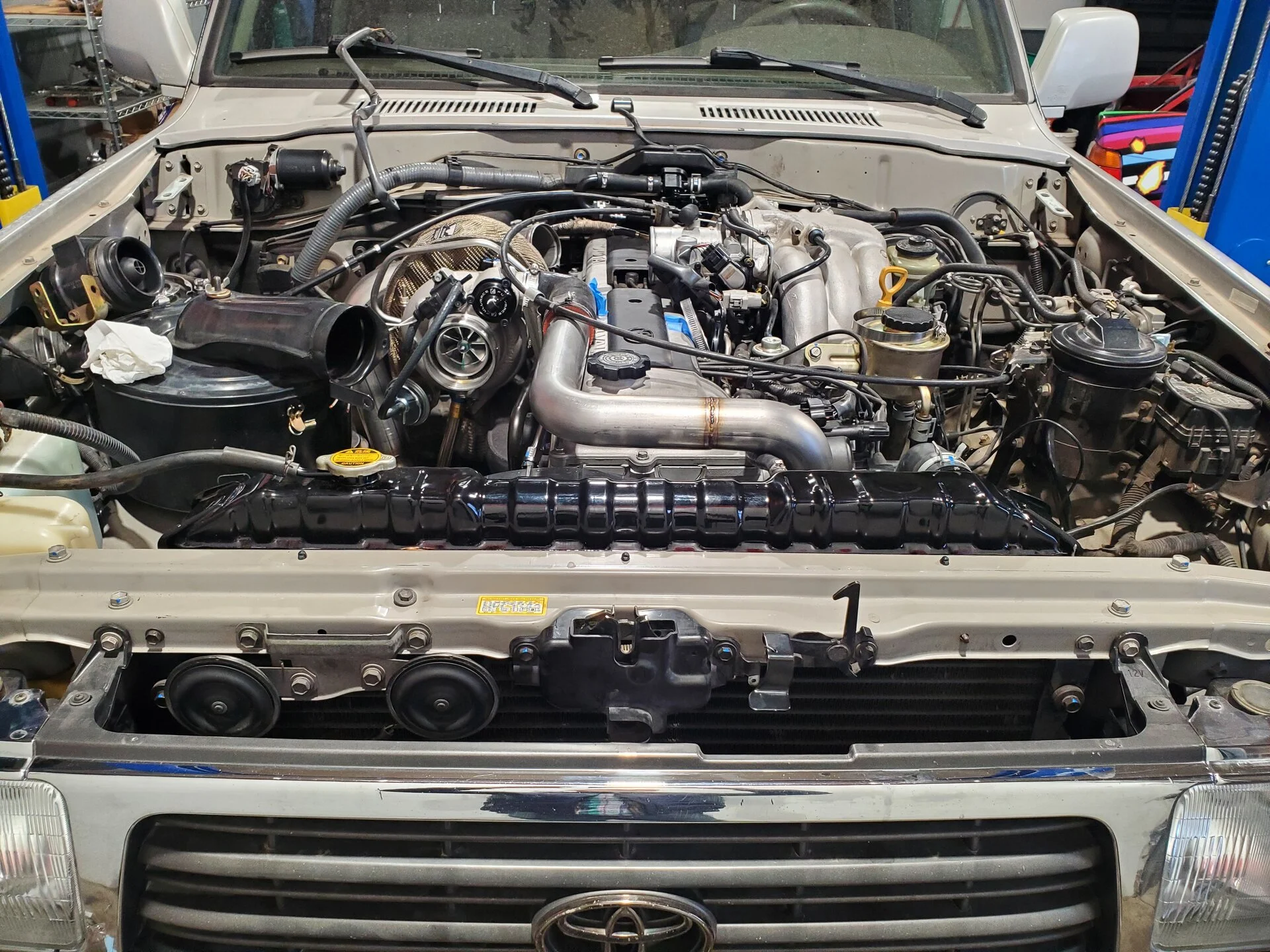

Can you share intercooler location + pipe routing when you’re done?
Obviously excited to following along and live vicariously thru you :) thanks for bringing us along.
Intercooler fits behind grill and low in front of radiator; there's a surprising amount of dead space right in there...
Zoom in on last picture posted above...
You can see the warm side stainless "L" around the valve cover, then drop down the driver's side of the fan shroud; goes forward by frame rail.
Cold side return follows passenger frame rail straight back, then pops up behind/near the turbo. You can see where it's poking out (loose) for flex connection across to the intake manifold.
Downpipe near factory exhaust route, just bigger diameter with Cerakote and a woven stainless flex section.
(All that was rough-fitted and fab'd before engine disassembly.)
