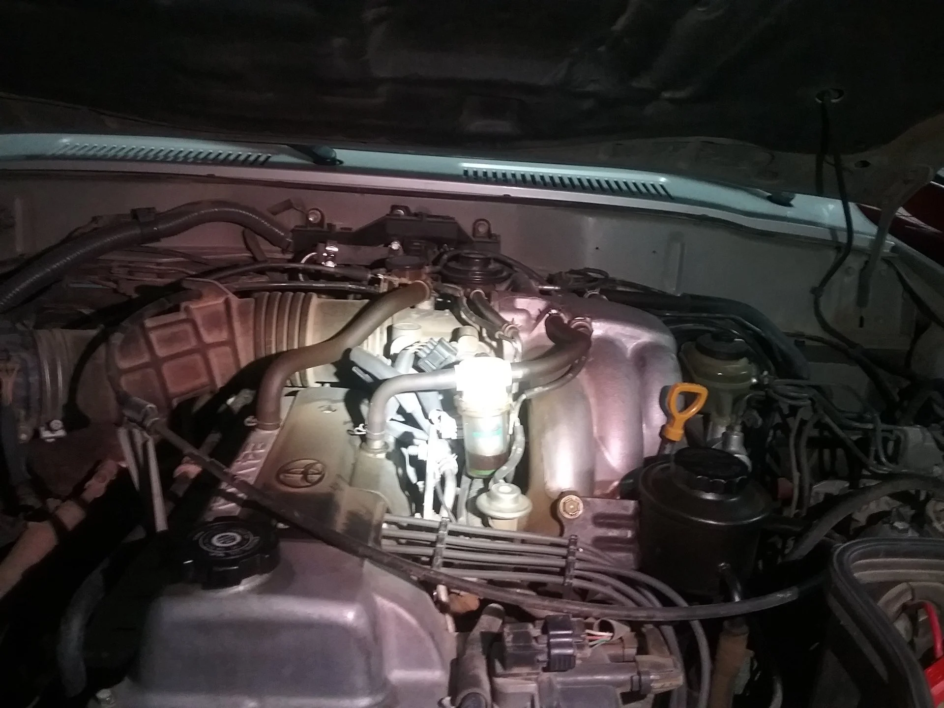

Still running the same separator from 11 years ago. Prevented many miles and years worth of oil getting into the plenum. Not as pretty as the one I have in my tundra but it works the same.

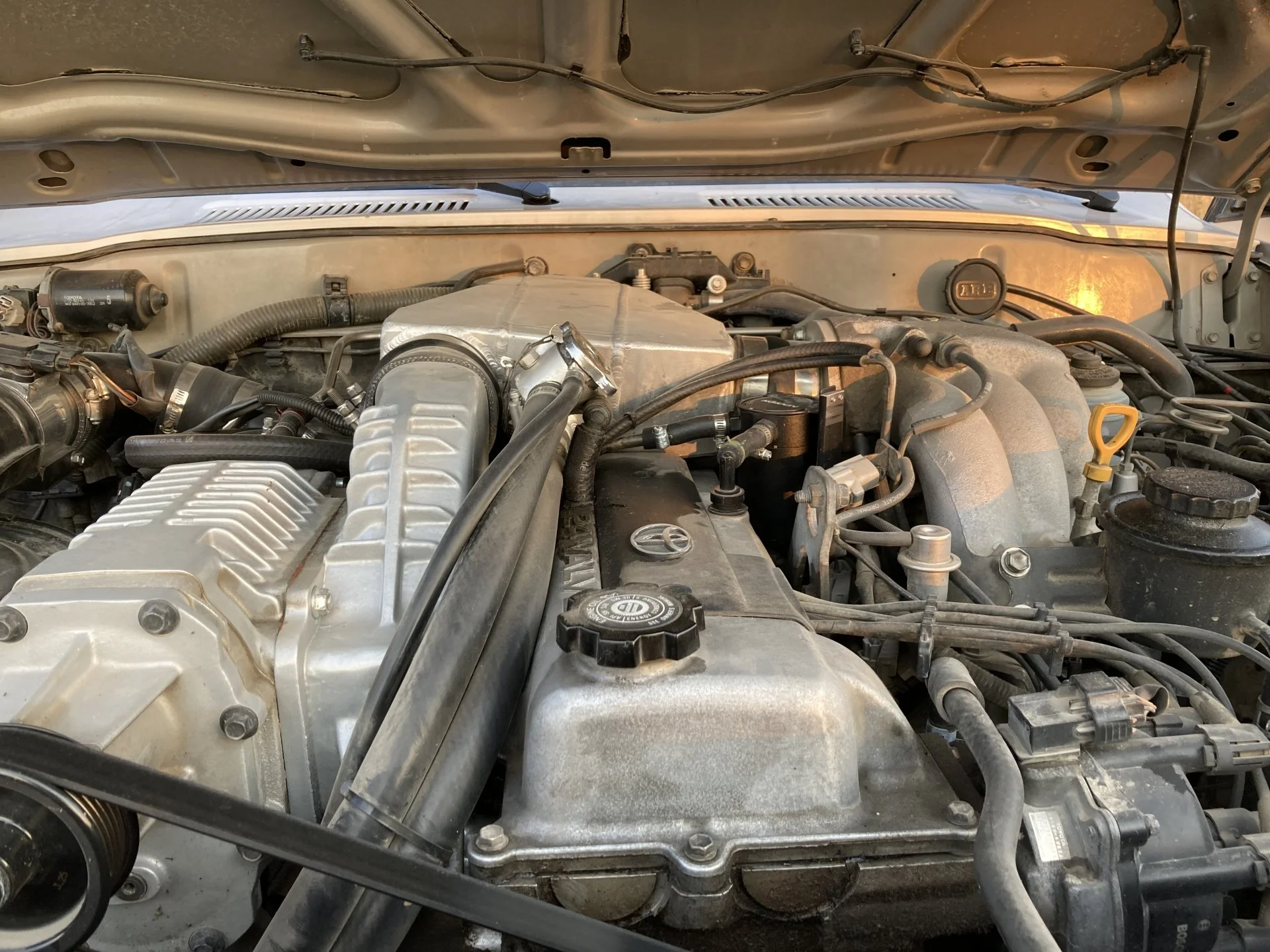

Kinda dirty but I’ve had this KK Moon can in on the PCV side for a year +. Bout half full after 5k miles. Need to make it easier to remove and dump but it’s not often that it needs done either.
Looks clean, do you remember the name of the brand for this can?

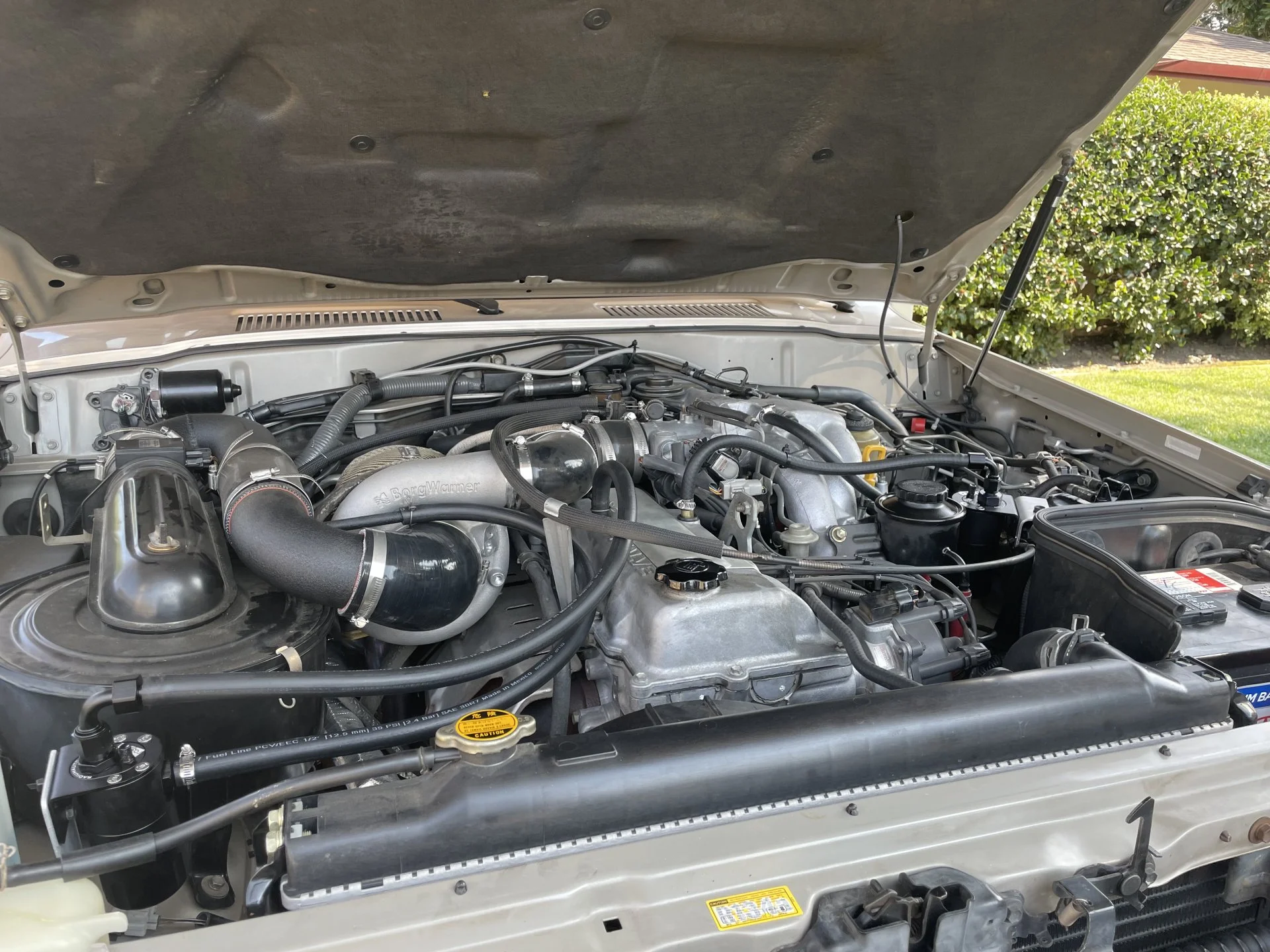

Here's my simple, effective 1FZ-FE solution. This is about how much oil vapor is condensed out of the breather tube over the course of 1 tank of gas, ~300mi of around town and mixed freeway driving, and has been consistent for quite some time now.
I think the part was $20 on Amazon, and about 5 minutes to cut the breather and stick it in-line. You could spend a lot more, but Im frugal that way...
Amazon product ASIN B00CH2JSIY
This is the same can minus the molded hoses. There are similar ones out there for much less though.

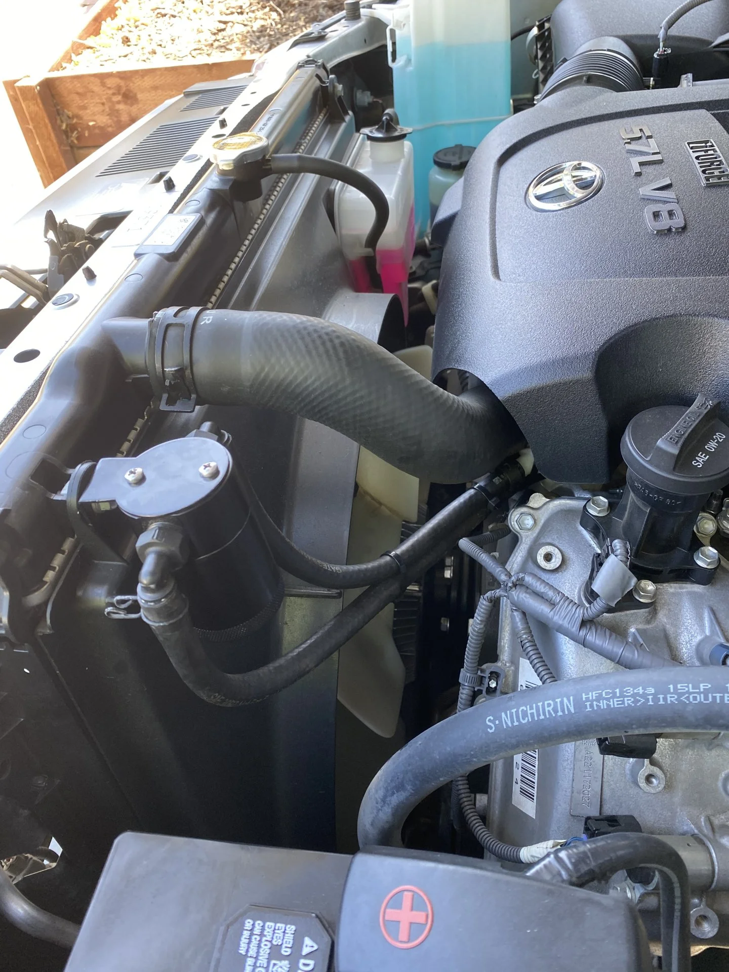

The price is a bit steep when compared to the Amazon specials, but I’m going this route on my truck:
I like the radium cans, but I think I would want the standard catch can instead of the Air/Oil separator - Return. To do it properly, you’d have to drill a hole in your oil pan for the oil to return, and splice into your coolant lines on the throttle body as well. I like the thought, just not the complexity.
I think Air/Oil separator isn’t necessary. I’d rather remove the fuel, oil, junk mixture than let it go back into oil pan to circulate in the motor and turbo.

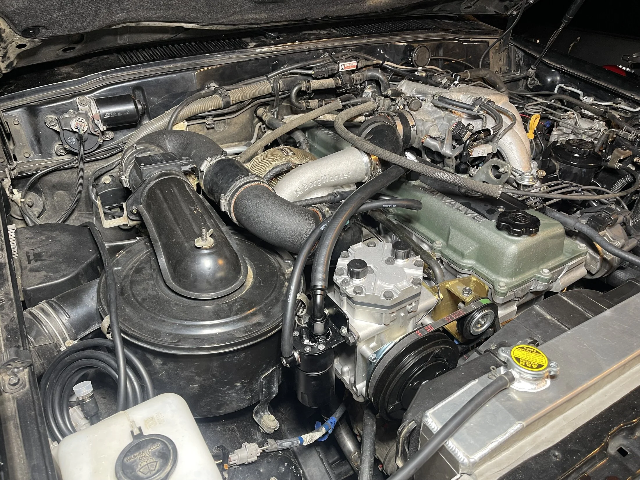

I was just looking at my radium can and it’s not catching oil. But the outlet has oil in it. I’m using on of their PCV valves but it looks like you’re just running straight through the can?
Curious how it is with no valve.
well i'll be a damn idiot. I just realized I'm routing the crankcase breather into the PCV and then pre turbo and the PCV post TB. Need to swap those.... Don't build custom lines when you're tired.

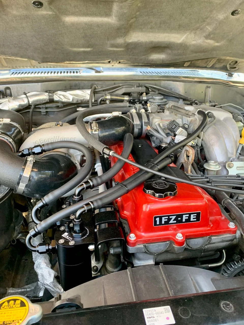

my can on the PCV side catches much more than my can between breather and intake.
lol was just about to say the same thing. love the radium catch can mounted there though, looks great!
Sorry for delay.
Yeah, what you said.
same for me, I definitely catch enough oil in both to warrant having them both, but the pre-PCV can catches about 10x more. Part of that might be because the can is pre-PCV but I like knowing my PCV valve isn't getting clogged up with crud.
