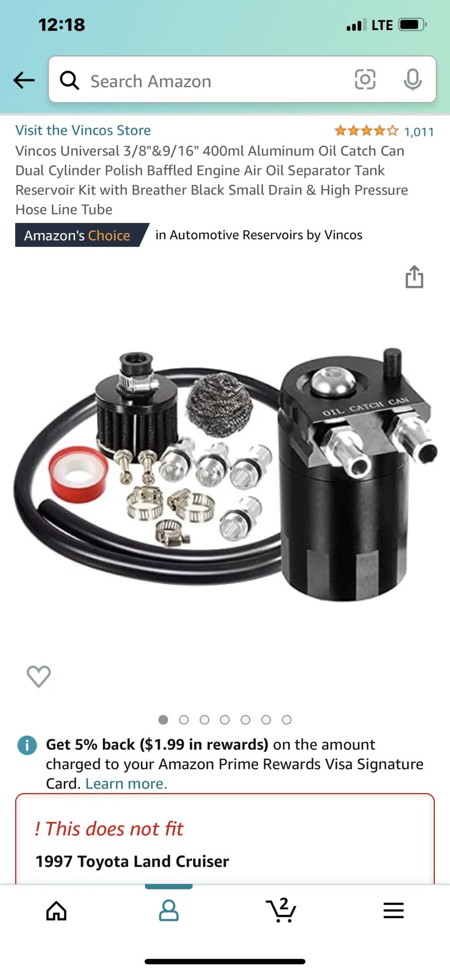

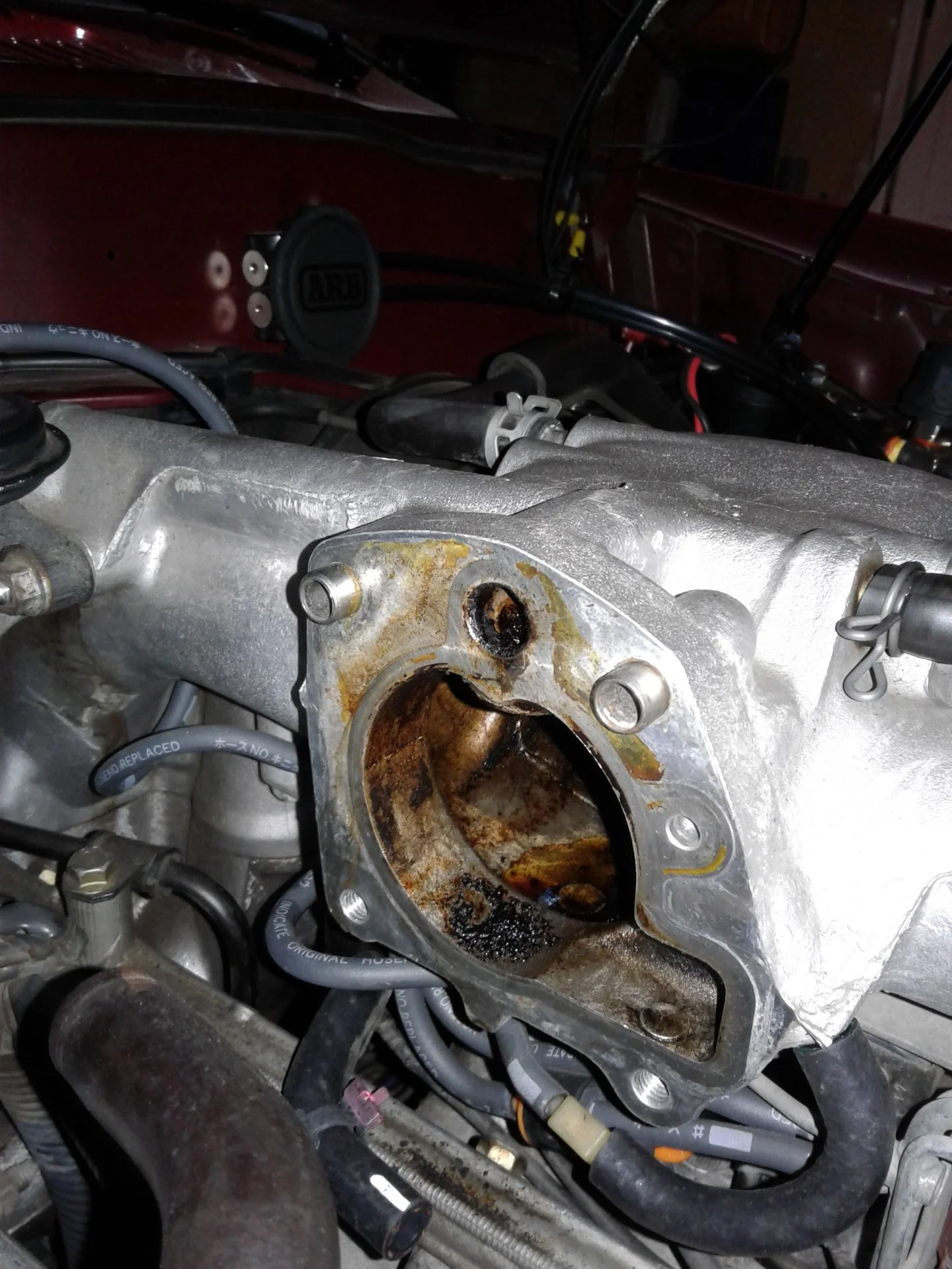

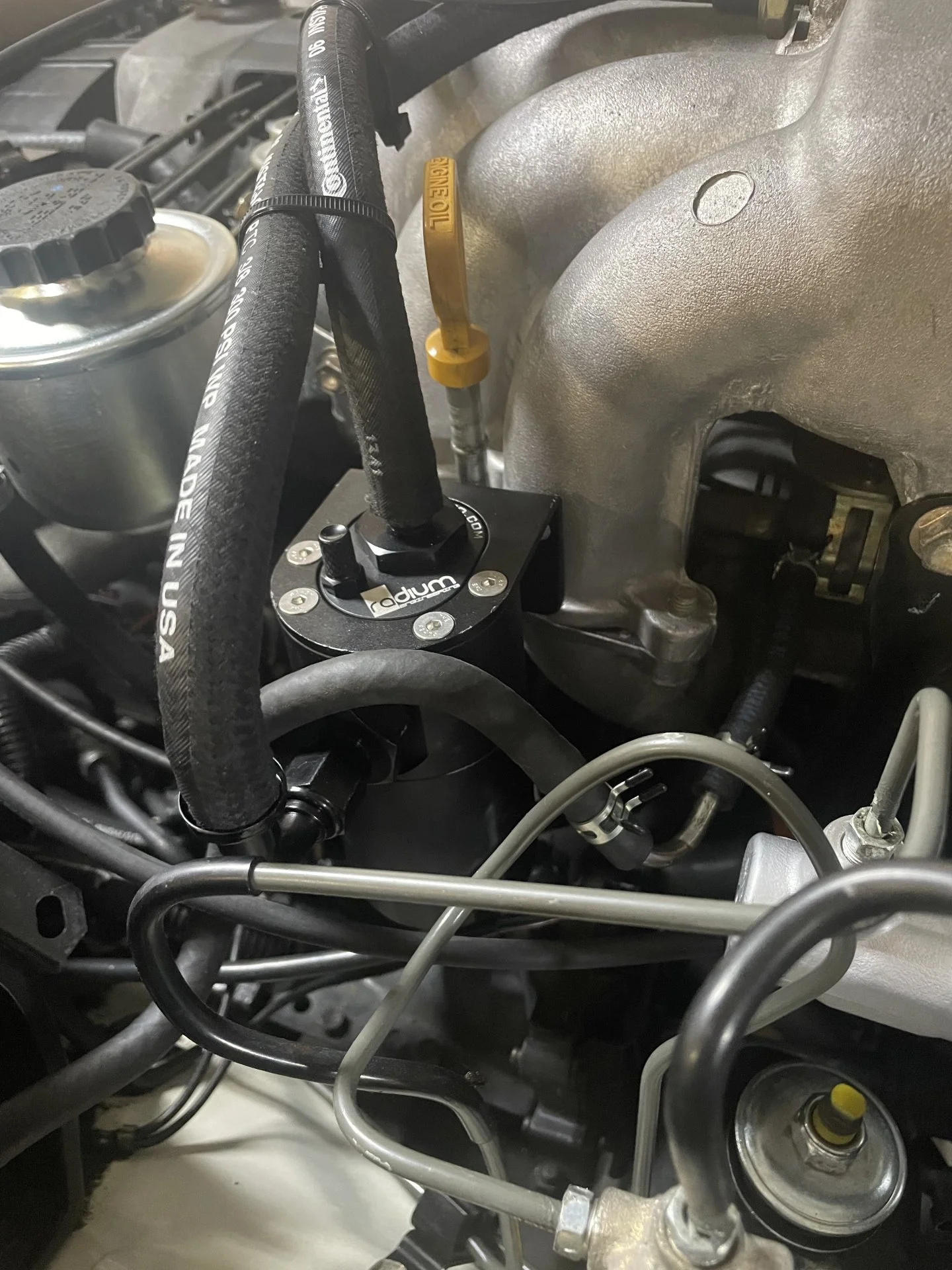

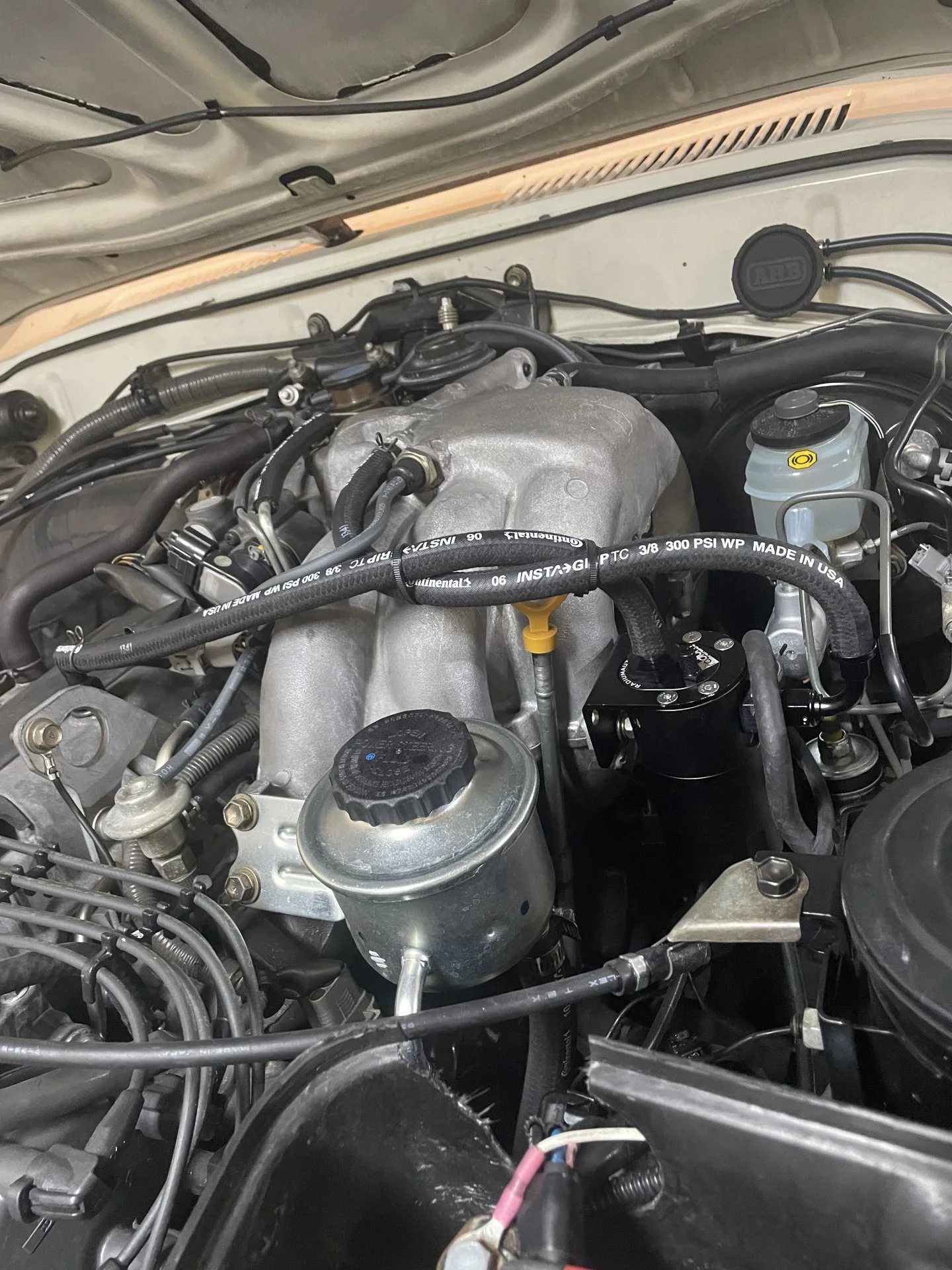

Hey mud I’m working on a oil catch can system and think we could all benefit from seeing what people are running. If you have a working set that actually catches oil and you have to empty it! Than please provide a couple pictures and some detailed information on your install and results. I know there is a lot of brands out there and some that may not work, if your not having to drain it than it’s probably not working. Here is a pic of a Amazon Chinese cheep one I got for $40. Questions I have do I need to put both the breather hoses on the intake trough catch cans or just the pcv? The back side of my throttle body was pretty oily so I assume a lot is getting by the non pcv valve side. Again please provide info if your posting pictures. I will be building a bracket of some sorts. Zip ties are pretty legit but..
Thanks wes

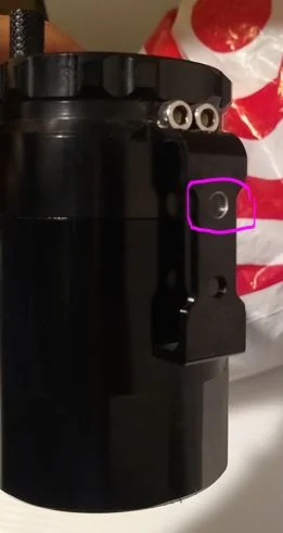

@Fj80oregon mine's similar except just the brillo inside (no filter).
I opened up the mounting clip upper hole to slip over ABS brake pump stud & fasten with existing nut. It's been hanging on ok so far 🤞

Because the motor Lets oil through the pcv valve especially a old one and it’s get inside the intake and clog’s things up. It’s just a little insurance to keep the intake clean. Not for everyone I guess.

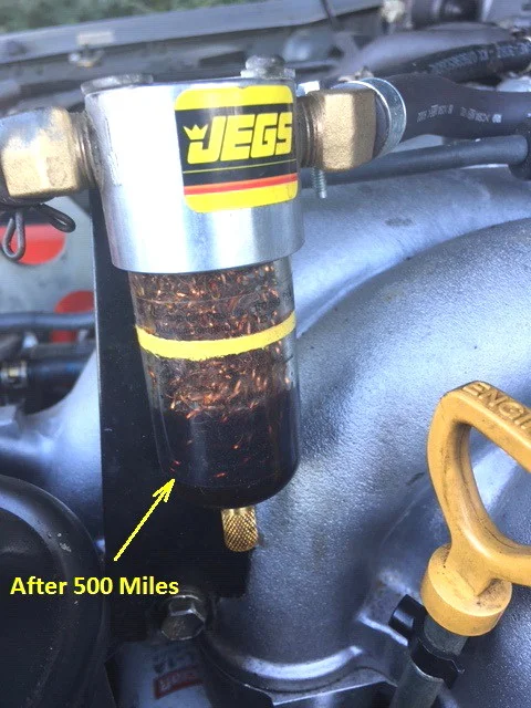

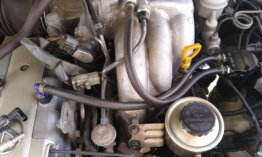

I'm collecting ~1/4cup of oil every change from a 270k mi block. PO had replaced head gasket w/ reman head, so assuming mostly from blowby on the block, lesser from valves? This is my arrangement (sorry didn't post earlier, was previously returned to stock for smog inspection):

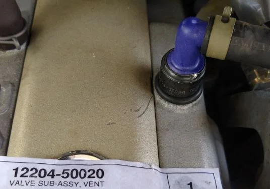

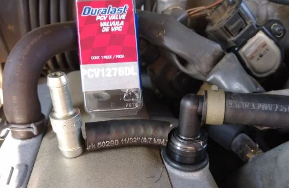

BTW, Toyota right angle PCV 12204-50020 going to try next. For Toyota pseudo-purist-wannabes like me :geek:. Truthfully dunno about internal differences vs stock if any (TBD same or better results :hillbilly:), these are supposed to be for 4.7L V8 1998-2003:

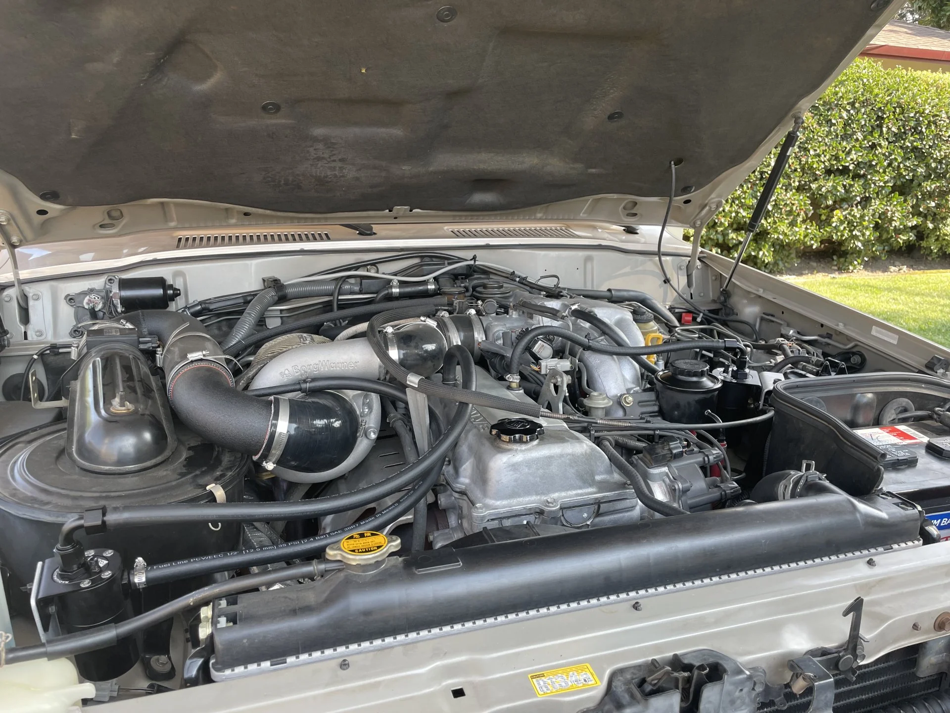

Mine is just your bog standard cheapo set up. Had to replace the supplied hoses with a quality brand as the vacuum was collapsing them.
Not much oil out yet but the truck has only just passed 154,000 miles so it’s barely run in 😎

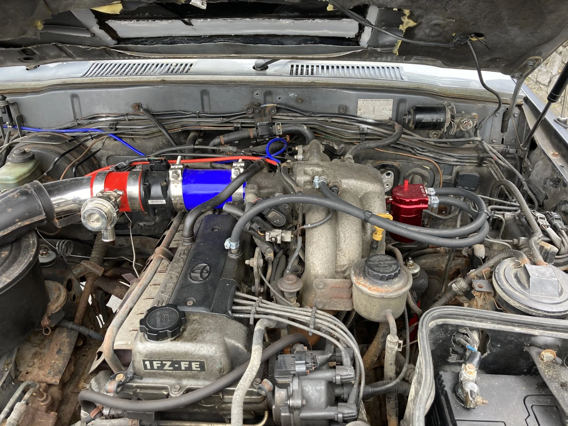

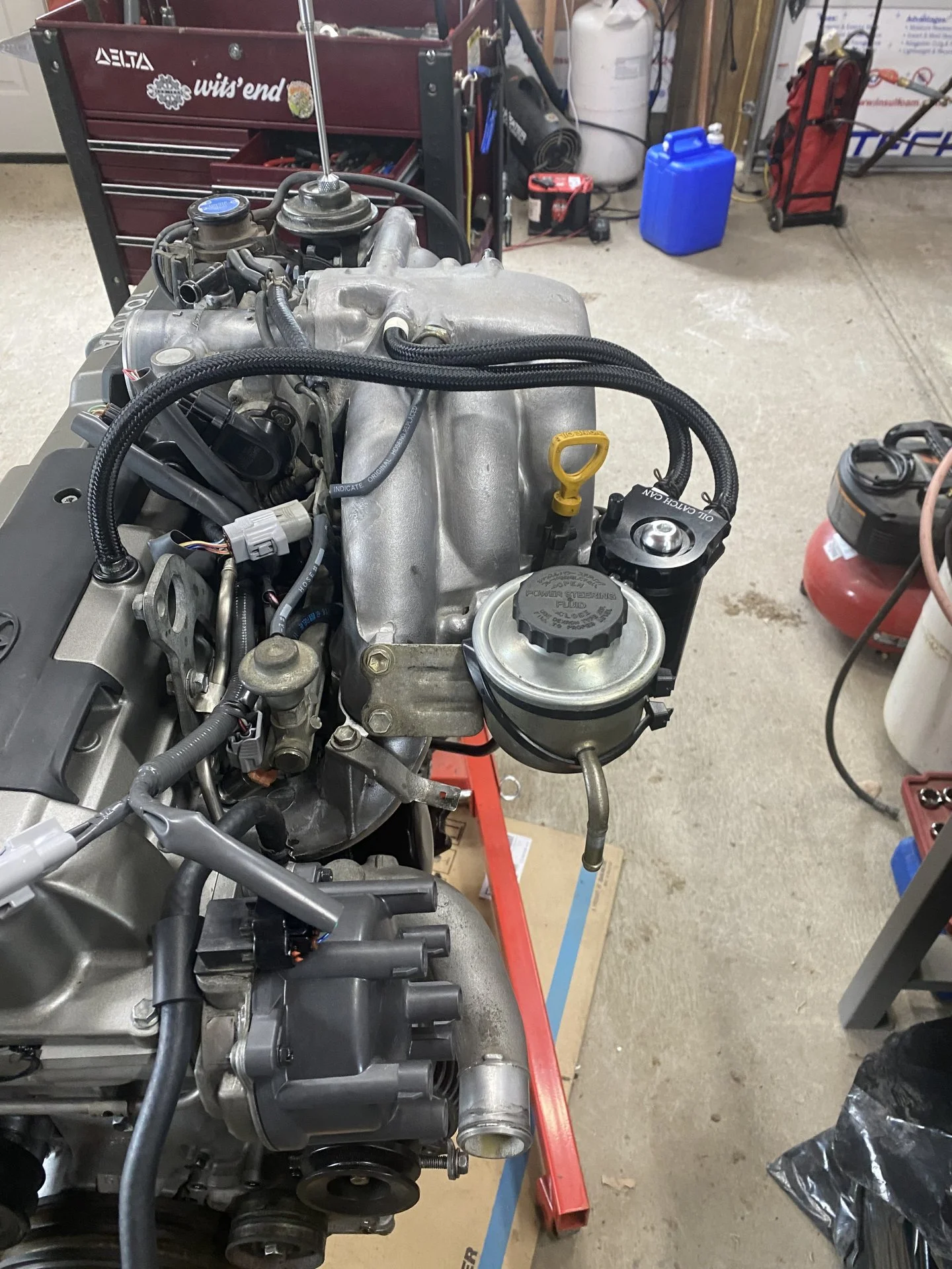

Mine was set up like this. . excluding the angle PVC of course.

Having a "large" catch can like you have can be emptied when you do an oil change. There isn't that much blow back where there will be a significant amount in there. I'm sure you can go three to four oil changes without it being a 1/4 full.

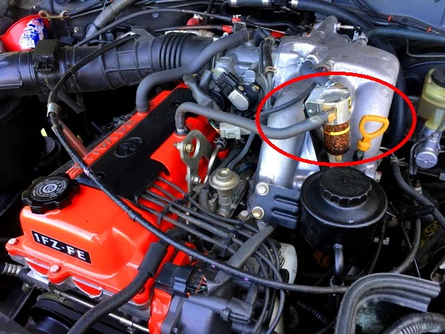

I just finished mine last week. After a few hundred miles worth of road trips I am starting to see oil on the dipstick of the can so I know it’s doing what it needs to.
