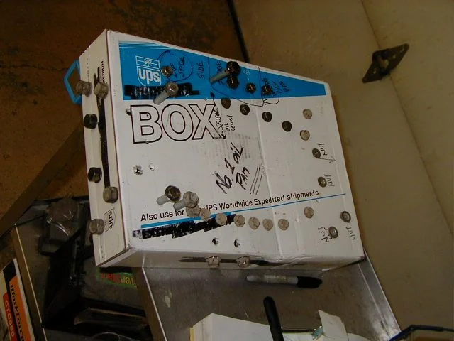

The bolts clean up really easy brass brush and some purple power. Or spend the $25 I guess.
